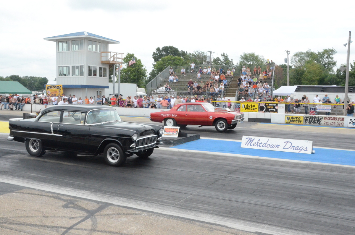

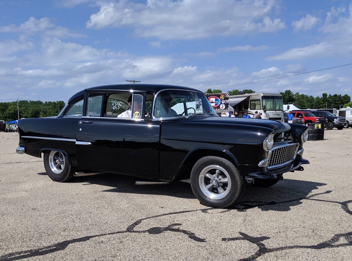

    Yes, I'm not too keen on running an original 3 speed, either. As mentioned it's not fun breaking parts. I have considered using a later all syncro 3 speed, though. However, I have no idea how strong those transmissions are. A Muncie 4 speed isn't entirely ruled out, either.
    As far as the rear axel, the one in my 55 has survived 8 years of the Meltdown Drags / USPEC, (Pie Crust Drags), and the first Glory Days Drag meet. Considering what is planned for the 56's engine, (a basically stock Power Pack 265), and tires, (7 inch cheater slicks), I'll probably stay with the 56 axel. The axel will be beefed up, like my 55's.....Moser axel shafts, bearing cap plates, and a trued up axel housing with reinforced spring pads.

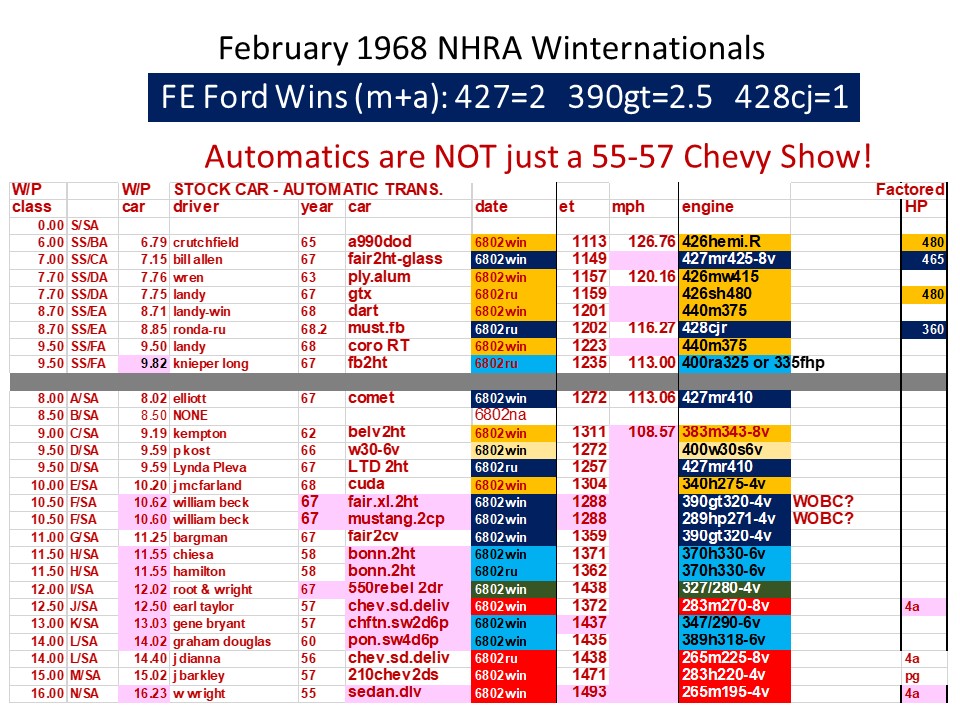

    I too have been searching for anything on the 1968 Pomona Winternationals. I found a barely readable newspaper link here, gives the winners and R/U, and ET but no MPH. From that I've started building my results tables as I'm trying to do for the whole era. Lots of blanks, some guesses, corrections welcome!
    https://newspaperarchive.com/pomona-progress-bulletin-feb-04-1968-p-27/

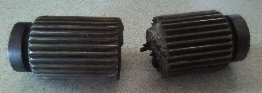

    Very nice! These pictures are from my personal "Shelf of Shame." These were very old, aftermarket 12-bolt axles, from a modern Stocker (small block, 3250# Camaro, w/Powerglide) with modern track prep. These axles were in use well beyond their effective life span so the breakage is on me. Both broke on the starting line during Q1 at the Winternationals about twenty years ago. It is my theory that the right-hand axle had crystalized due to many years of hard use. It is possible to see the crystalizing in the profile of the break. When that one let go, the left-hand axle said, "Screw you, I'm not going to carry this load alone," and it broke about a tenth of a second later. The pattern of the metal separation at the break is visually entirely different from side to side. The car never broke the beams. It jerked sideways but did not move forward.

    What brand of axles are those if I may ask? Just replaced the ones in my 57 with Mosers.
