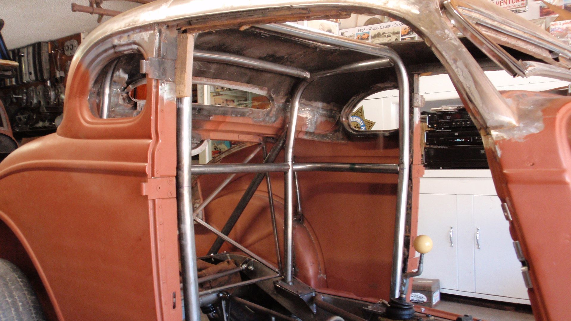

  8. Greg wants the car to be SCTA legal so we built this cage. We tried to tuck it up out of sight as much as possible. For the body to be removable it had to have 1/4" plates that sandwich the floor. Tubing is 1 5/8" x .134 wall. It is mig welded.
    the start...
    The back half...

    Holy **** that looks unreal! I really like the design and installation of the cage.

    Cage looks great I plan on copying it:D
