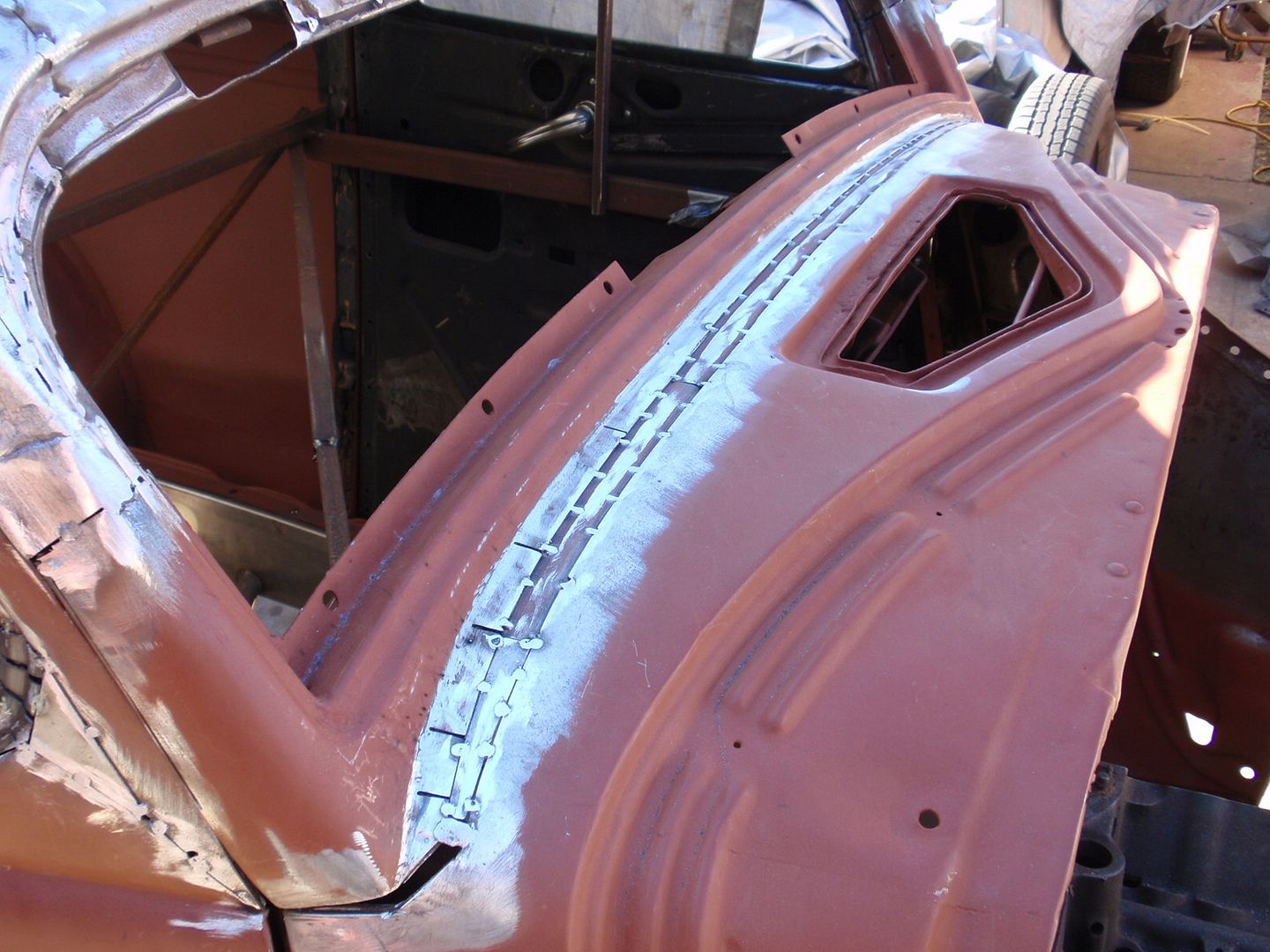

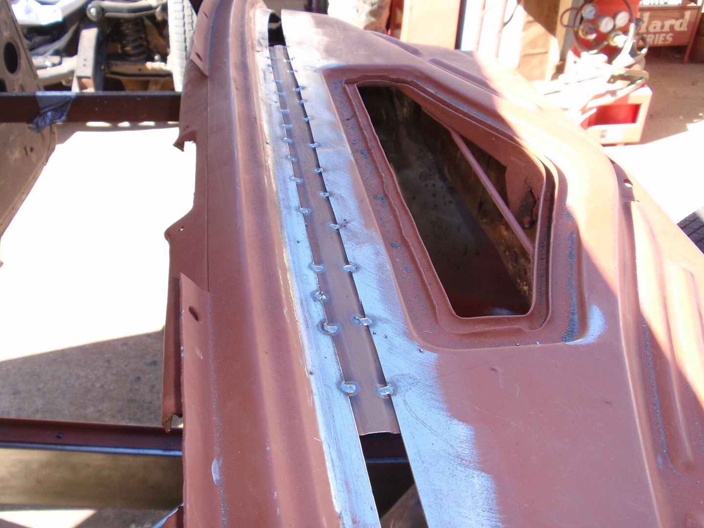

  24. Got the rear window corners tacked in this morning and also the cowl strip filler panels are tacked in. The fitting and tacking is now 95% complete. Keep in mind it is not just me working on this project. Greg has been busy too.
    Rather than fit a strip in the opening and **** weld it I decided it would be alot easier to make a strip wider than the opening, step the center of it up in the bead roller so it will be flush, install it from the bottom and mig weld it. Alot less chance of blowing holes or warpage. I don't see any problems with the double panel in this part of the cowl. In a big flat area you might notice something on a hot day with different expansion rates but with all the curves in this small area of the cowl there should be no problem. Some parts of the cowl are already double thickness.
    Made the first stepped piece 20" long then 2 more stepped pieces to take us to where the cowl is double skinned.Easier to make and fit 3 pieces than one long piece. In the double skinned areas at the ends we fit pieces in the opening that will be **** welded.

  25. chaddilac
    Joined: Mar 21, 2006
    Posts: 14,071
    chaddilac
    You gonna lead that piece in Kev?
  26. Everything will be fully welded. We are just fitting and tacking together right now.
