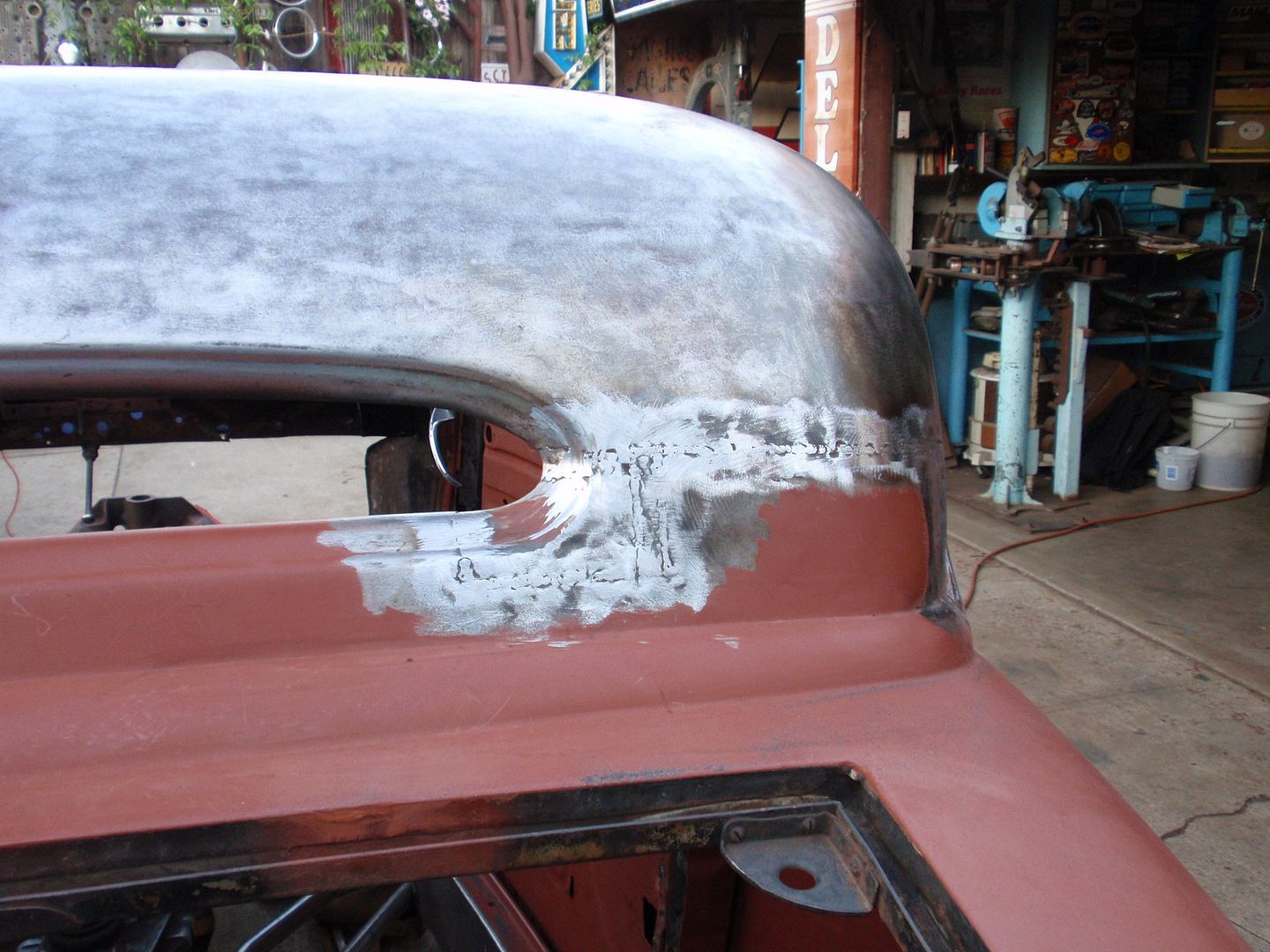

  9. We've been pretty busy welding and grinding. One more day and we should be done.
    Here is the back corner welded up.
    inside shot.
    alfin32, rob-redm and kidcampbell71 like this.

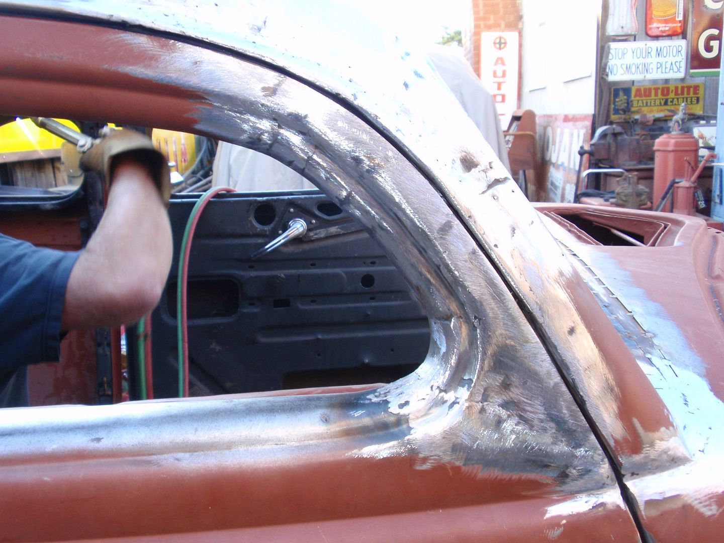

  11. Here is the p***enger door gas welded up. It's like I told Greg, "We're not trying to make pretty welds, we're looking for full penetretion. The top is getting ground off".
    Next the top of the welds are gound off without taking away the sheetmetel around them.
    Then everything is cleaned up with a 36 grit sanding pad. It won't take much filler to finish it off.

  13. The back window joint came to a point so I built it up a little with the mig welder and ground it back for a round corner.
    I used misc' round stones and wheels to shape the rear window corners and door front corners.
    alfin32 and kidcampbell71 like this.

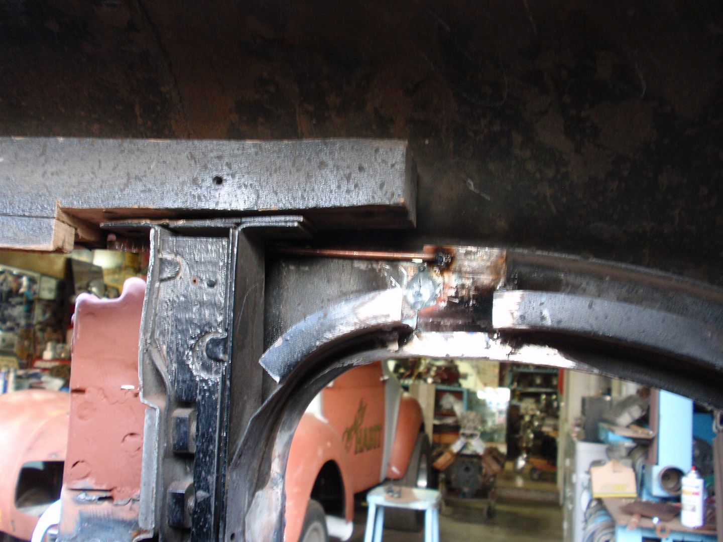

    Here is a shot for junkyardgenius.....

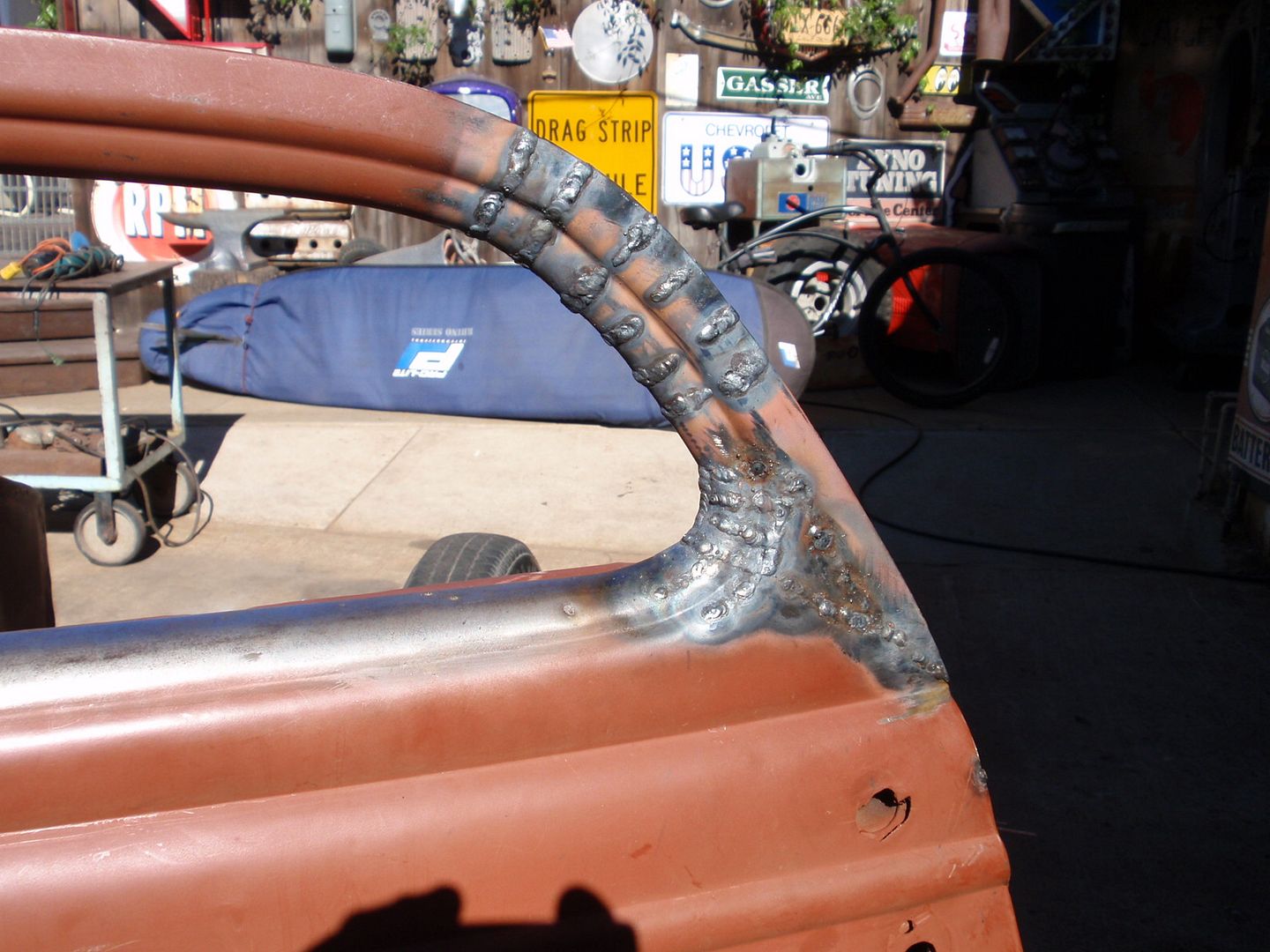

  17. Slepe67.......I just use regular mig wire .030. Nothing fancy. I do run my welder on the hot side so I get instant penetration. There were many holes blown during the tacking process but I don't show pictures of the really hokey looking stuff. I have a great method for taking care of holes where you just stick the end of a stick of welding wire in the hole and tack it again, works great.

  19. Speaking of filling gaps with welding wire. Here is how we connected the top of the B pillar back to the roof. There was a gap, about 1/8" or more. I cut a peice Of thick welding wire and laid it in the back side of the gap, tacked it in place and then mig welded it from the outside and ground it to shape. When I say mig welded I mean alot of spot welds, not long p***es. Taking time not to let any areas get too hot and warp.

    Thanks for the inside shot Kev.Looks like there,s a 5 inch chop coming here soon.
