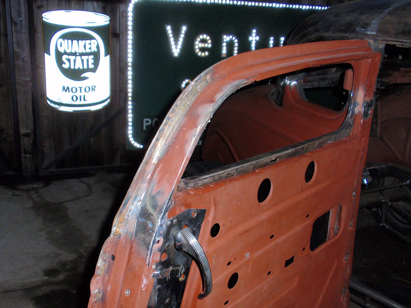

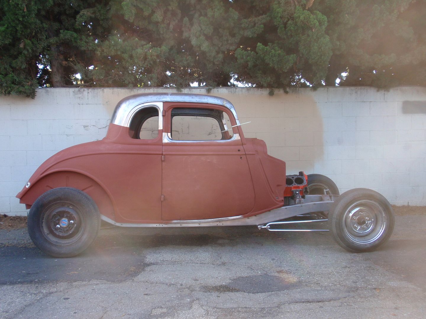

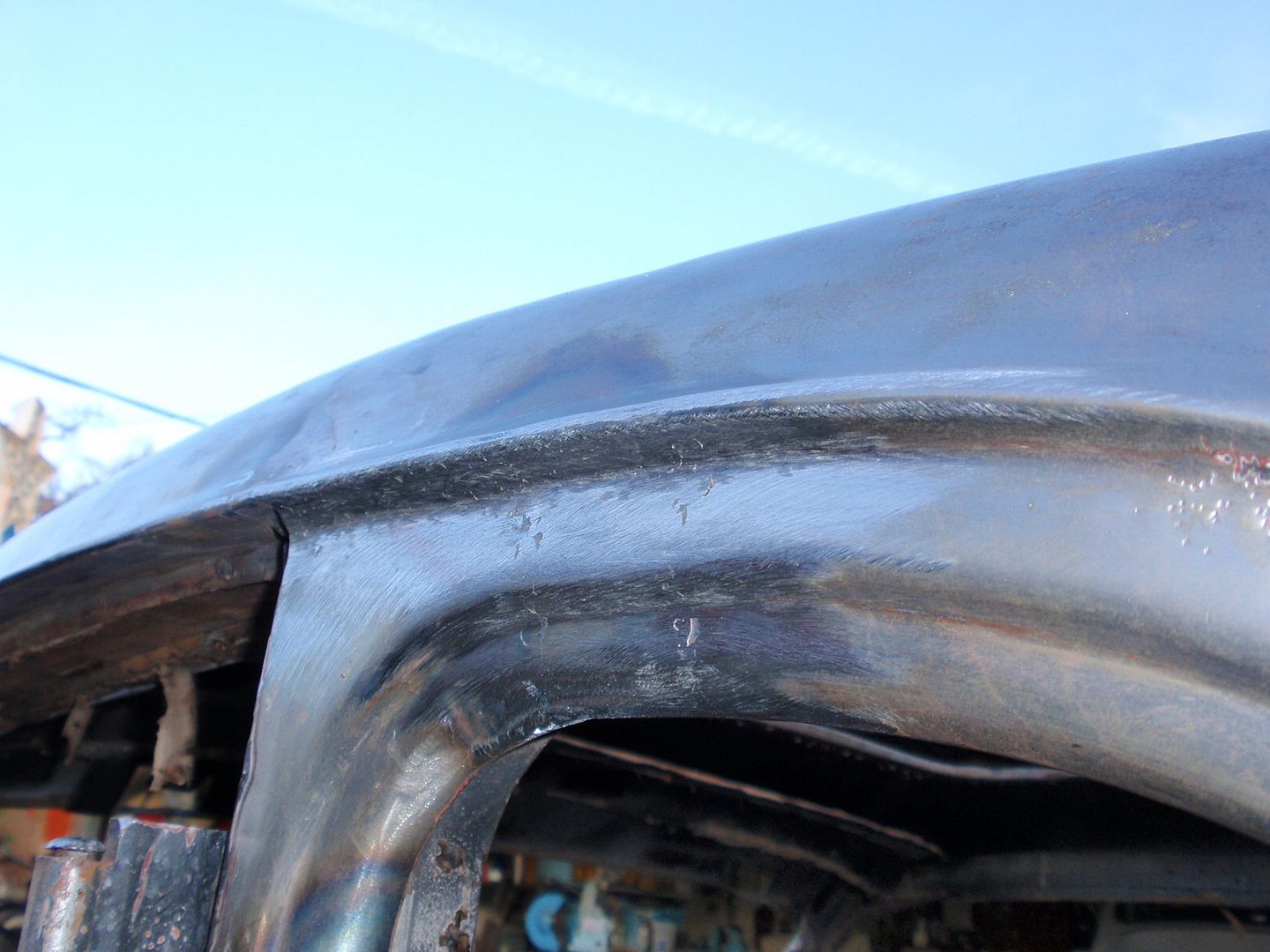

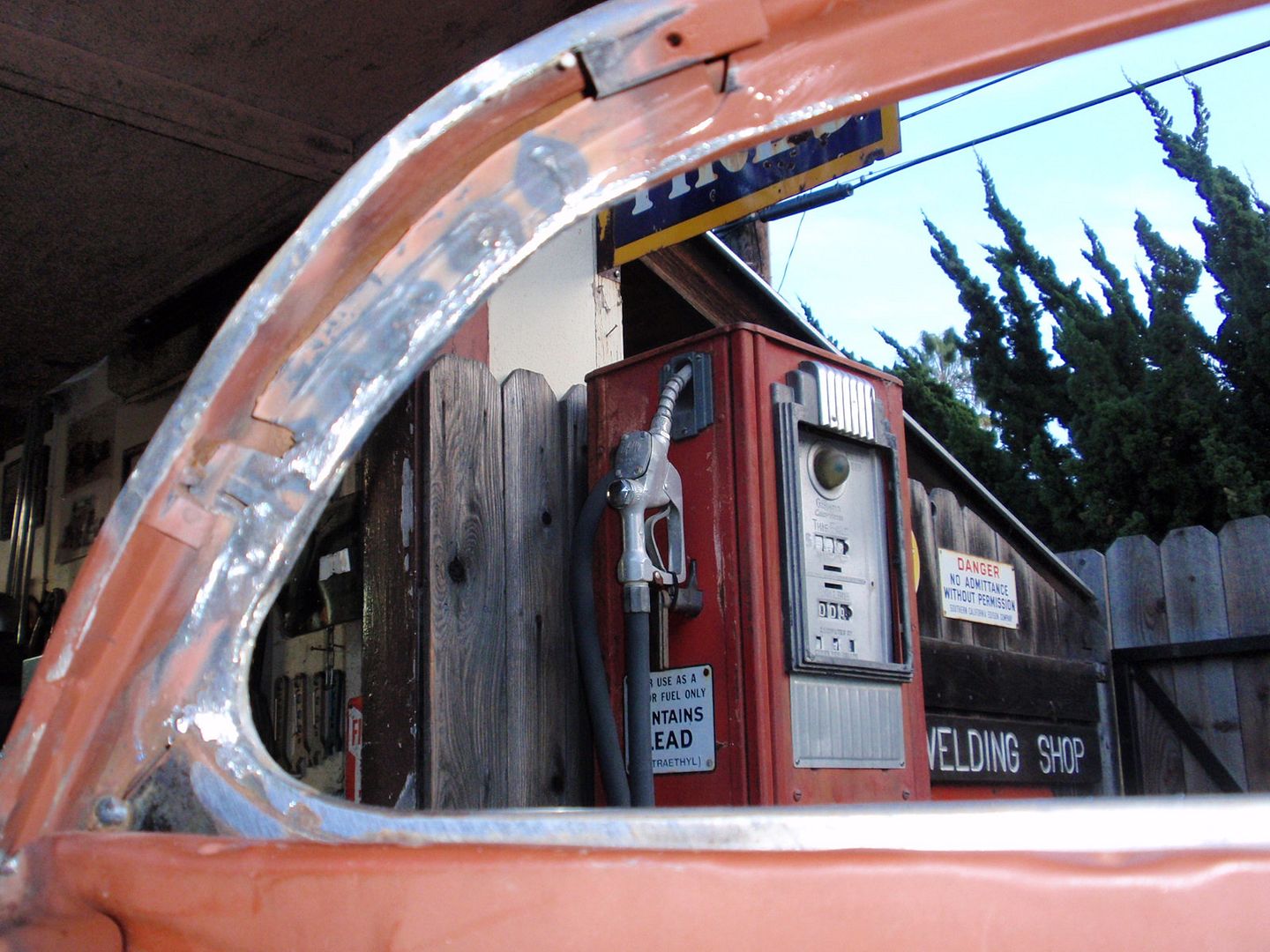

  1. Welded up the driver side and did some more grinding and sanding today so Greg can take his baby home and play with it some more. Still to do are weld the cowl strip solid and fine tune the door gaps. Also a little bondo work. We worked at a casual pace and so far I have 50 hours and Greg has about 40.
    Here is how the top of the B pillar looked when welded and ground.
    A couple of pics of the inside of the door.

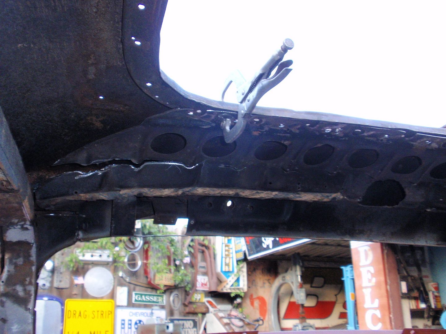

  2. We retained the upper inner structure. It helped keep everything lined up when pulling the top half of the A pillars and it helped keep the windshield opening lined up. The curved part had to be cut along with a bunch of strengthening creases so that it could be bent up and attached to the roof. The cut areas will have some patches added later.
