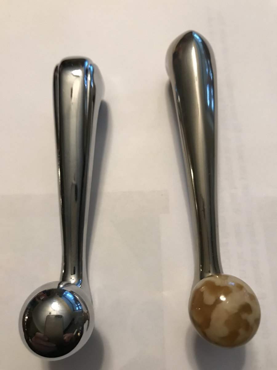

    0104F0D4-4C26-474A-A4FC-7FDF66E71F57.jpeg C6482FC7-F624-41A9-9A3F-44972504C8FA.jpeg Here’s some photos of two early Ford window handles showing one nickel and one chrome for comparison.
    Not really a lot of difference can be seen in a photo, I really think you need to see nickel in the flesh so to speak. I’ve heard some say nickel has a warmer or richer appearance.
    And like Joe H said it does tarnish, it gets a dull haze on it.
    Cosmo49 likes this.
