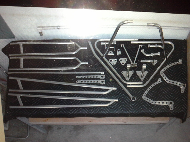

  6. I just had some parts done in nickel - brackets, pedals, tie rods and panhard rods. I had the bare metal vapour blasted, then plated and then lightly vapour blasted again. There was no polishing at all - so much cheaper to do. See here ;
    '52 F-3 and Texas Webb like this.

    DDDenny, that stuff looks great, I had these 4 pieces done for $60 and was happy with the price.....
    Blackjack, that looks pretty close to same color/shine as mine... looks really nice.
