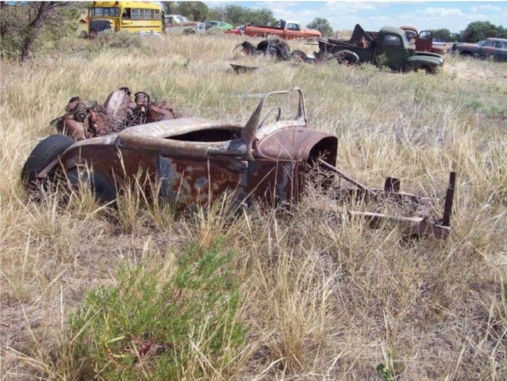

    OK Guys, after a long pause, the little junkyard coupester is back! My brother, Neal, (Fortypickup on the HAMB) started this car. I'm sure many of you followed his build thread until he started another project and gave up on Nickle and Dime. And then, unfortunately he passed. After about two years, My son Joshua decided that it had set long enough and bought it from Neal's son. More to follow. 1.jpg IMG_20191210_125949n.jpg 300841620_10221429759760879_4244074667628899057_n.jpg

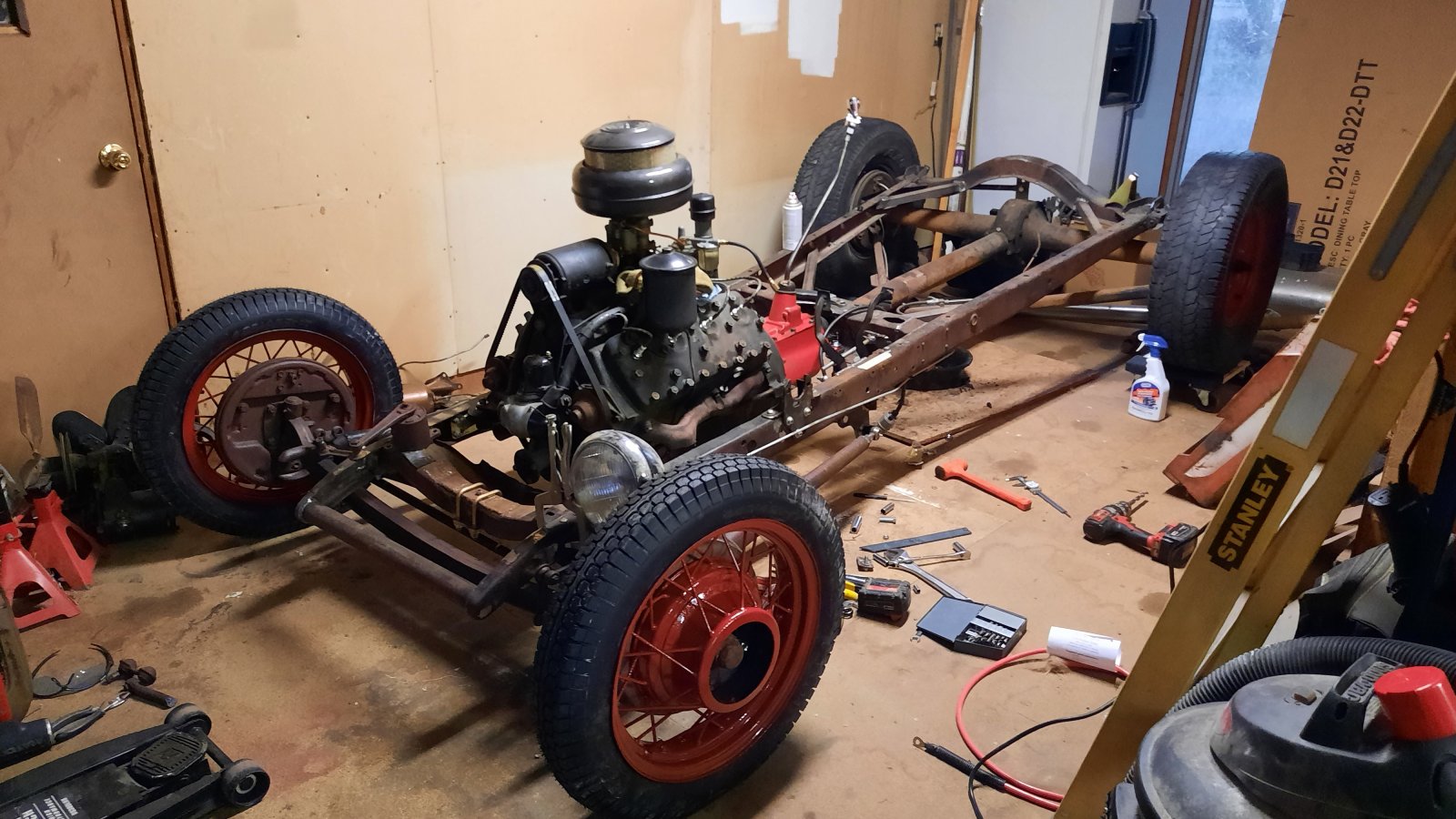

    Here it is in it's new home. 20220327_170148.jpg 20220327_170158.jpg 20220327_192657.jpg

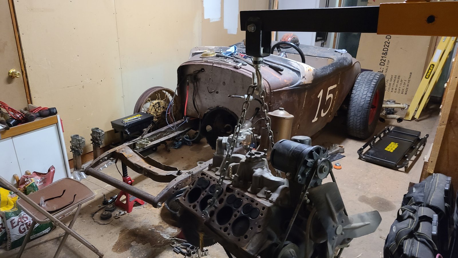

    So then, things went south....What was supposed to be a good running flathead had a cracked block and a couple of gallons of water in the pan. I heard the motor run when Neal had it but no anti-freeze in the winter does not work:oops: Anyway out comes the old. 20220515_165139.jpg 20220524_210752.jpg

    In the meanwhile my son scored a complete front end out of a 46 ford. I know, it's not model A, it's too big and ugly and the spring is in front of the axle. But we had a plan and the rear was out of a 40 so we figured it would work just fine. He also grabbed a couple of 34 wires 20220626_161900.jpg 20220716_204936.jpg 20220717_185540.jpg Figuring out radius arm placement and finalizing spring length and spring perch placement.

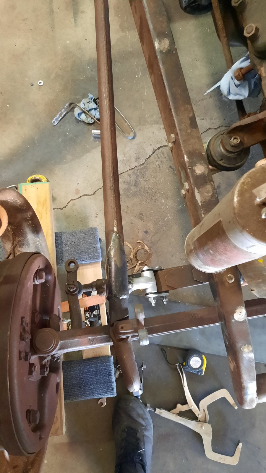

    We are going to reinforce the wishbones where we are drilling for the spring perches.
    20220720_182955.jpg That should be plenty strong. Lots of meat to drill through:) 20220720_201543.jpg
    We checked everything for squareness to the frame and josh welded it up. 20220806_145250.jpg 20220806_152348.jpg 20220806_152518.jpg
