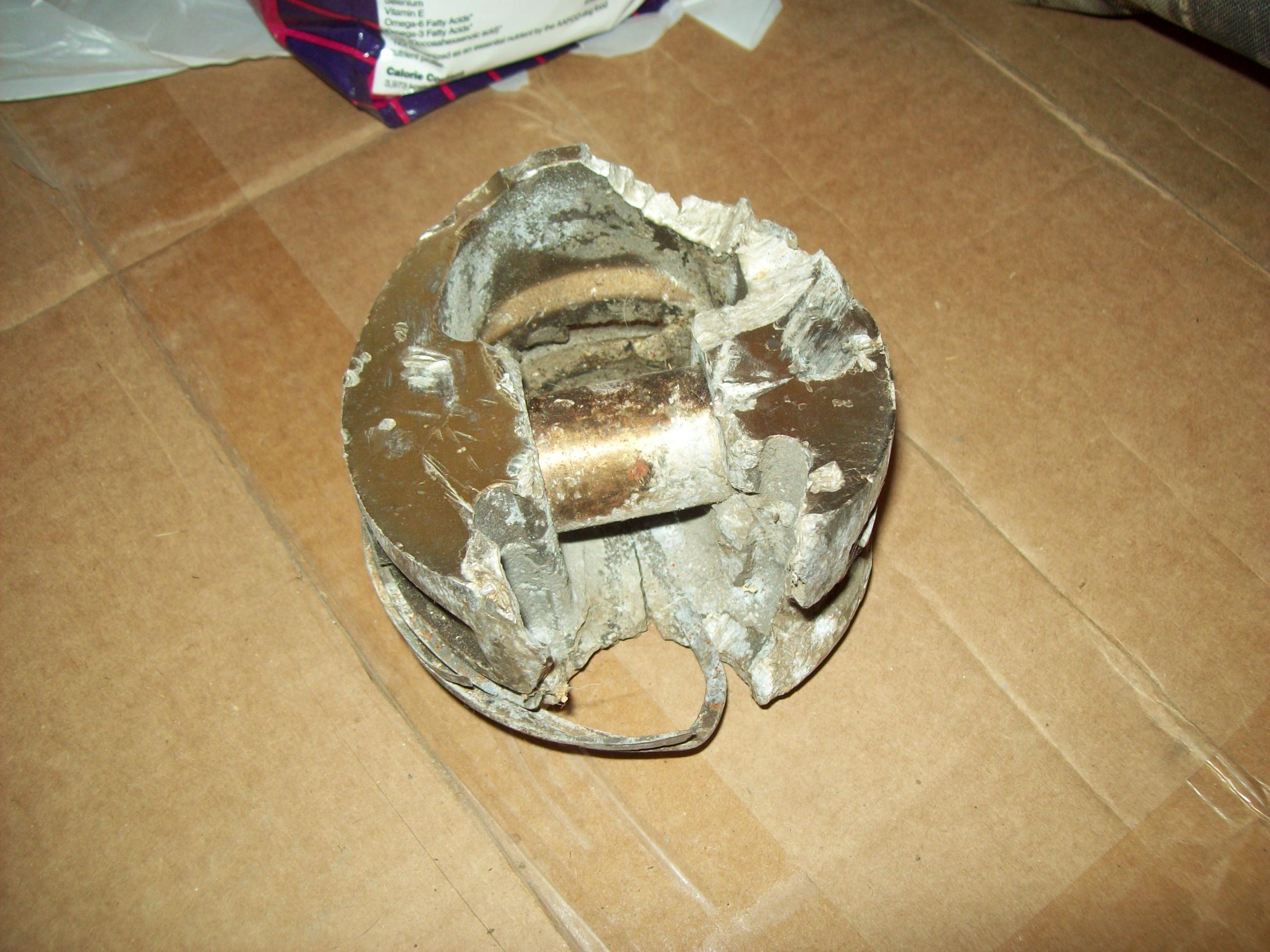

    Buddy like has been said above Lean is BAD Tim Jones I sent you a PM

    from indiana
    Lean or rich isn't good, but don't you think it's better to burn something than to have it expload?

    Need to find the happy medium:) , Worked on a lot of cars that didn't try to kill themselves every p***, it's all about getting a good tuner , Me, I was a diver , mostly fixing what a bad tuner can do:eek: Tim Jones
