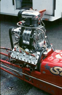

    I just got off of the phone with Rick Schnell, owner of 'Slider", the worlds fastest flathead dragster, with over 900HP.
    Interestingly,he too only has 3 mains, Moldex crank, Crower rods, big crank girdle. He's running 60% nitro. He said sneak into the tune, and don't get gready. He says for every 10% nitro increase, he has to fatten the fuel return by .010. He says go .020-.030 to be safe.
    Boys, if we don't go lean, I have to think we have a shot!
    Forgot to mention, though, the block is aluminum filled.
