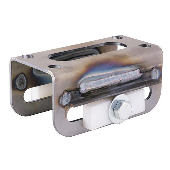

    I was thinking something along the same lines. I have parallel leafs on the back of the stude. I was thinking of using a slider on the front mount for the ladder bar to allow for the spring movement. something like this
    Hightone111 likes this.

    If you're using a standard ladder bar you can leave the rear, top left bolt, out of the mount on the housing. The other rear mounts should have a large rubber bushings, and the front mounts should be the largest, and best quality heim joint you can get. Front mounts should be wider than the joints, with high misalignment on both sides of the joint. If you're building your own bars, the top left hole in the housing bracket can be slotted and a little oversized so it can move and be bind free. This will allow a bolt to be used in the top left mount if it's not tightened. This setup will allow the body to roll when making a turn, or allow one wheel to roll over a bump bind free. Hope this helps.
