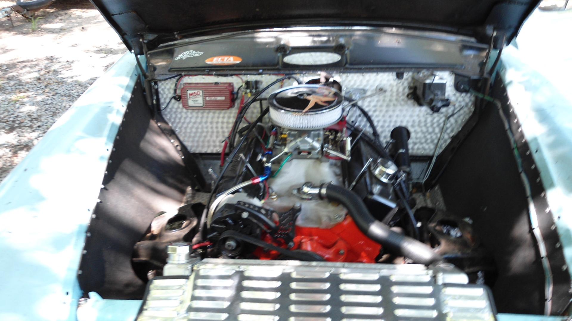

  4. edweird
    Joined: Jan 4, 2009
    Posts: 3,186
    edweird
    can ya see he master cyl. in this pic.

    What's the mc bore? With the volume needed for 4 wheel discs it might not be enough? Does it take a lot of effort to stop or a lot of pumping? What's the pedal ratio? Prop valve? Residual valves?

  21. edweird
    Joined: Jan 4, 2009
    Posts: 3,186
    edweird
    according to master power brakes co. i may need to use the ford explorer master cyl. and booster. they say it has a longer piston stroke to feed the rear disc properly. i'm calling them today.
