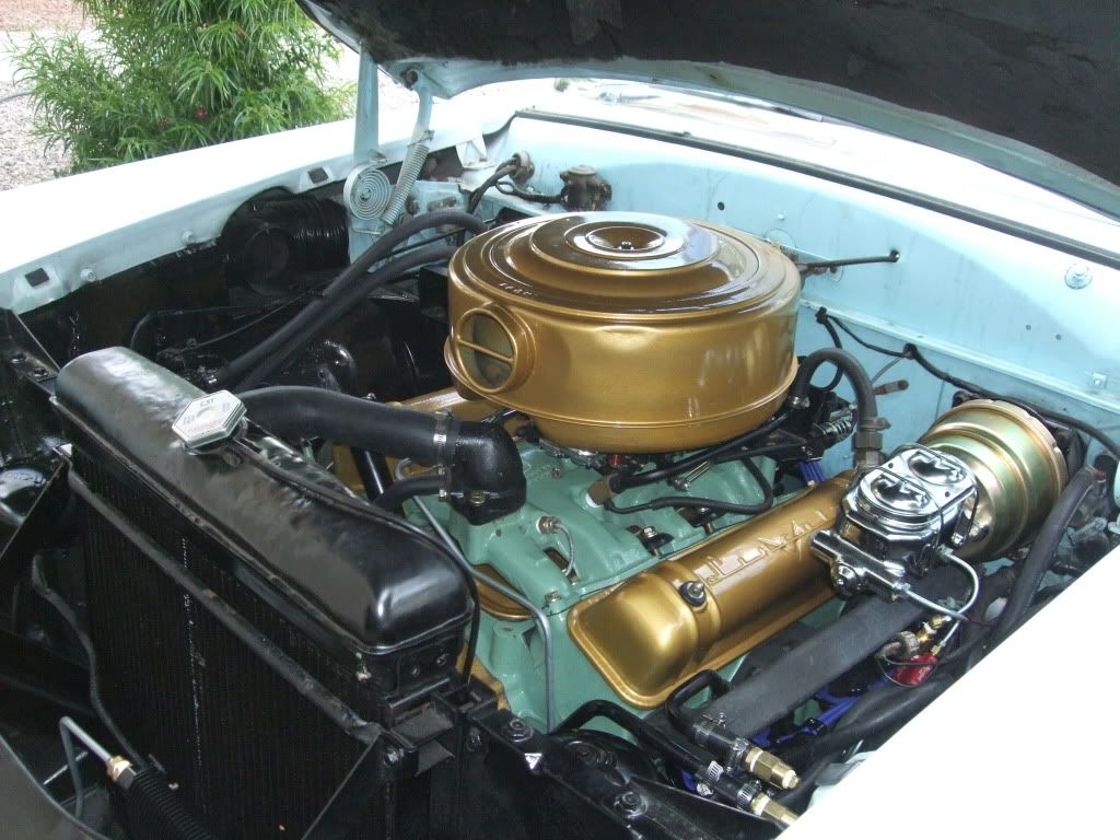

    That car has a firewall mounted " Treadlevac" . Very pricey to repair and not many people do it. The MC section is NOT removable without taking the entire unit apart. Updating to a 8" dual diaphram dual cylinder is probabley the smart way to go here as much as I hate to say it.

    yeah. heres a shot of it.
    how would i got about updating it?

    The drum brakes on thes cars are excellent, the weak spot is the Treadle-Vac....
    Replacement is as easy as the picture makes it look...
