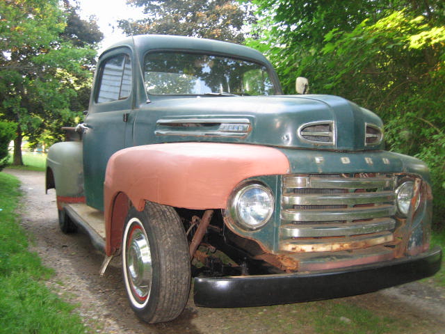

    I wanted an F-1 forever. Ive always been a truck guy. While people are fawning over the hot rods in old photos, Im looking at the trucks that brought them there and pushed them down the tracks.
    Fast forward to September 2007. I'm driving along with a light case of the butterflies on my way to my first night of Grad school when I spot the F-1 sitting at a repair shop. I swung a hard left u-turn and pulled into the lot.
    The truck was a heap, the asking price was laughable. The shop owner came out and told me that the owner had just sunk a considerable amount into the truck to get it running (battery, generator, fuel pump, gas tank boiled and cleaned, some wiring, etc.) I wrote down my name and number after fumbling through a test drive with the non-synchro four-speed, along with an offer.
    Shortly thereafter, the owner called me. He roundly rejected my initial offer. It was very important to him that whoever bought the truck didnt simply rip the motor out for a hot rod and junk the truck. It was a clear case of 'I dont really want to sell, but Im being forced to'
    He explained that the truck was originally purchased new by his great uncle, who sold it to his uncle in 1964, and then the uncle gave the truck to him a few years back to use on his farm. It was obvious that the truck was special to him, so I stated my case once again, with a promise that I wouldnt junk the truck or do any crazy modifications and made another offer. He accepted and not long after, I had the truck home.
    At the time I was living near my grandparents. My Grandfather is a retired body man who had hoped to enjoy his retirement, free from body work and welding, or at least he hoped that I would have the good sense not to drag a rusty heap home. I let him down on both counts.

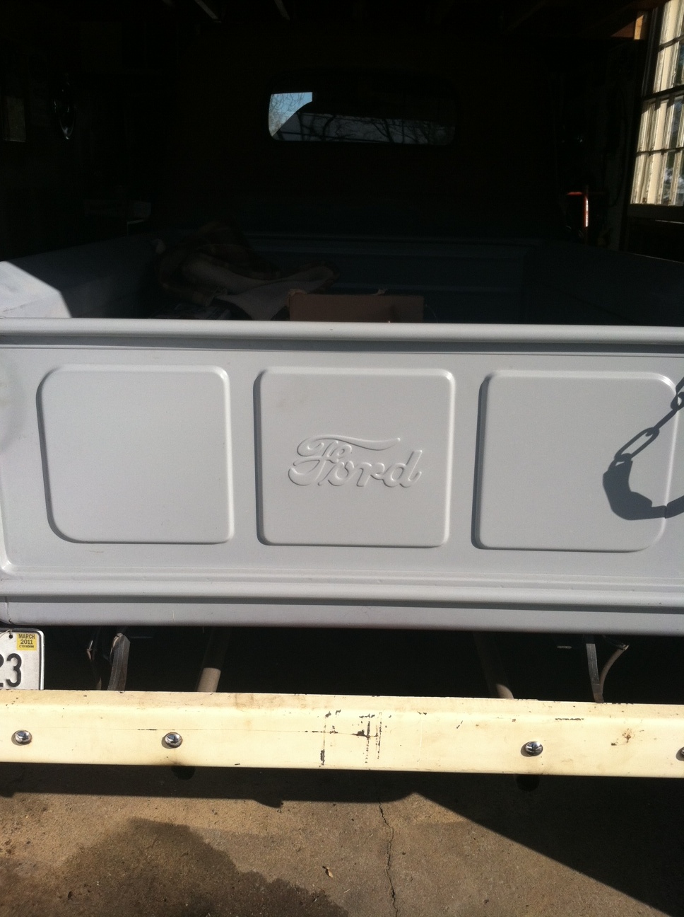

  4. Added a used bumper and hand lettered a used ebay tailgate

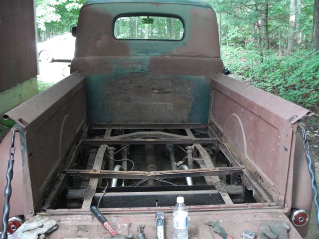

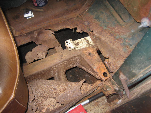

  6. At some point the previous owner welded in a smooth sheet of sheetmetal over top of the original steel and wood bed, so for years everything that was in the bed slid forward and hit the front panel. That caused the panel to rub against the cab, and eventually wear a hole in it.
    Naturally, I can't find any of my 'after' pics, but the hole in the cab was fixed with solid metal. The cross members were also replaced with new ones, and everything was painted Rustoleum black. Also spent a considerable amount of time repairing the rust on the inner bed frame.

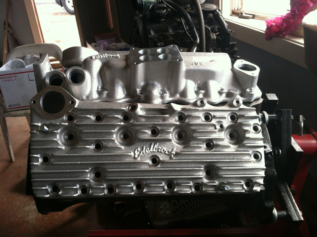

  13. Ham fisted the last post. Took the truck out today as it was decent weather. Switched tires over the winter.
    Built a motor over the past year or two. .125 over, stock stroke. French crank and rods, zephyr springs, Schneider 254f cam. Finally had a chance to mock up the heads and check for clearance. Plenty of space ImageUploadedByH.A.M.B.1394926810.786069.jpg

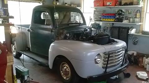

  15. Been plugging along over the past few weeks, splitting my time between detailing the new engine and doing body work. After probably 30 hours worth of picking out dents, heating and shrinking stretched metal, skimming, filling, and blocking, I finally have the back of my cab to where I'm satisfied with it. ImageUploadedByH.A.M.B.1398168702.319146.jpg ImageUploadedByH.A.M.B.1398168727.611512.jpg ImageUploadedByH.A.M.B.1398168746.835942.jpg ImageUploadedByH.A.M.B.1398168768.568923.jpg

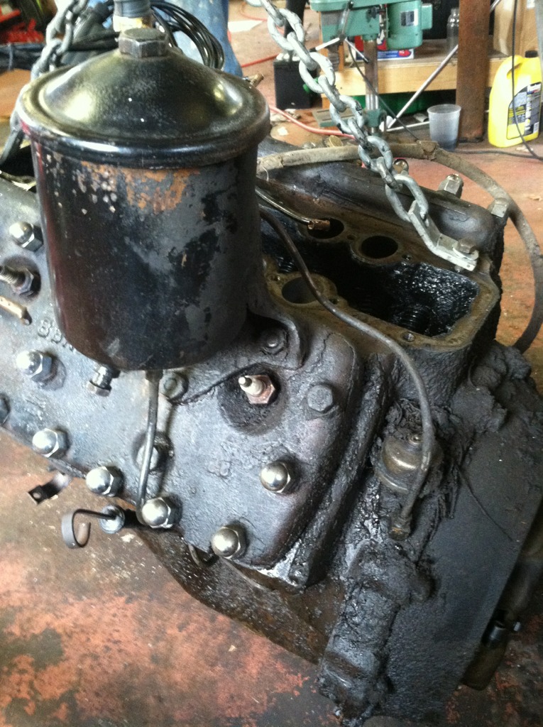

  22. A couple more shots of the greasy mess ImageUploadedByH.A.M.B.1398879190.553695.jpg ImageUploadedByH.A.M.B.1398879202.984987.jpg
    The clutch disc is down to the rivets, so Im getting the flywheel surfaced and waiting on a new clutch, cleaning up and swapping parts from the old motor to the new one

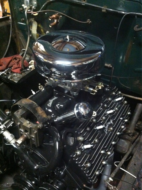

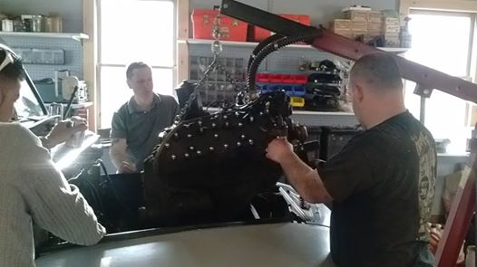

  24. Attempting my first post on HAMB 7 via mobile device because I like to live dangerously.
    After a few weeks, a king's ransom of nickel and dime parts, a shit load of Purple Power, a few good friends and a dozen cases of beer, my new Flathead is in and running!
    I still need to button up a bunch of little things and hook up the driveshaft. Here's a quick snap. Ill post more once I get my sea legs on the new site ImageUploadedByH.A.M.B.1400001127.603013.jpg ImageUploadedByH.A.M.B.1400001158.828193.jpg ImageUploadedByH.A.M.B.1400001187.634183.jpg

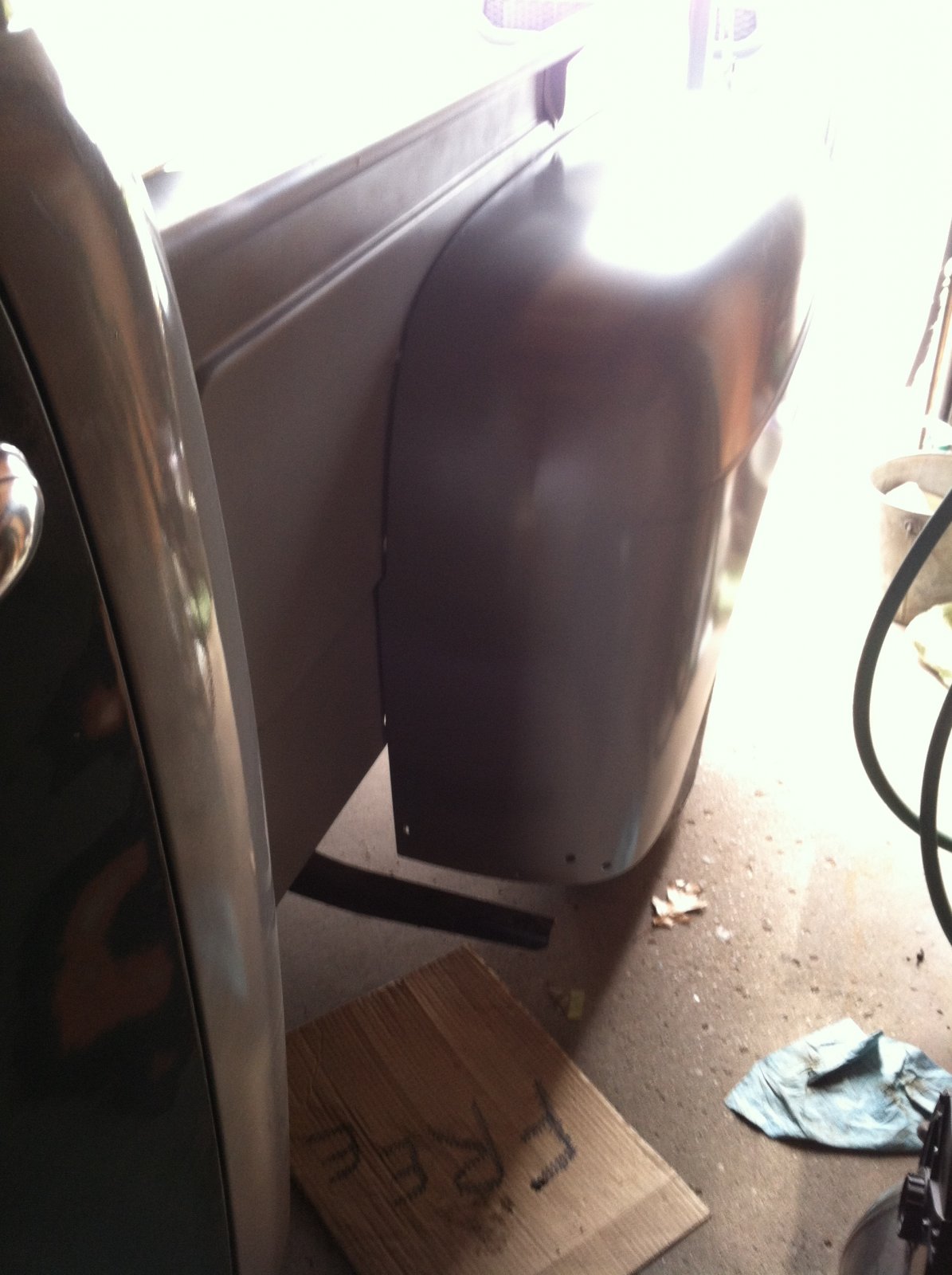

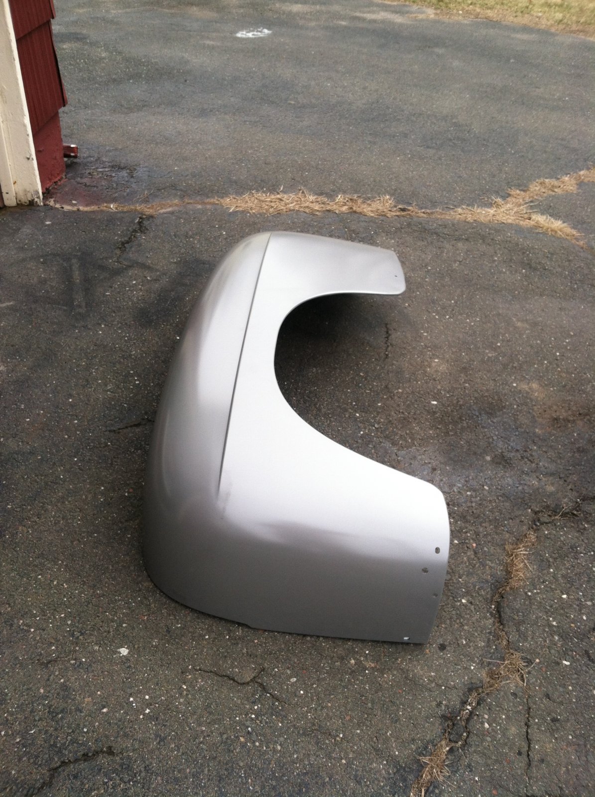

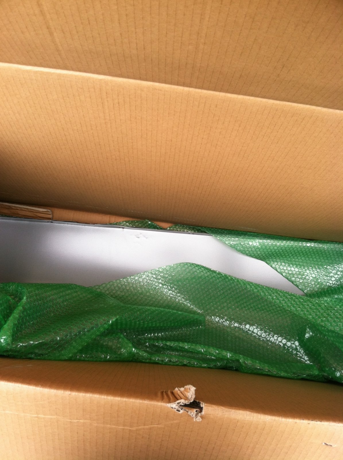

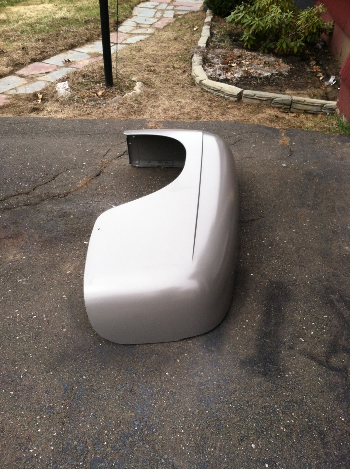

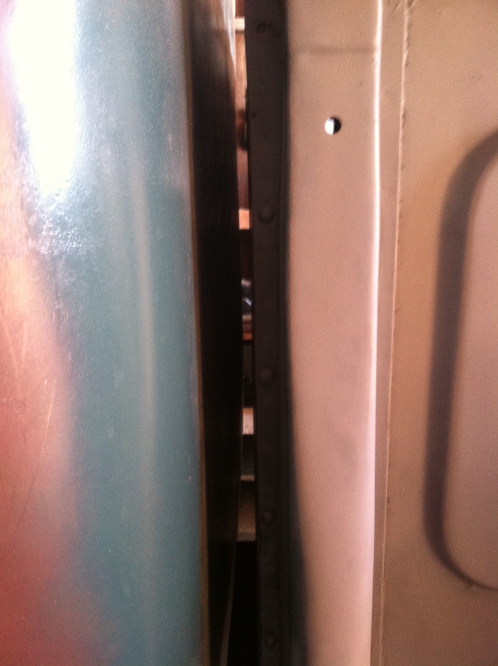

  27. I decided to pony up the cash for a new Dennis Carpenter steel fender. I hadn't seen any real reviews of anyone using them, so I flew blind. image.jpg image.jpg
  28. The fender is very nice, and actually exceeded my expectations. I just kind of slapped it on in the last pic without tightening it down, that's why there's a bit of a gap.
    I'd been working with a 51-52 style fender. It wasn't a great fender to start with and the gap was too weird.
    Still, I can't help but have a touch of buyers remorse because of the cost. The 53-72 fenders are half the price. I'm assuming I paid for R&D and the fact that the fenders cover 4 years of trucks, not 19.
    I know I'll feel a lot better when the truck is all done and painted. This fender will get me to that point way quicker
