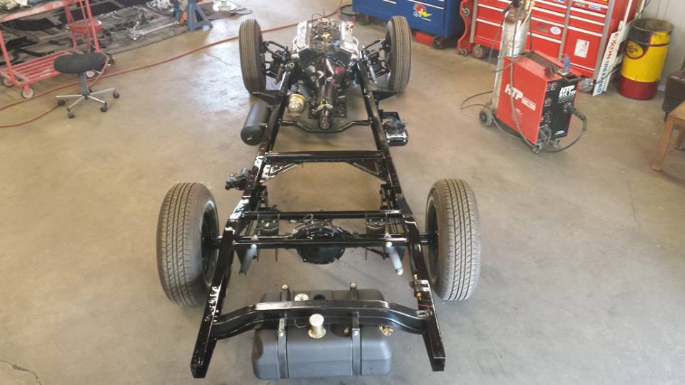

    Here's a shot of the frame, btw. It's been back on the road 2 years now. It has a 350 TBI with 700R4 so I need to update the gearing into the mid 3s.

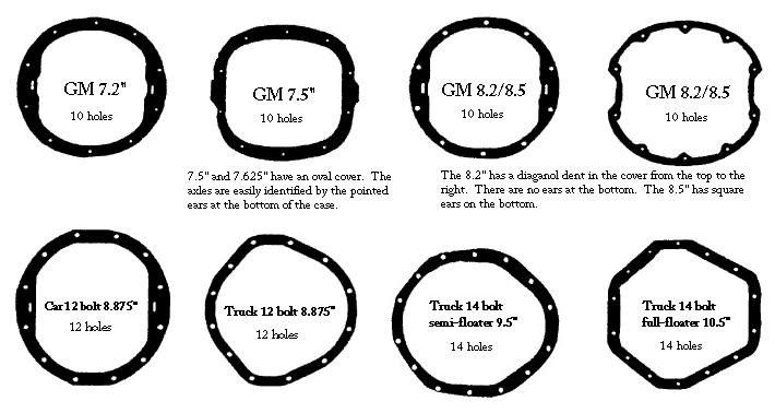

    Does this help?

    Great post, mgtstumpy! Thanks....

    2.41:1?
    Sounds like a mid-70's 10-bolt.
    Is there any evidence that there were a pair of eyelets on the pumpkin, cast in, for a pair of upper control arms?
    If no, then my guess would be Nova, maybe Camaro.
    Going up from there will mean a carrier change.

    If you have a moment, post a picture of the rear-end cover.
