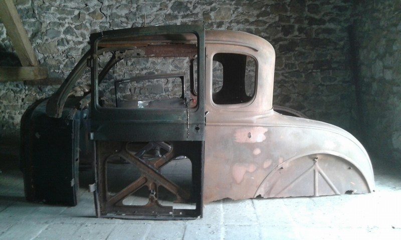

    We bought a new farm last autumn and we have a lot of work to do in the house so I didn't have time to work on the frame (or other cars)
    I only collected few parts for the body.
    It's not a good mock-up, it's just to see what's missing and where I go :)
