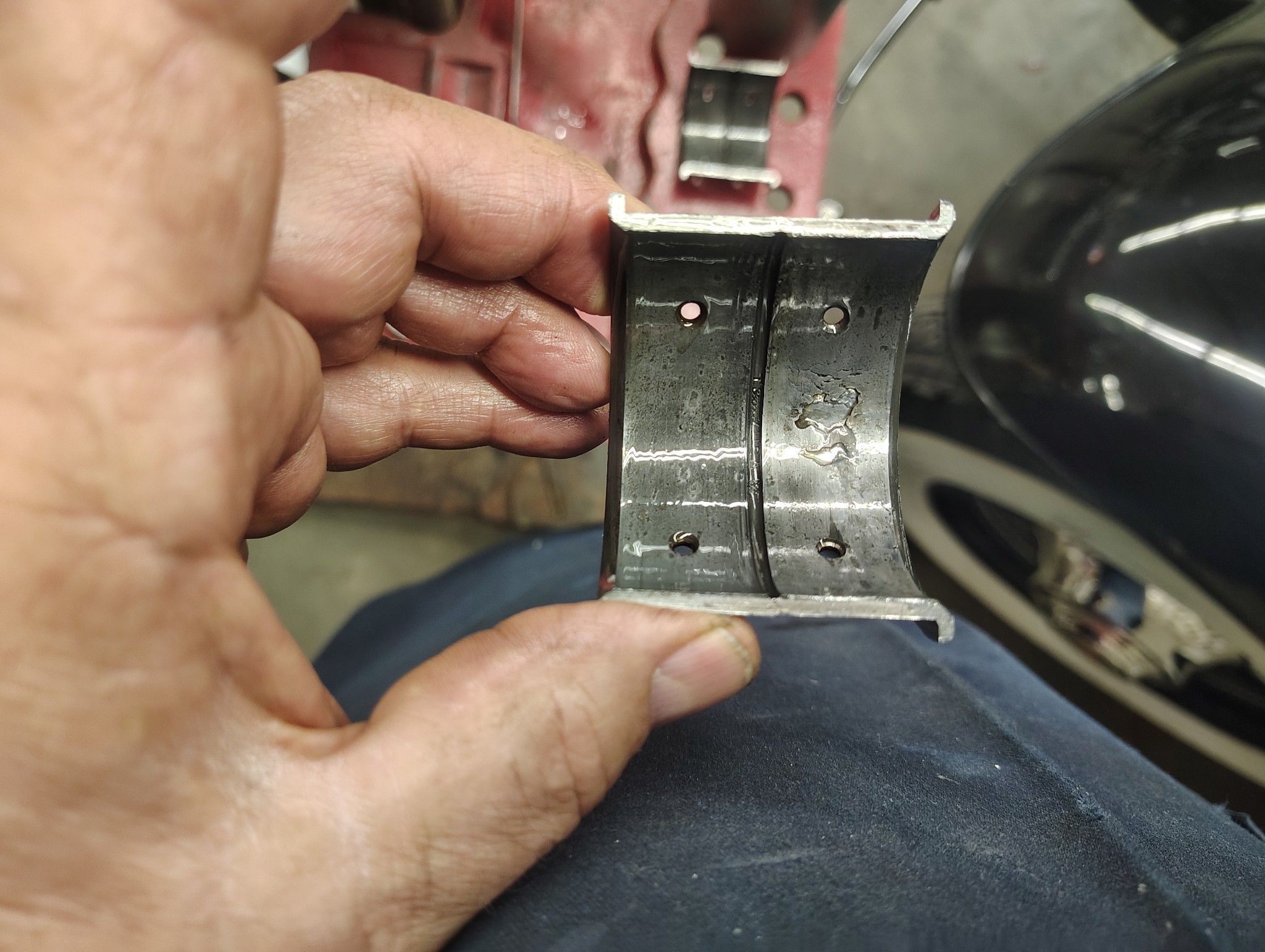

    If your flathead developed a rod knock in it's first 50 miles after a rebuild, that probably has nothing to do with the oil, and is much, much, much more likely due to incorrect machining, contamination, defective parts, or something else a human did wrong. In other words, prove it - show me root cause.

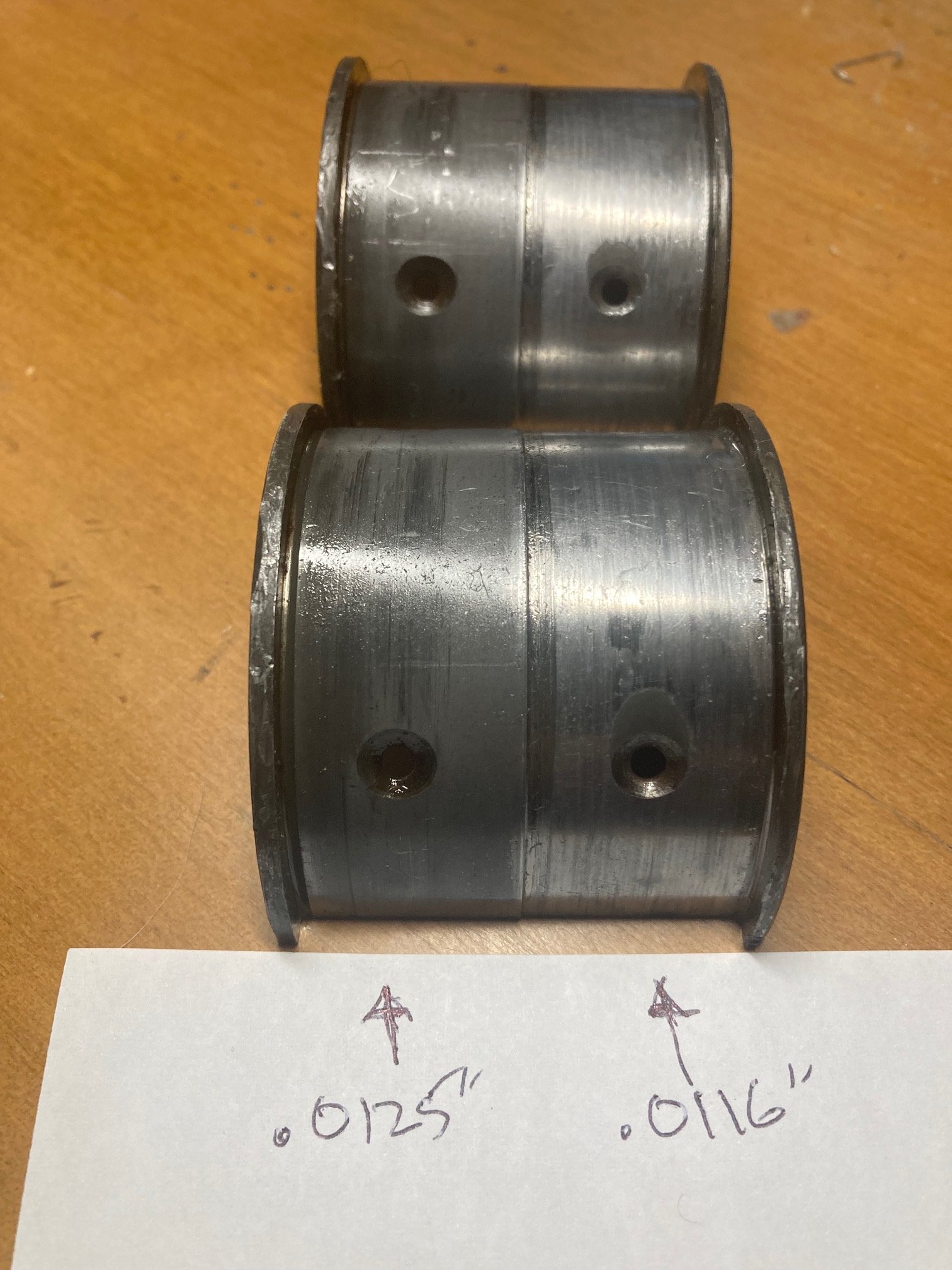

    Some clarification - when I bought the car the previous owner said he probably drove it about 5,000 miles over several years. When he purchased the engine he took the pan and intake off and said he said it looked like it had been rebuilt. I drove it a couple of hundred miles and changed from the 50wt that was in it to 15/40 Rotella. After 50 miles it had a knock. Looking over the engine after it was apart everything was great except one rod. The previous owner was quite surprised at what happened and offered to help me out.
    A friend sent me a link later to a article about why diesel is not a good idea so I have continued to look for information and found the video to quite informative. This is only my experience, and I suggest watching the video I included in the first post for the scientific explanation.
    Full floating rod bearings. Delaminated on the crank side and worn on the rod side. Measurements are the bearing 2307805849371302119.jpeg

    I wonder if the 50wt that was in it previously contributed to the rod bearing demise? it's hard to get that stuff moving when it's cold....
