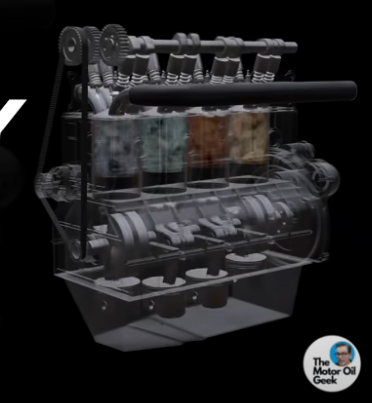

    Explain to me the animation at 1:45....
    Also, the summary at the end of the video is specifically calling out differences in injectors between MODERN gas and diesel engines.
    I didn't catch or hear them mention any significant study of lubricating performance of diesel oil in an engine built 70yrs ago, or built today using 70yr old parts....

    tubman
    First, the animation at 1:45 is simply a demonstration of how a diesel engine combusts the fuel mixture. I would think that would be pretty basic; I'm surprised you had to ask.
    As to your second point, 70 year old gas engines have a LOT more in common with modern injected gas engines than they would ever have with any diesel. Also, different "API Ratings" of automotive engine oil (the "SP/SQ" emblem he pointed out) are currently available; this is the "Old Car" oil mentioned earlier in this thread. Hell, you can still buy non-detergent oil if you really want to mess your engine up.
    Third, this is about the differences between additive packages and the ***ociated degradation, not basic lubrication.

  20. caprockfabshop

    caprockfabshop
    Then explain to me why the pistons are in the oil pan???
    winduptoy likes this.
  21. tubman
    Joined: May 16, 2007
    Posts: 8,255
    tubman
    I can't. They probably "borrowed" that animation and it's not entirely correct. Who knows? It's really not that important in the total scheme of things. The whole point of this is the incompatibility of additive packages. To concentrate on 4 seconds of inconsequential video is beside the point.

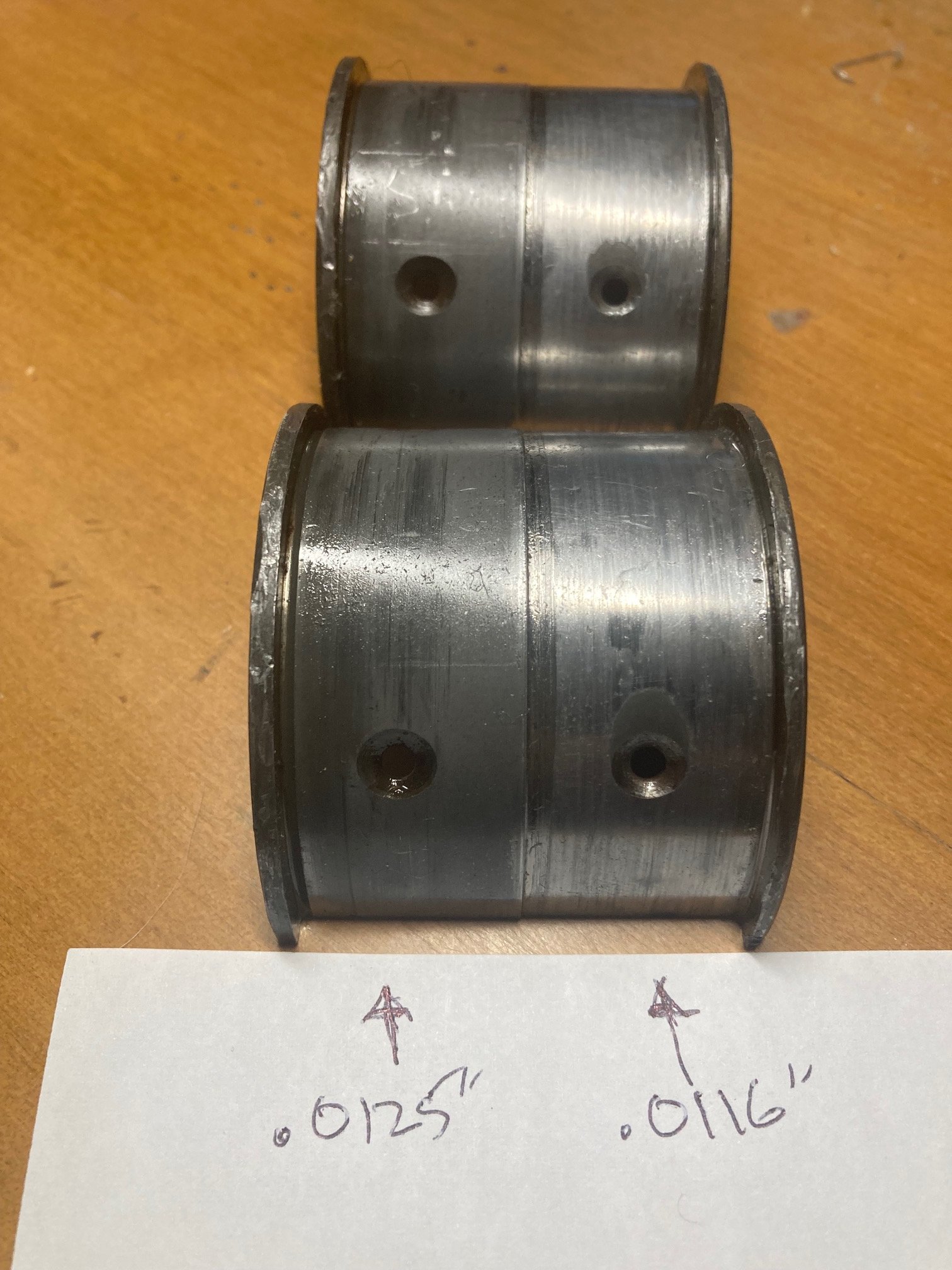

  25. proartguy
    Joined: Apr 13, 2009
    Posts: 825
    proartguy
    from Sparks, NV

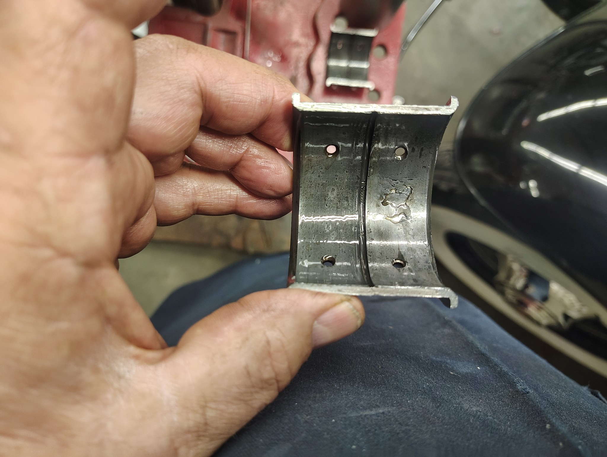

    To answer a couple questions, the engine is a ‘37 221 Ford flathead, thus has no oil filter. The oil pump pickup screen had some plugging not so much to restrict flow.
    My theory is the high detergent diesel oil may have caused existing contaminates in the pan to be disbursed and led to a bearing failure. Everything else in the motor looked fine. That bearing is last in line to receive oil in the system. There was considerable gunk in the bottom of the pan and I think the 50wt oil and having been seldom driven the last few years may have caused that before I bought it.
    I am not surprised to hear the stories of having run diesel oil or Walmart oil or drain oil and it worked out great for you.

    @tubman I don't know anything, but when I research the subject of oils and additives, there seems to be a lot of professional engineers and racing people who support your beliefs. People continue to install new lifters and wipe them out on start up no matter which types of oils they use. There are of course many variables when installing new cams/and or/lifters which can cause these failures. I think (?) the "diesel oil" works in many installations if everything else is correct. Many people have done it and had good results and do not wish to believe that maybe there are better options, or that any other option is worth considering. Don't get disheartened by some of the pushback......some will never take the time to consider an alternative much less actually change. On the other hand........if someone always has good luck with a certain method, I can also understand reluctance to change. The old "If it ain't broke, don't fix it". So, there is more than one way to do things and get good results. That said, I still have a "land line" phone in my house.
    The point that sticks in my mind when this subject comes up is that there are multiple types of ZDDP. It isn't a one size fits all situation. The explanation as I vaguely recall was that different rpms or different temps (????) affect the activation of each type...........so a specific type or blend of types may be best for different motors or situations. It seems logical that the multi-million (billion ?) dollar oil companies may have a pretty good idea what is going to do the best job for most situations. I'm going to attach something that kind of explains what I'm trying explain about the difference in ZDDP types. Anyone who isn't interested in it should just skip it and continue doing things the way they always have. Remember tho, I'm not saying other things don't work for people........just sayin it doesn't hurt to consider that there may be newer things that might help also.
    As for the bearing going bad in your engine in 50 miles........my su****ion is that the bearing was already failing and they put 50 weight oil in to mask the noise/prevent bearing failure. When you changed to a lighter oil, it no longer had that protection and failed. Thats just a supposition on my part. There could also have been some debris in the engine that just happened to break loose and destroy the bearing just after the oil change. I don't think the replacement oil itself caused it........but thats just a guess on my part.
