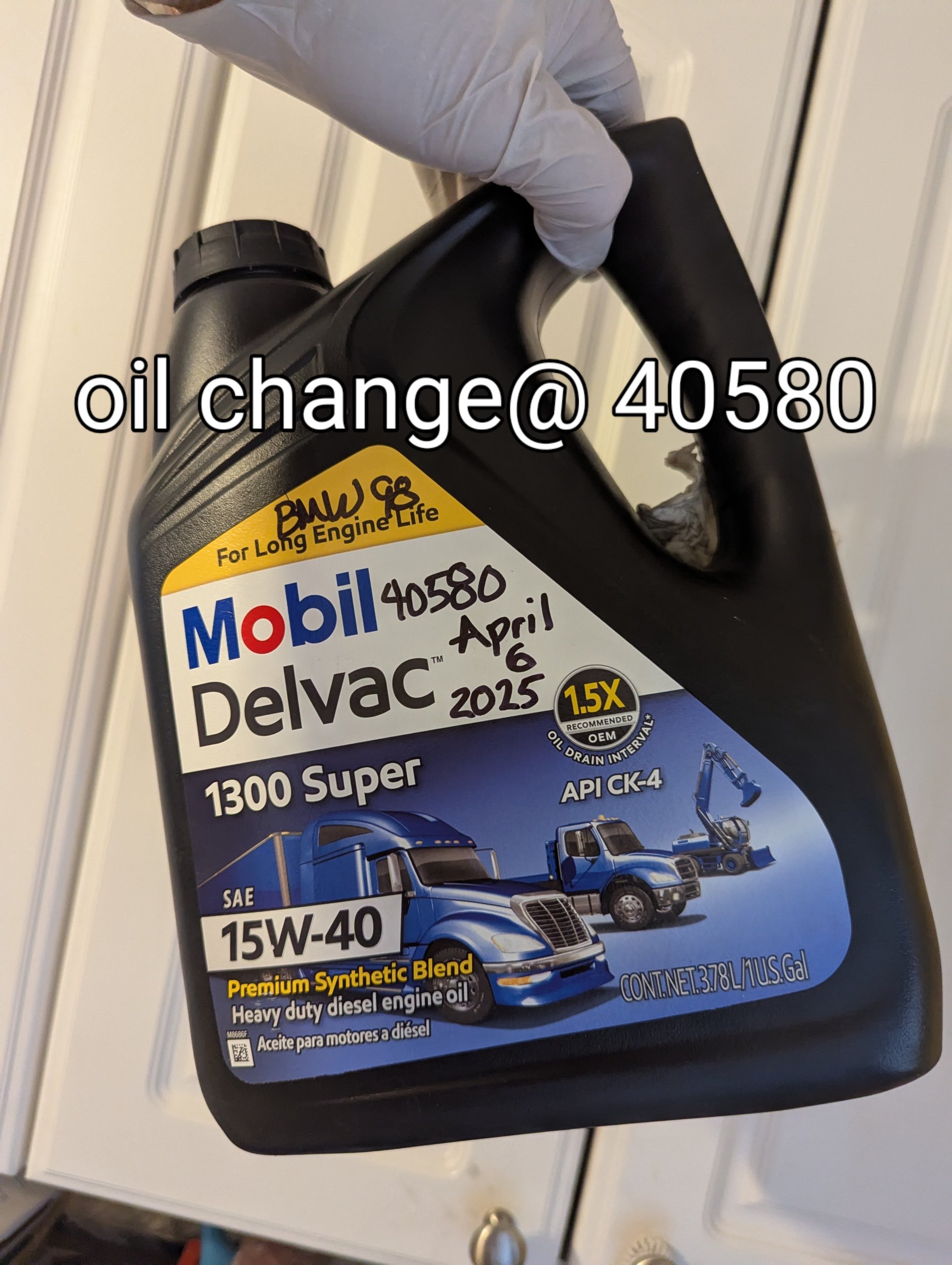

    I’m running this in my 1998 OT air cooled 1100cc PXL_20250408_003802691~2.jpg motorcycle. seems to be doing OK.
    I haven’t tried it yet in my 41 Cadillac...
