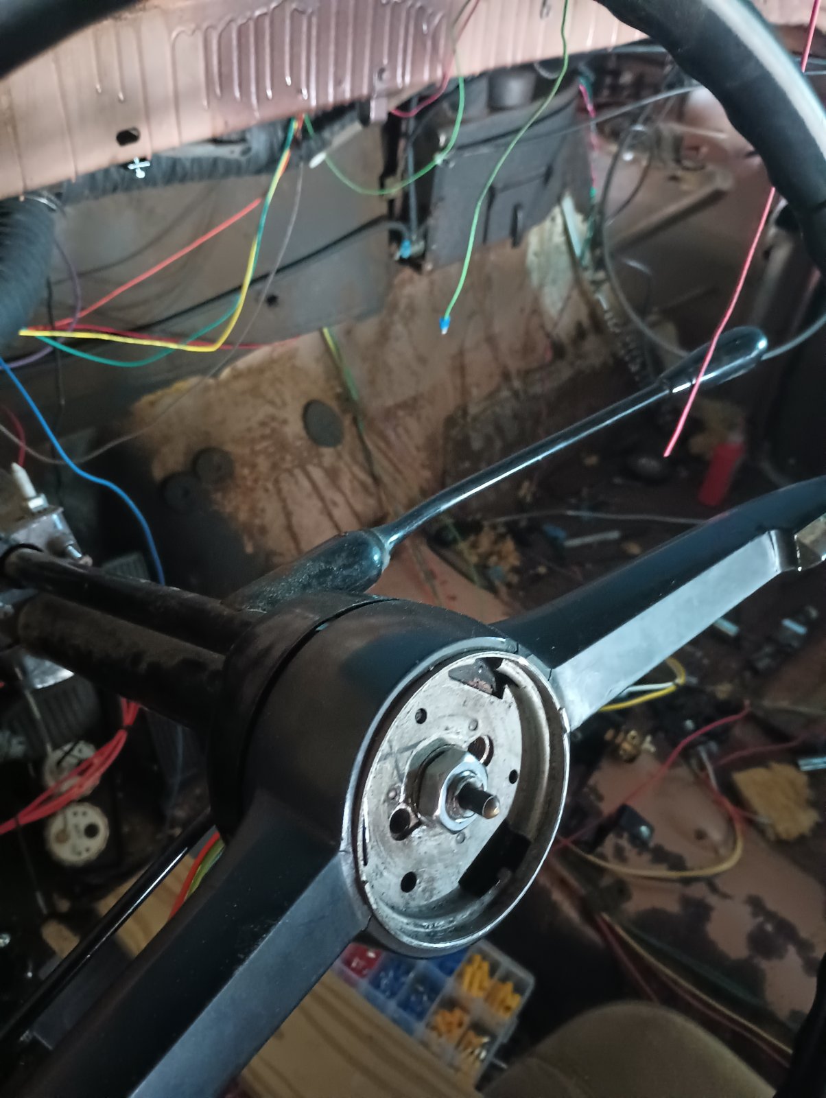

    I've hooked up a new harness to my 55 custom but I'm not getting any turn signals. I've tried to hook them up in different but nothing works. When I use the turn signal the light just goes out. The brake lights work but front and back turn signals do not. What am I missing to make these functional? And is there a way to convert to the push and twist style bulb sockets or no?

    Without seeing how you have it connected, it's really hard to help you. More description, pictures, etc will help.
    Like...what turn signal switch does it have? What color wires on the harness are connected to what color wires on the switch? Things like that.

    I don't know if this helps at all. I can take more pictures if needed. Yes ford customline. Sorry about. IMG_20240802_142239333.jpg IMG_20240802_142212341.jpg

    I see a bit of the cheap quick connect terminals. If you followed the installation manual and your confident in that. I'd probably probe and make sure you have good connection on everything. You have a picture of how you have the relay and bulbs wired?
