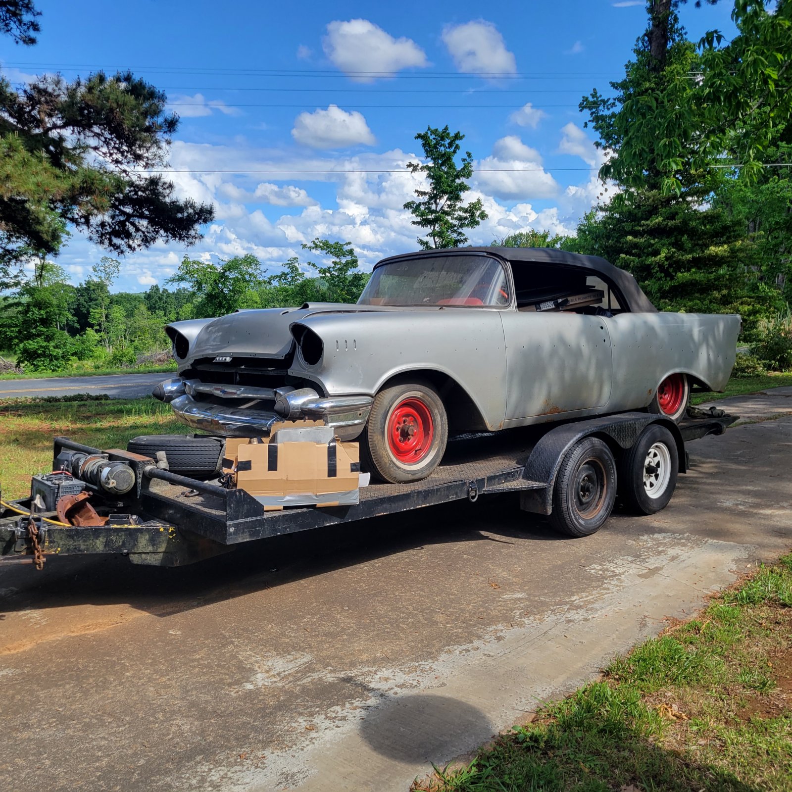

    I picked it up 5/14/22. I was amazed at all the "stuff" with it. There were numerous "race parts" he had bought when he was driving it that never got installed and at some point he started collecting NOS parts to restore it - even though most of the OEM stuff is in awesome shape. Some items he collected multiples. I loaded the car to over flowing, the bed of my truck to over flowing, and the back seat area of my crew cab to over flowing.
    And while loading only really saw a fraction of the parts.
    I got it home (actually to my father's as I'm in the middle of moving and don't have a garage built at the house yet) and started going through the car and parts.

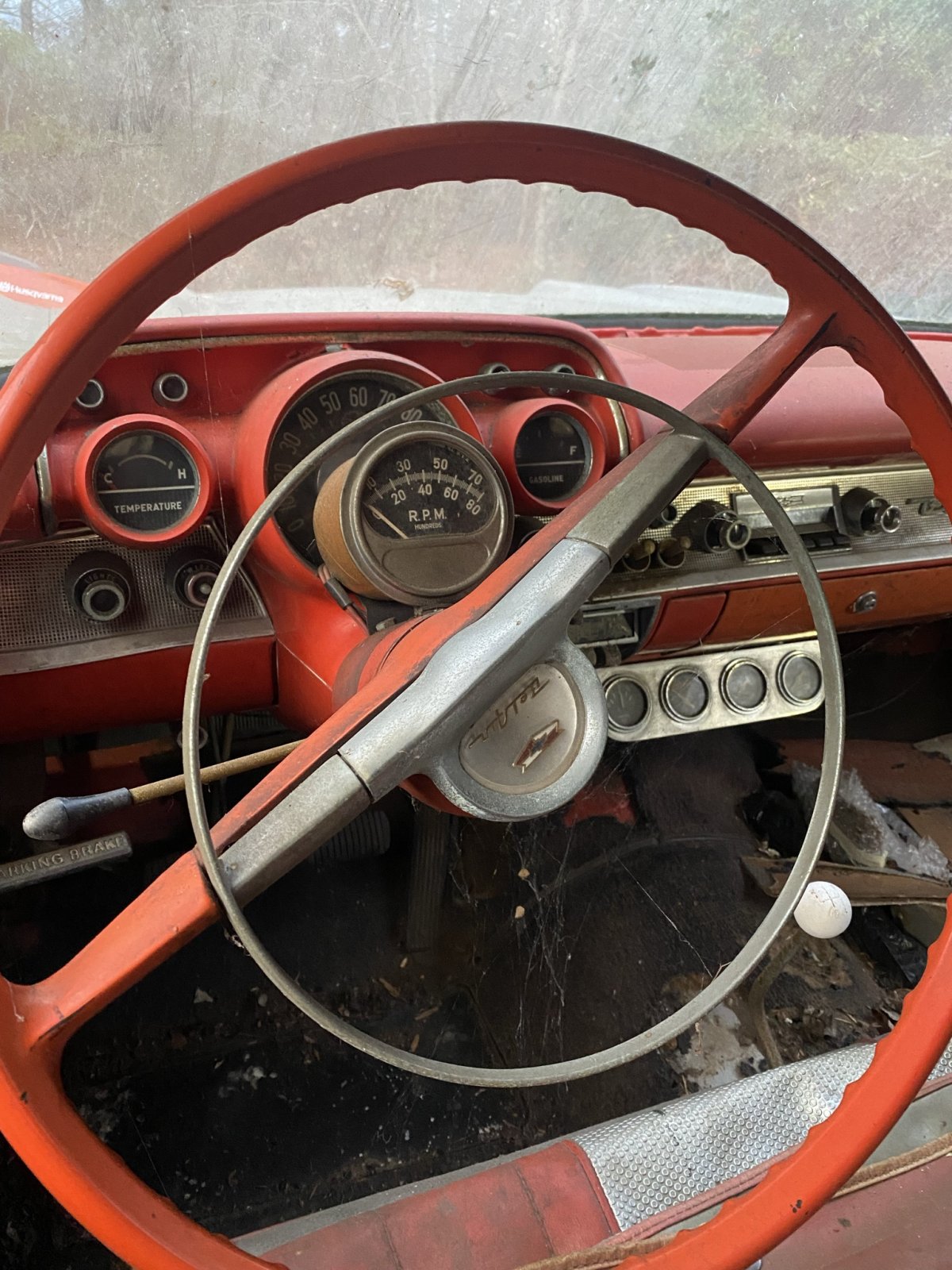

    So...as I got into the car, I started uncovering the "drag racing" history. A lot of the stuff I didn't see when loading or took the time to dig into, but reinforces he was about speed:
    1. Tubular traction bars
    2. Battery relocated to the trunk
    3. Racing "harness" lap belt with eye hooks mounted to the back floor
    4. Blocked off 3-speed floor shifter location and BW T10 4 speed with a Palmini Engineering ****ter shield

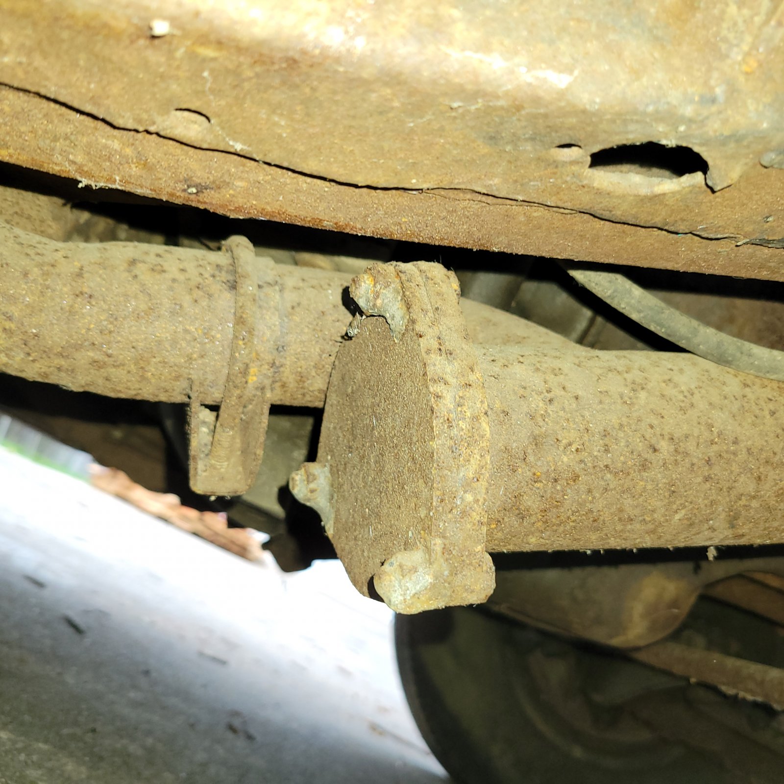

    5. Early headers with block off plates to uncork at the strip
    6. Early performance shocks (I have been told they may be Corvette Delco 411 shocks but can’t find pics to compare and haven’t been able to get a good pic of the stamping)
    7. 1950s Sun Tach
    8. SW accessory Gauges
    9. Additional dash switches - haven't traced but potentially to cut tail lights/brake lights (time will tell)

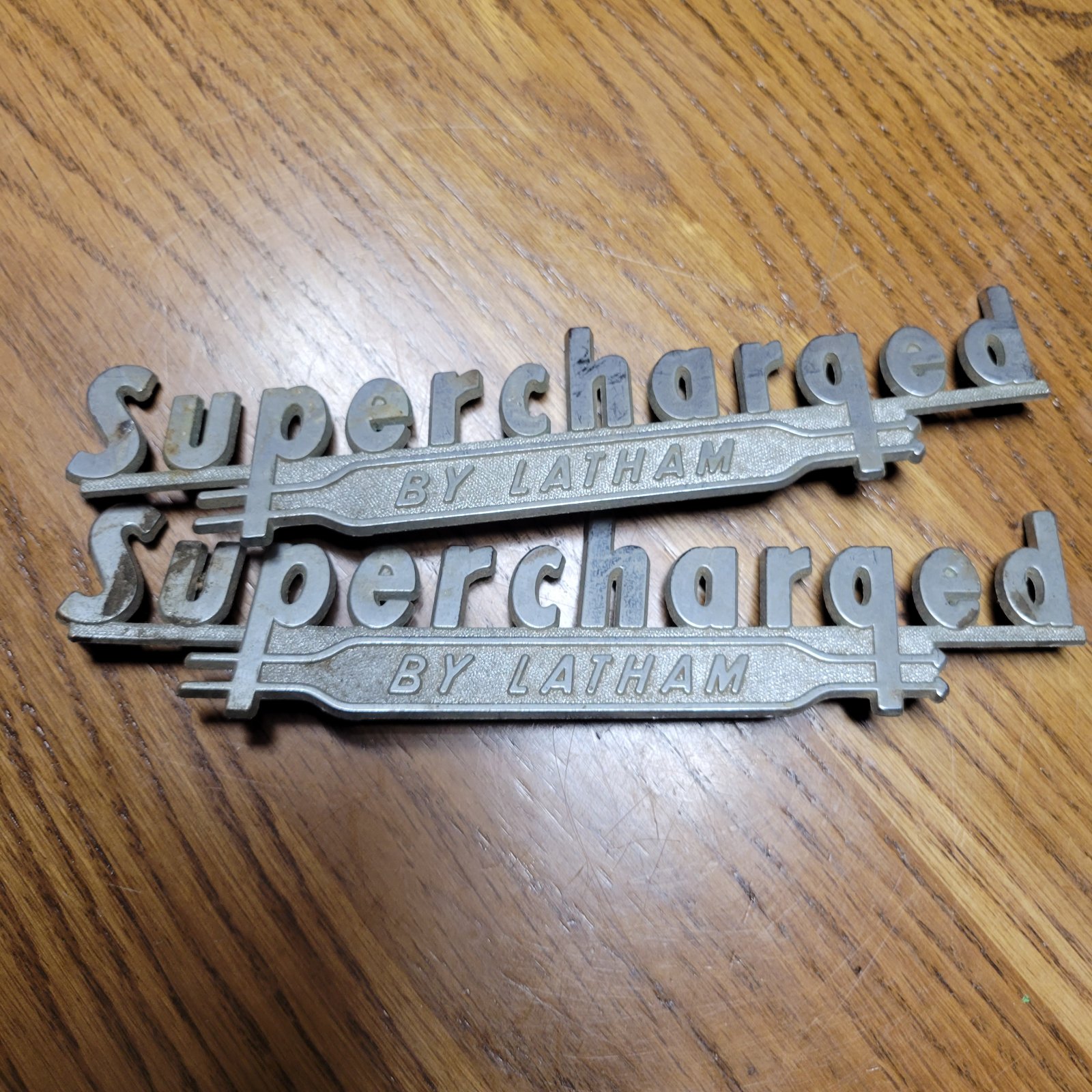

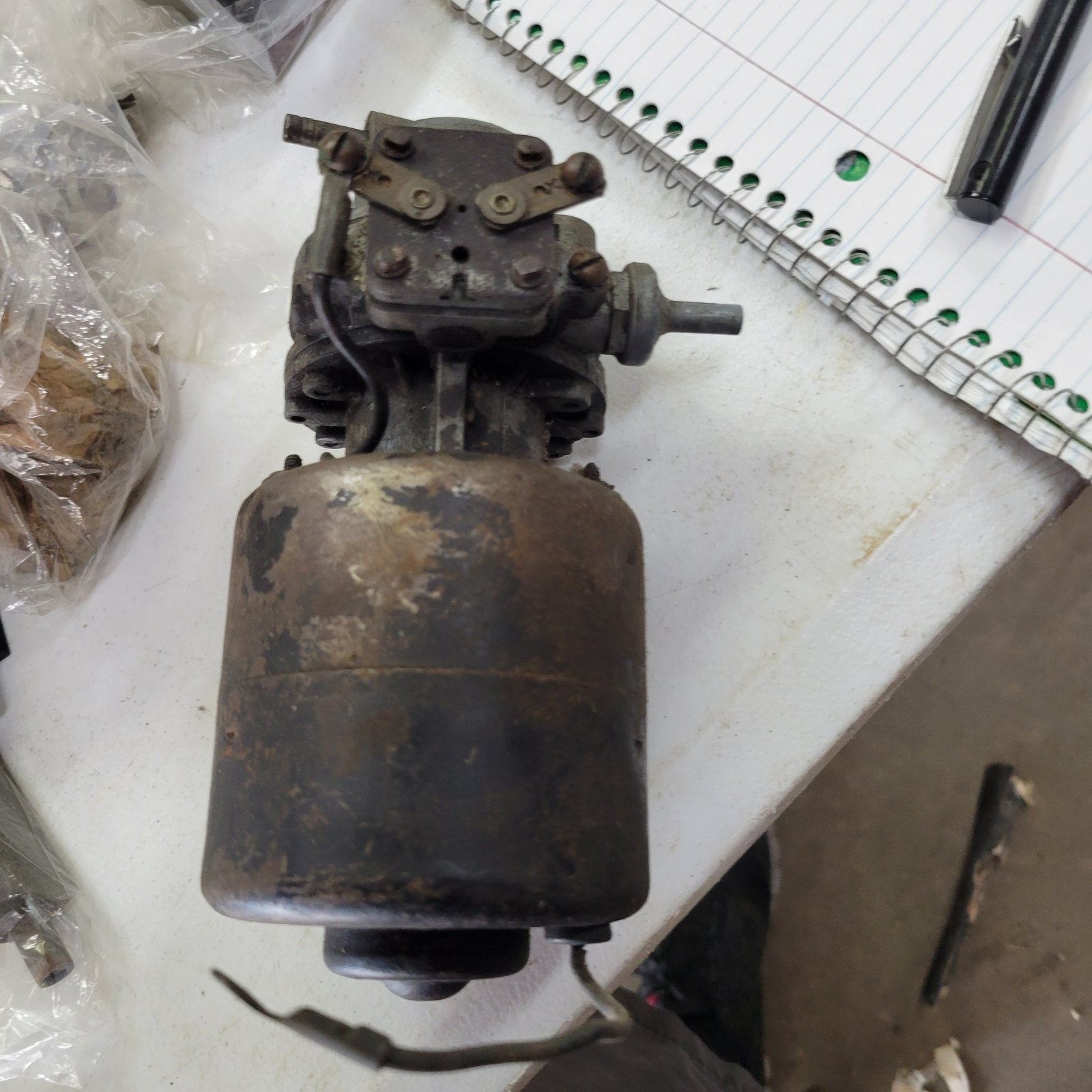

    And then I started going through the boxes and boxes of parts:

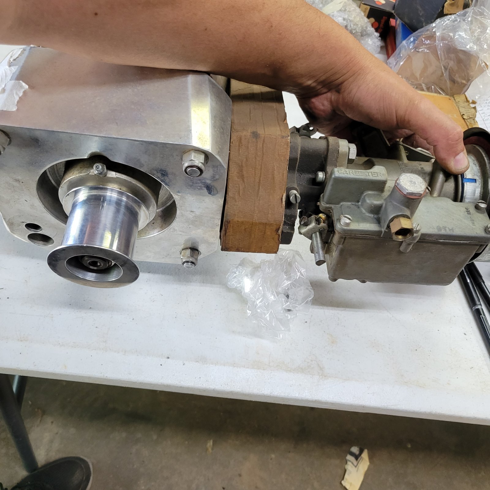

    1. Complete Latham Supercharger new in box (ok, I saw this when loading) with all hardware, pulleys, original belt, YH sidedraft carbs, modified fuelie intake, block off plates...and really cool "Supercharged by Latham" cast fender scripts
    2. What I believe is the original fuelie 4520 unit (cracked) with all parts but the "throttle body" and everything to rebuild it. I have to go back for a Model A I bought, so hopefully I'll find the missing part
    3. A bonus fuelie 4800 unit complete

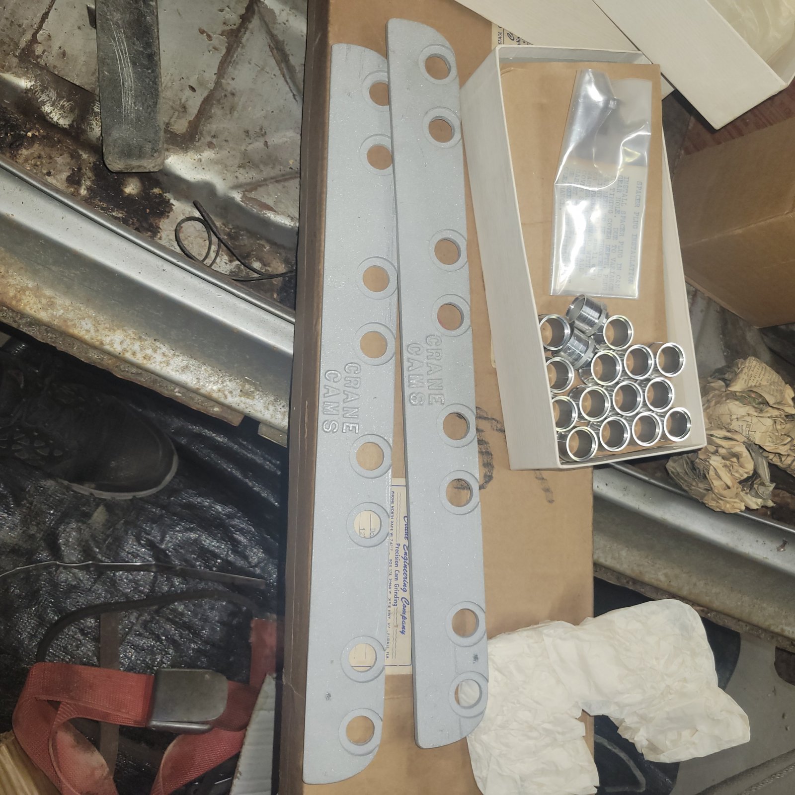

    4. 1962 “Hi-Rev” R-266-BL Crane Cam with rollers and cast rev guides, and then-brand new Crane-worked Corvette “fuelie” 461X heads new in boxes (shipping value from Crane at $500 in 1962!)
    5. Segal fuel distribution block
    6. Hildebrandt fuel pump block off plate
    7. Marvel Mystery Oil Injection setup
    8. 2 other Fuelie intakes (3768233 dated 4.2.62 and another that I don’t have the numbers available)
    9. An early "Capacitive Discharge Electronic Ignition" - need to research more

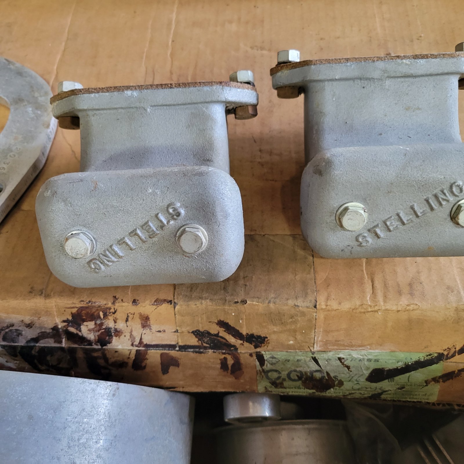

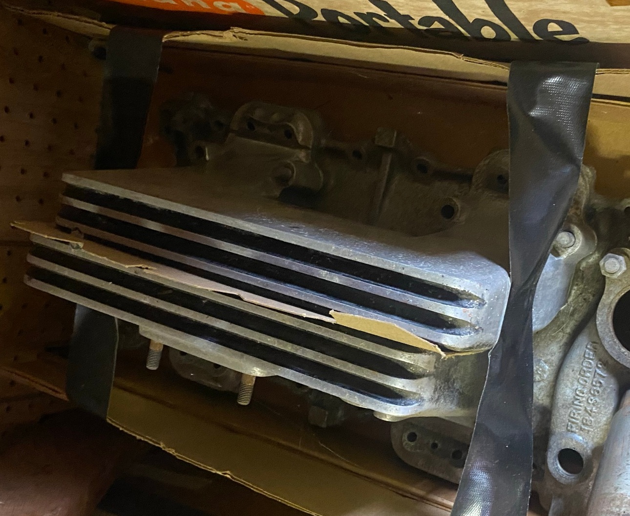

    10. Never installed Stelling cast breathers
    11. Never installed early battery disconnect
    12. New never installed 2-pod SW Pressure gauges
    13. An add-on “race belt” with reinforced eye-bolts and latches to add a seatbelt while racing
    And so much more...

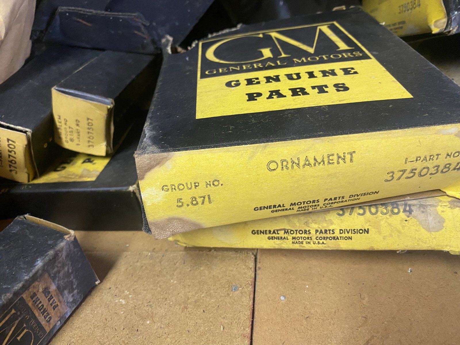

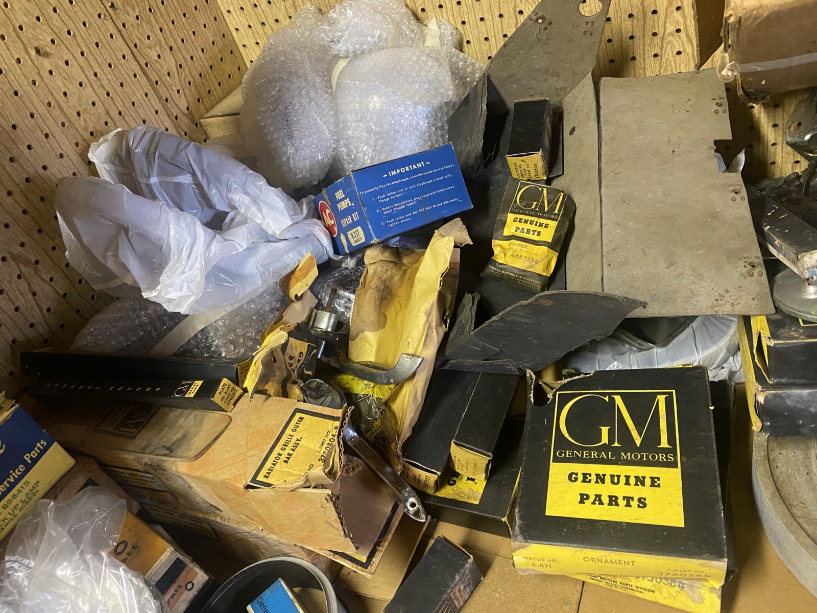

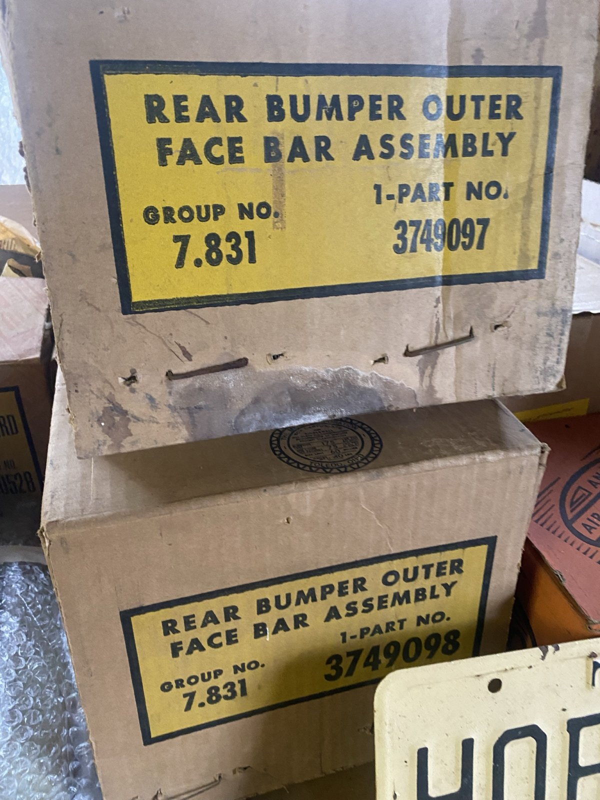

    And then there's the NOS stuff...2 pages I cataloged in a notebook and I didn't write down everything yet. From trim (I think everything but the outside door handles) to complete bumpers, grill bars, etc.. Some things there are 2 or 3 of...

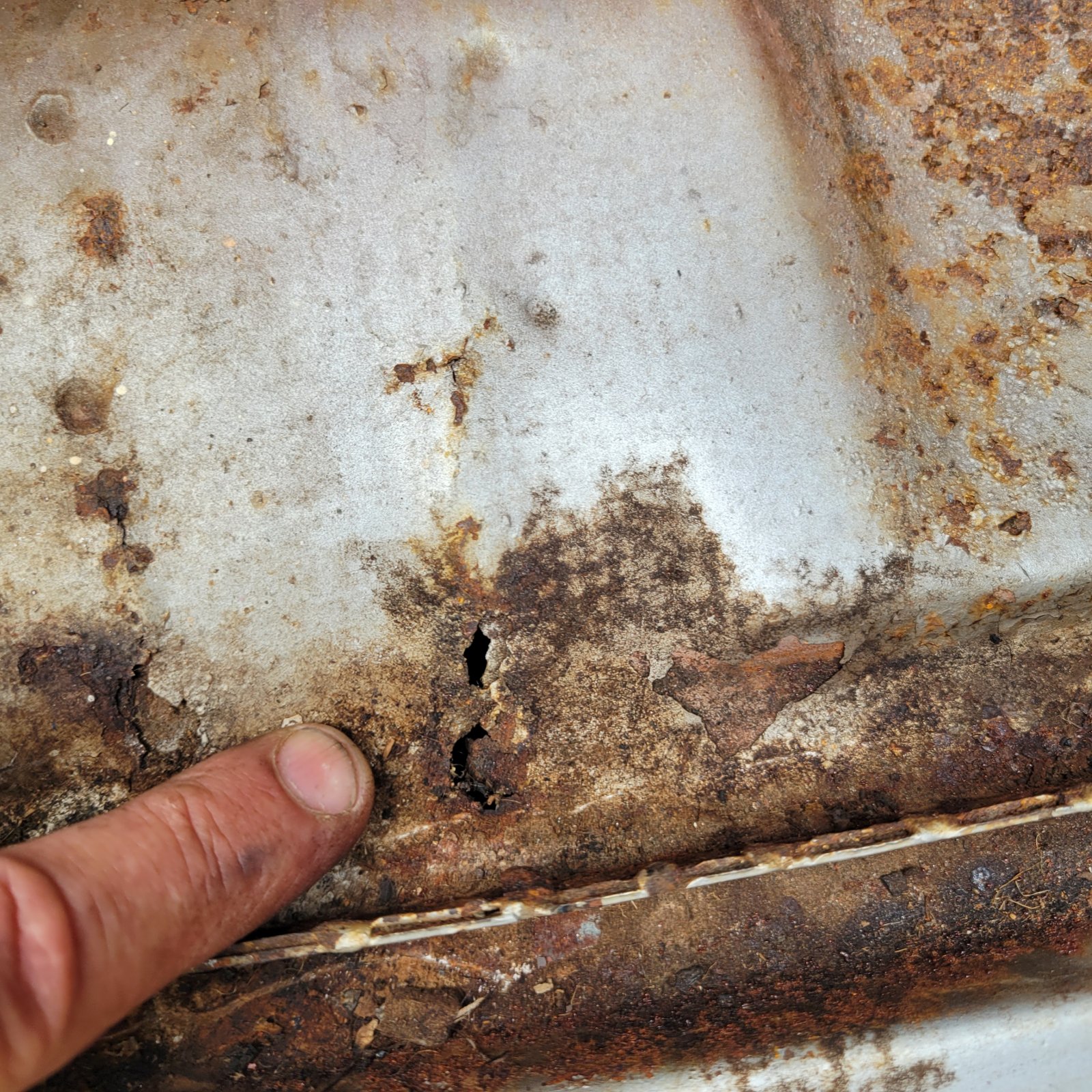

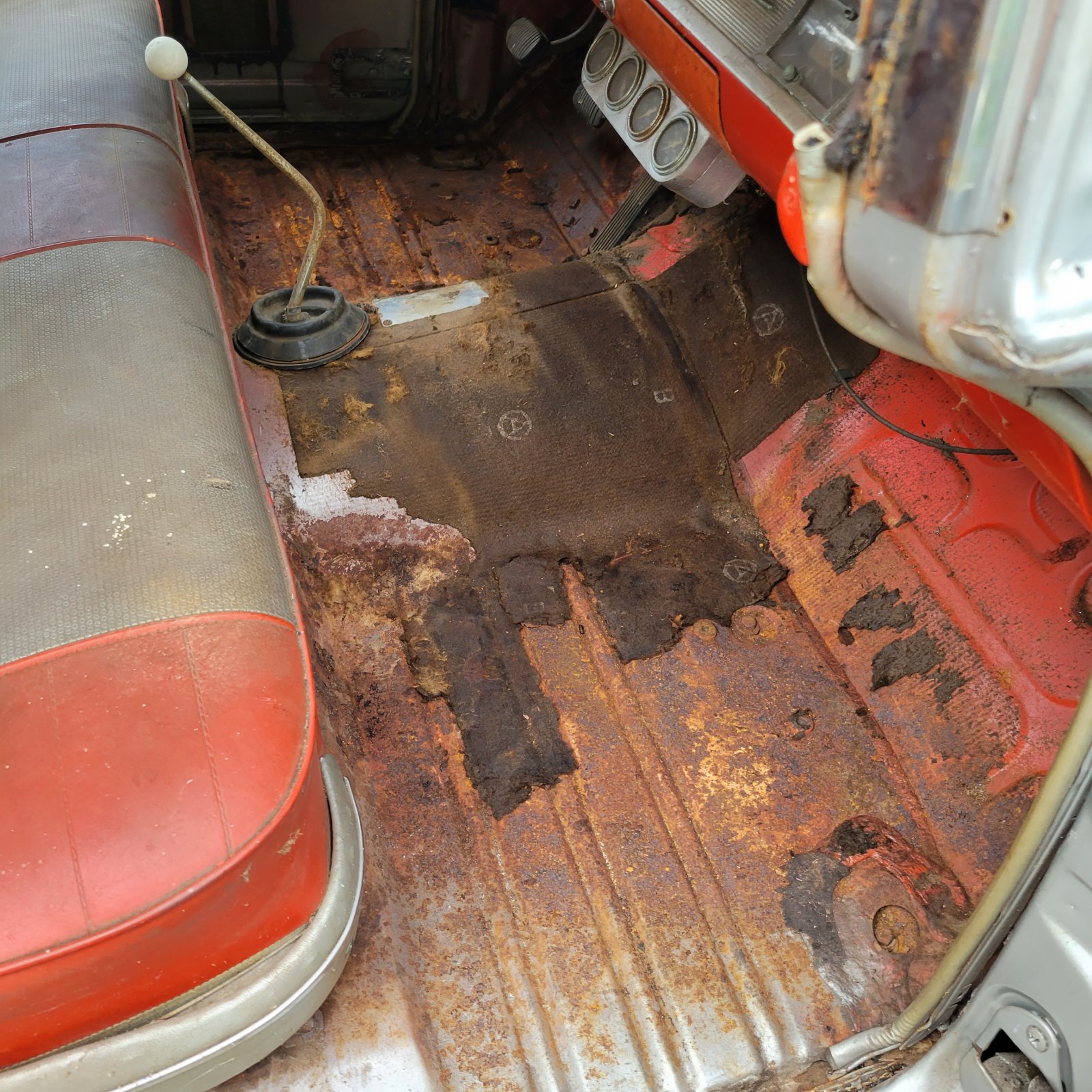

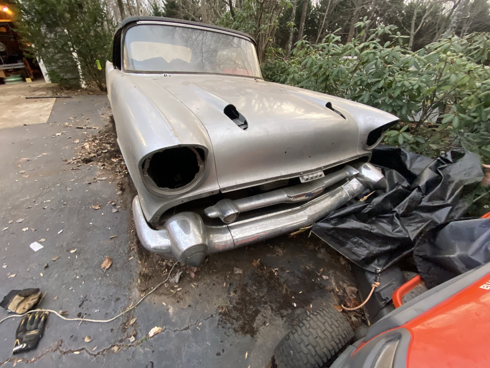

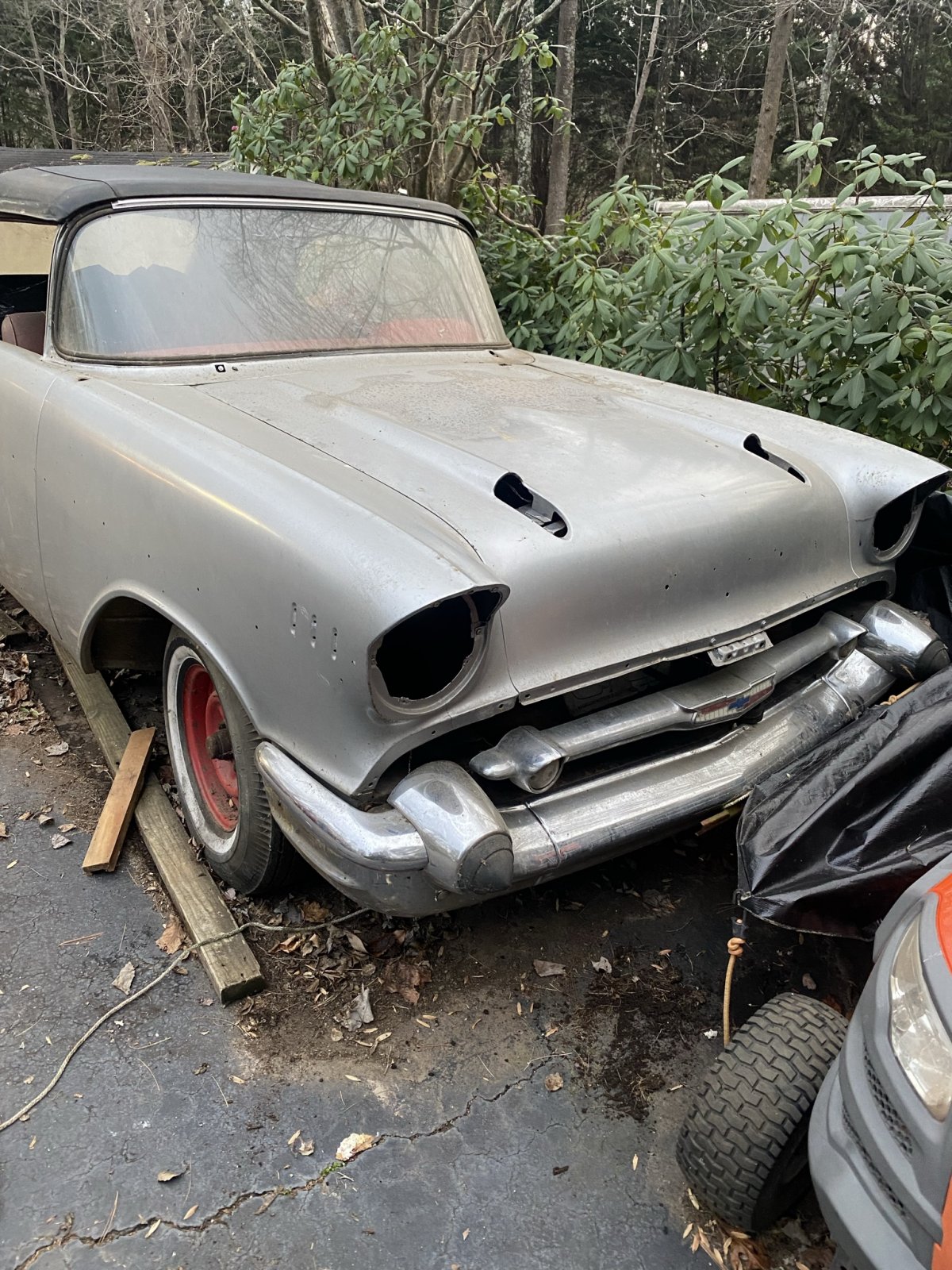

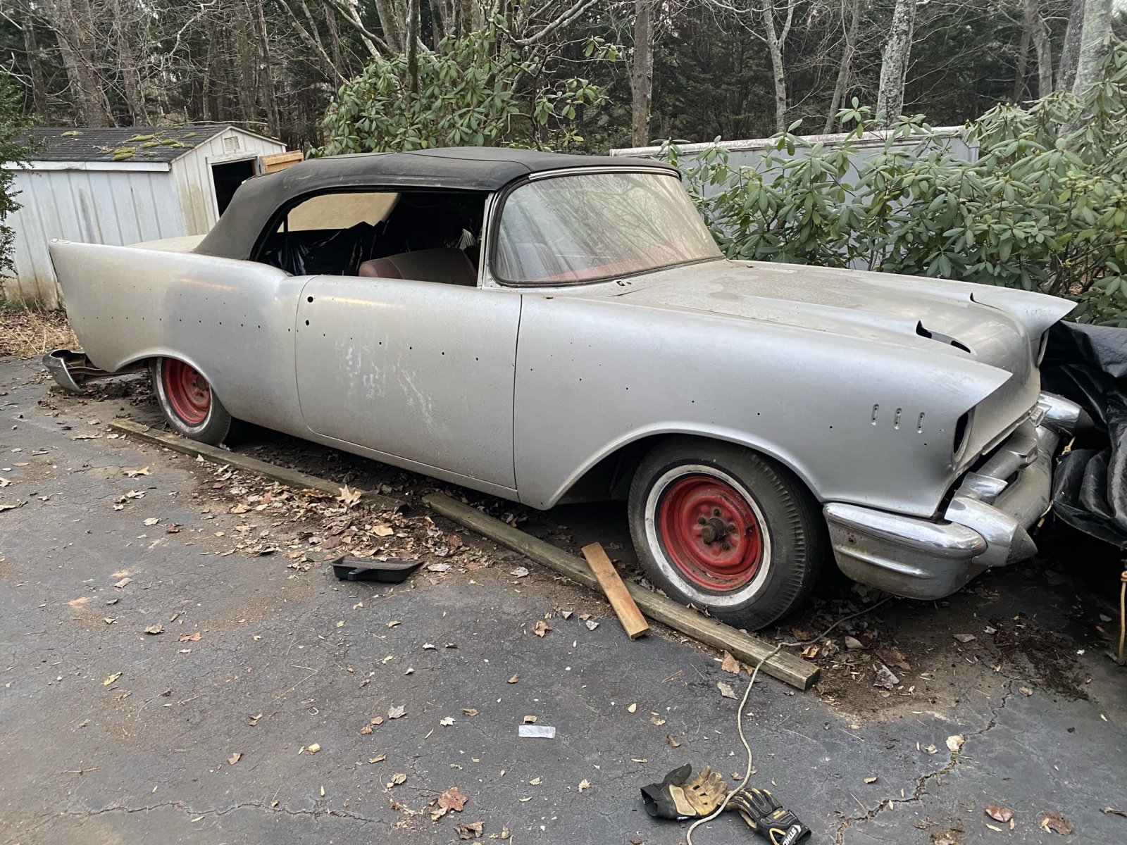

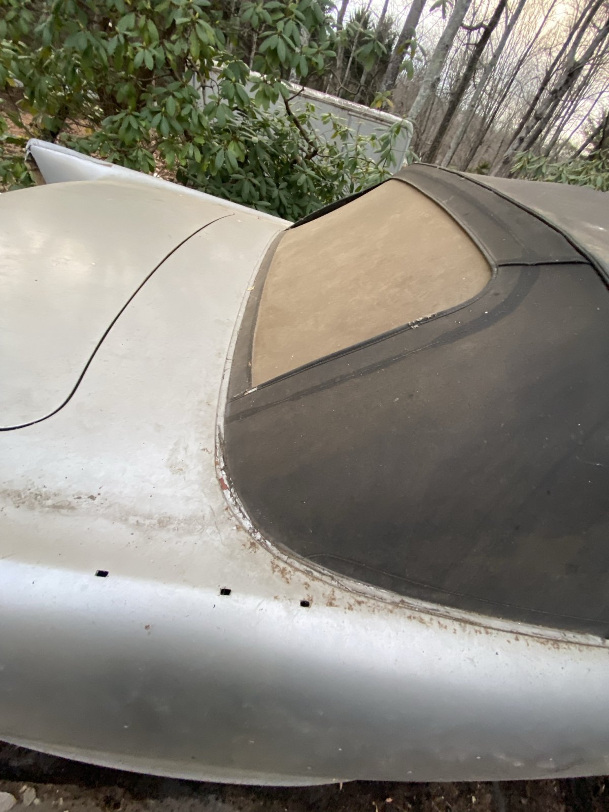

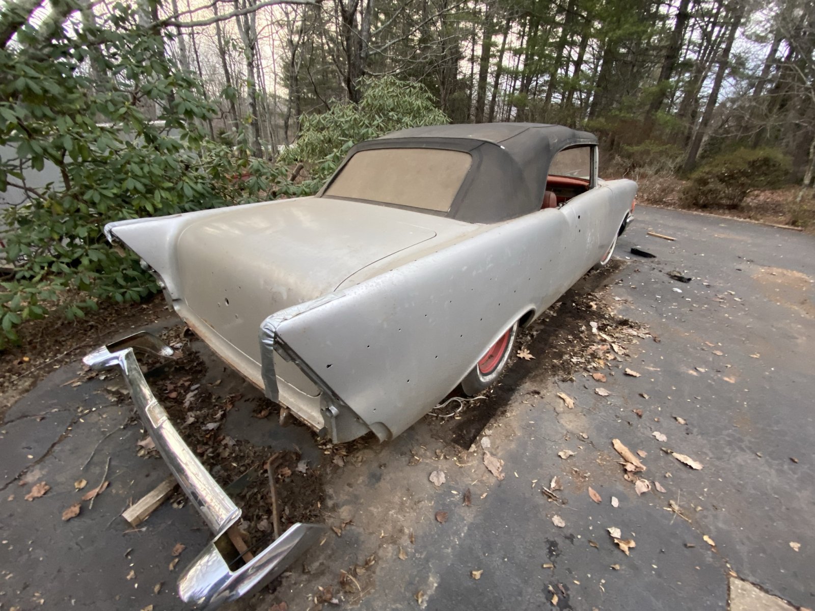

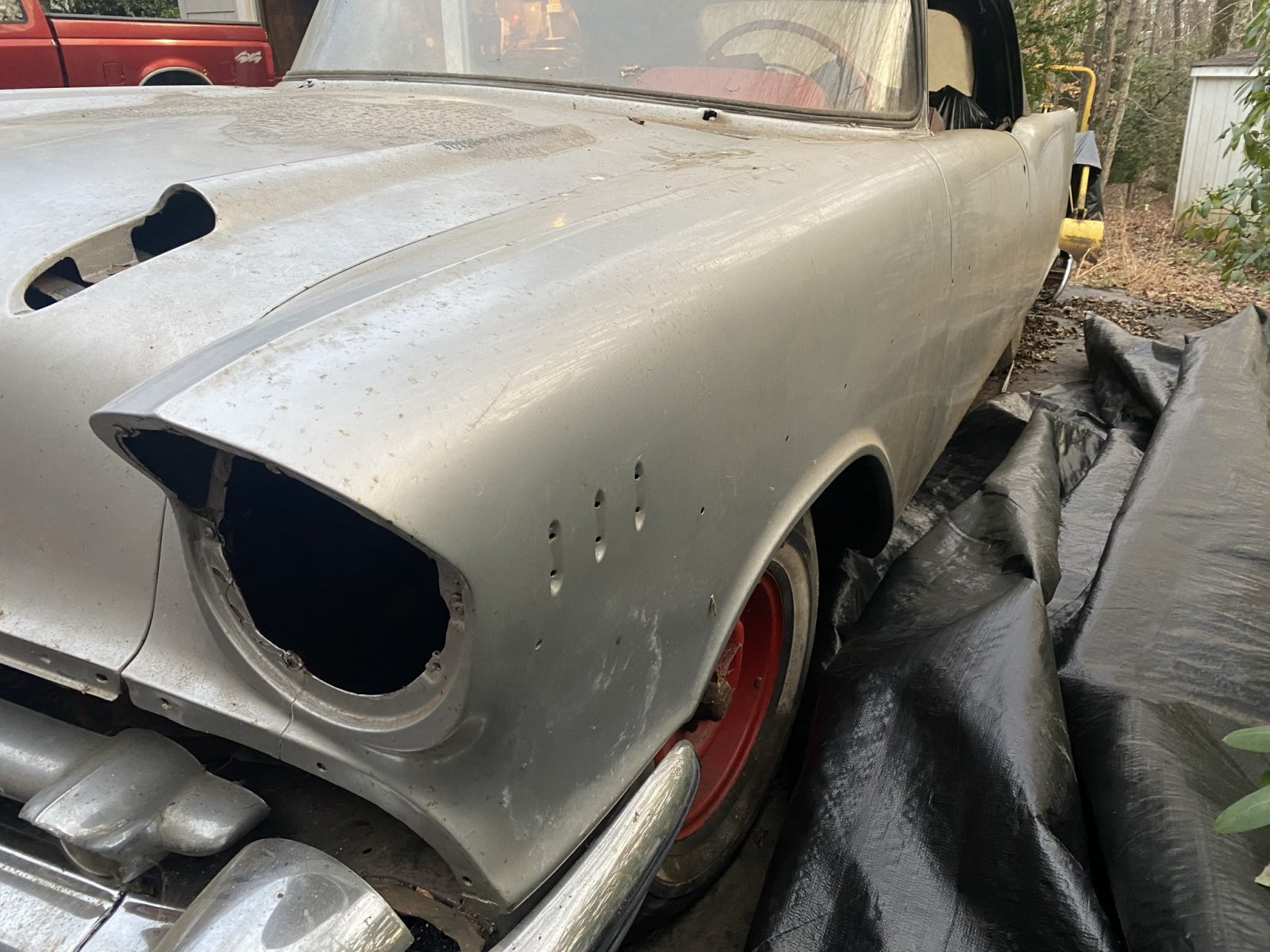

    And then the car. It's essentially untouched other than the repaint. The top is original and salvageable. The seats are in great shape other than 1 hole on top of the driver's seat. The one rust hole on the whole car (on the p***enger floor near the door sill) is about an inch long and 3/16 wide.
    As for the Fuelie...I've chatted with experts and did my share of sleuthing. It has the original 1/8" script/badge holes. Later holes were larger. I have the electrovac, the fuelie 4520 unit with a serial in alignment with production date, distributor, the 3/8" fuel line, original badges, vacuum wiper ***embly...everything but the right engine (it's an auto application and this car was clearly always a manual). I think even the cracked fuelie/missing air valve and all the rebuild parts (including the small wiring harness) aligns with the fire under the hood...potentially a big backfire...
    I’m not a ‘57 guy. But a convertible is sort of cool. A potential fuelie is even cooler.
    But a 1957 Fuelie Convertible used as a weekend drag car...pretty damn awesome in my book!

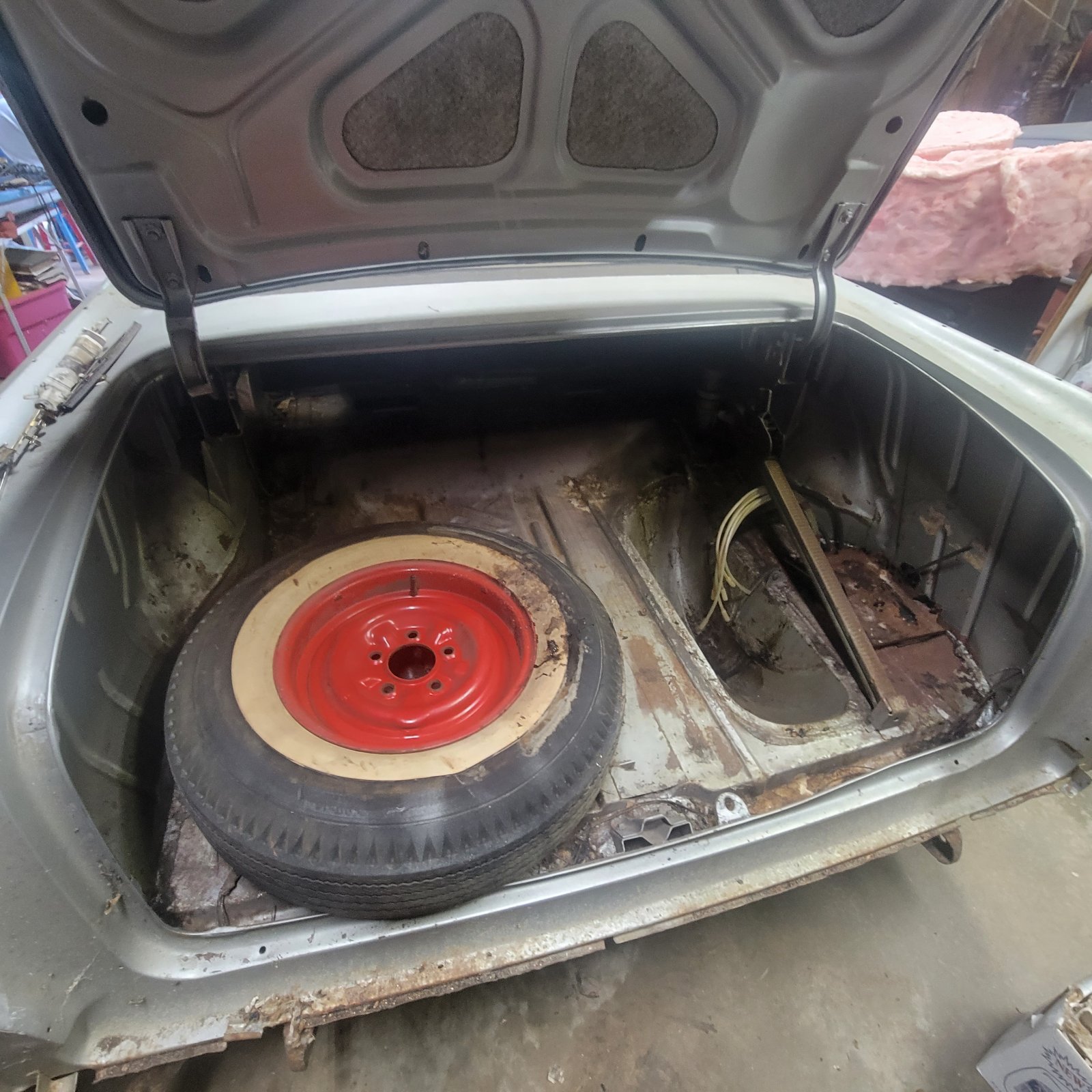

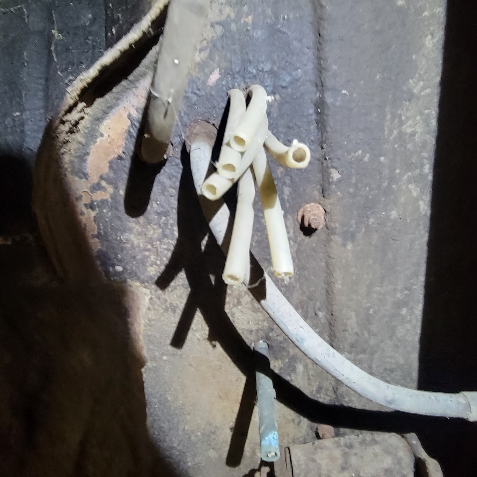

    I’m still trying to figure out a few things...like the 8 plastic hoses in the trunk! They are cut off under the car so no idea. My initial reaction was air shocks...but 8 hoses! I haven’t checked out gear ratio in the rear...I’m working too much and being at my father’s is a little inconvenient when I want to sit in it and make zoom zoom noises...

    Counted the white plastic tubes - how about outside vents for the 6 caps on a tar top battery ?

    I think I would frame that Latham box and the Crane Cam packaging and hang them on the wall like high art. Those might be the only surviving examples of those packages left in the world.

    I think this is a solid theory.

    You know...I thought I had counted 8! Perfect explanation! I'll have to look up setups! Thanks

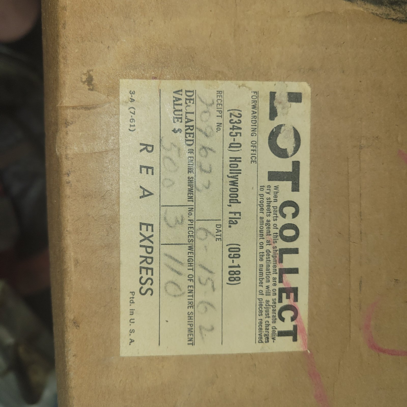

    No "ZIP" codes on any of the adresses on the boxes (pre 1964) Cool!

    The MM oil injection is to keep the Latham vanes lubed so they don’t wear out early. Yes, you do win best post and best find of the year!
