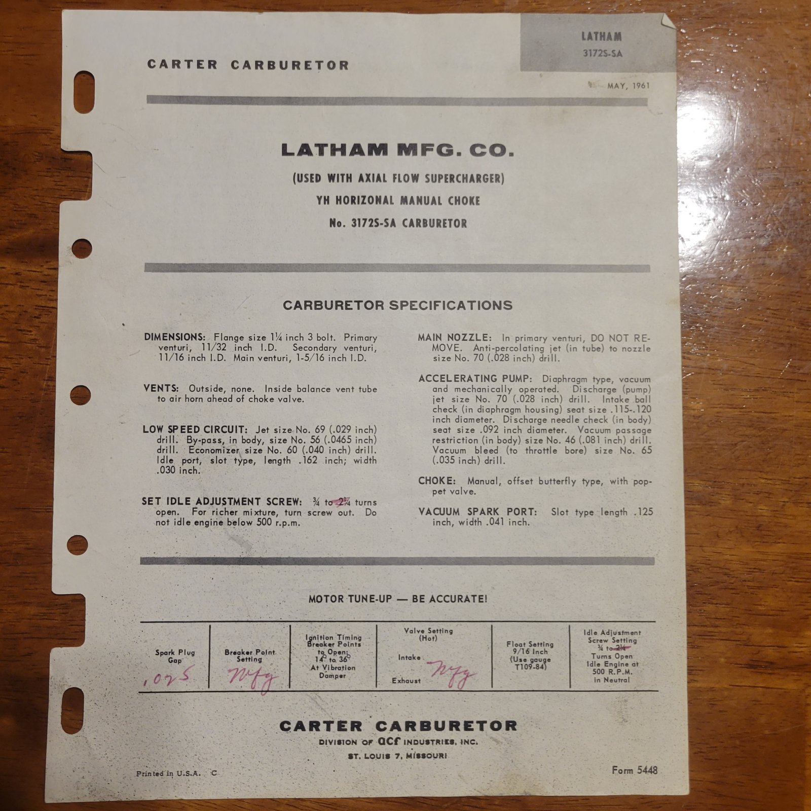

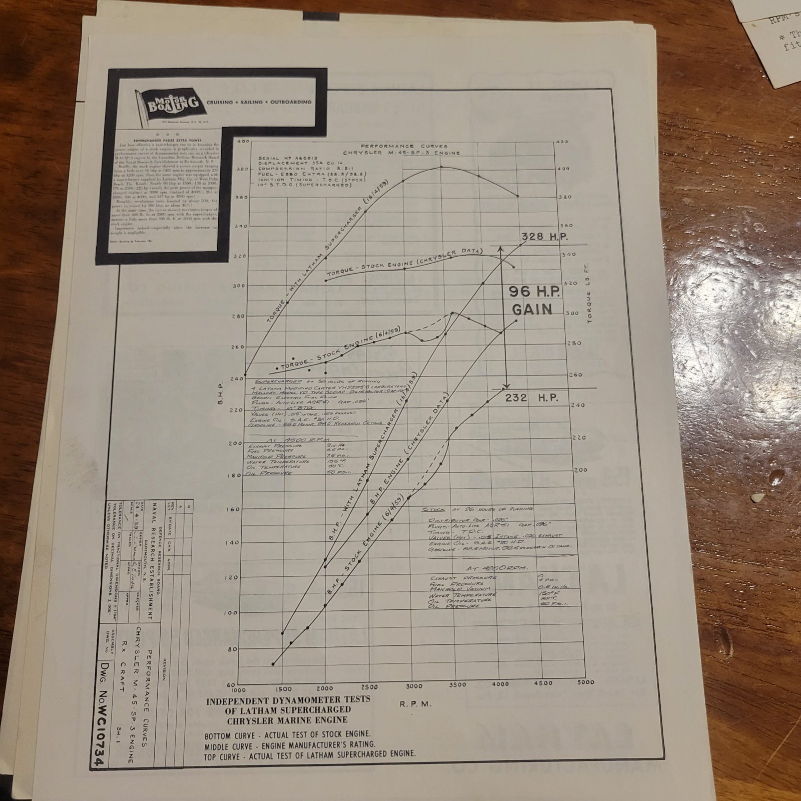

    More documents. Apologies if some are repeats...there's a lot of stuff and m multiples of some
    20220602_205216.jpg 20220602_205222.jpg 20220602_205226.jpg 20220602_205232.jpg 20220602_205239.jpg 20220602_205250.jpg 20220602_205257.jpg 20220602_205304.jpg 20220602_205324.jpg 20220602_205330.jpg 20220602_205342.jpg 20220602_205349.jpg 20220602_205417.jpg 20220602_205425.jpg 20220602_205449.jpg 20220602_205456.jpg 20220602_205529.jpg 20220602_205536.jpg 20220602_205544.jpg

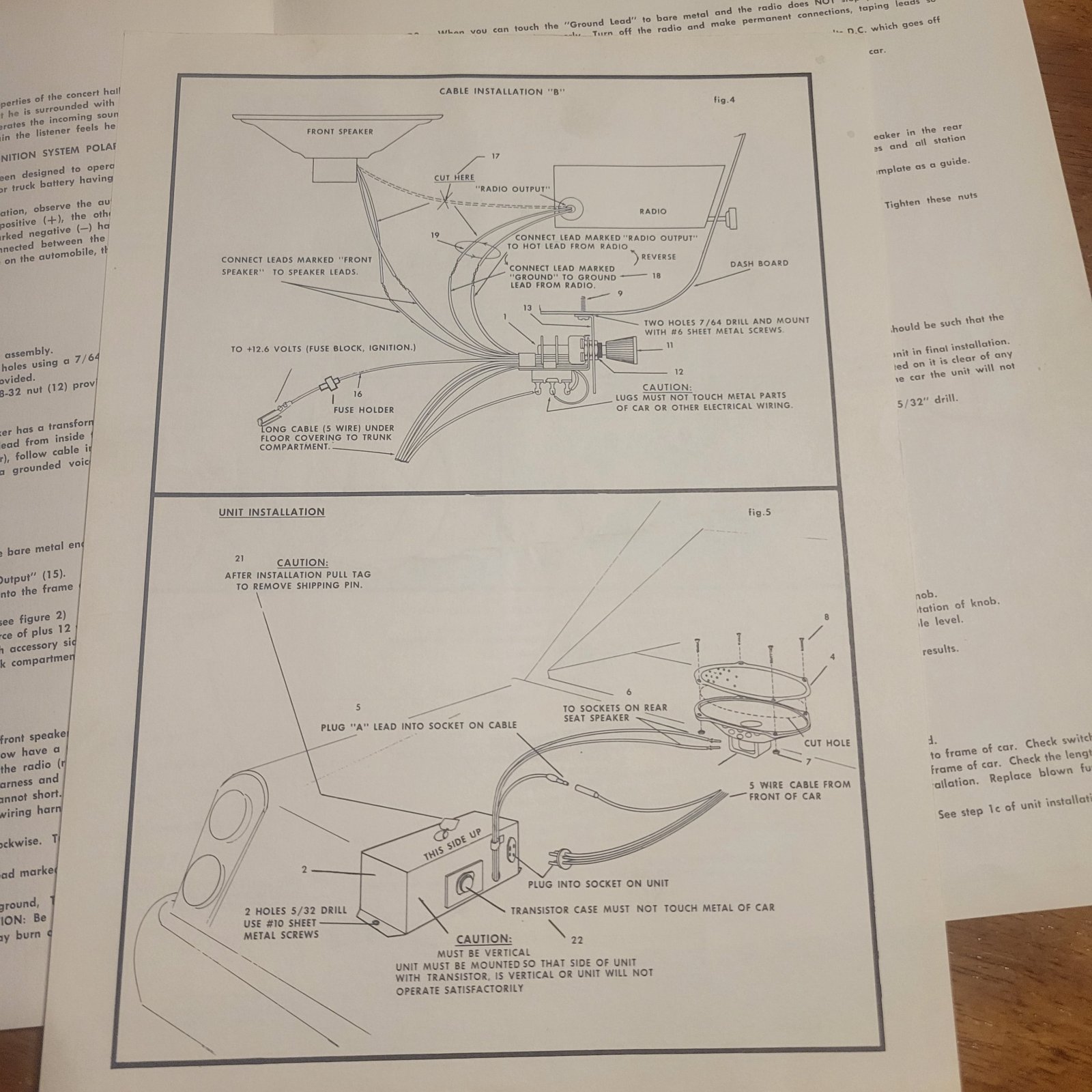

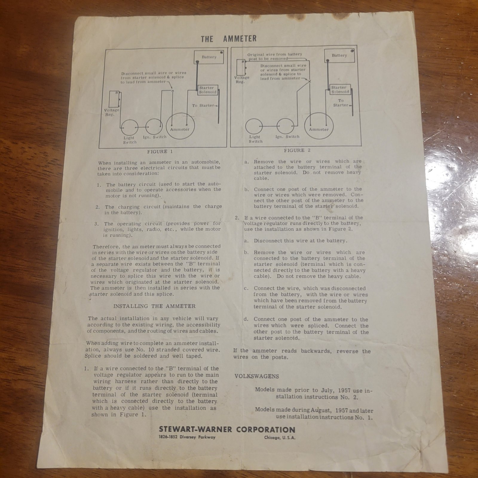

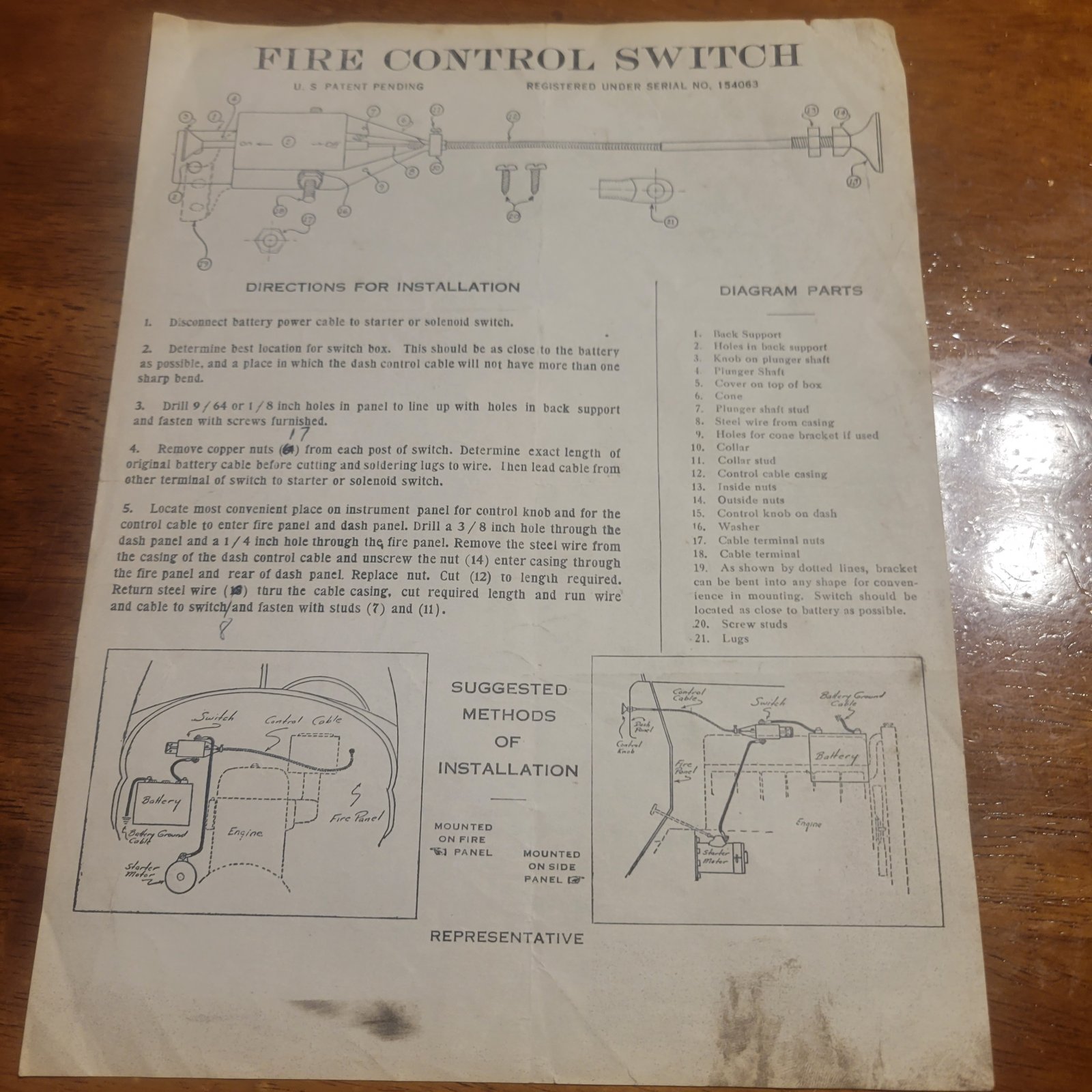

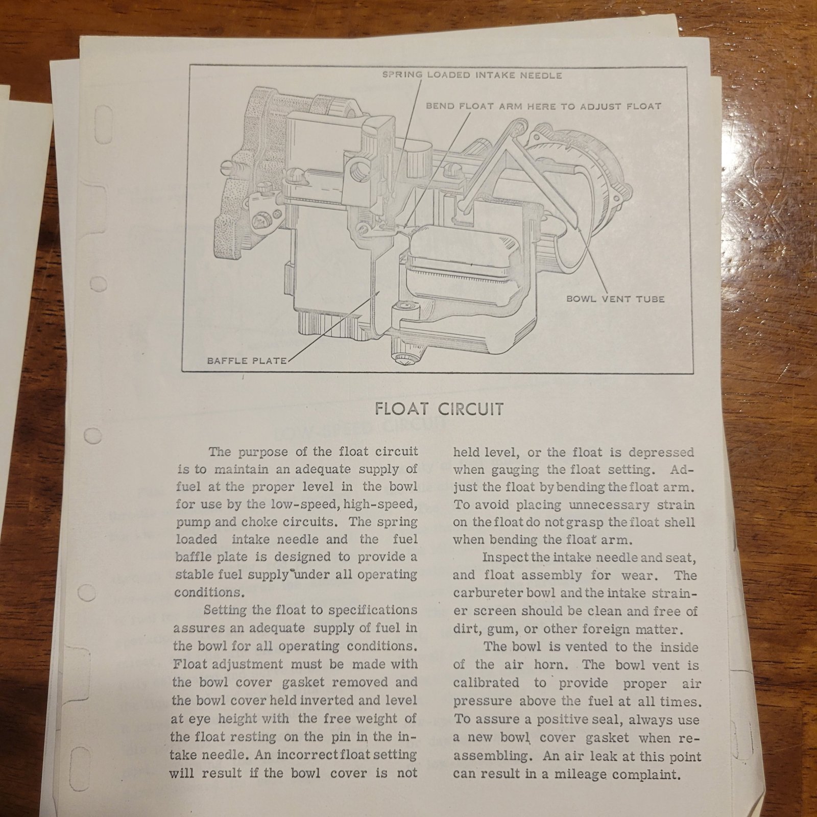

    Some of the other documentation...perhaps not all pertaining to this car. The battery kill switch is with the car and never installed. Same for the reverb unit and accessory speakers. I haven't seen any evidence that the engine heater was ever on the car but may have been removed. I need to crawl under the car and see if there's an electric fuel pump...work has kept me too busy but I have seen a lot of references to using one with the Latham.
    I'm including some of it just because it's interesting and may benefit someone 20220608_204605.jpg 20220608_204616.jpg 20220608_204629.jpg 20220608_204640.jpg 20220608_204646.jpg 20220608_204720.jpg 20220608_204740.jpg 20220608_204745.jpg 20220608_204813.jpg 20220608_204823.jpg 20220608_204827.jpg 20220608_204834.jpg 20220608_204858.jpg 20220608_204933.jpg 20220608_205013.jpg 20220608_205023.jpg 20220608_205028.jpg 20220608_205033.jpg 20220608_205039.jpg 20220608_205048.jpg

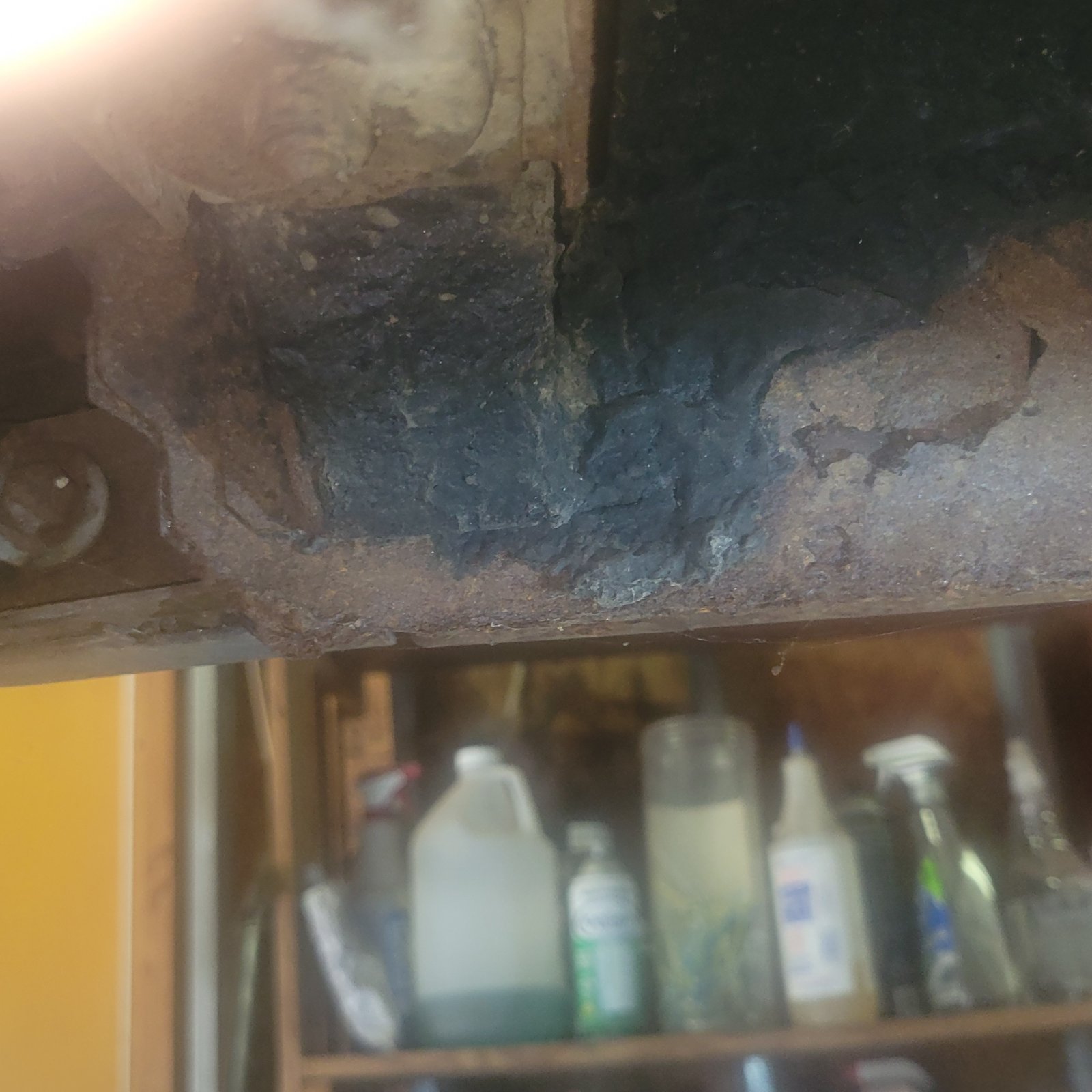

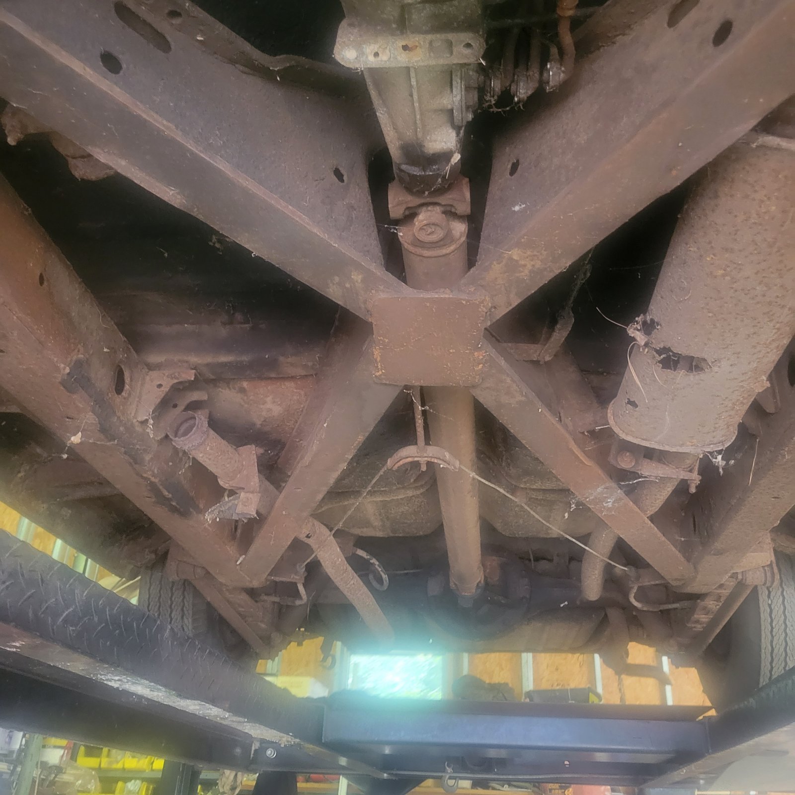

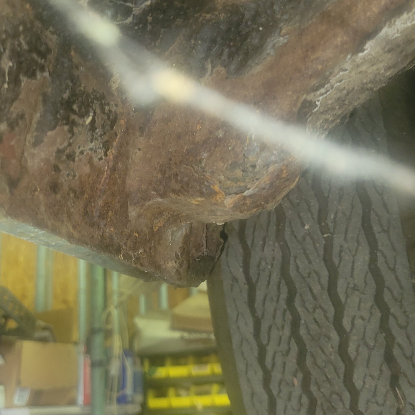

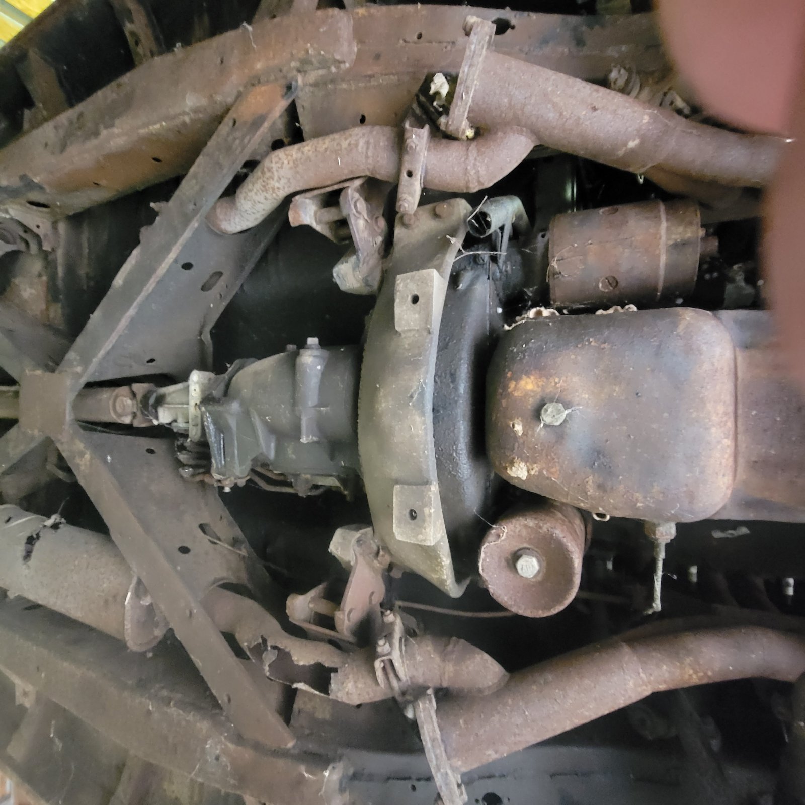

    Finally got a chance to get the car up on the lift. I found 2 minor rust spots...one on the inner face of rocker panel at the front and one spot on the dog leg support just forward of the rear wheel well.
    I was able to get a good look at the trans...1962 T10 from a Corvette. Has a tag on the side cover with HH...all my searches haven't revealed what HH represents, but I have found other posts of people asking about the same code.
    The differential is an early non-x, non-P posi (January build) that decodes as a 3.36 rear. However, the gears are 4.11s. Looking at the Z bar, mount welds are a little bubble gum-ish...so with the 3.36 I'm thinking it may have been an auto originally. However, there is another late '56 built empty hogs head that is a non-posi 4.11 that decodes to 3 speed manual with OD. I'll have to look for remnants of mounting for an OD pull cable.
    I'm a little surprised there is not a rearward mount on the T10. I'm guessing the mounts at the scattershield are original trans mounts for 57?
    Overall, still stunned at the condition 20220703_155757.jpg 20220703_155817.jpg 20220703_165601.jpg 20220703_165618.jpg

    Wicked cool! A veritable gold mine... That rig is a definite keeper with few, if any, parts to buy. We trust you'll add a rear trans mount, right?

    Yes the trans mounts were on the bell housing on 55-57 chevs. The trans hangs free. I have had a bunch and it is not a problem. Most of the ones I have seen where a rear mount was added ended up breaking an ear on the trans

    Is that an oil temp sender or an oil heater in the oil pan?
  19. flamed34
    Joined: Dec 30, 2009
    Posts: 818
    flamed34
    I believe oil temp...there's SW gauges for each.
