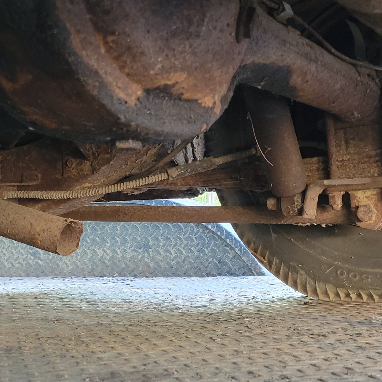

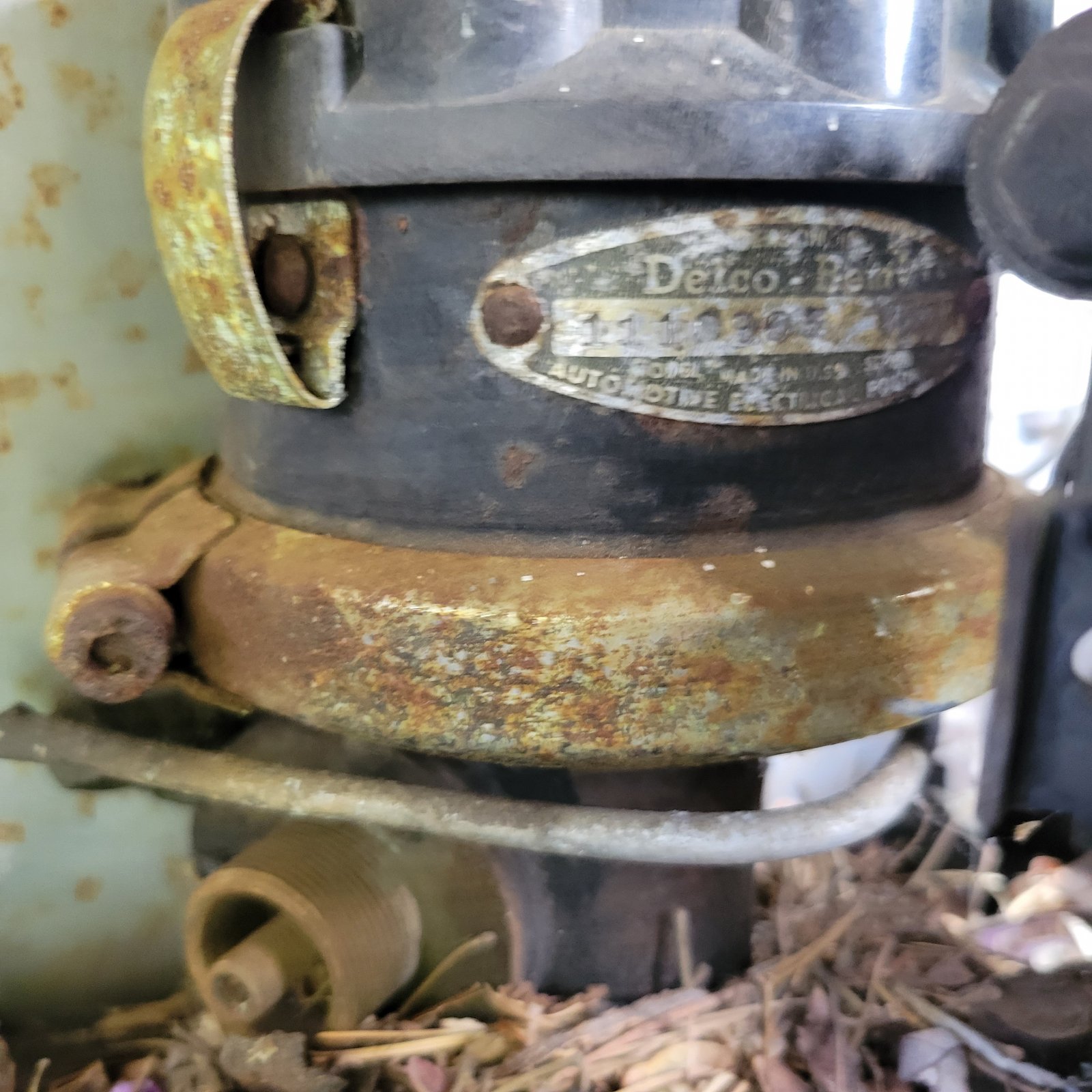

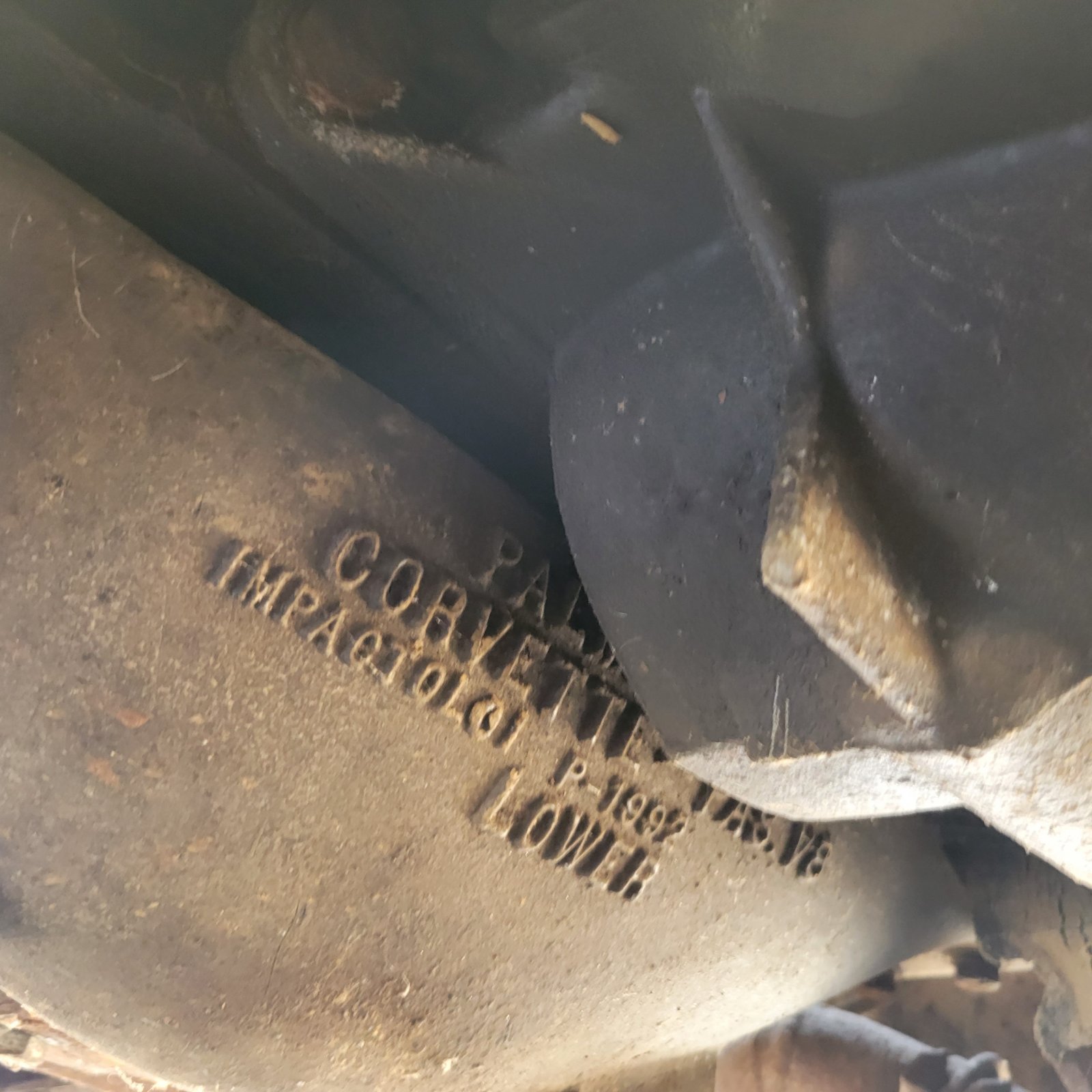

    This post really get's me fired up to get my recent purchase in my shop and examine in closely and see what I really have. All I know is that 10 or 15 years ago it allegedly sold at a Me***s auction and at some point later it had a short by the starter and it burned the dash and interior out of it. It was a restored car and still has the single well master cylinder and what appears to be the original 283. I'm currently in the middle of a 31 coupe build and as soon as that's done I have an original bodied 32 three window that I need to get back on and finish. Once those two are done, I can get on the 57. The floors are solid it has the one piece bumpers so there's no telling what it came with new.
