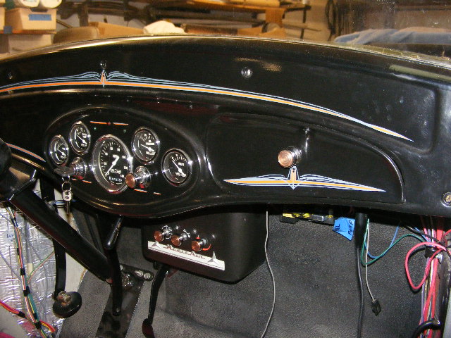

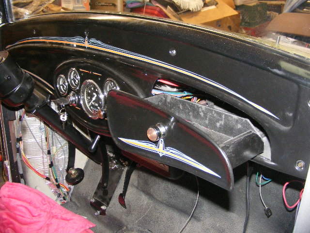

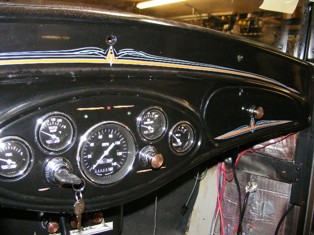

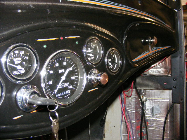

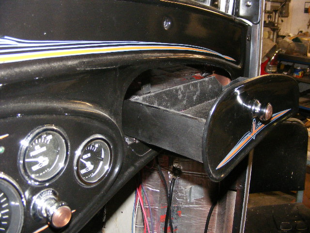

    No glove box, build one!
    1934 Ford p/u, pull out glove box....................
    DSCF0002.JPG DSCF0003.JPG DSCF0004.JPG DSCF0005.JPG DSCF0006.JPG DSCF0007.JPG
  4. HOTRODPRIMER
    Joined: Jan 3, 2003
    Posts: 65,331
    HOTRODPRIMER
    Now that is pretty ingenious!
    Ignore the pun but that is thinking outside the box. :D HRP

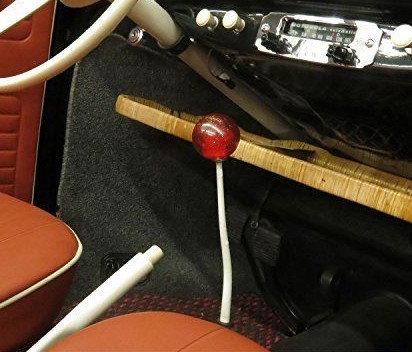

  10. In my travels on the 'net, I save the ideas and concepts that might be handy someday. This shelf arrangement is one I filed away for later. It looks like wicker with maybe a basketweave bottom?? But it would be simple enough to make one with your own twist. It could be handy to temporarily hold items on the particular day and trip, and maybe snaps or belts to hold a zipper pouch for the paperwork, etc.

    My old VW had a wicker tray under the dash also. HRP

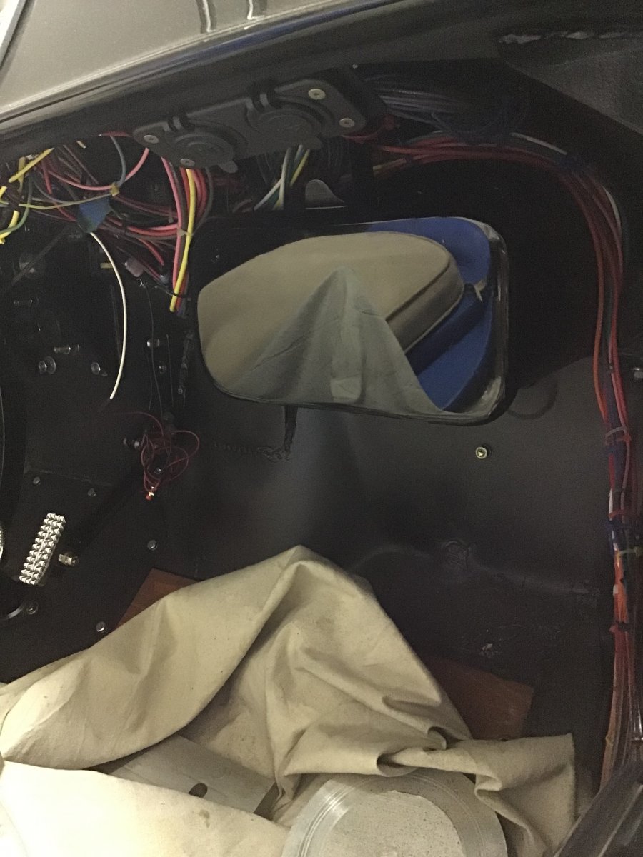

    I made one that fits under the dash on the roadster I'm building. The door is a 26-27 Model T cowl vent door painted body color. Rolled a box to shape, welded a back into it, hinged it at the bottom, cut up a 37 Ford felt glove box liner, magnetic touch latch. Sorry the pics are so poor.

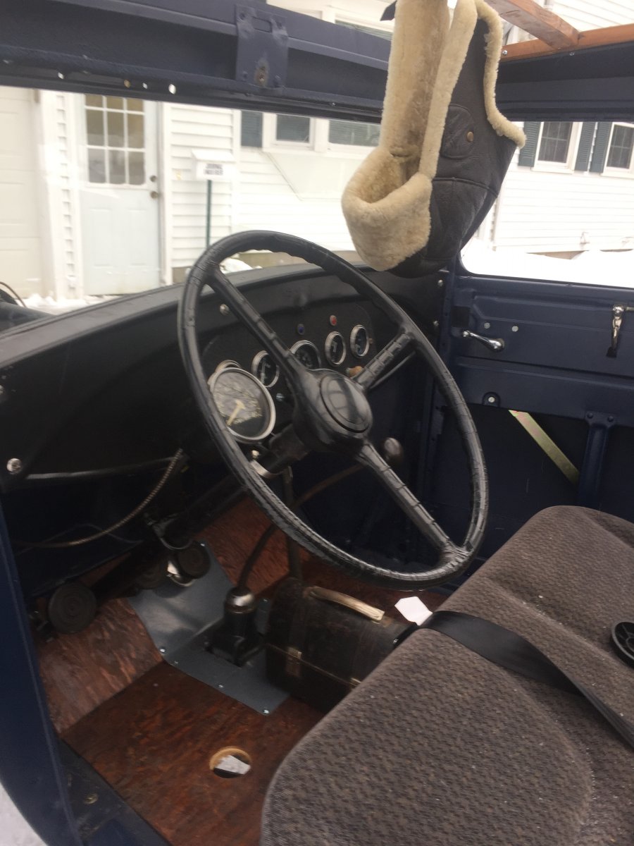

    I found this old school lunch pail in the attic of the last house I owned, that was 25 years ago now.
    Thought it was cool and saved it. When I built the car I used it for my glove box, it’s screwed to the floor behind the shifter.
