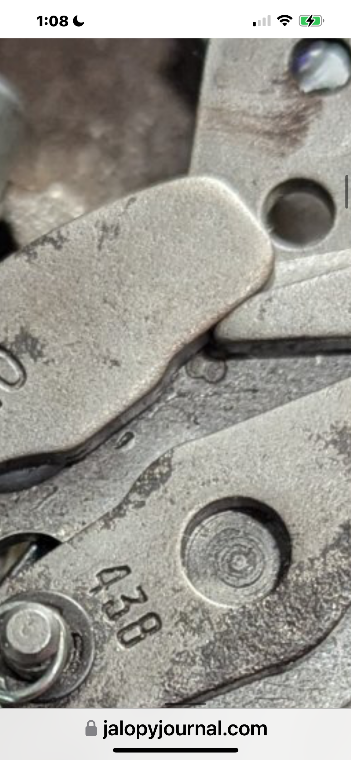

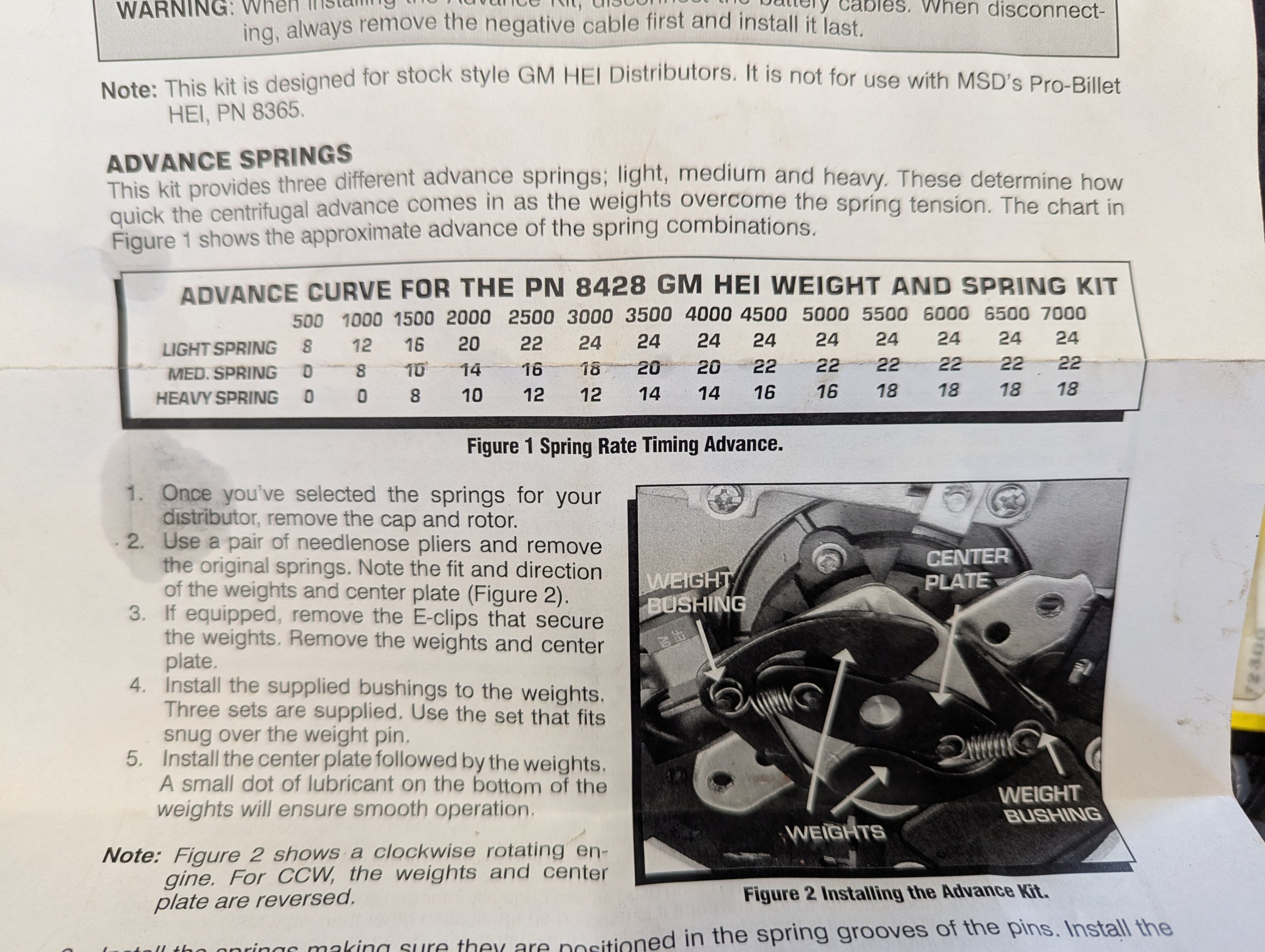

    Hey guys,
    My question is related to an HEI on a 455 Buick but I figure timing is timing :).
    Checking the timing with a new good quality timing light, I'm getting the same advance from 600 to 2,600 rpm. It seems as though I'm getting no mechanical advance. After the discovery I recurved the distributor with an MSD medium setup (picture below), same result of no change through the range. Other than trying the heavy and light springs, I'm at a total loss.
    The weights move freely under the cap and the advance moves freely. I have tried three weight/spring setups now with the same result. Balancer is new, cap and rotor are new, coil and contact are new. The distributor and guts are new with less than 1,000 km.
    Could there be something wrong with the pickup coil?
    I'm at a loss. Thoughts would be great.
    It spins clockwise, same as a SBC. The second photo below is the weights before I recurved it.

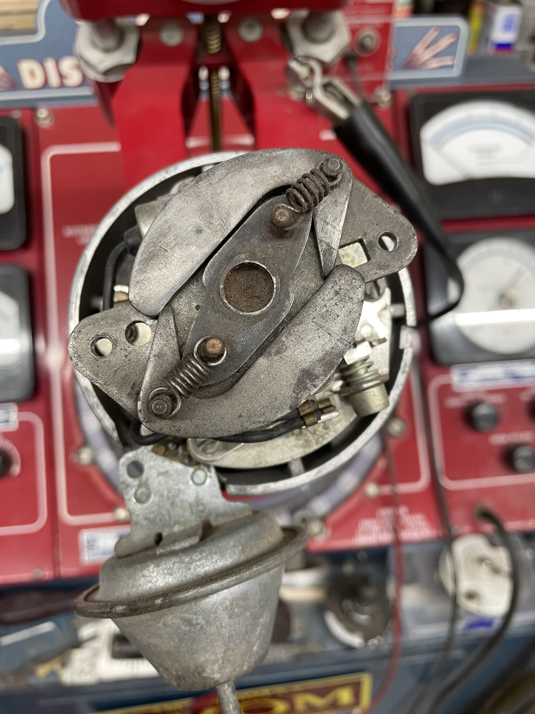

  2. Kevin Ardinger
    Joined: Aug 31, 2019
    Posts: 1,050
    Kevin Ardinger
    I could be crazy, but I think the weights are on it backwards. If it spins clockwise, those weights are not gonna be very prone to sling out. I think. It looks like a reman distributor as the parts look like they’ve been sandblasted.

  4. rockable
    Joined: Dec 21, 2009
    Posts: 5,394
    rockable
    It looks like one of the weights is sitting on top of the other and that would keep the advance mechanism from working.
  5. Moriarity
    Joined: Apr 11, 2001
    Posts: 41,103
    Moriarity
    SUPER MODERATOR
  6. 05snopro440
    Joined: Mar 15, 2011
    Posts: 3,489
    05snopro440
    Is the MSD picture also wrong? I'm not being s***y, I genuinely am curious.
    The weight installation matches the HEI I have on my bench that just came out of a SBC
    Wouldn't hurt anything to swap it and try it, I guess.

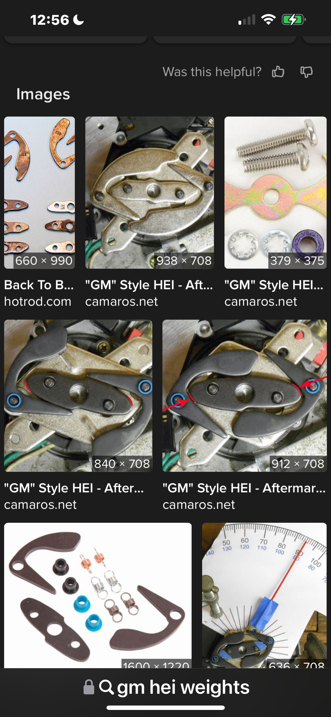

  9. 19Eddy30
    Joined: Mar 27, 2011
    Posts: 5,142
    19Eddy30
    from VA
    Check to make sure the Vac moves
    With finger , it can limit the plate
    Movement of wights,
    & pics show opposite of @Moriarity point weights ,my self not @ shop to check 1 of 10 HEI's I have :cool:
    GlassThamesDoug and alanp561 like this.
  10. Moriarity
    Posts: 41,103
    Moriarity
    SUPER MODERATOR
    unless an Hei and a points dist are different, I just spun mine and the mech adv works
    GlassThamesDoug likes this.

  12. Moriarity
    Posts: 41,103
    Moriarity
    SUPER MODERATOR
    yup, I was wrong, all the pics I see are opposite of the points dist. doesn't make any sense to me. I do not have an Hei to test .. sorry if I messed you up
    Toms Dogs, alanp561 and 05snopro440 like this.

  17. 19Eddy30
    Posts: 5,142
    19Eddy30
    from VA
    Not over lapping
    05snopro440 and alanp561 like this.
  18. 05snopro440
    Posts: 3,489
    05snopro440
    Nope not at all. Besides, my weights now look like the picture in the MSD instructions.

  30. jaracer
    Joined: Oct 4, 2008
    Posts: 3,299
    jaracer
    If the weights are free and the rotor will move when you attach it and move the trigger ring; then I think that your weights are at full advance at 600 rpm. That's the only thing that makes sense. Need stronger springs.
