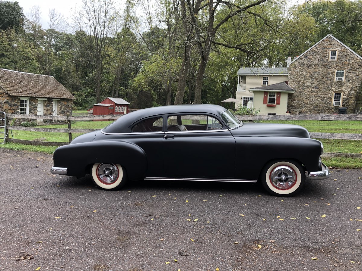

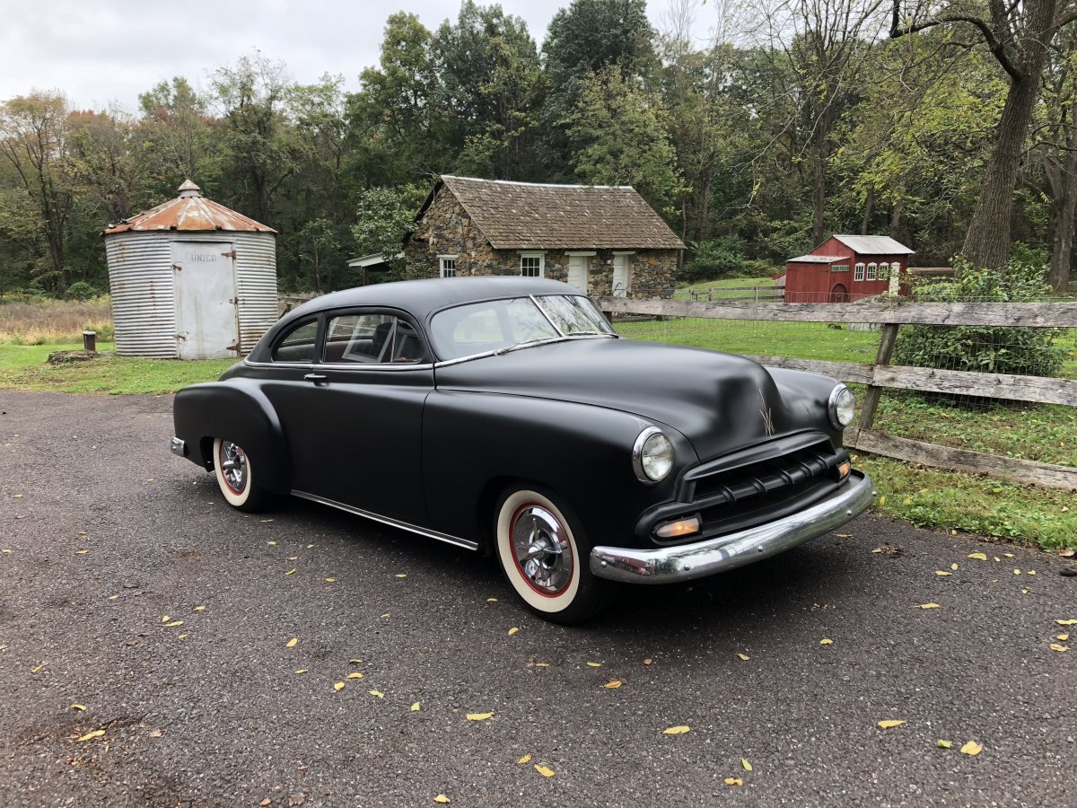

    CA0C1EB0-C0A9-4A54-9398-42E2361A57F8.jpeg 46B8B030-D506-4D2C-9001-004AC71DD061.jpeg 89D73862-FF88-4CE2-857A-F657F447E04D.jpeg Hey guys, anyone have any advice on a cheap way to make a grill look good? Mine is in great shape except painted. I can’t afford a re chrome right now but I was thinking about maybe powder coat or if there is any kind of paint I can try? Thanks

    The cost of nickel plating is a fraction of the cost of chrome.

    Electroless nickel.
    $225.00
  9. Sounds like an excuse to customize it, to me. Use a grille that isn't chrome. '58-'60 T-bird would be something different on there.

    Plating itself is not that expensive. It's all the buffing and hand work that has to be done to make the surface as flat as a mirror that's expensive. Then you plate it. Just plating some new parts, without polishing them, to keep them from rusting isn't expensive but it doesn't look good on exterior pieces that should be slick and shiny, IMO.

    I powder coat on the side at home, the "chrome look" stuff is real, well "chrome look". If they know what they're doing they can get it somewhat polished looking but it wont look like actual chrome more like a buffed up billet aluminum.
    Now if it were my car (and its a killer looking car btw) Id try maybe painting the grill white for now? Might play off your wide whites some.

    There are developments in the powder coating world all the time. The biggest hurdle in chrome replicas was the fact they were not UV stable on their own; it looked great straight out of the oven, but the necessary clear top coat then took all the pop and reflection out of it. The end result was more of a silver and the 'chrome look' was all but gone. These previously pitted and beat up Dodge 800 truck emblems were restored and coated in the old chrome powder with a clear.
    The latest upgrade in the industry has been a single stage chrome replica that is UV stable without the dulling clear coat. The difference is amazing. It reflects almost as nicely as a real chrome job!
