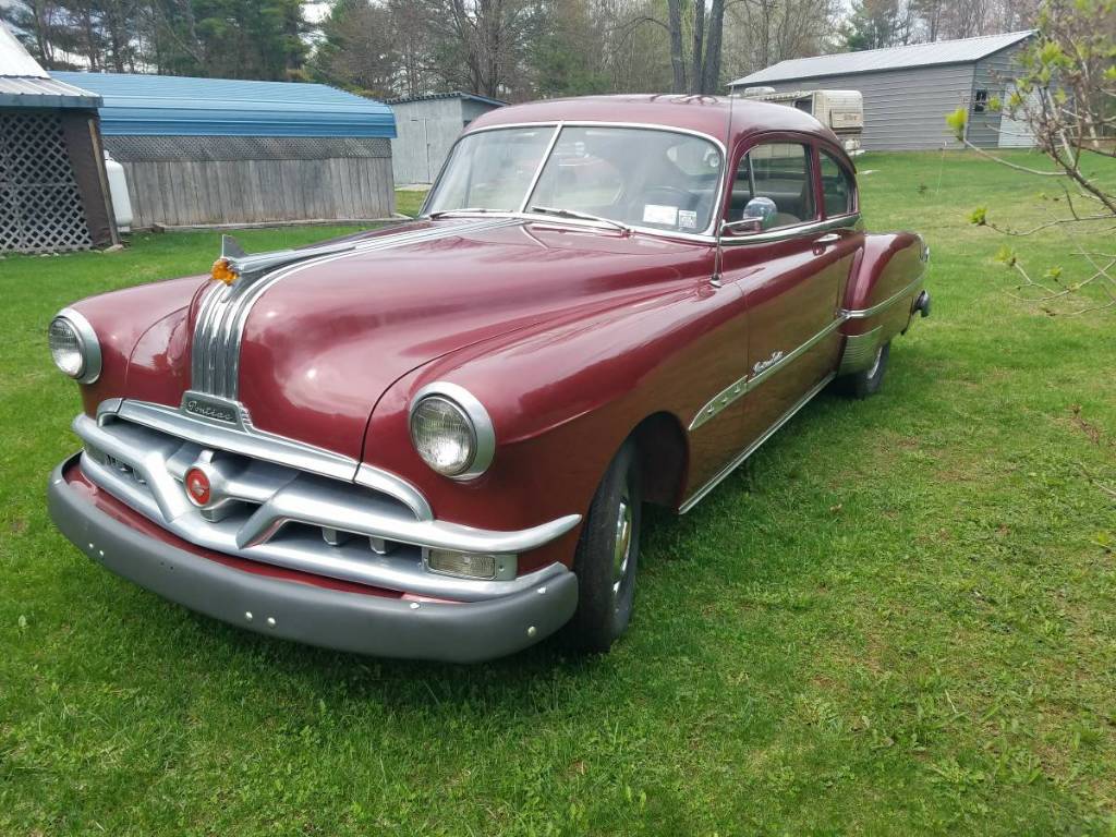

    I have a 51 pontiac. I really hate that there is no love by the aftermarket for the straight 8 or the car in general. I know about the companies that do make some stuff but nothing like its chevy counterpart. It just makes it harder for us Pontiac guys. I think if the aftermarket stepped up, we would see more Pontiacs! Anyway, here is mime. 00l0l_dQYEE79vfeD_1200x900.jpeg 00M0M_9XXPDjB5DAL_1200x900.jpeg

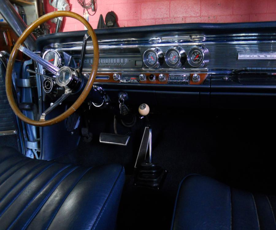

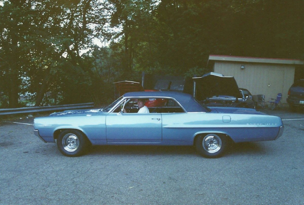

    I would try to keep the Hydro.. They make a car so cool!!
    The 64 was the last year for the Hydro. I have a Super Hydro behind a built up 455 (462) in this Bonneville..

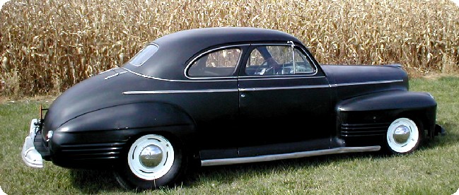

    The rubber crankshafts in the straight 8's won't tolerate high RPMs or m***ive power increases. I've found one of the best modifications to the old Pontiacs is a rear gear swap to 3.23 or even 3.08's. First gear in the hydramatics is really low so you'll still have good acceleration off the line and the engine will thank you for not having to turn so many RPMs on the highway.
    55 and 56 Pontiacs with the automatic will have the higher gears and it's a bolt-in swap. A taller rear tire helps also. I've had a 41 with a six and a 48 with the straight 8 and did the gear swap. Put many interstate miles on them driving all over the western U.S.
    BTW, That blue 42 coupe in the photo above was built by a friend of mine in Malvern Iowa. Such a nice car!
