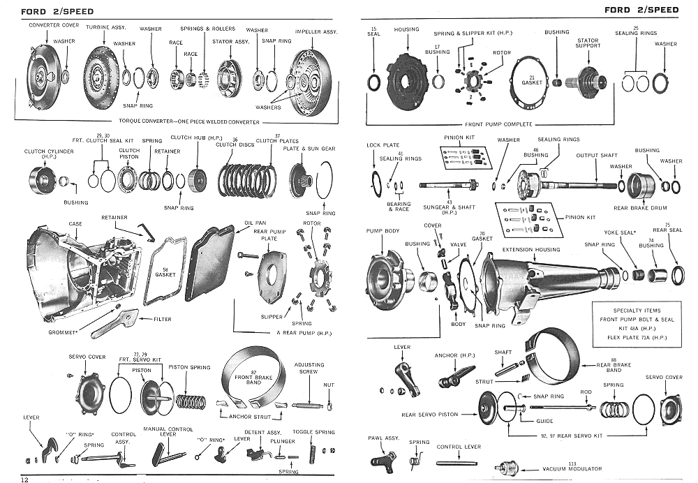

  5. Katuna
    Joined: Feb 25, 2005
    Posts: 1,822
    Katuna
    from Clovis,Ca.
    Damn it man, pics!
  6. bedwards
    Joined: Mar 25, 2015
    Posts: 280
    bedwards
    You have no idea how hard it is to get a pic from a PDF file but here it is =]

  9. Maniut
    Joined: Aug 19, 2016
    Posts: 37
    Maniut
    from Poland
    Do you have the complete Pdf file for a 2 speed? I would be very interested, I have troubles with mine, it could be very helpful.
