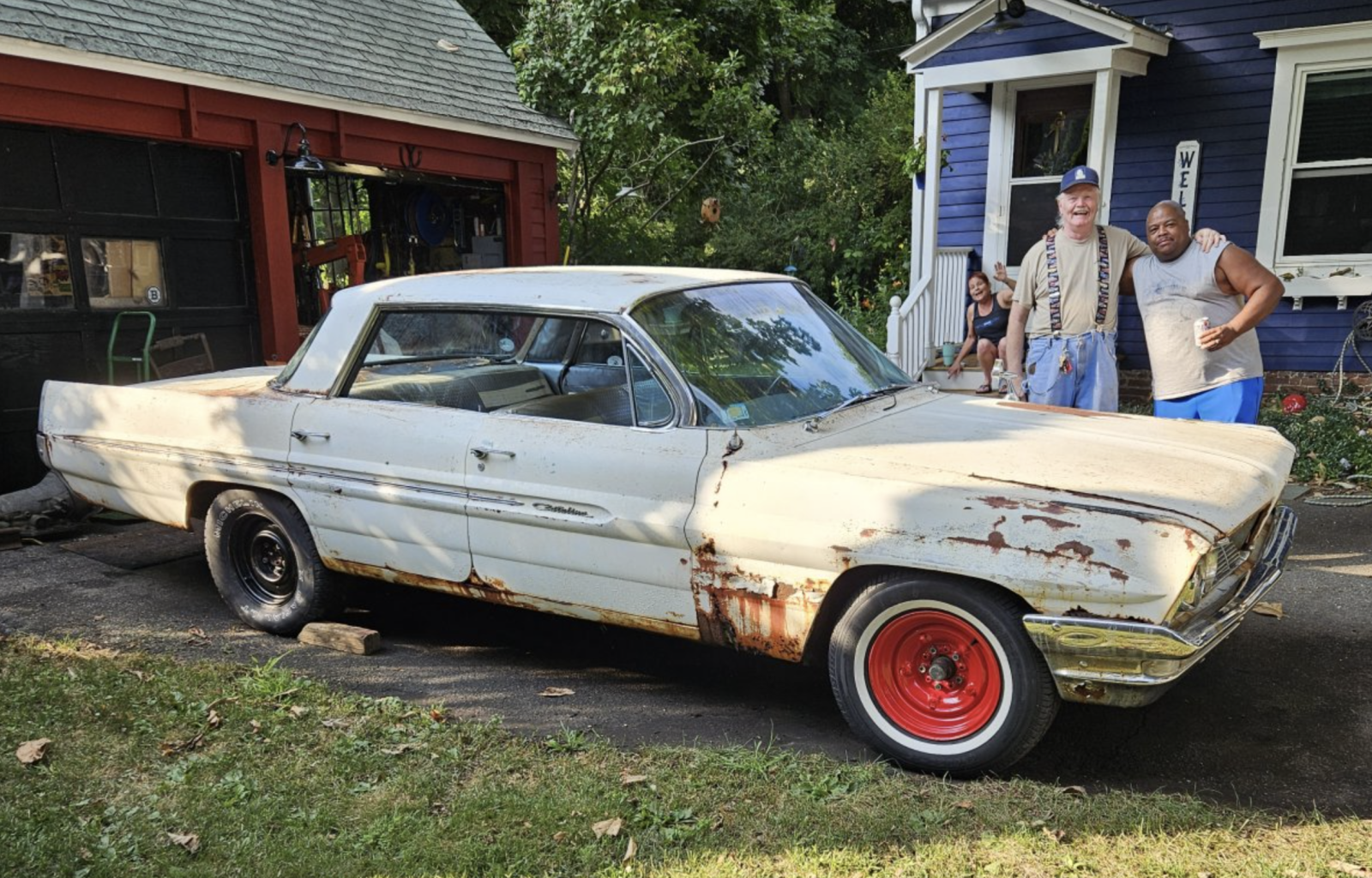

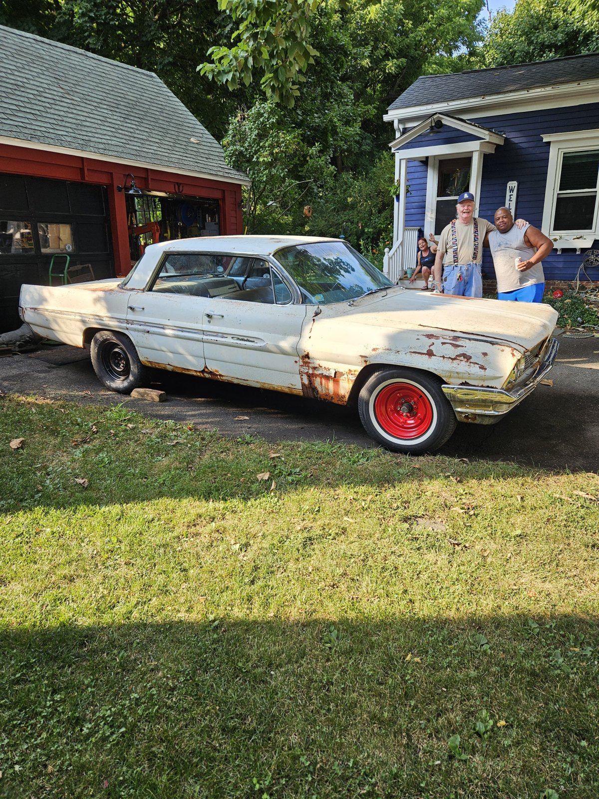

    Knocked out a couple issues after work this week and most of today. Column was stuck, wouldn't move out of park. My column guy (35years experience) was baffled after 3 hours. I pulled it out and saw the very bottom was rusted stuck to the inner sleeve-aha moment! So I freed it up and put that back in but Mike will need to do the finishing touches because I will break the fragile parts. I also repaired the rotten driver's door window channel. 20240727_145458.jpg 20240727_153323.jpg 20240727_154339.jpg 20240727_164503.jpg 20240727_144744.jpg 20240727_144907.jpg

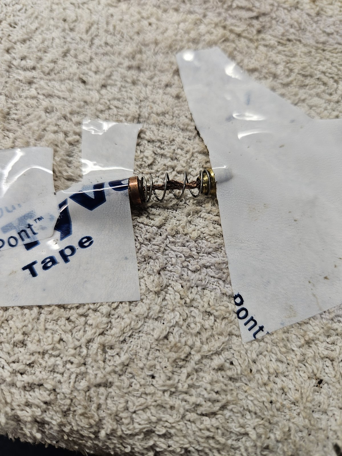

    This is the horn ****on in the steering wheel. The wire is broken and I thought I could solder it but that isn't going to work.
    Anyone have a spare or know where I can find one?
