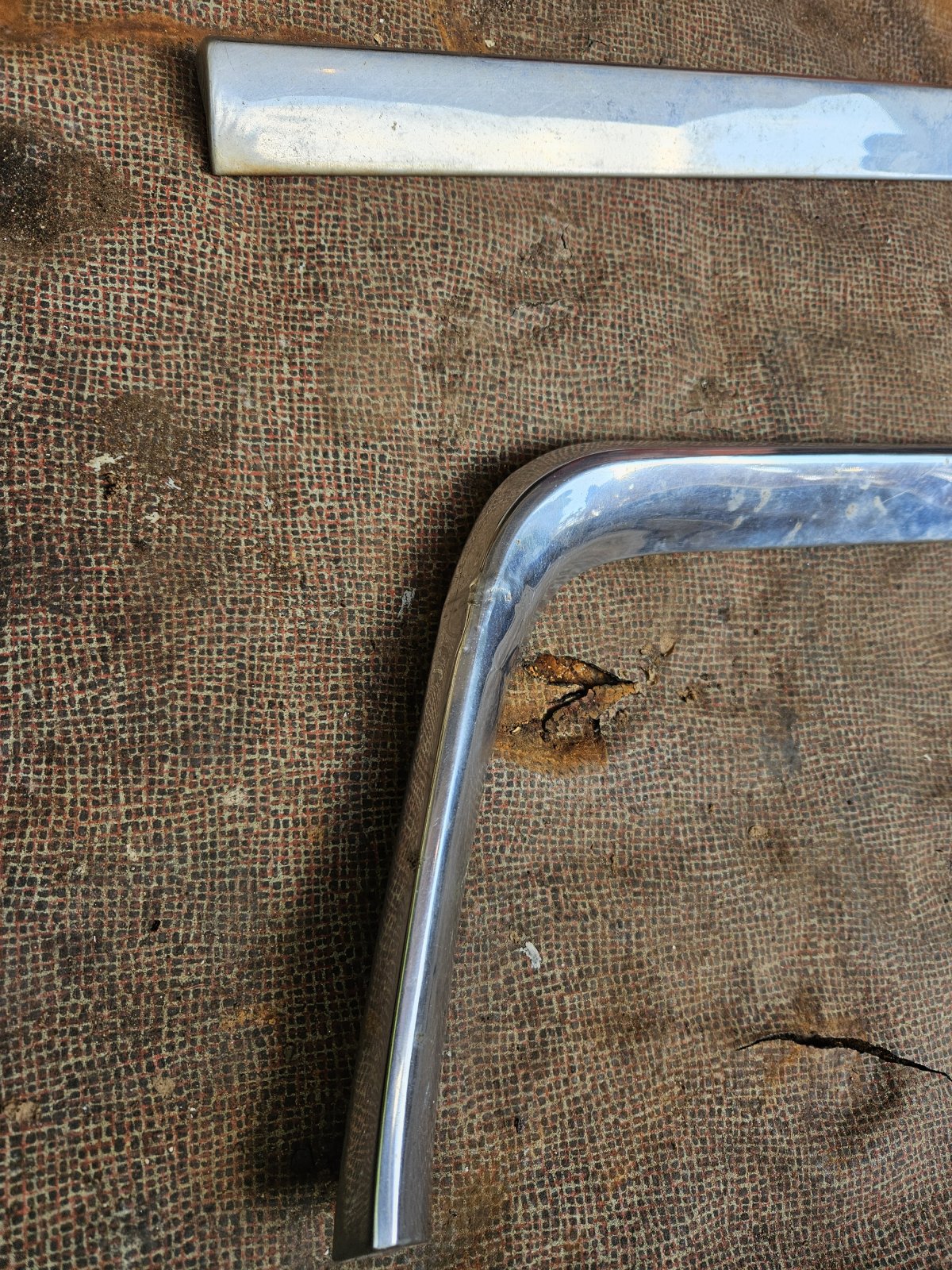

    Been fooling with the brake system, had to replace front left hose and brake line.
    Also tapped out some dings on the stainless trim pieces for the hood 20240827_154600.jpg 20240827_154604.jpg 20240827_154613.jpg 20240827_162145.jpg 20240827_162148.jpg 20240827_162151.jpg

  28. HOTRODPRIMER
    Joined: Jan 3, 2003
    Posts: 64,786
    HOTRODPRIMER
    The stainless looks good,did you sand it and what grades did you use? HRP
