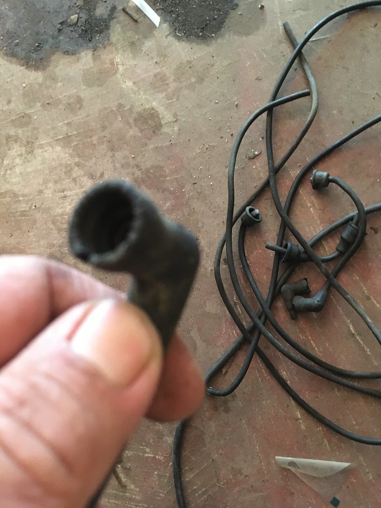

    Check out the plug wires too. Even if they really need to be replaced, the contacts can be cleaned if corroded for a simple check temporary run.

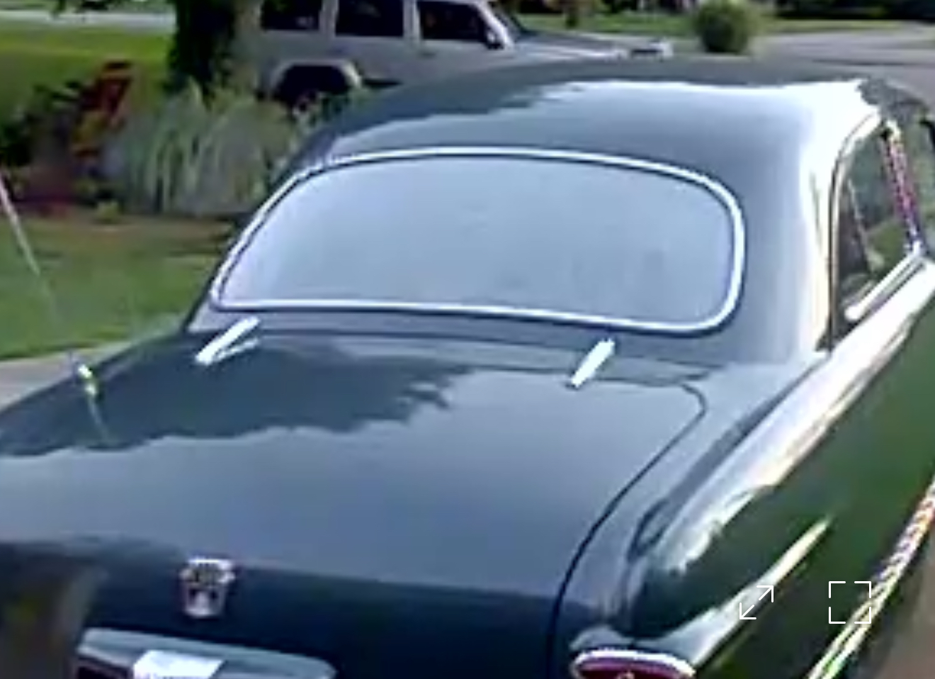

    My wife came home and asked what happened to the rear window. It shattered in the heat. Now I have to find a new rear gl*** and somebody to replace it. My wife said that car is haunted that I should get rid of it. first ride on the street belt broke on the tire. Had a new set of Coker’s so I changed them.
    Next time I went out 4 miles U-joint busted.
    Changed that and had the carb issue then hood bolts came out of the hinge on the drivers side. IMG_8464.jpeg
    Now the back gl***.
