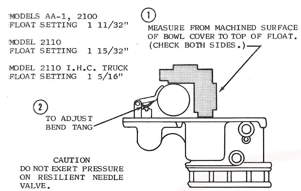

  3. djweaz
    Joined: Sep 17, 2012
    Posts: 412
    djweaz
    from Tennessee
    Yes. I went by this picture and by other reading and videos to drop level should actually be like 1/4” difference. Doesn’t sound like a lot but it doesn’t need to be a lot to get the job done. My original the float drop was huge and it is why the needle fell out. IMG_8484.jpeg

  4. ClayMart
    Joined: Oct 26, 2007
    Posts: 7,796
    ClayMart
    Sounds like you were a step ahead of me with your diagnosis. Good on you! That may fix several issues.
