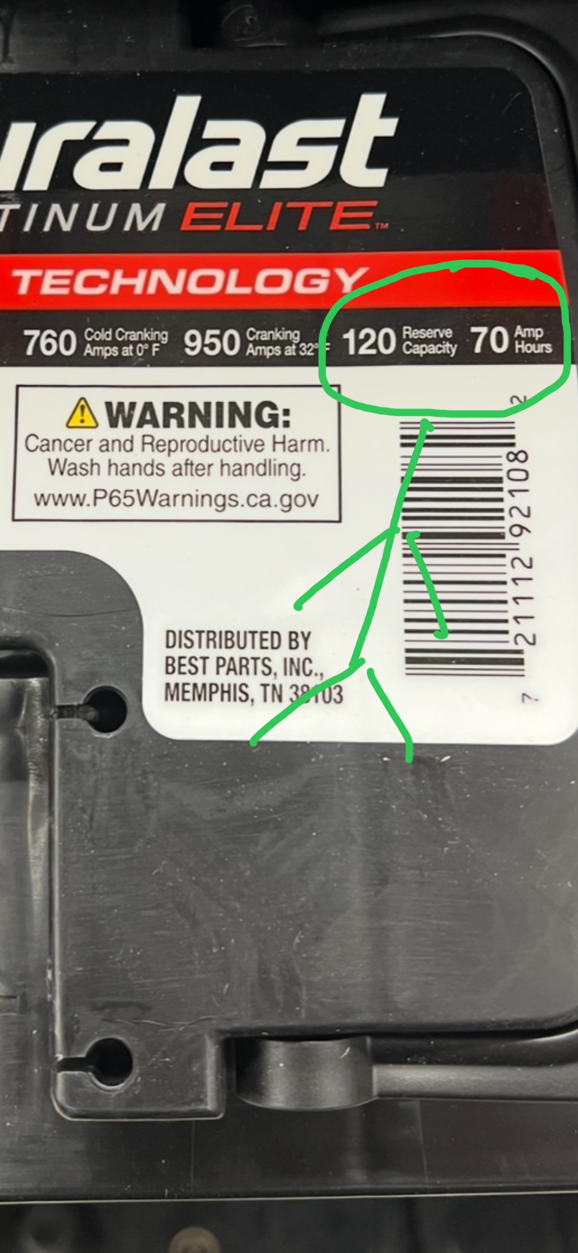

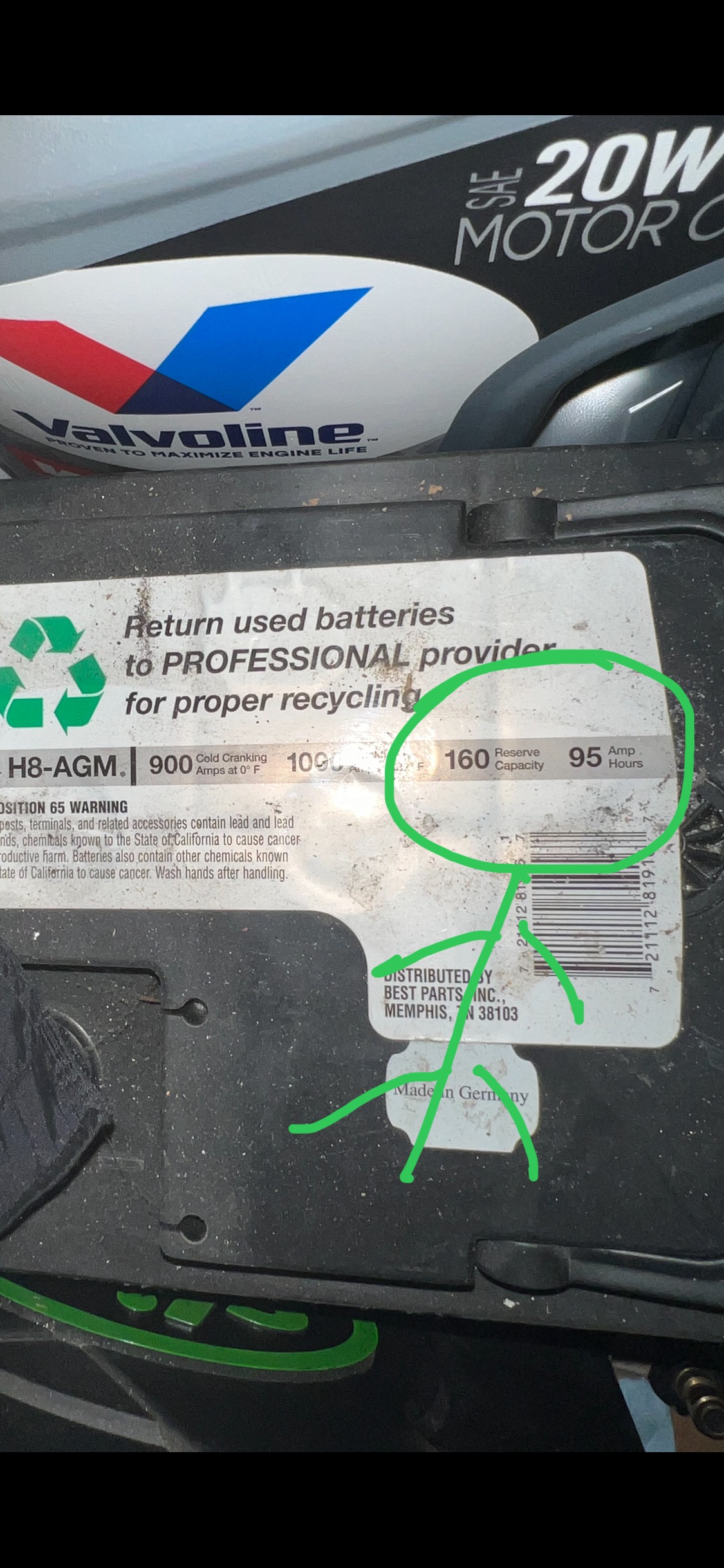

  5. 19Eddy30
    Joined: Mar 27, 2011
    Posts: 4,037
    19Eddy30
    from VA
    & Does not seem to many
    Do Not know how to
    Size battery specs for their needs,
    The Spec 's
    The reserve( like gas in yr tank)
    @ how many Amps per Hour
    jaw22w likes this.

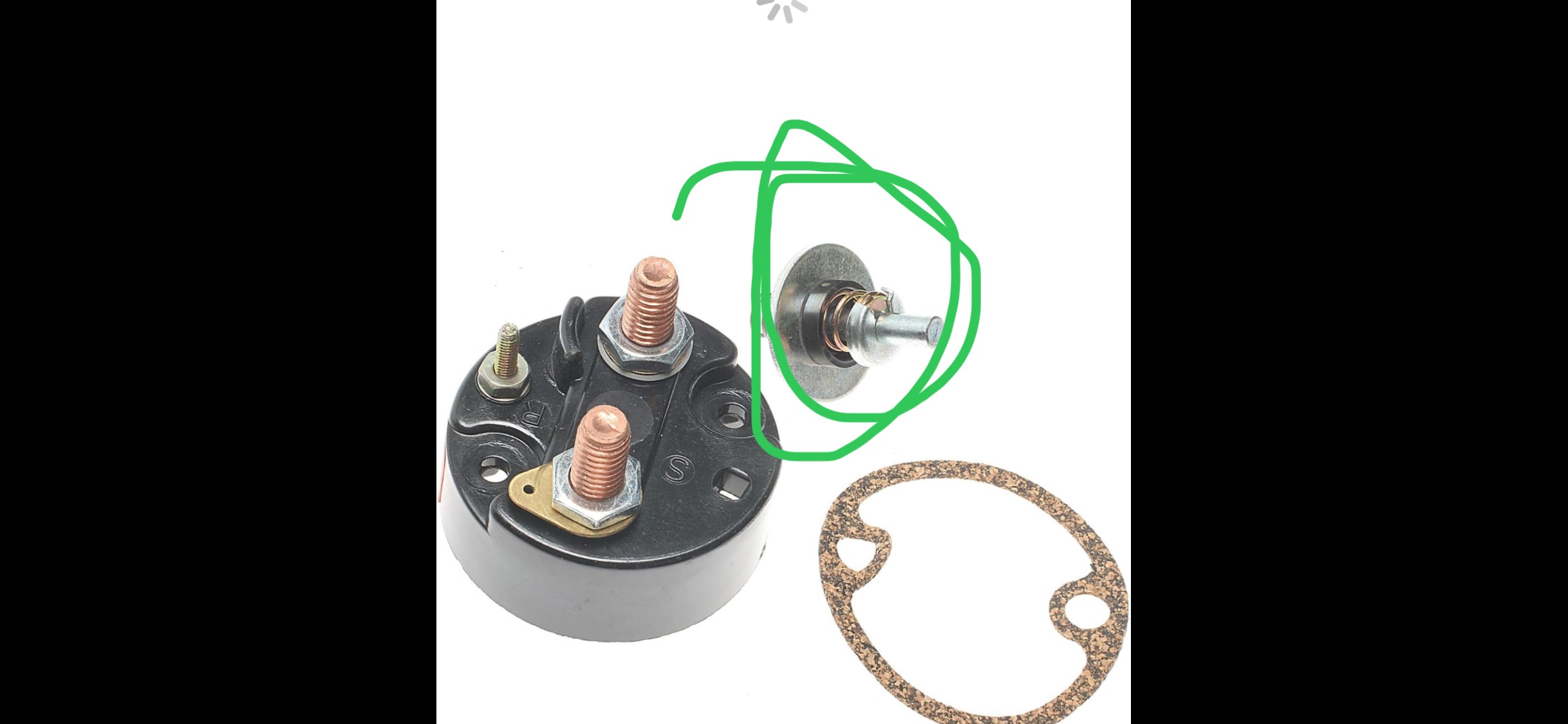

  15. 19Eddy30
    Posts: 4,037
    19Eddy30
    from VA
    @jaw22w
    If all connections you feel are good,
    If it does it again
    And you changed with new starter & solenoid , I would look @ Key switch,
    This Happen even on Lawmower tractors ,
    Many newer ignition switch are just junk, "" Purchase name brand"
    Or Old NOS , even a junkyard one.
    But more likely the problem was the contacts inside the solenoid
    And the contact studs on the inside Black piece both will get burnt spots & warp , Not a flat contact
