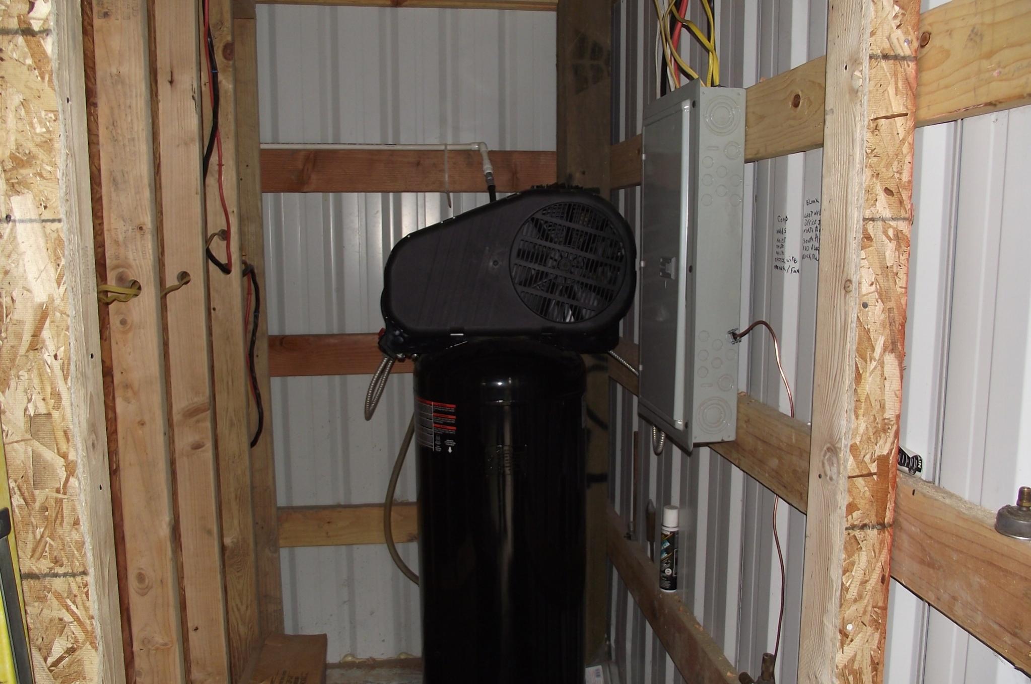

    I built an insulated closet for mine. I can still hear it but now it;s bearable. I had it in a shed outside at the old shop but then I could hear it in the house and I'm sure so could my neighbors.

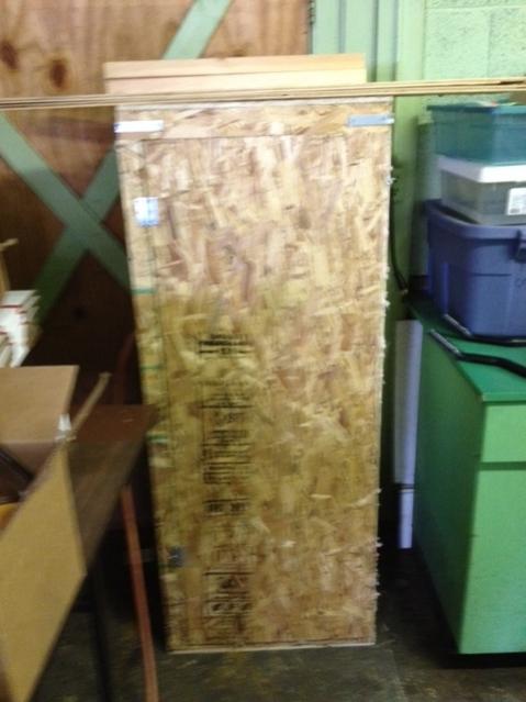

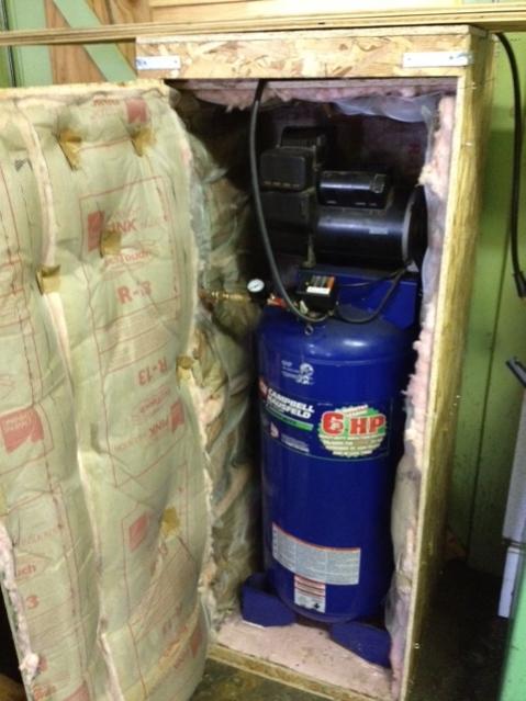

    Hi Guys. I just made an air compressor box for my upright 30 Gallon Campbell Hausfeld. Here's what I did.
    (Ignore the board stacked on top of it...that's just extra wood sitting on top)
    I used 1/2" OSB board
    24" x 24" overall outer dimensions
    60" tall with a double roof inside (one roof inside the other with a letter "S" shaped outlet for air at the top).
    Floor is 24"x24" OSB with 1" pink styrofoam on top
    Walls (and door, of course) and ceiling of box are 3 1/2" thick fibergl*** insulation. I used the 15" wide roll that is 32 feet long. IT works out perfectly where you only need one 32 foot roll.
    It is so quiet you can talk on your cell phone while leaning against the front door. Before this, it drove you out of your mind even if you were 30 feet away!! Ping me if you want the plans.
    ***I used screen (aluminum screen) to hold the fibergl*** insulation in place. Staple gun with cardboard over the staples to keep them from shooting through.
    ***There is a screen vent on the top of the roof (2" wide by 24" long opening/slot in the top covered with screen)...the second roof under the top has a solid plate where the slot is and there is another 2"x24" slot on the opposite side of the interior roof...this makes the air have to travel in a U or "S" type shape around a corner to get out...allows air to travel and sound not to come out in a straight line)
    ***I picked up a gallon of bright blue latex paint (one of those discarded one where the guy changed his mind or screwed up the mix) and we're paingint it bright blue this week. OSB is a bit ugly unless you paint it.
    Hardware:
    2 Hinges
    2 Door Clasps (hook/eye thingys like for yard fences and screen porch doors)
    8 Corner braces (90 degree corner braces to hold the corners snug)
    4 bottom corner braces - the type that hold the bottom of a board and hold the 2 walls at 90deg to each other).
    The top has a 2" x 24" opening for airflow. It does get warm in there, but if you don't run it nonstop, it's fine. I could add a fan in there, but I don't think it needs it. All compressors get hot. The thing I could have done was put the compressed air line (the copper line from compressor pump to the tank) outside the unit to keep it cool...that is what causes almost all of the heat in a compressor box (heat coming from the compression of air - pv=nrt). <!-- / message --><!-- / message --><!-- attachments -->
