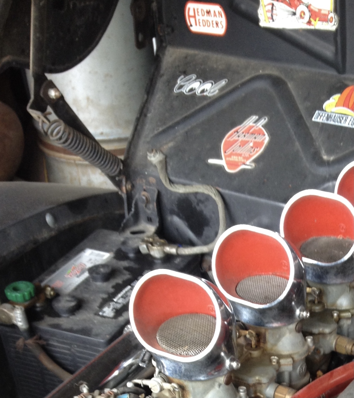

    IMG_0589.jpeg Took bird cage wire, fine scotch brite and screen door screen and made filters for my frog mouth scoops Keeps out big bugs

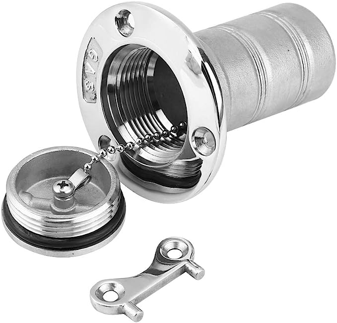

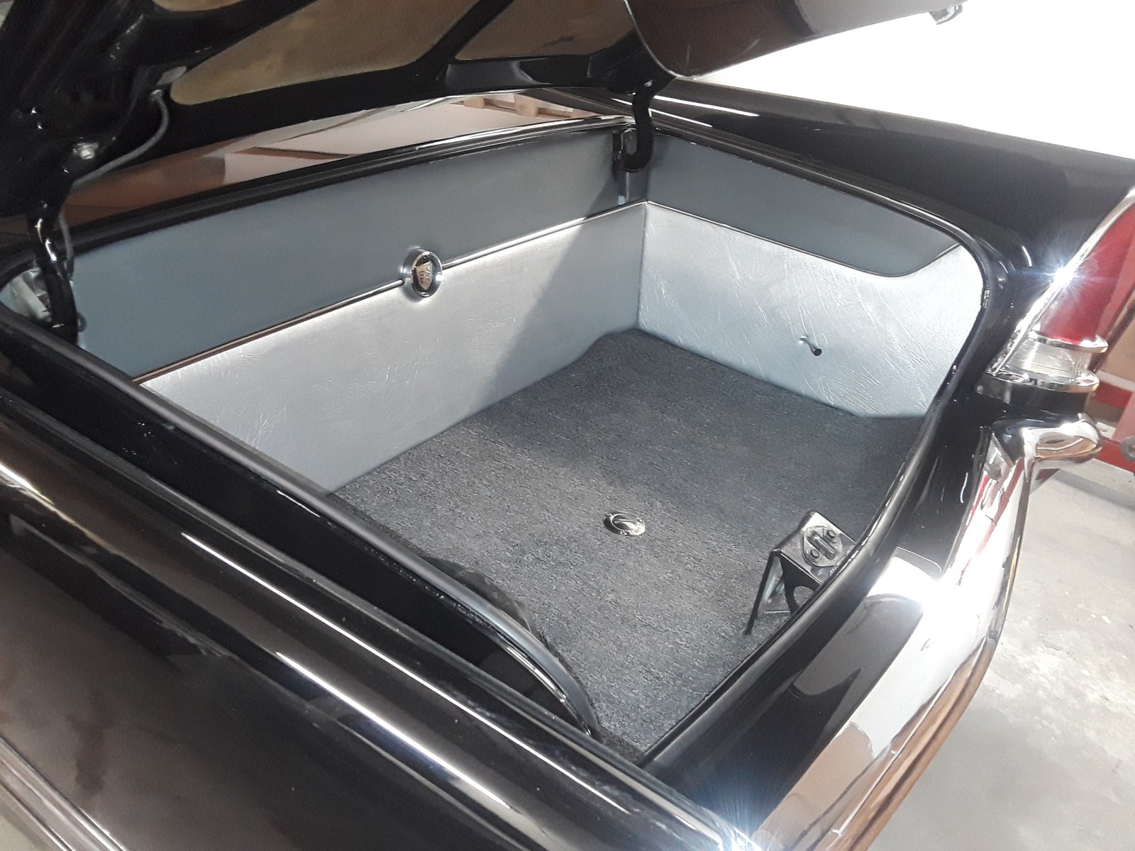

    I shaved the gas door on my Chrysler, and installed a Mustang fuel tank in the stock location. I cut a hole in the trunk floor directly over the tank's filler tube, then used a flush-mounted stainless marine 'GAS' deck fill inside the trunk connected with a short piece of rubber tank hose. The hardest part was tightening the clamps on the hose. The filler cap is a sealed unit to keep fumes from escaping, so I added a vent/rollover valve to the Mustang tank before installing it. It's simple and unobtrusive, cost $20, and looks better (IMO) than most of the solutions people have for a shaved gas door.

    Yup, I used one of those that I picked up from the local boat supply store. Set it in the right rear fender of my 49 Ford truck.

    That’s neat and all, but how do you put gas in without it dripping into the trunk carpet?

    Shake it a little before pulling it out… lol.

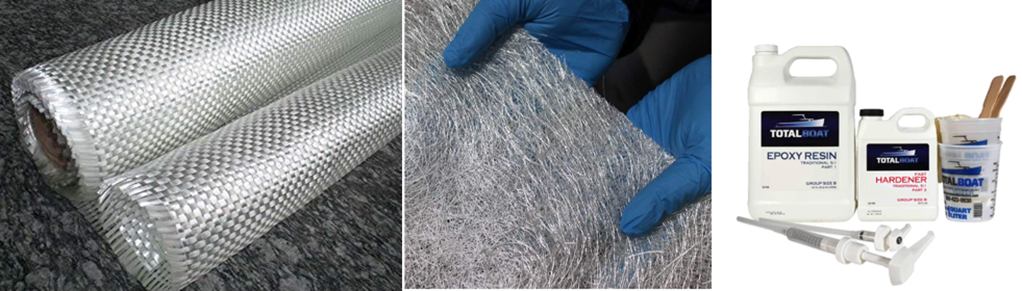

    Earlier upon drying our surfboards, one of our friends was doing a “ding repair” using fibergl*** cloth, resin, and shreds of matte fibergl***. He had hit a reef upon losing his board and caused some damage that could not be left alone. The resin was in a gallon container and there was a small bottle of catalyst to start things off. The fibergl*** cloth was "a given" for any surfer, as ding repair is just one of those things that we all learn to complete at one time or another. The mixture is the potent part of the whole “shebang.”
    Jnaki
    So, being surfers and access to the same fibergl*** cloth, resin and shreds of matted cloth material, we had the fixings of a “hole-crack” water tight sealing compound. The dirty caked on undercoating had to be somewhat s****ped off, but only to the width of the cloth coverage and seal guarantee. The surface was sanded and prepped as if it was a ding on one of our surfboards.
    After the initial layer of cloth/resin combo, it set and was ready for some sanding to prep the surface for the next wider layer of cloth/resin on the metal surface. We had ***umed a two layer repair was going to do it, but since this was our only metal repair, we decided to give it a third layer when ready. Again, spreading farther out to the edge of the s****ped undercoating barrier.
    A well deserved nap and snack prepped us for the gas fill check for leaks scene. It worked as planned and we were a bunch of happy surfers. A nice black spray can did the cover up job and it looked great, too. In no time, with the running on dirt roads, the black paint was covered up and it looked as old as the car after a couple of days.

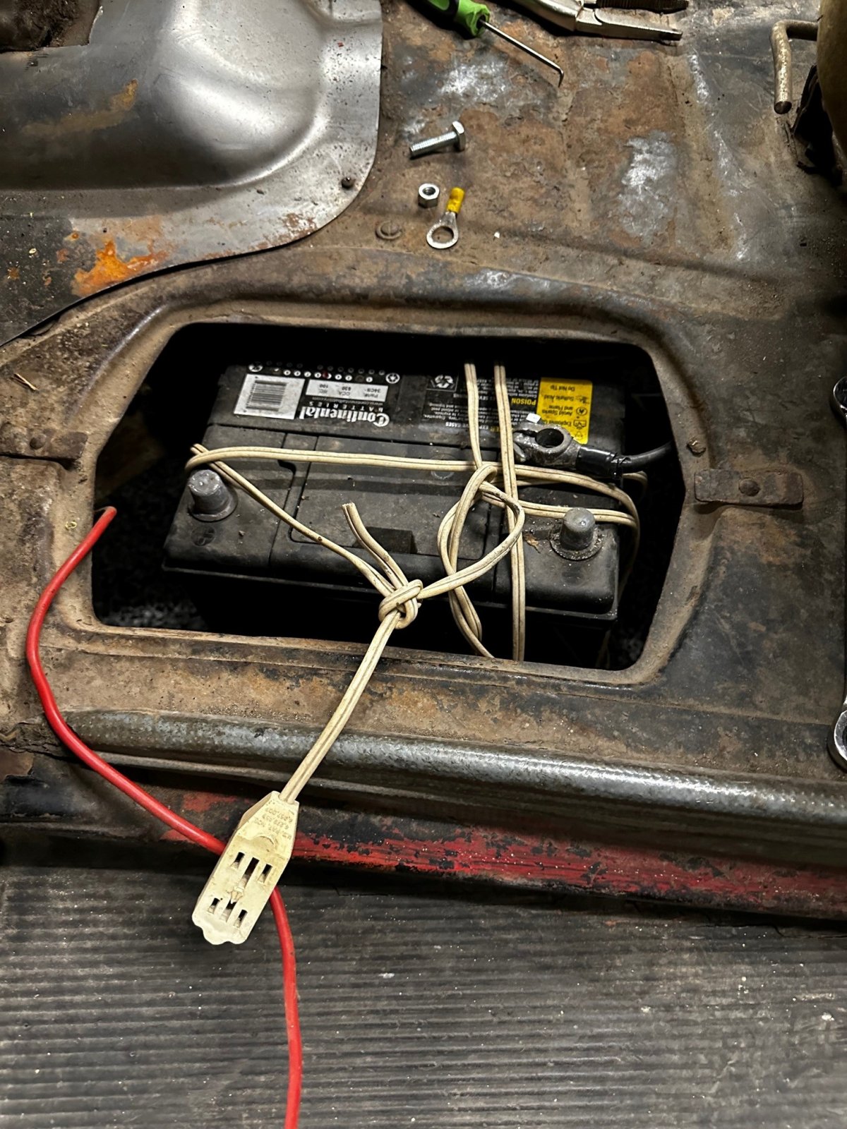

  23. What a waste of an extension cord! Why hell, that and some wire nuts and you could have hooked up yer taillights!
