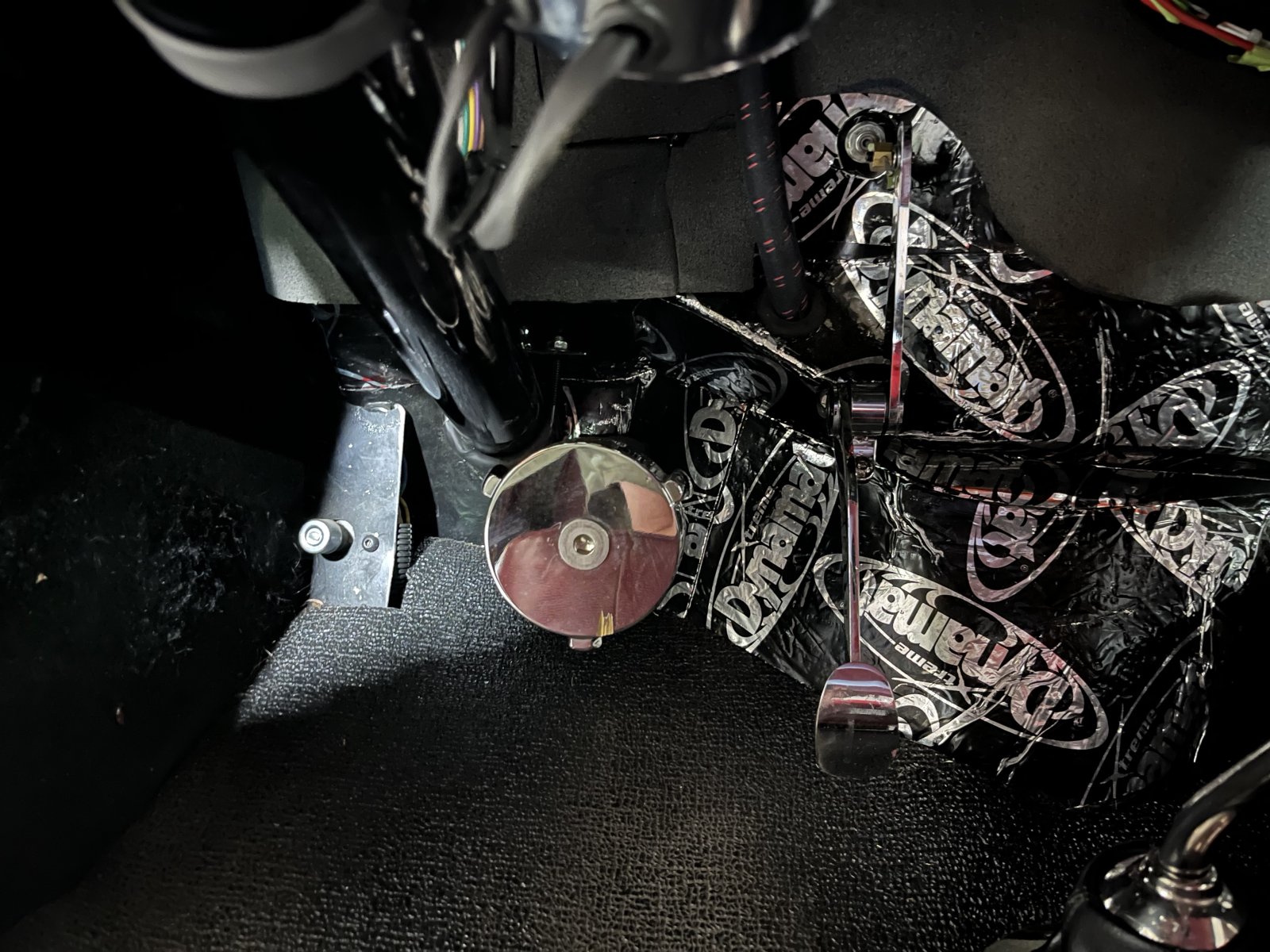

    2 1/2 inch discharge port cap from a fire engine as my brake pedal pad. One day I’ll replace the s**** gas pedal with a FD spanner wrench.
    John

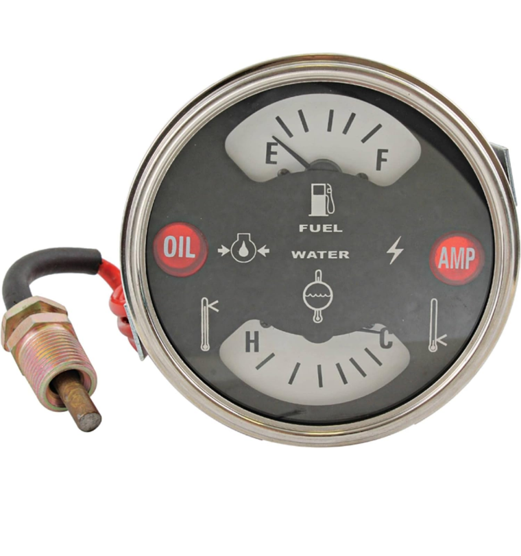

    Pondering.....I found this generic tractor cluster. I wonder if it would be easy enough to get the fuel gauge to work with an automotive sender

  11. They would operate in the same way, but you may have to insert a series resistor to match the range. You can fit a variable resistor (potentiometer) and adjust.
