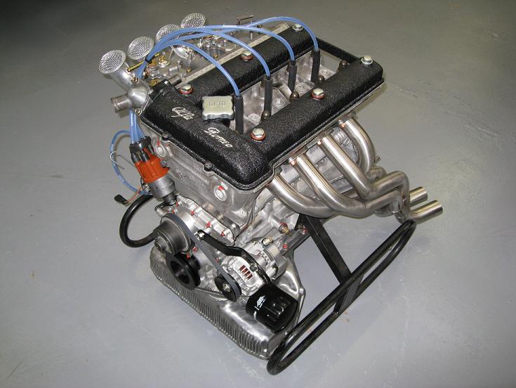

    ALFA ROMEO 4 banger... 1954 to 1994
    Schweet Little Engine!

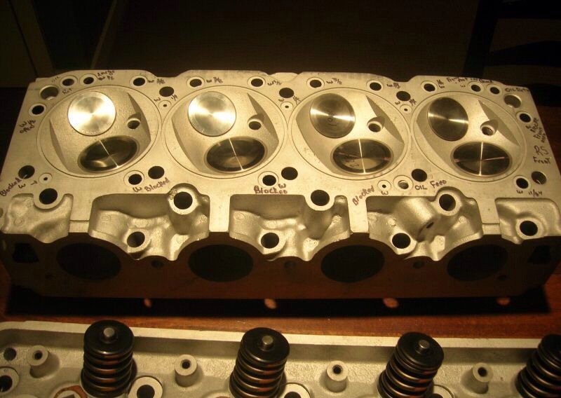

    Boss 429 wasn't exactly a true hemi, more of a twisted hemi. The valves were canted a somewhat. ImageUploadedByH.A.M.B.1421716927.786869.jpg

  24. I think that is why we called them a semi hemi way back when.
    They actually claim that the 426 hemi is not a true hemi because the combustion chambers are not deep enough. You need to think sphere when you are thinking hemi and the face of the head wants to be on the equator. At least that is the purest's view of it.
