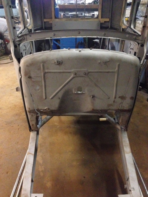

    This body:
    On this frame , maybe sell the sedan body or keep it for a future project.
    Some say i'm crazy but i alwas wanted a coupe
