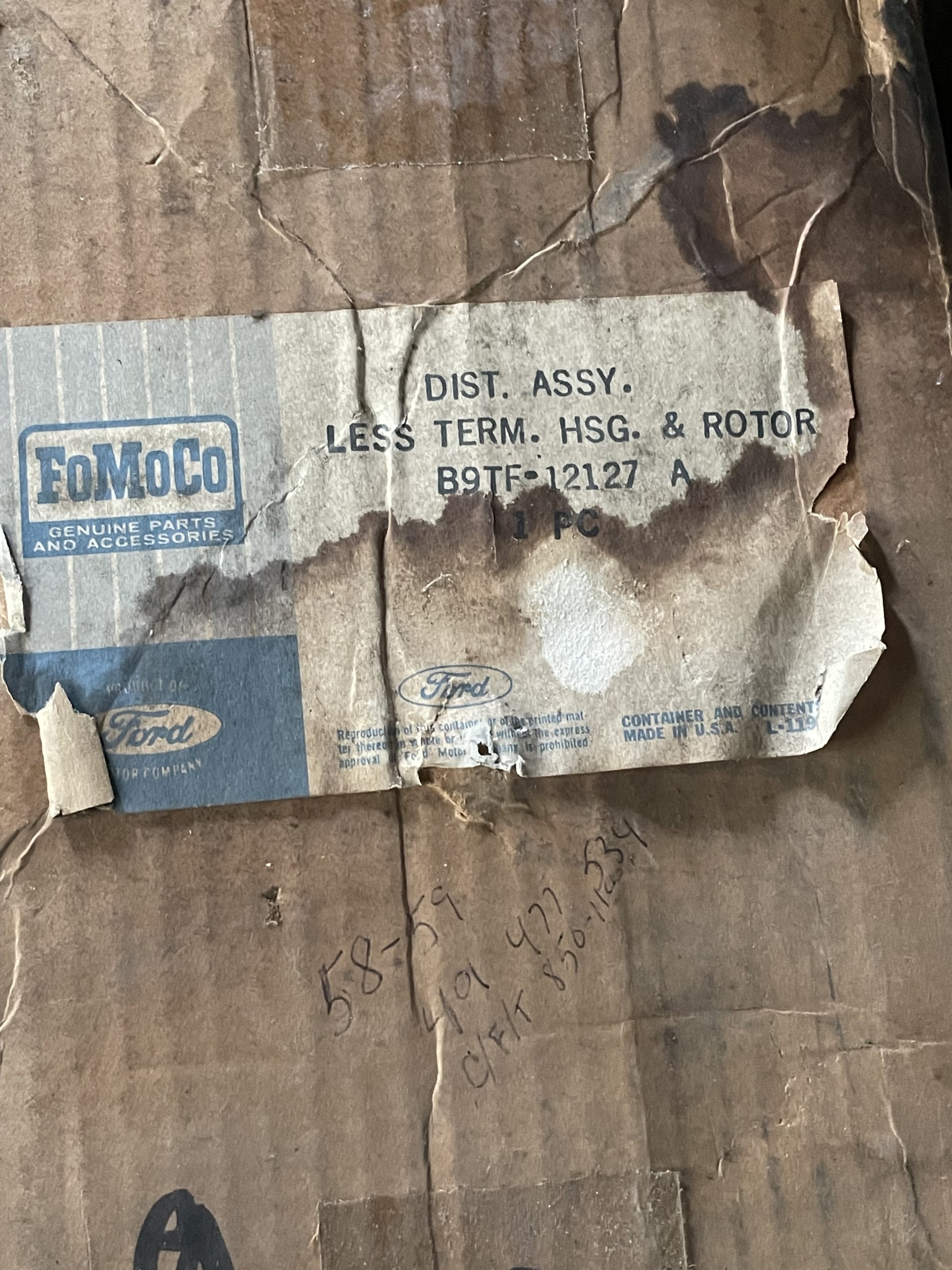

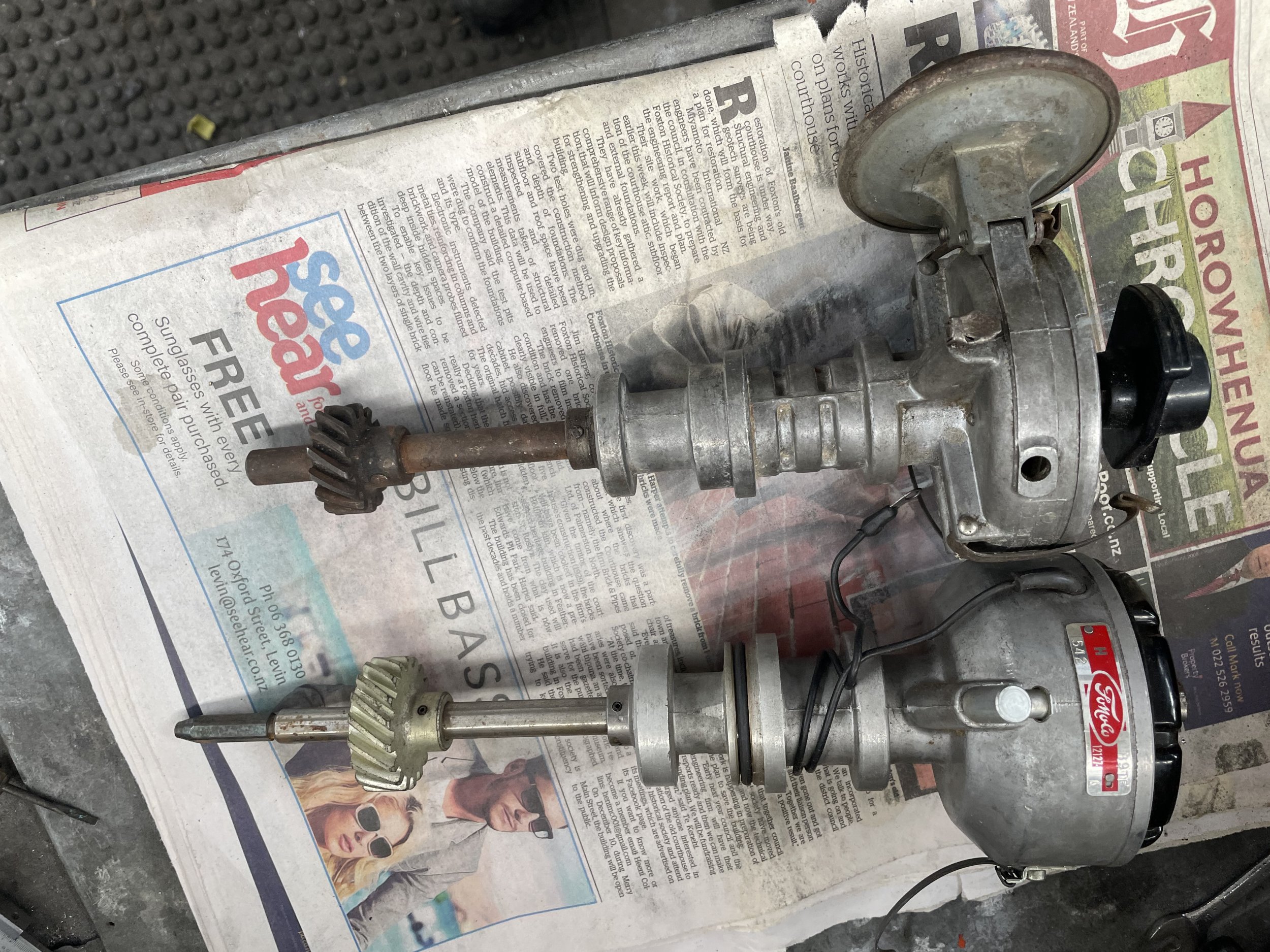

    We are looking for a decent rebuildable late Y block distributor, this “thing” was still in the original box and listed as a 59 Y block distributor,I bought it in haste late at night. What is it? Beside it an early Y block distributor. Still looking for a 57 on distributor. Any have any suggestions as to what the “thing” is. ? IMG_6309.jpeg

    Have you opened it? It looks like an FE distributor (possibly a truck application) with a transistor ignition trigger (under the black plastic insulator). It wouldn’t help with your needs, but it would be cool to see. :)

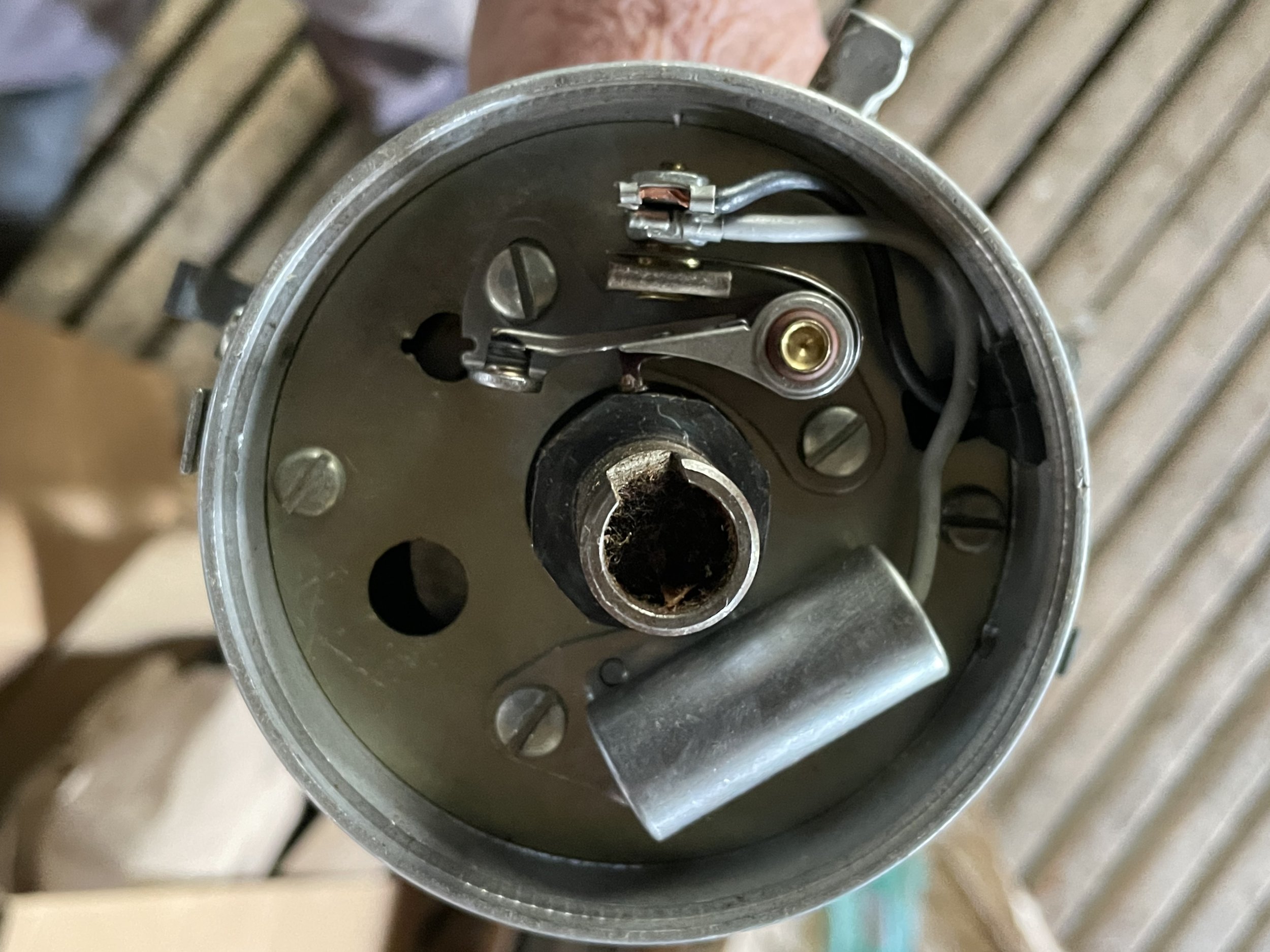

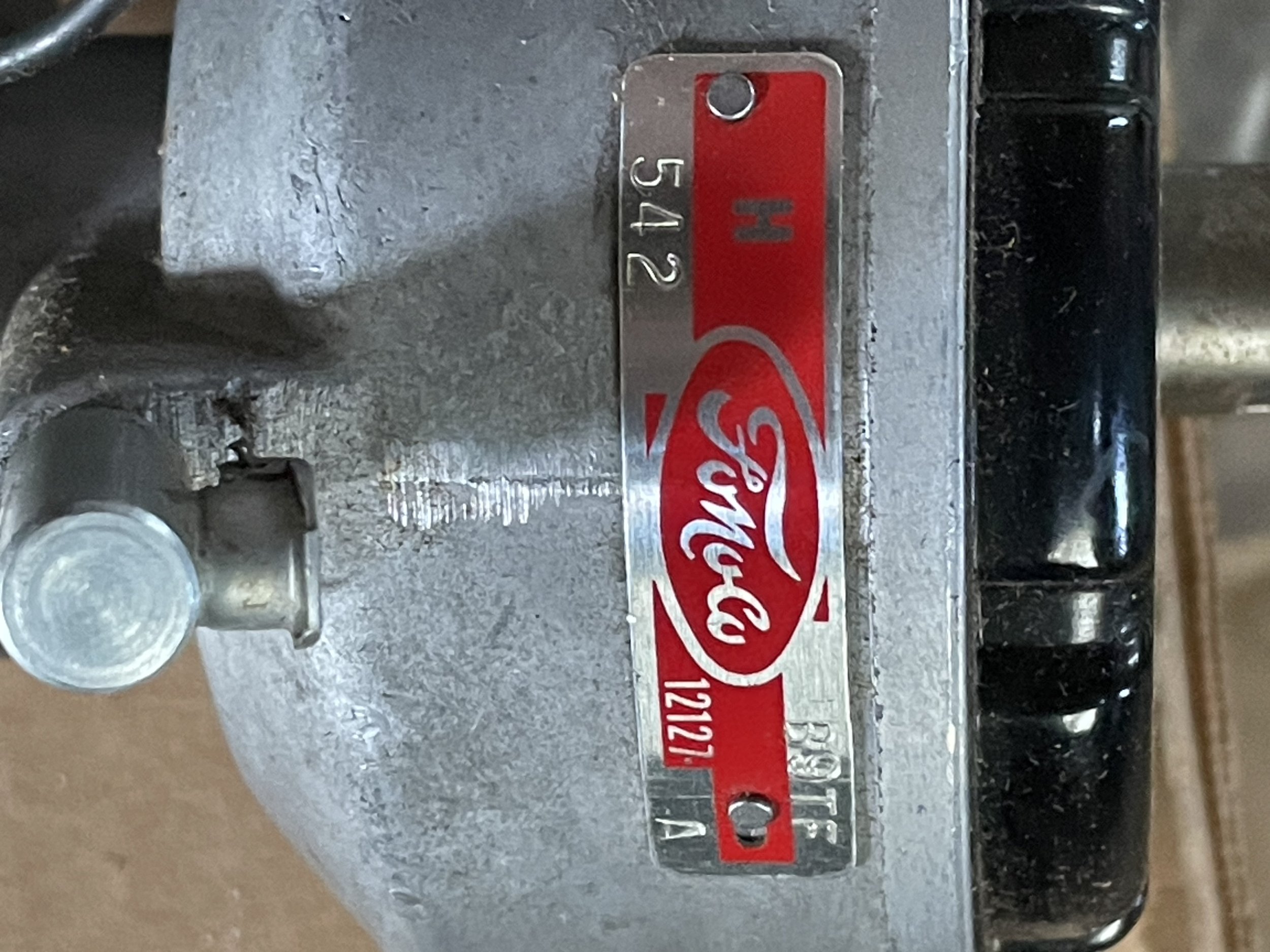

    It was listed as truck, but no vacuum can ,would that hint to a stationary motor? IMG_6336.jpeg IMG_6335.jpeg IMG_6332.jpeg

    The handwriting on the box is the best clue. 58-59 fits the B9TF and the 401, 477, 534 fits in the Super Duty engine family used in the big (Godzilla sized!) trucks. No vacuum advance - may have only needed mechanical advance. It’s odd the distributor has the extra cover over the points, but that may be for added weather protection. I was hoping to see the transitor ignition trigger. :)

    Use the part number on the box (B9TF 12127 - A) and do a a Google search, it'll tell you everything you want to know..

    1957-59 FEK or FEH 12127 Ball bearing breaker plate
    1959 B9AF or B9TF 12127 Hinged breaker plate
    1960 C0AF or C0TF 12127 "
    1961 C1AF or C1TF 12127 "
    1962 C2AF or C2TF 12127 "
    1963 C3TF 12127 "
    1964 C3TF 12127 "

    It does look like a little lathe time could turn it into the other.
