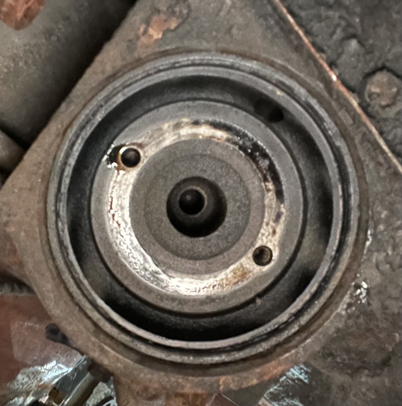

  1. The 283 I’m building had a bypass missing the bypass part of it. Pulled a bypass and spin on adapter off another 283
    The bypass didn’t have a gasket between the block and bypass.

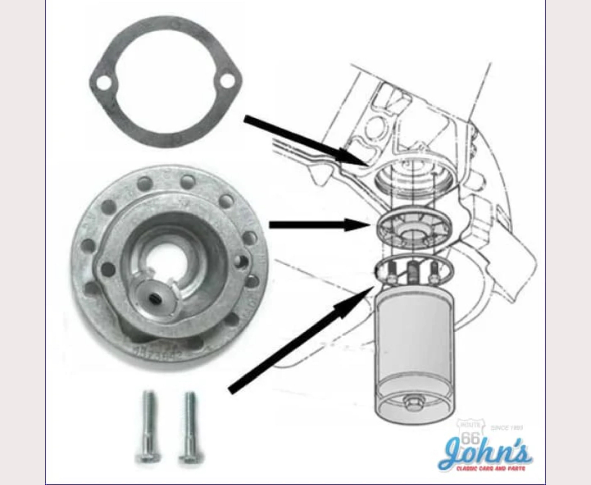

    IMG_5292.jpeg Looked up a bypass on the internets and it shows a gasket
    not seeing this on other breakdowns I looked up.
    So is a gasket used here. Another 283 I have didn’t have one either. There isn’t one in the gasket kit.

    no gasket between valve and block. The gasket was used with truck engines with an oil cooler, I think.
    The adapters usually have a felt or rubber gasket to seal against the valve. Do you have an adapter yet? If not, just buy one, it should be complete.

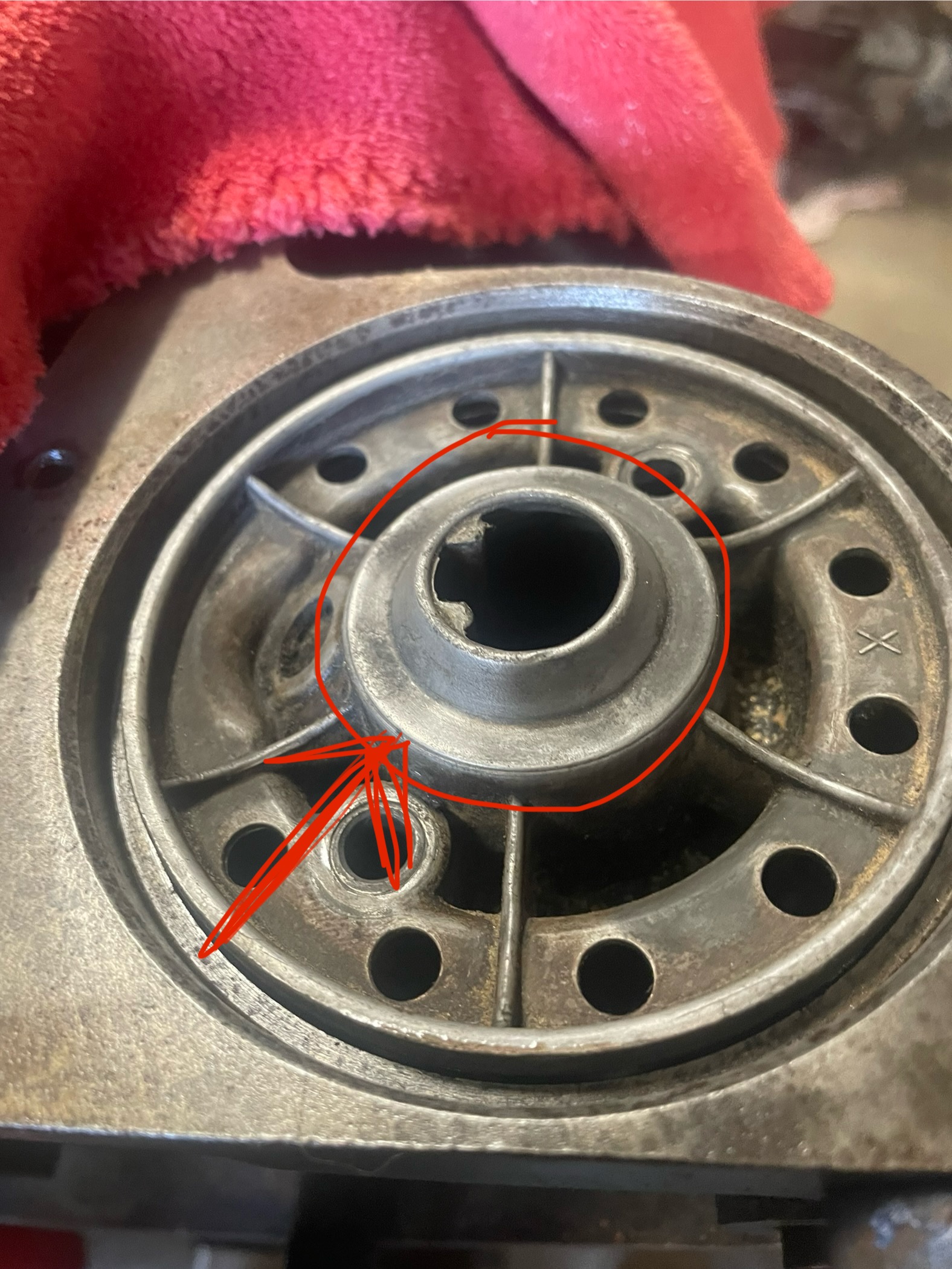

    The seal crumbled when removed

    You also need the large diameter rubber square O ring that goes around the bypass valve, that the adapter seals to the block with. It comes with the canister filter.
    The inner seal between the adapter and valve is usually a felt washer, perhaps 1/16" thick.

    That adapter has to be used with a bypass valve. If you don't use one you will distort and crack the adapter plus it won't filter any oil.

    I like the canister oil filter in some applications. Having two canister lengths to choose from and an almost puncture proof filter had some merit. In some ways it's too bad the blocks machine work changed to eliminate that option. I have some original factory filter bypass adapters and the kit does contain a gasket for the block side. And as mentioned, the bypass adapter must be inplace under the spin on adapter to support the spin on adapter and provide the bypass.

    Just put a 283 together - no gasket on the original bypass, but the "reclaimed" adapter I used did have a seal that went against the area you have circled - of course is also used the "original" style outer seal (that the canister sealed against) too - IIRC there was another adapter available back in the day that did not use the original bypass - it replaced everything and used a ford! FL-1A filter....

    On the gasket...sometimes parts are included that aren't needed, or used originally. For example, Chevy engine gasket sets have included exhaust manifold gaskets for decades, even though Chevy never used them.
    I doubt that it would hurt to install the gasket between the block and bypass valve, even if it's not needed. So do whatever you feel comfy.

    The 2 I took apart yesterday didn’t have one. The internets pic shows one listed for a corvette

    They didn't use them when they built the engines. But since there's a gasket that fits, for another application, someone decided that they should include the gasket.

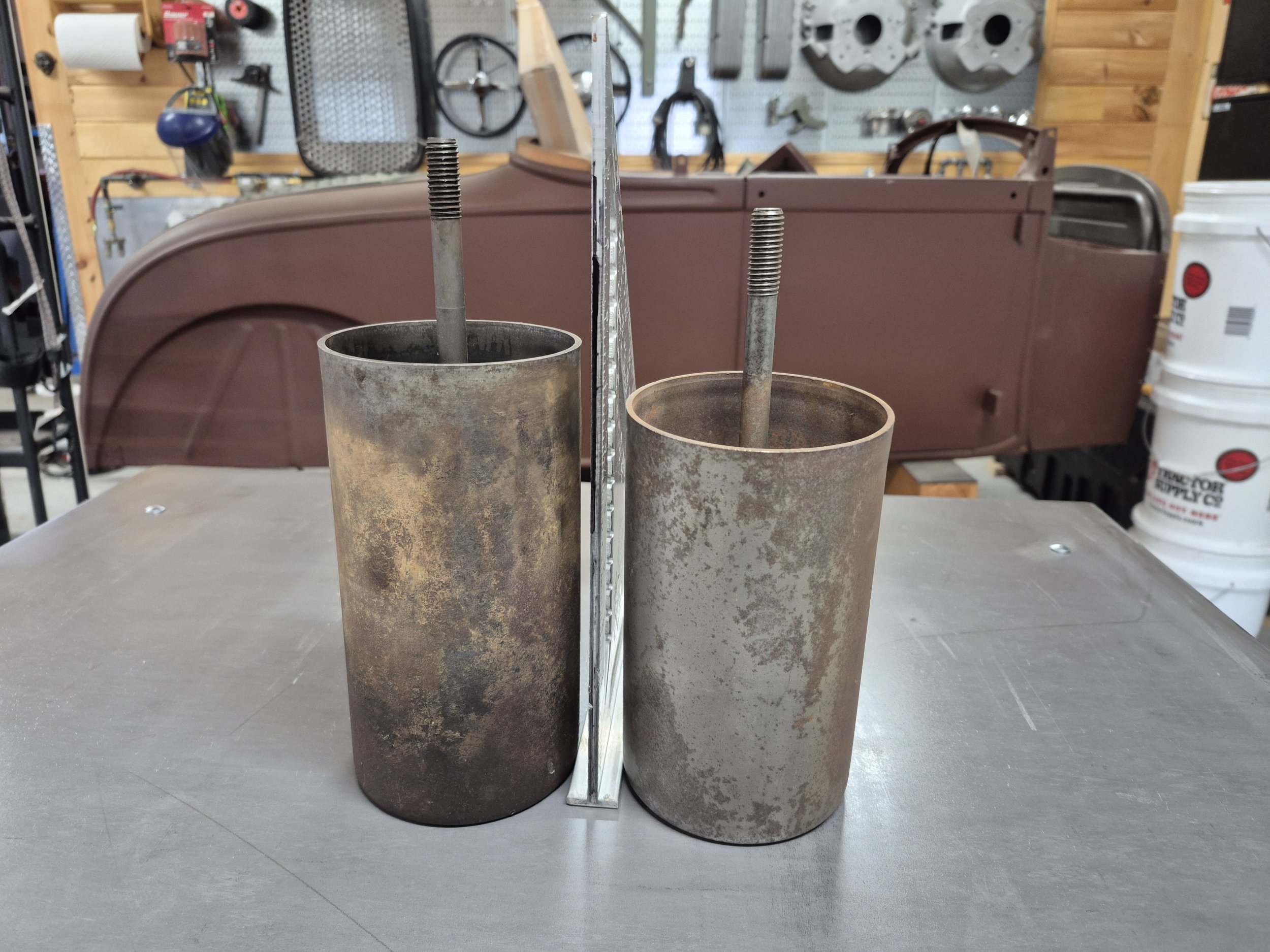

    Here are the two canisters that you usually find. The tall truck and the shorter car. It's possible with so many unique applications you could stumble into something different. The truck canister is 7 1/2" tall and the car 6 1/2".
    clem, anthony myrick and Blues4U like this.
