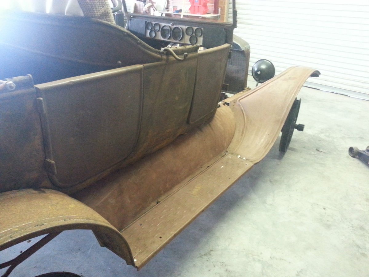

    This is what I've bought to build.
    From what I can see it has '40 wheels and brakes, a dropped front axle and smaller headlights mounted inside the stock Model-T units. Model-A bumpers and hydraulic shocks mounted at a silly angle. It was painted bright red. Steering column and wheel appear stock. I'm sure Norm used a real steering box though. Also what engine? Flathead V8 with '39 transmission would be ideal. Rear axle - '36? '40?
    Ideally I'd like to retain the original T frame. Any inspiration on making this rigid would be appreciated. I've never built a car on a T frame before. I'm thinking of a rigid X subframe which bolts inside the original frame.
    I love the tires. Are they still available?
    I think I can build this for a reasonable price. I have most of the V8 parts already.

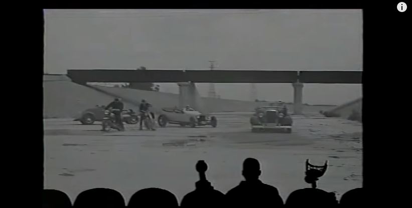

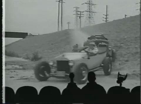

    Screen shots from "Girls Town" looks like a considerably different car (although could be the same body). Either way Norm G. is definitely driving the car. Can't believe I've never seen this episode of MST3K! Watching it tonight!
    I'd like to see more pics of this T if they exist.
