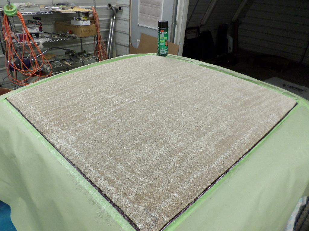

    Cut some indoor outdoor carpet and glued that to the Masonite 121 034.JPG 121 035.JPG .

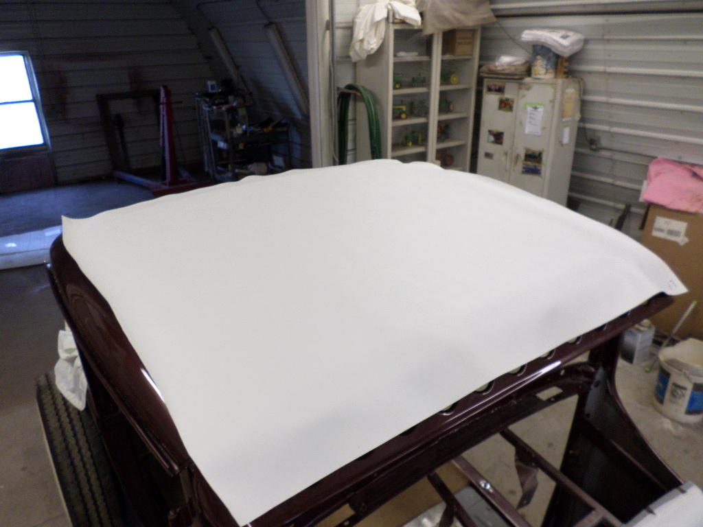

    Trimmed the vinyl and nailed down the Hydem welt. Put construction caulk under the edge of the vinyl to seal it. Then about 250 really small nails and presto, instant roof,lol. 121 041.JPG 121 042.JPG

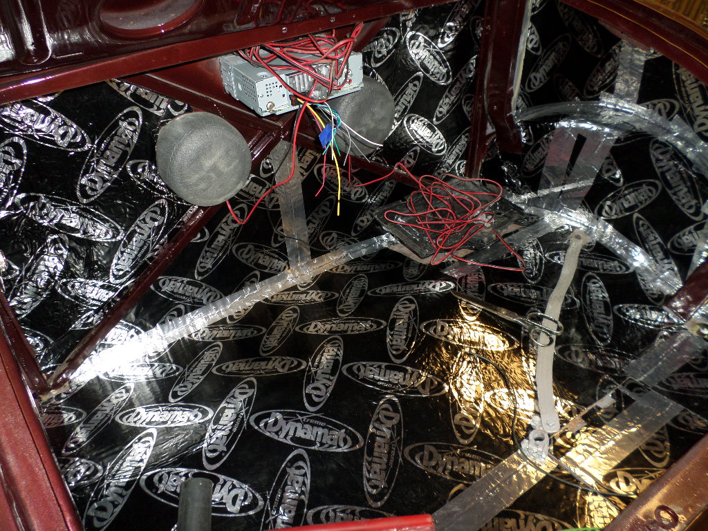

    Time to insulate some interior. 121 006.JPG 121 005.JPG 121 004.JPG 121 002.JPG 121 002.JPG 121 004.JPG 121 005.JPG 121 006.JPG

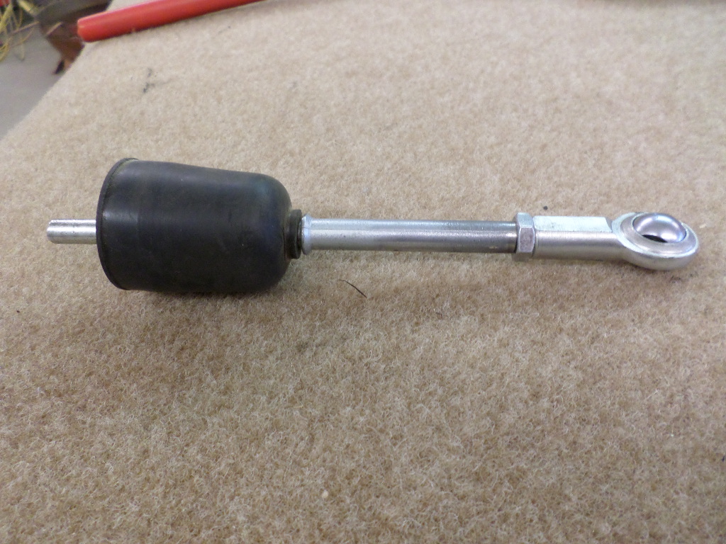

    The boot for the master cylinder fit the cylinder a little loose and the push rod snug, so to prevent it from sliding forward on the push rod I made a spacer from some gas line. I also put a small spring on the brake arm just cause I could.

    Finished insulating the trunk and made some gl*** patterns. 122 001.JPG 121 036.JPG

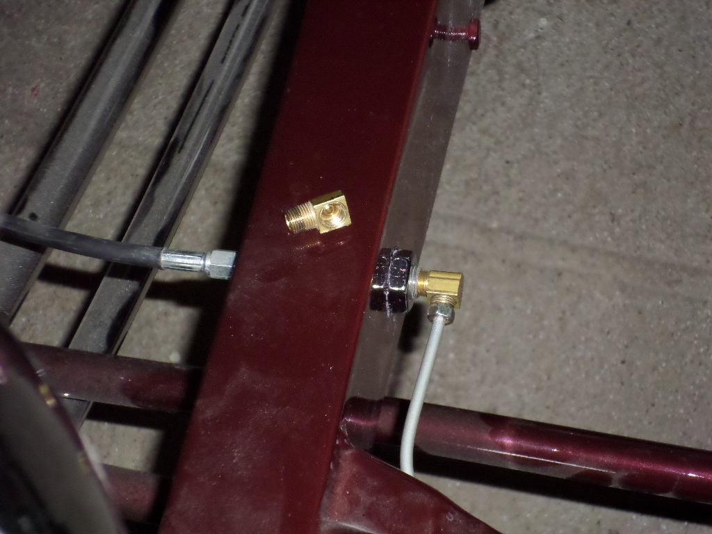

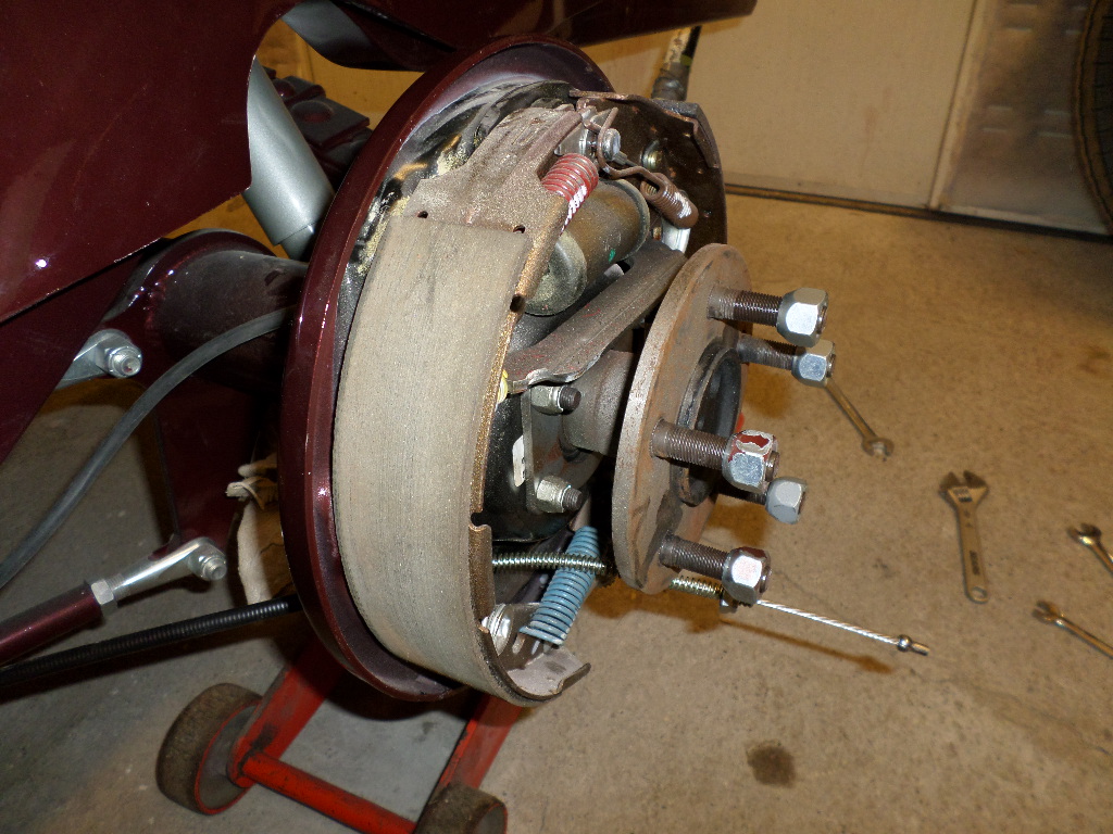

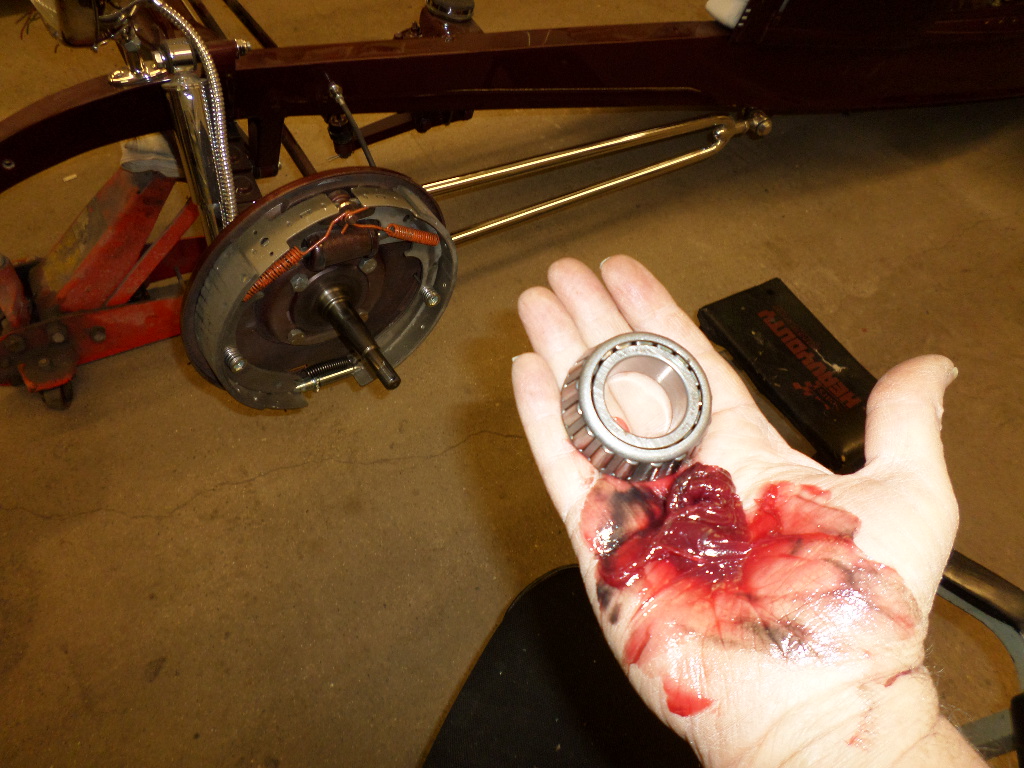

    123 001.JPG Put the E brake cables on the rear end. 123 004.JPG Then I went around and checked each brake line fitting making sure they were tight, I found one fitting that I had cross threaded. 123 005.JPG Finally I put the brake shoes on the front and greased the wheel bearings.

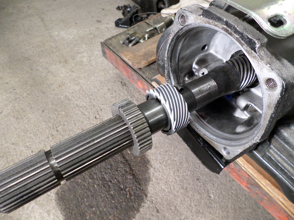

    Got to work on the transmission to make the speedometer mechanical. 124 001.JPG 124 005.JPG I cut the reluctor ring 99% through then some pressure with a screw driver and it popped lose. I used the ring to gently push the new gear on. 124 006.JPG 124 007.JPG Once I had it re***embled I could put on the correct pulse maker for my speedometer.

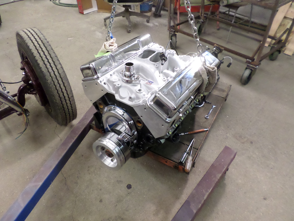

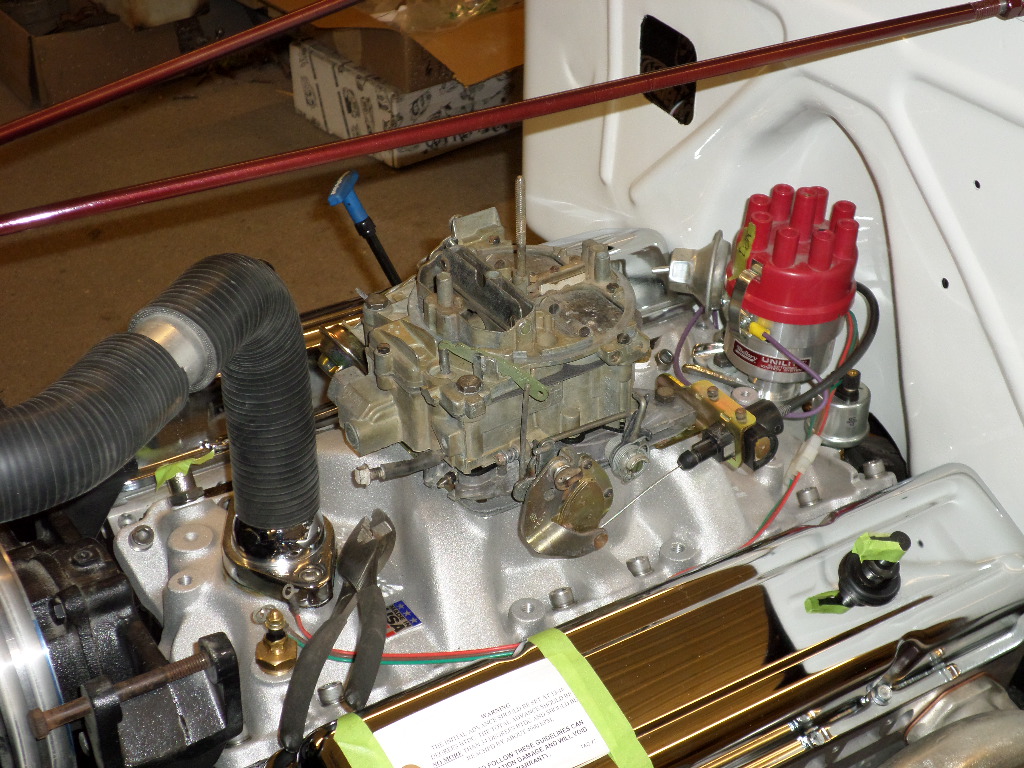

    Thanks guys, When I was doing the top and I cut the carpet half an inch too short on one side so, back to the store for another piece. Did some ***embly stuff on the engine today. 125 001.JPG 125 002.JPG 125 003.JPG 125 004.JPG
    Just before I quit for the night I set the intake on to see if I could install it without removing the valve covers and I can.
    kiwijeff and Studebakermatt like this.

    Did a few little things like water temp and oil press. sending units and lets see, oh yea, put the engine in. Managed to do it without chipping paint too. 126 005.JPG Now I have to try to figure out the hundred little things to do next.

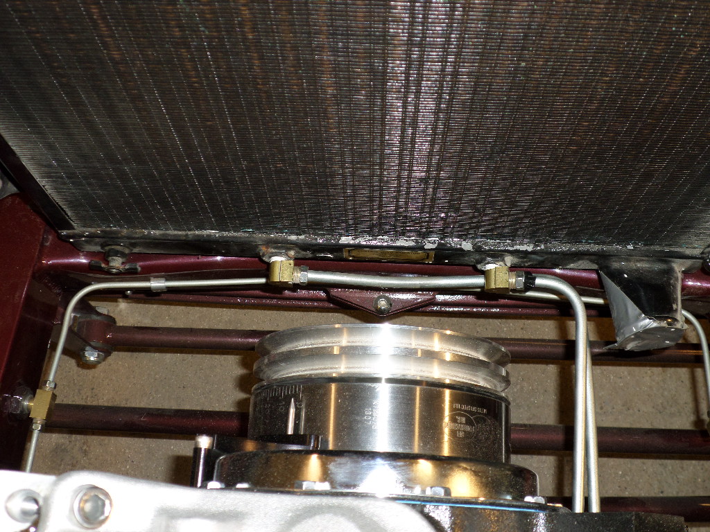

    Put the radiator on and then hooked up the transmission lines. I wrapped Teflon tape around many times and turned them on until they turned quite hard> since they have to point to 3 o'clock I hope they are tight enough, I wish there was a better way. 127 006.JPG 127 004.JPG I installed a Dakota Digital gear indicator to the trans. 127 005.JPG

    Decided to overhaul the Q jet. 128 001.JPG Took it all apart and put br*** bushings in. 128 004.JPG Pretty much all new now. 128 008.JPG
