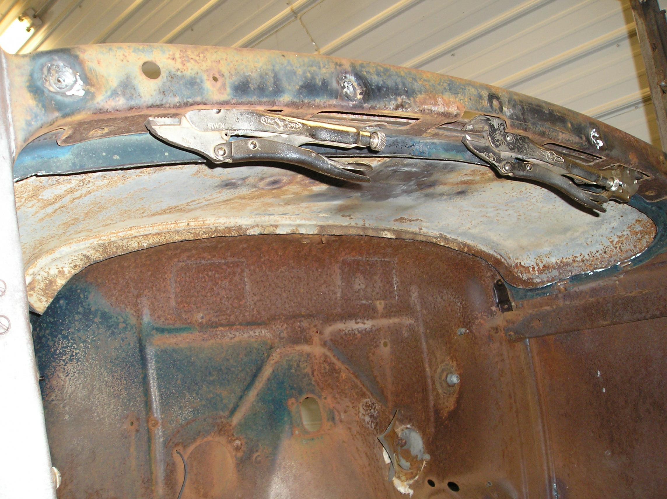

    I did some repair work to the metal above the gas tank. Then I cut the bottom out of the gas tank and cut off the gas cap.:)

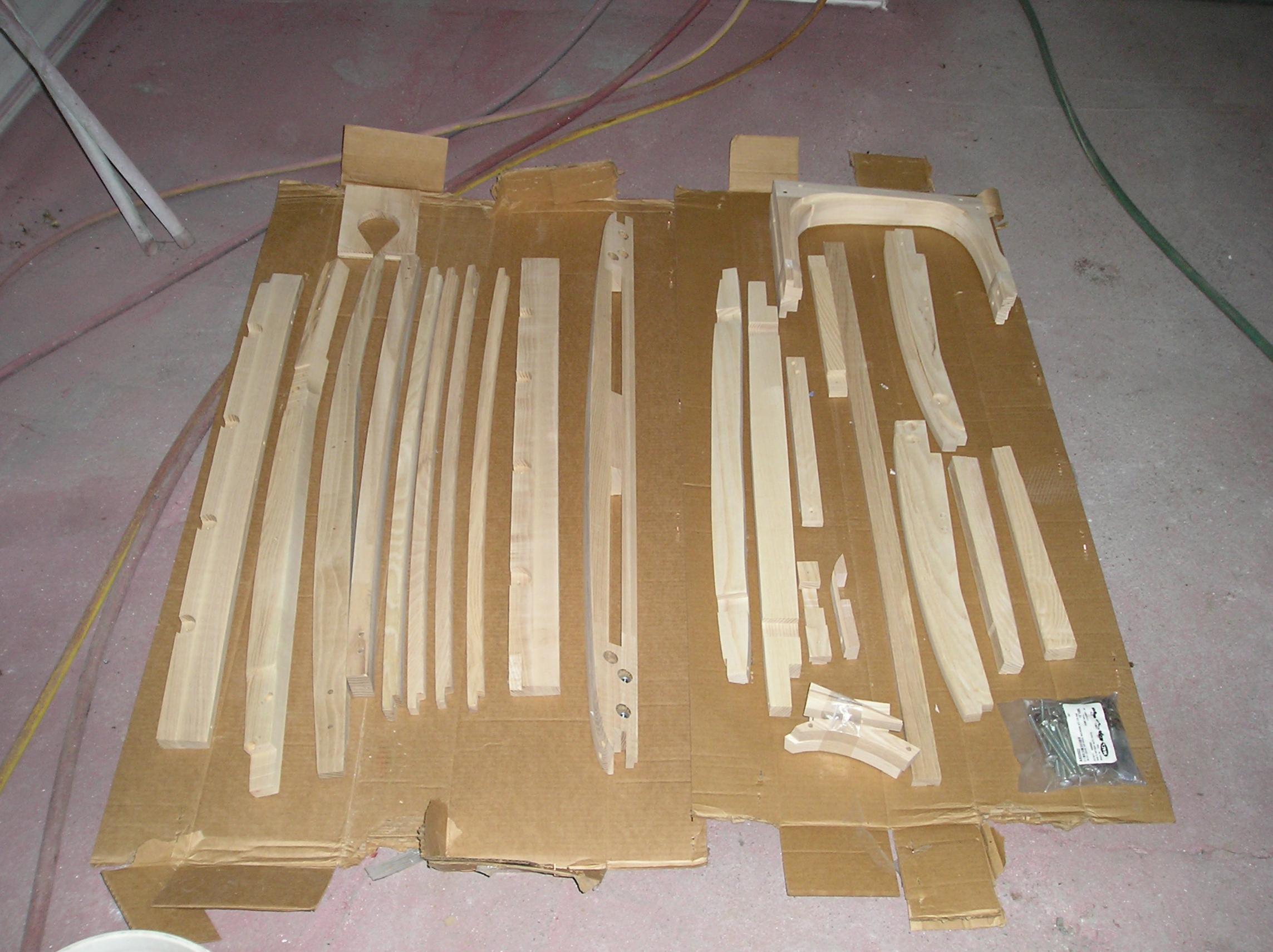

    got my wood kits and put them in. it took a lot of pushing, prodding, and prying but the wood ended up fitting pretty good.:) it stiffened up the top of the body pretty well too.

    I got my wood kits and some other stuff from Mac's Antique Auto Parts in New York. Took 5 weeks for it to come but it is good stuff.

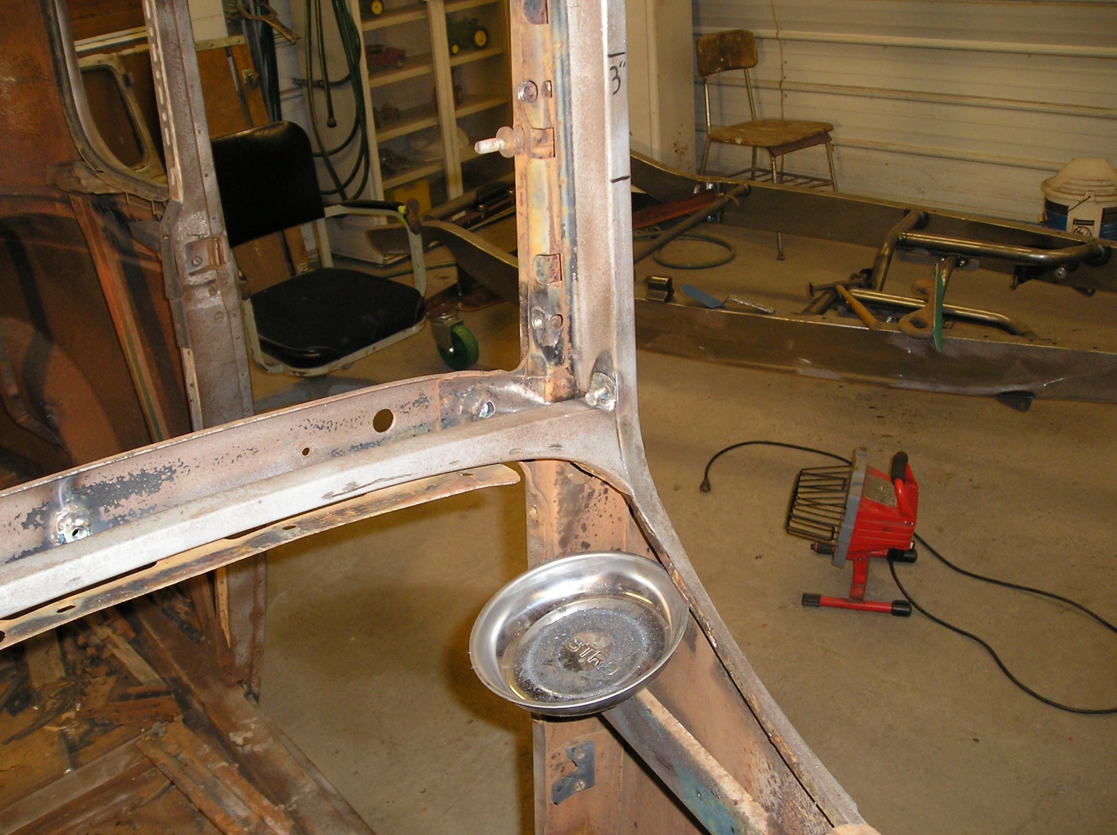

    Once the wood was in I pulled the top together to start nailing.
    I had to remove about 1/4 inch of wood at the front of the header to get the visor to fit.
    I took out 2 inches out of the front spreader bar and it actually fits.:)

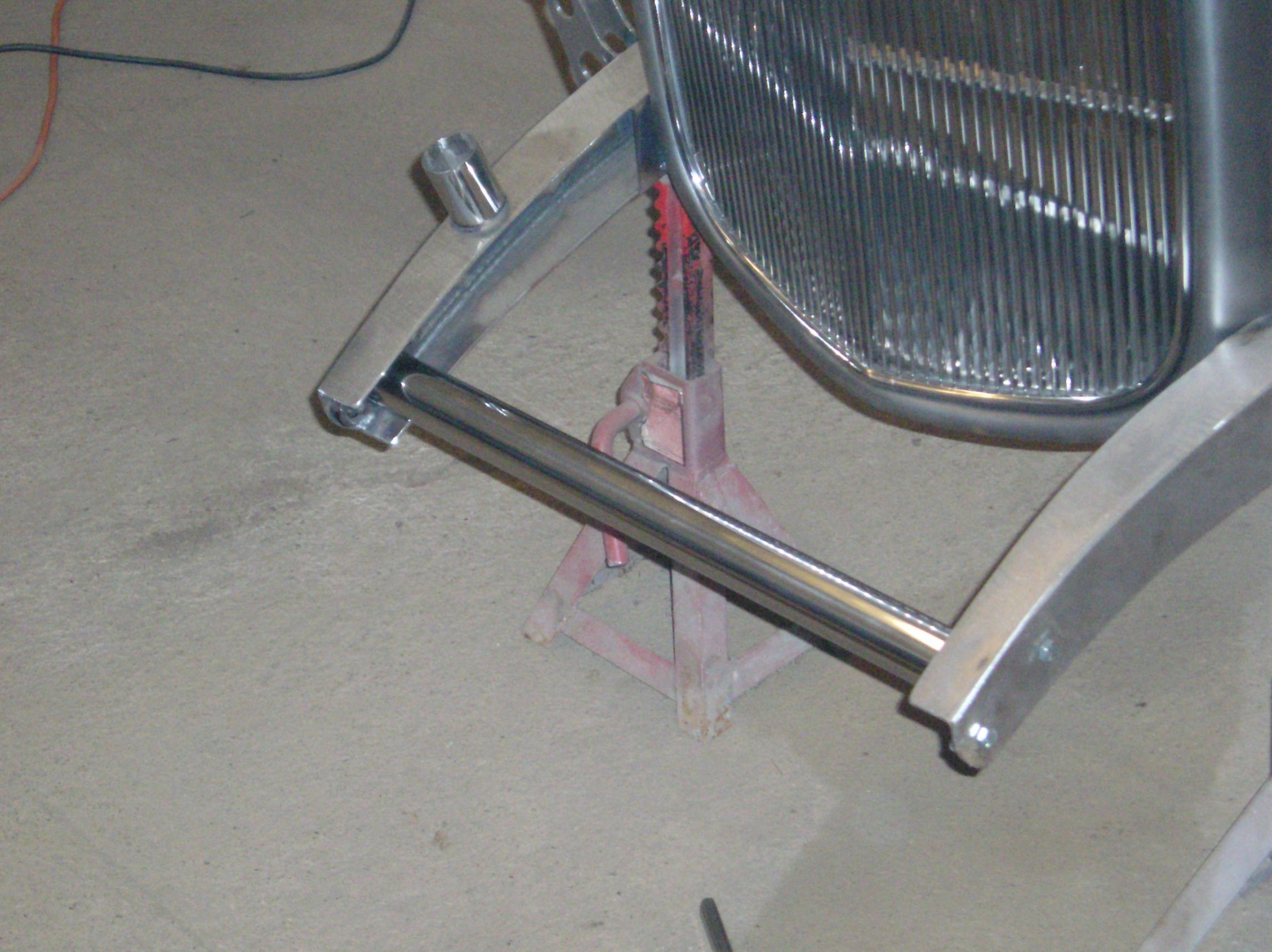

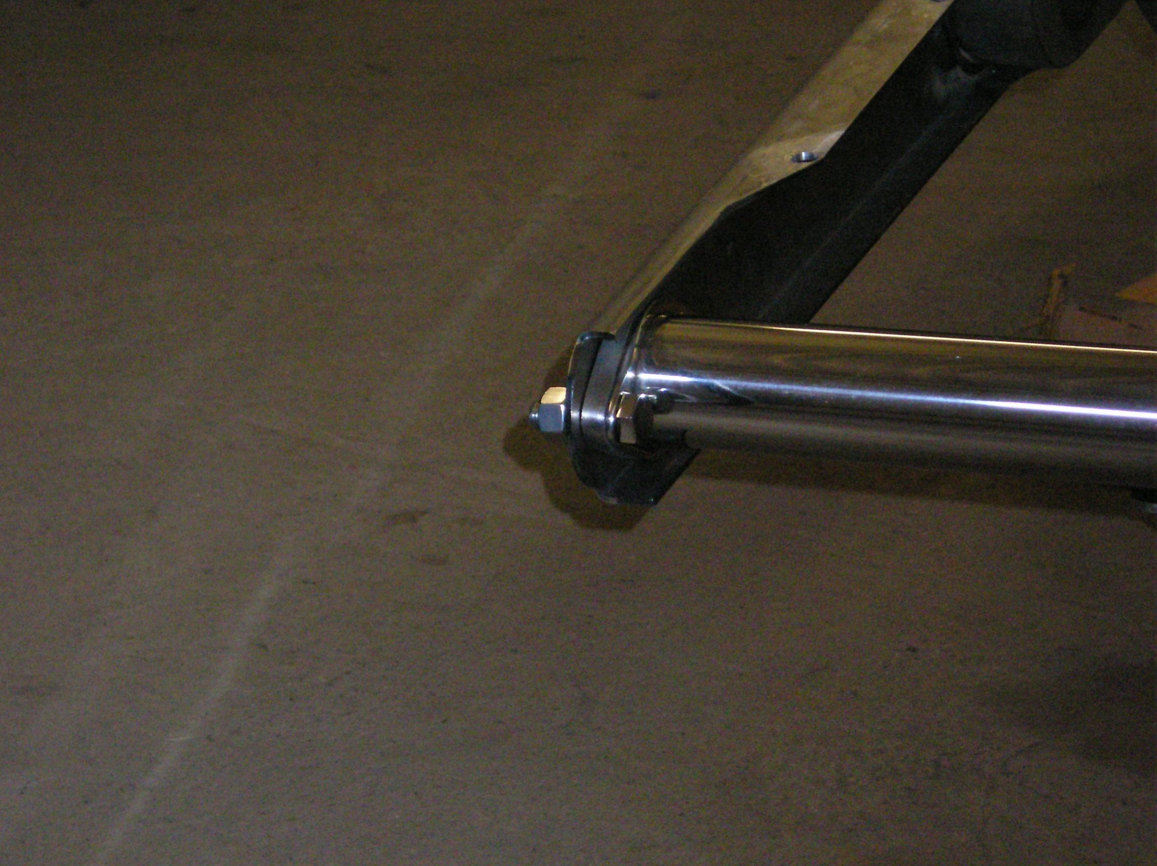

    I got a couple frame horns and fitted them and put them on so now I can have my 32 tank on the back.
    I made a couple 3/8ths spacers and put one on each end of the spreader bar, that seemed to help to get things in better alignment.
    Finally I boxed the horns a little, I think it's stronger and looks better:).

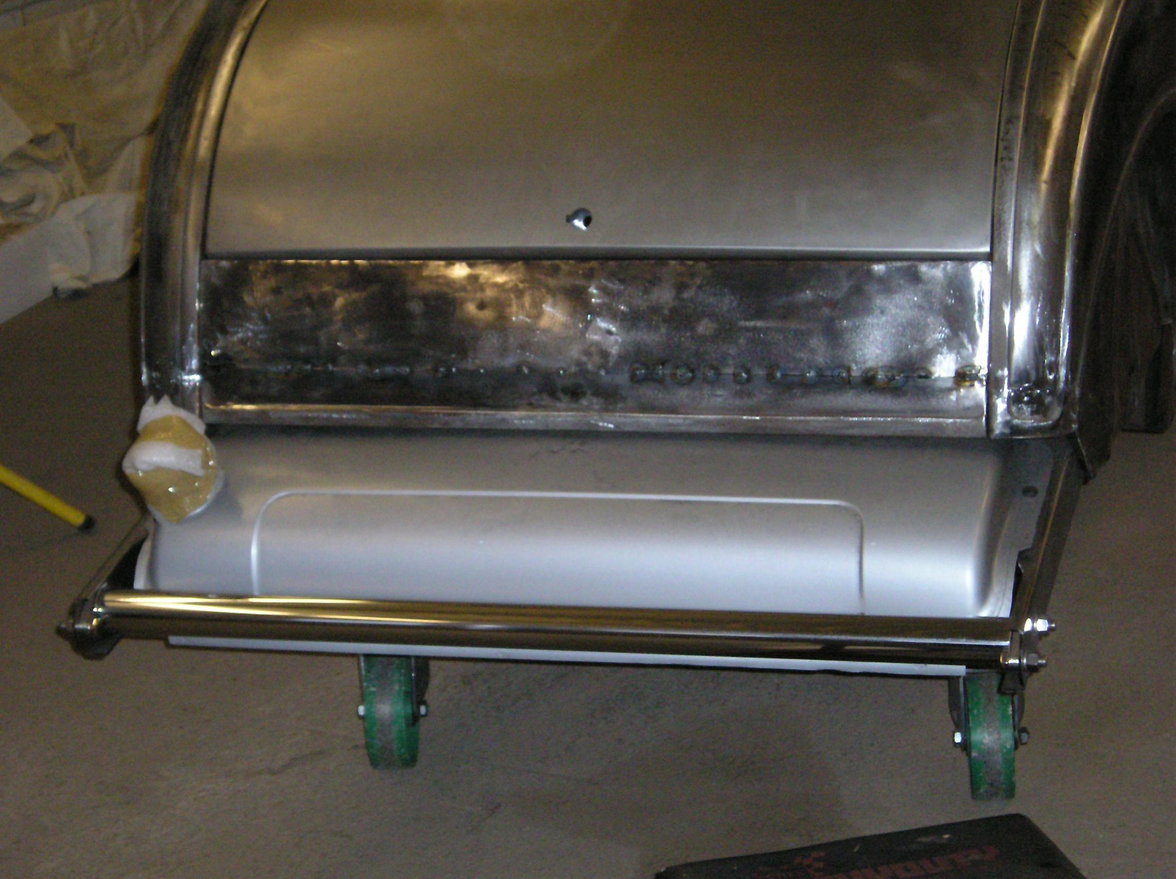

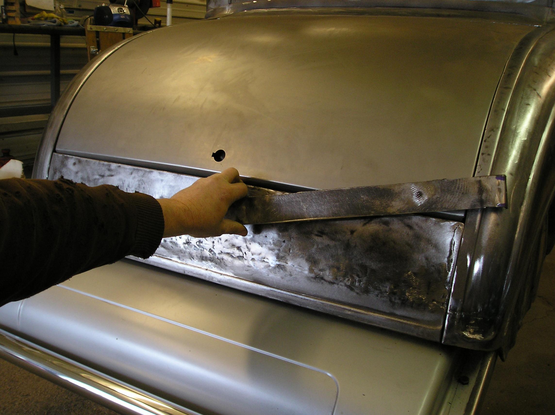

    Did some sectioning on the back so the tank and body don't fight for the same space. Ended up taking out 1 and 7/8ths inches.
    The panel was very rusty on the back side and tough to work with, I got it welded but it looks just a little rough:(, it will work ok though.
