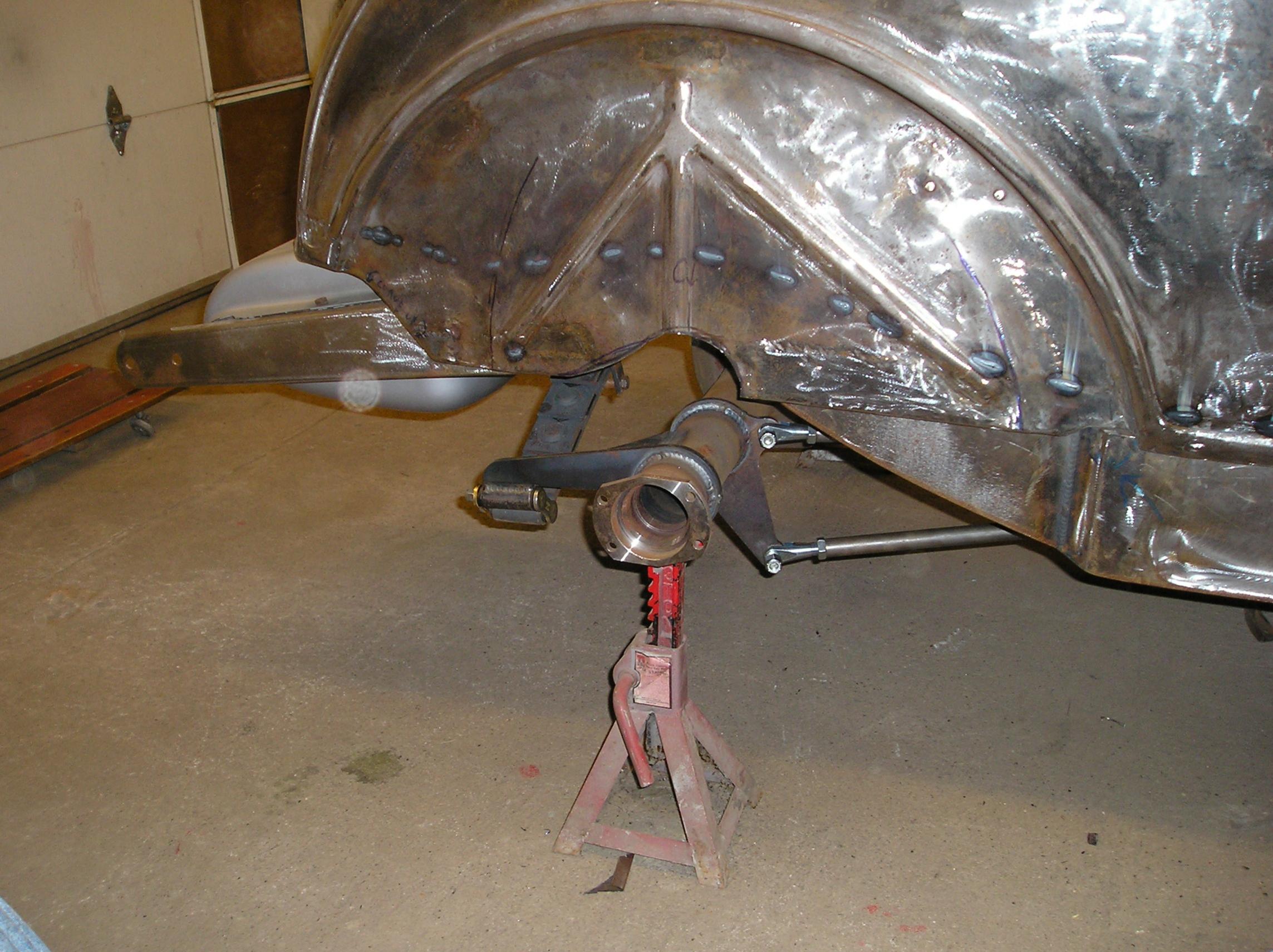

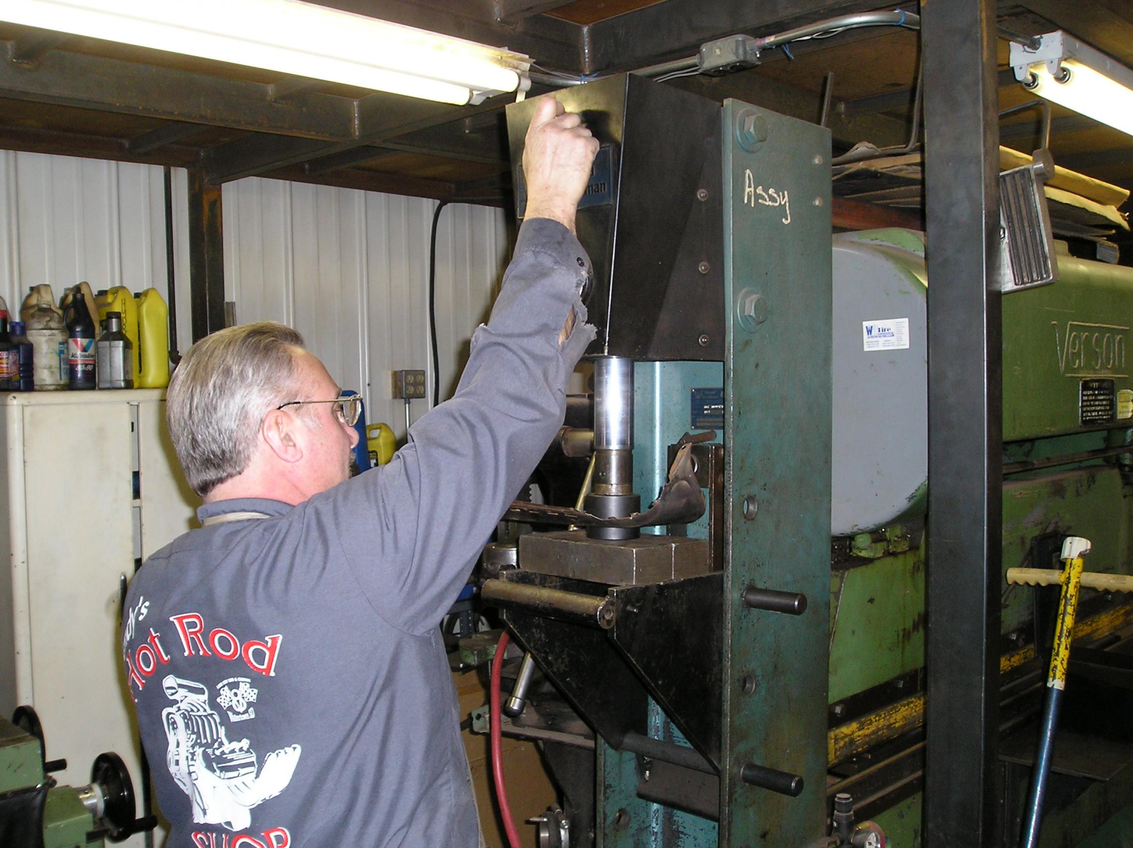

    I went to Watertown a few days ago to talk about getting some parts at Randy Gribble's shop, and while I was there I got punched :eek:!!!
    Yesterday I got the rear suspension put on, I had to trim just a little sheet metal for everything to fit just right . Now I have about 3 and one half inches of travel before anything would hit. That is with the 2 shortest leaves in the 9 leaf spring removed.
    Today I have to do some finish work on the metal edge that I trimmed yesterday.

    not trying to be negitave nacy but that grill looks to strait up and down like it needs to be laid back. just my 2cent great build
  23. norms30a
    Joined: Jul 17, 2008
    Posts: 599
    norms30a
    I'm planning to lower the grill shell one and a half inches and I'm thinking I might run a hood top, not sure yet.
    So when I put the radiator in I will try to set stuff up so a hood top will fit from a 32 as that is really close to the right length . The pic I took was really just to see how tall it was, you are right, the angle looks off to me too.

  28. chopt top kid
    Joined: Oct 13, 2009
    Posts: 959
    chopt top kid
    I really like the visor. If I could find a guy with some die's like that I'd consider getting mine punched.
    I've thought about cutting my wheelwell for axle clearance and wondered if moving the bottom of the center bead up above the cutout would be worth the effort???
