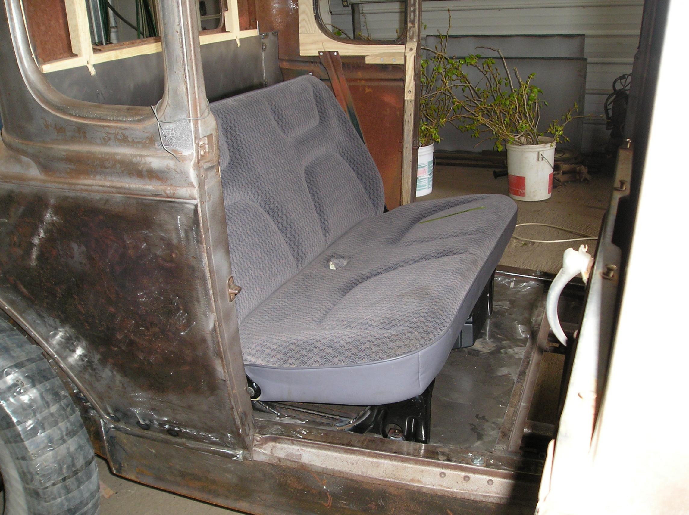

    Went to a local salvage yard and got a middle seat out of a 99 Chrysler mini van.
    The seat did not fold forward when I got it so I cut slots on the sides and now it folds nicely.
    My helper decided to ham it up for the HAMB.

    Got my seat install finished, saved the cup holder, don't know if there will be room to use it with 2 people in the car.

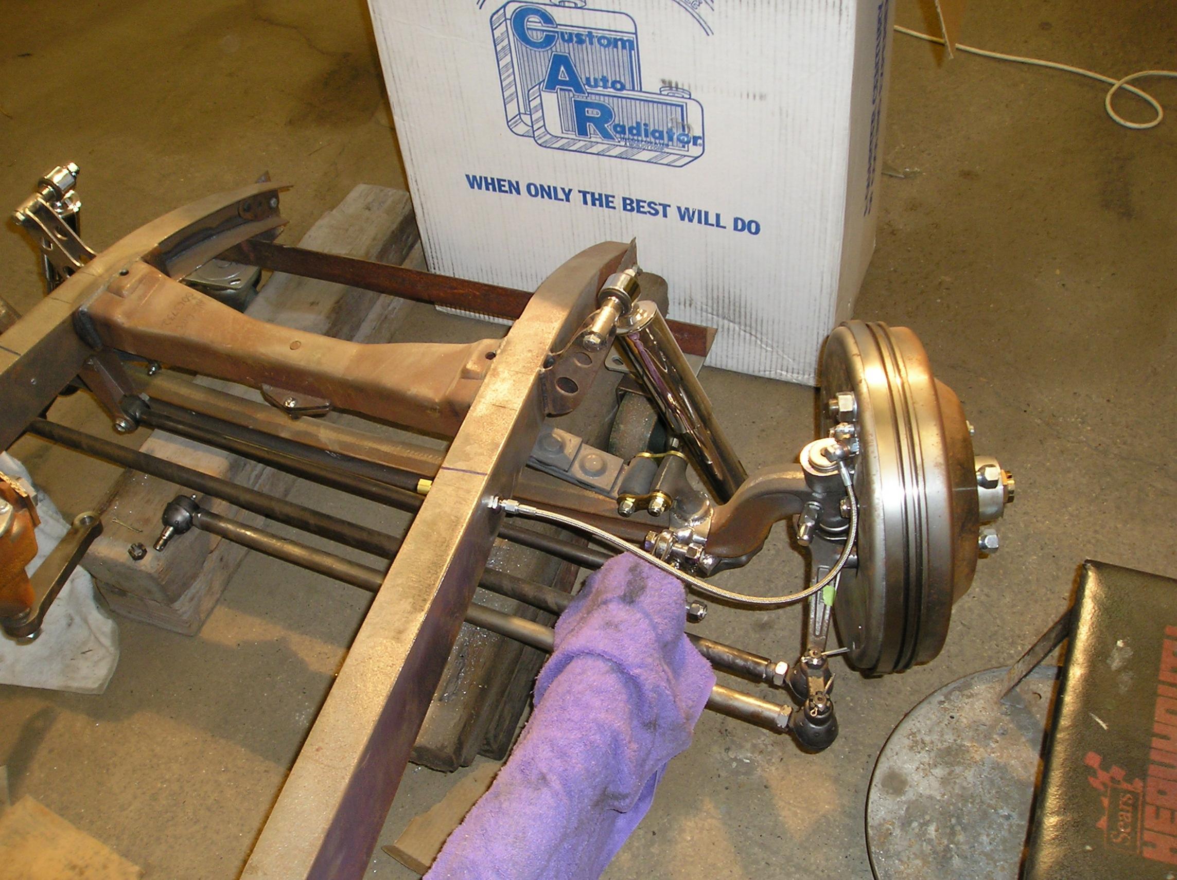

    Got my brake lines run and my inspector approves!:D

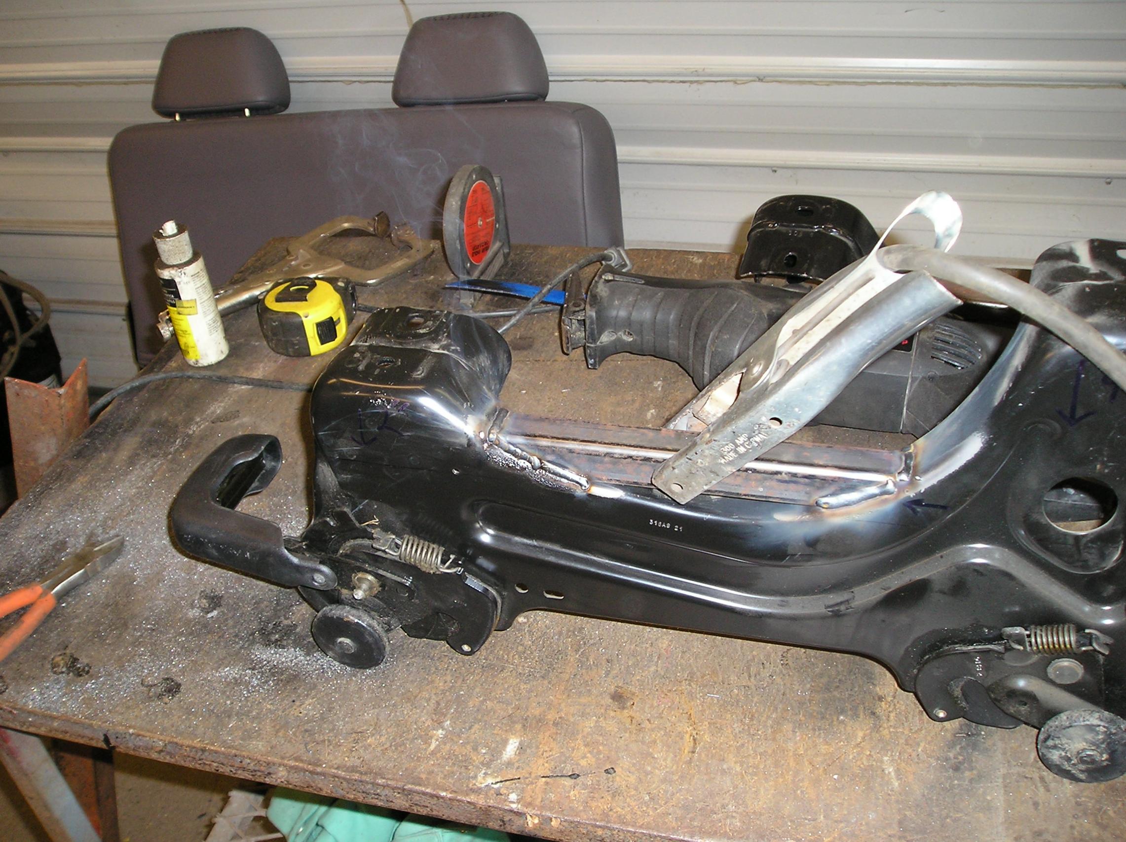

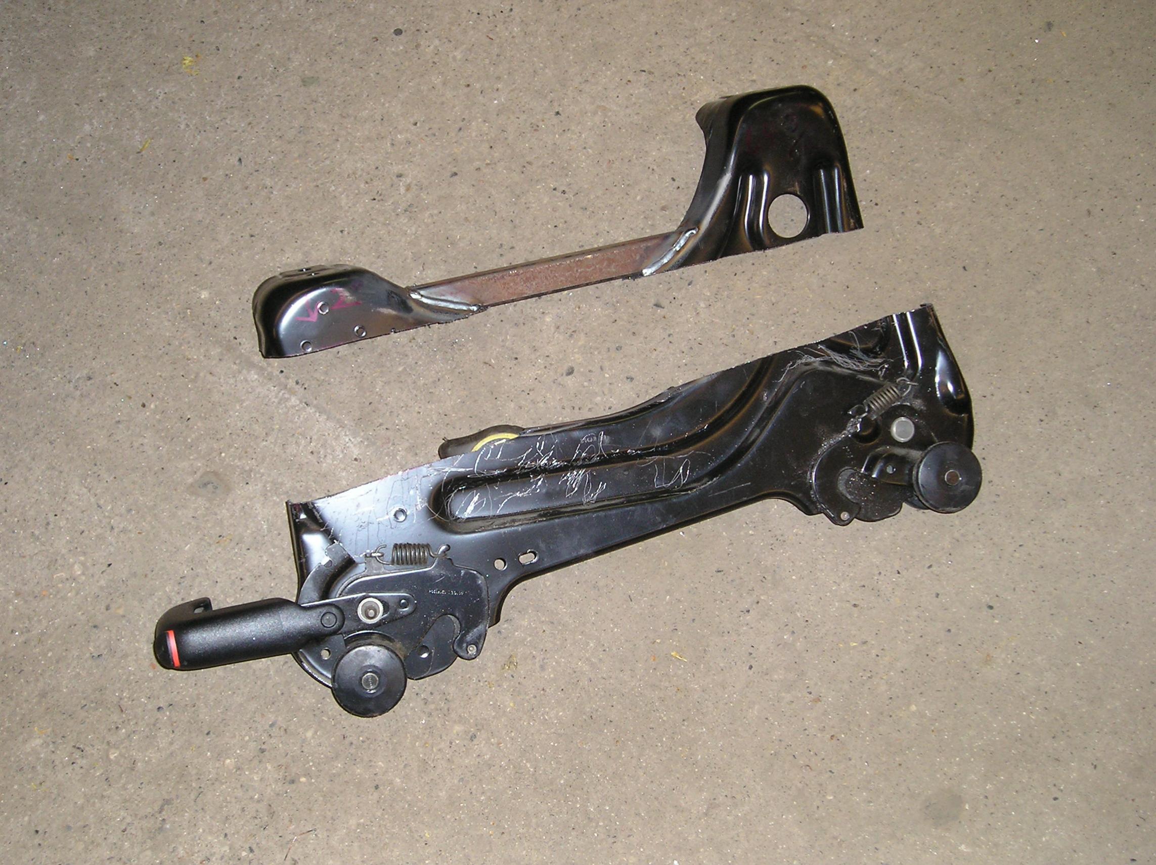

    Found these pics on what I did to the seat mounts, I plan to have a skirt around the base after upholstery so appearance isn't so important.
