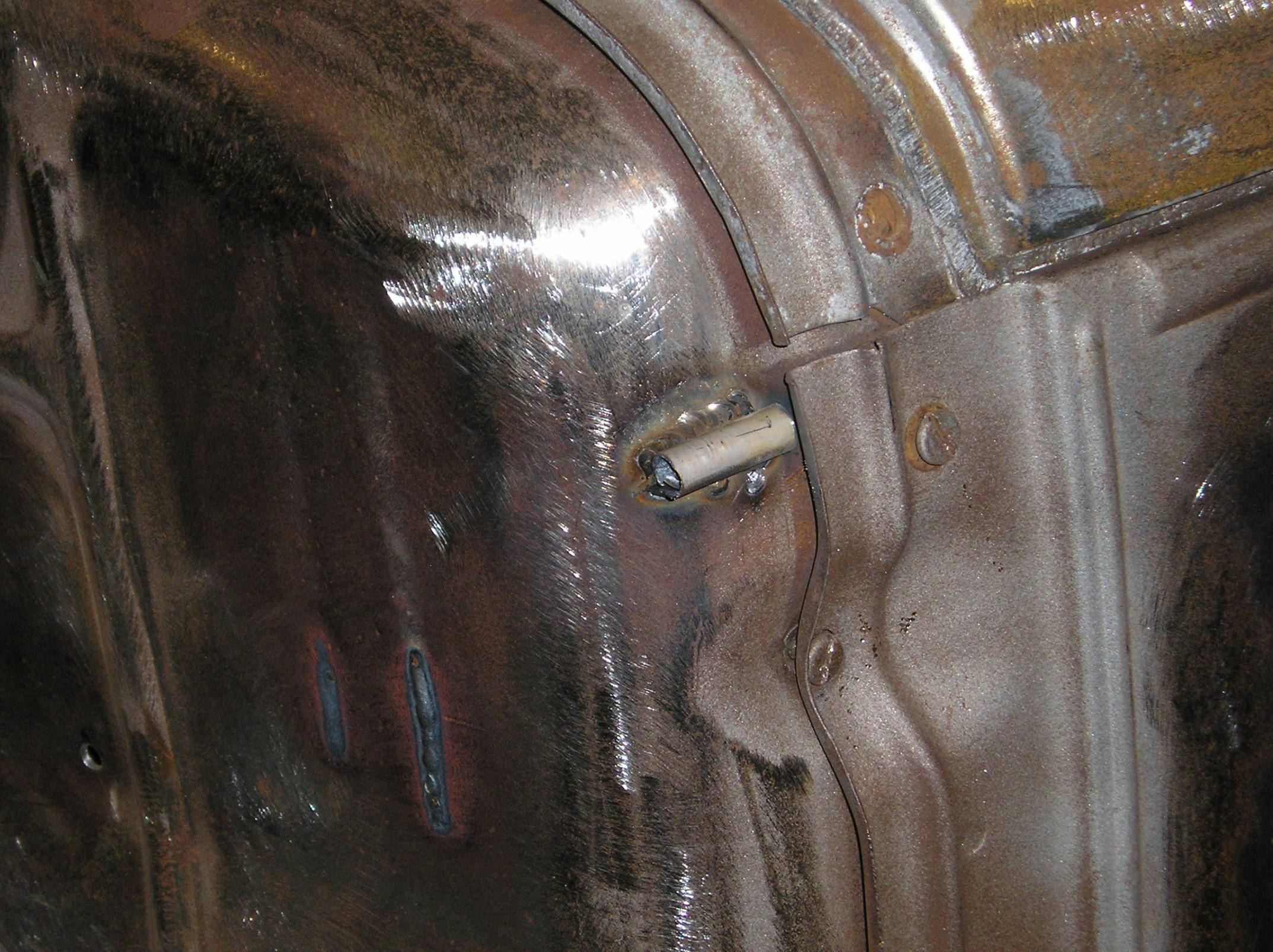

    thanks guys.Got done chopping my windshield frame tonight, and I mounted a non HAMB friendly black box under the dash lol.

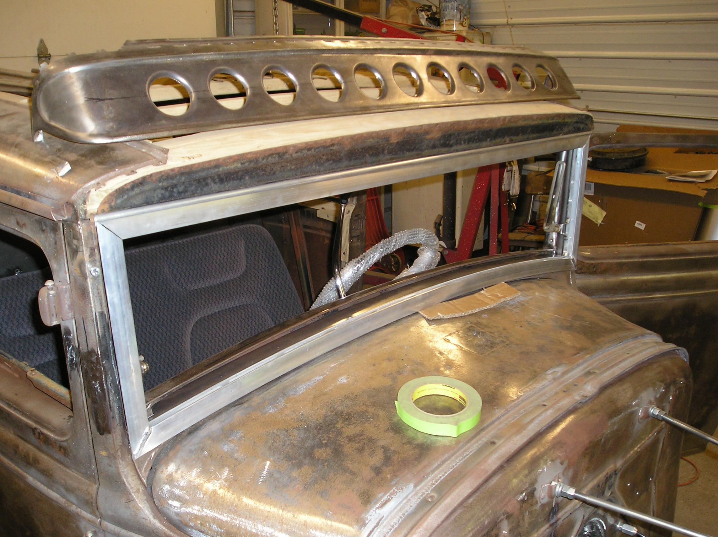

    I finished my windshield frame by filing the corner welds away, nice and smooth. I also mounted my main electric panel so that welding is done.

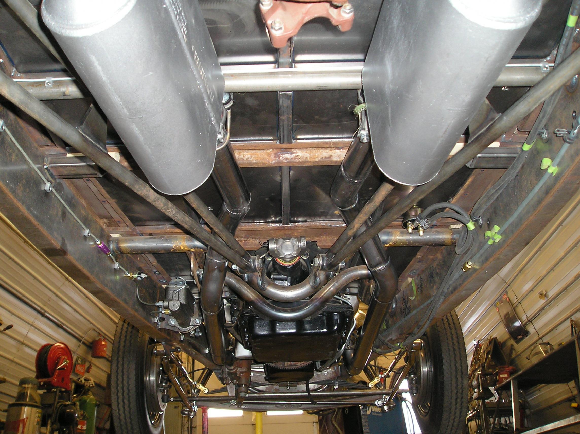

    I built a dual exhaust system using 2 1/4 inch pipe and a couple Flo master mufflers. I can get my finger between the pipe and the steering double D shaft so that should be enough room I think. I have an inch and a half under the rear end for movement.

    I was wondering how the steering and ram horn exhaust would fit. It turned out nice. Car looks great!

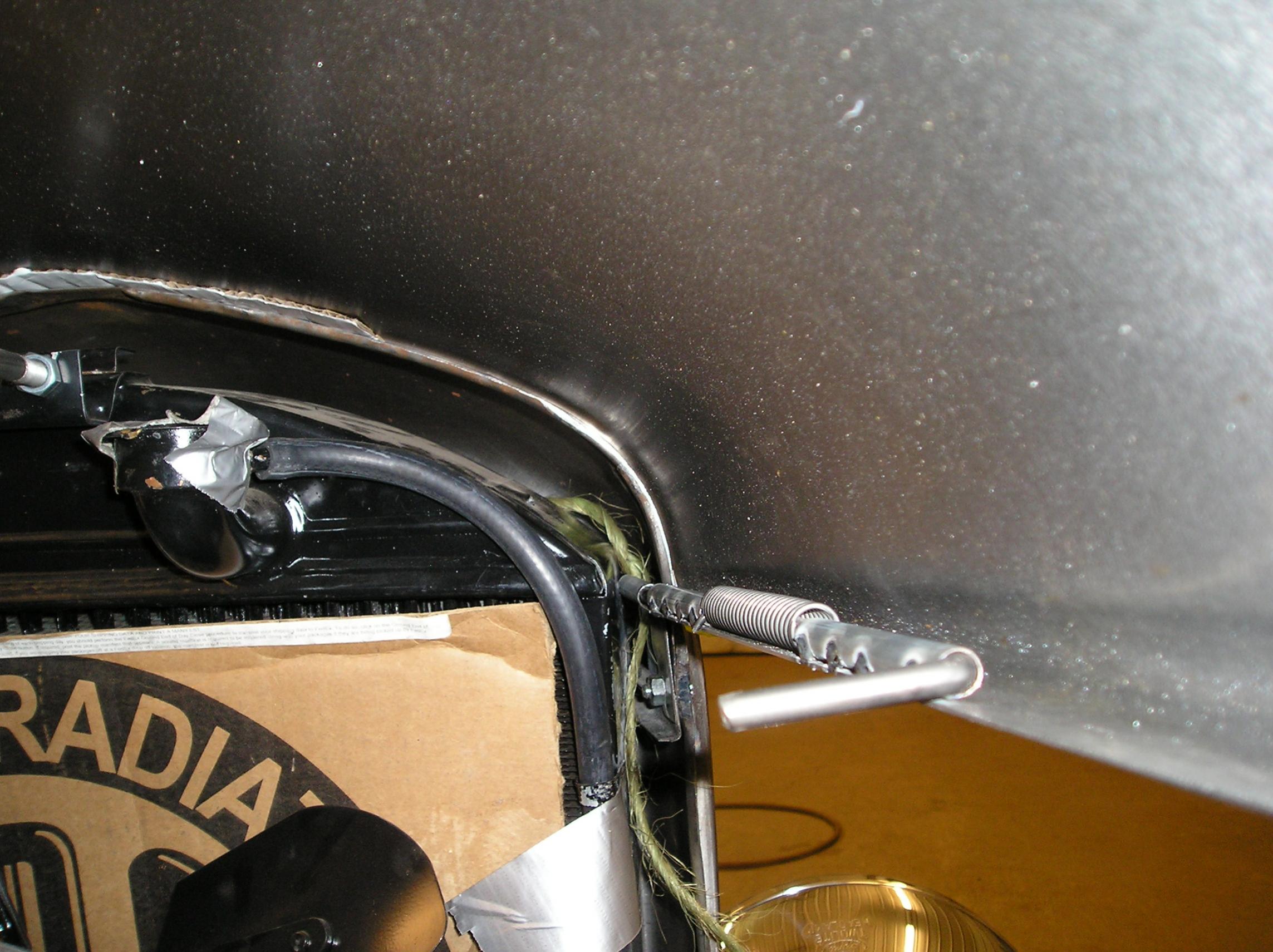

    I mounted my hood by making 4 spring loaded dead bolt latches. Kind of bad pictures but you get the idea.
    The front receivers just bolt to the radiator, the rear 2 I could not think of a nice clean way to bolt them on so I ended up welding them on.
    I had to remove a sliver of metal from the hood top near the center in the front to get the gap correct, looks good now.
