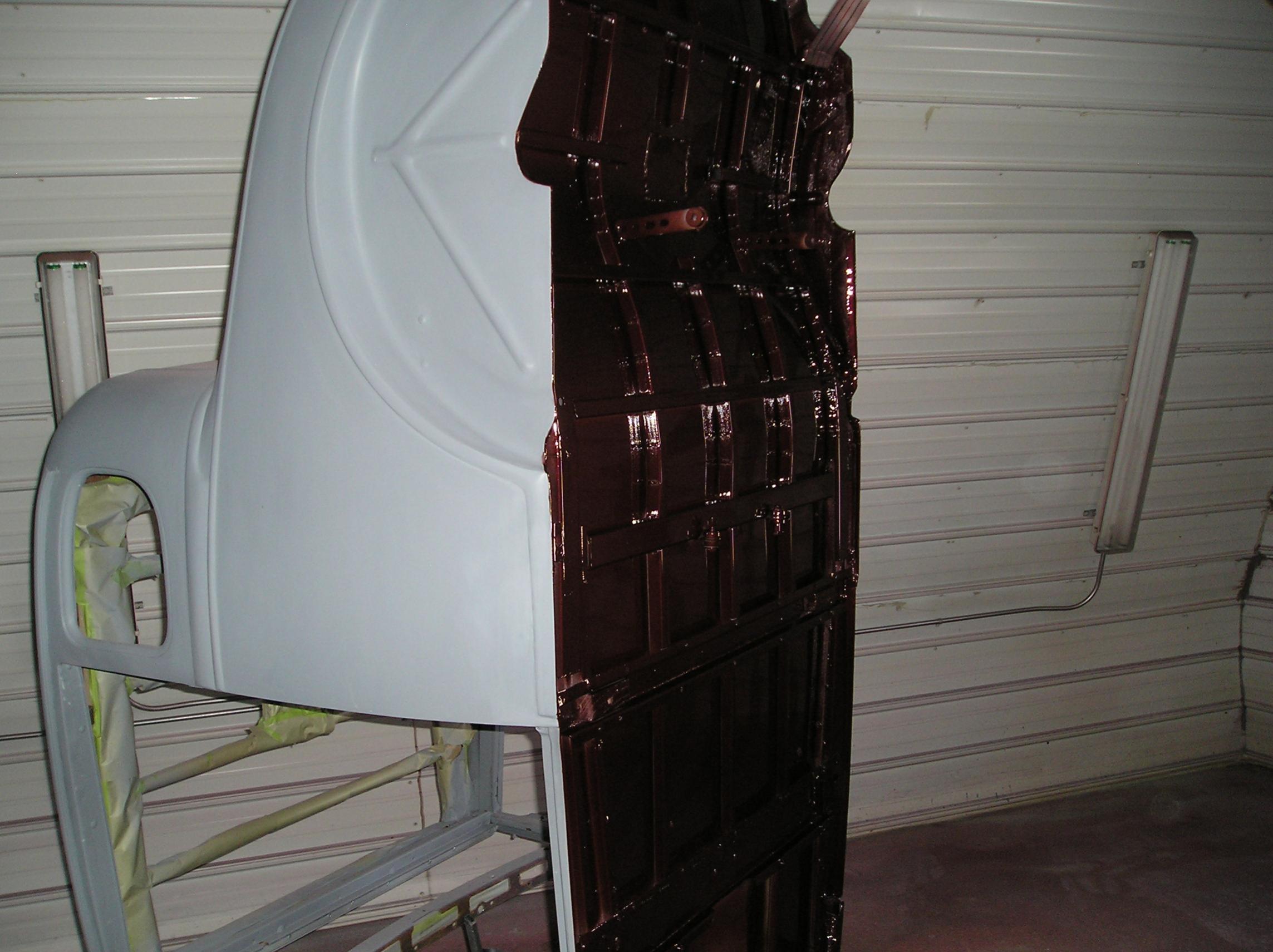

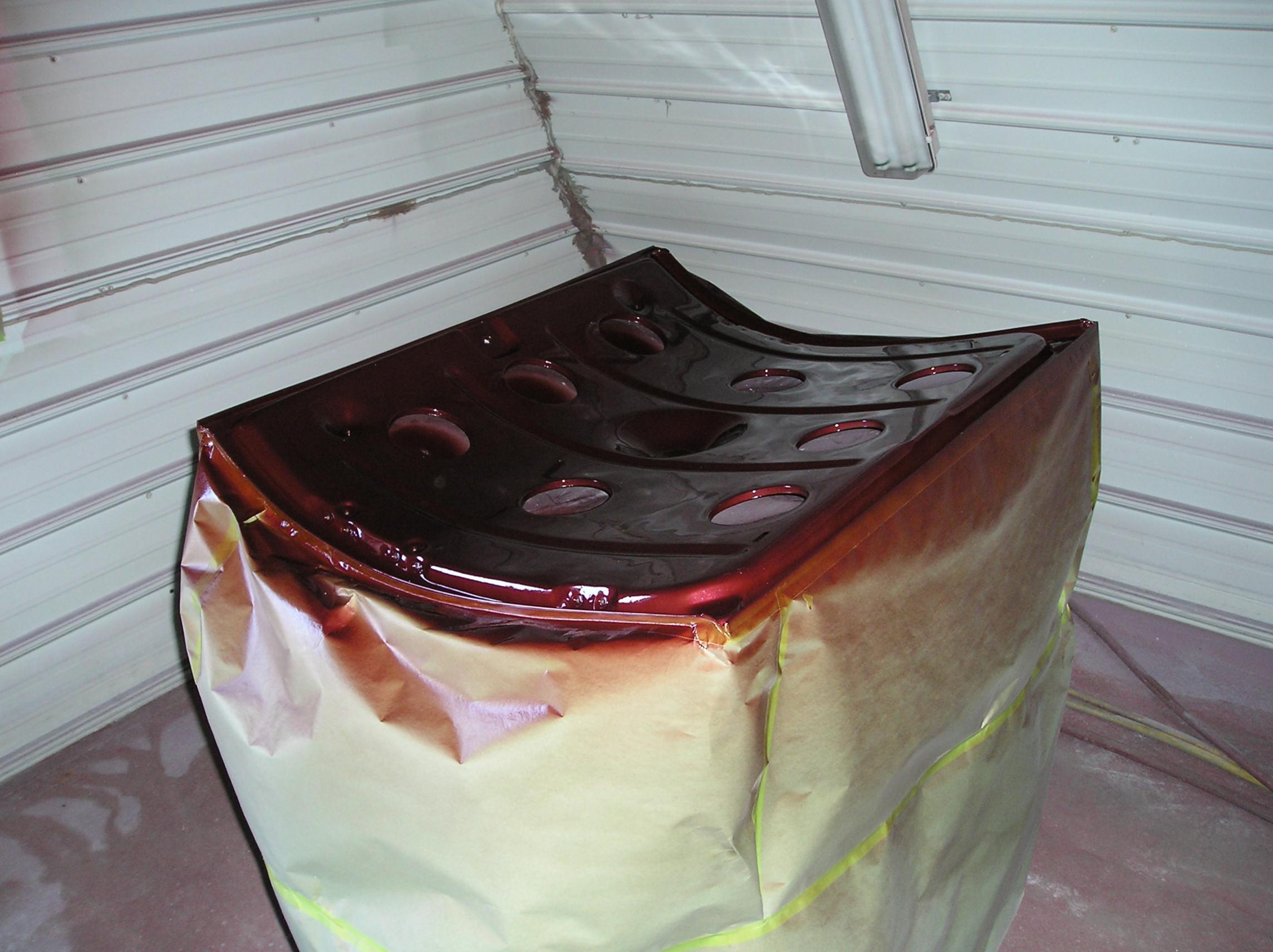

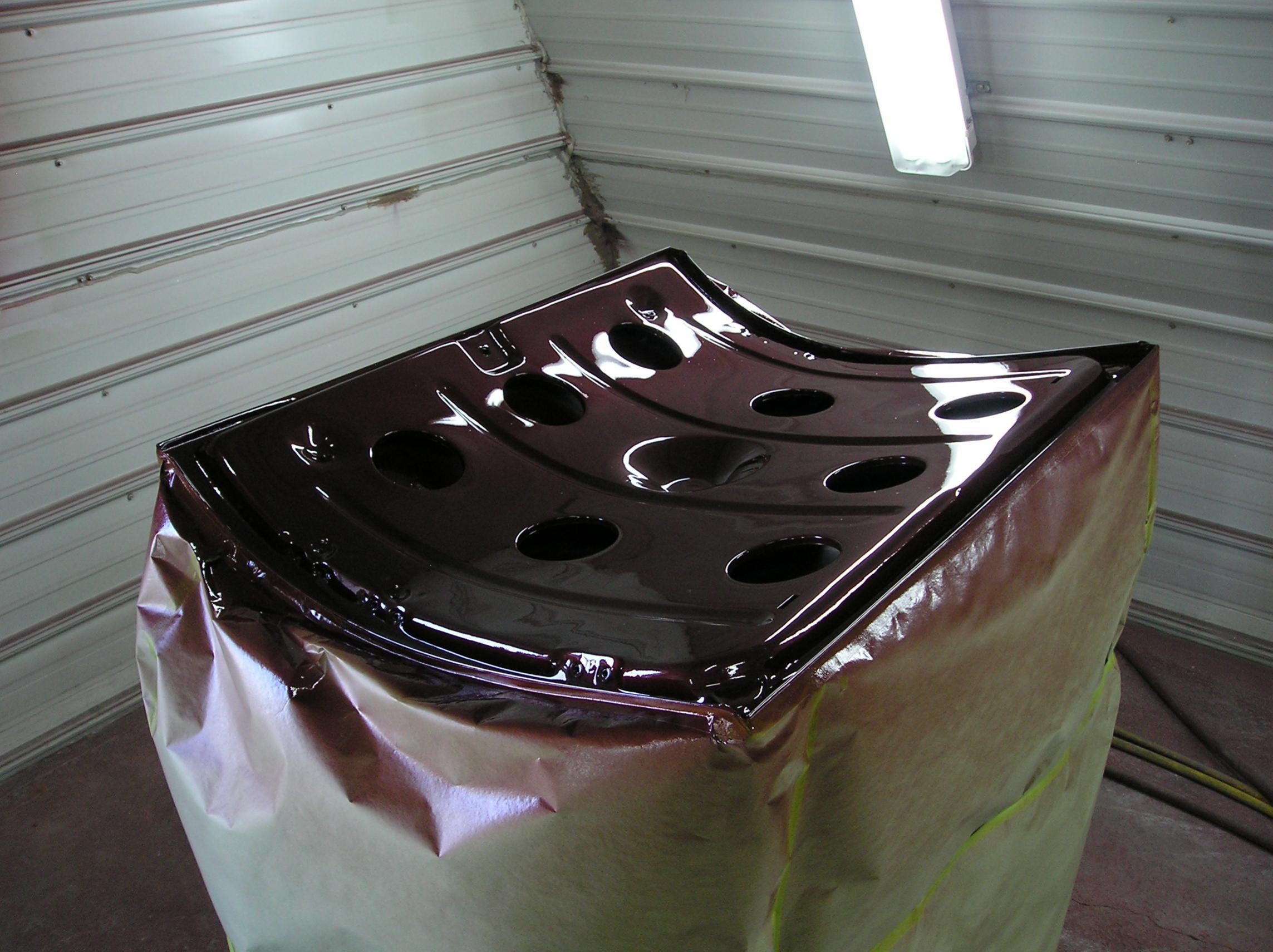

    Shot some more color,:) My daughter had to make my new camera computer friendly so I could post these pics, darn technology.

    I put color on about 50 little pieces, made for a long day,:)
    and yea it is a killer color, at least I like it anyway.

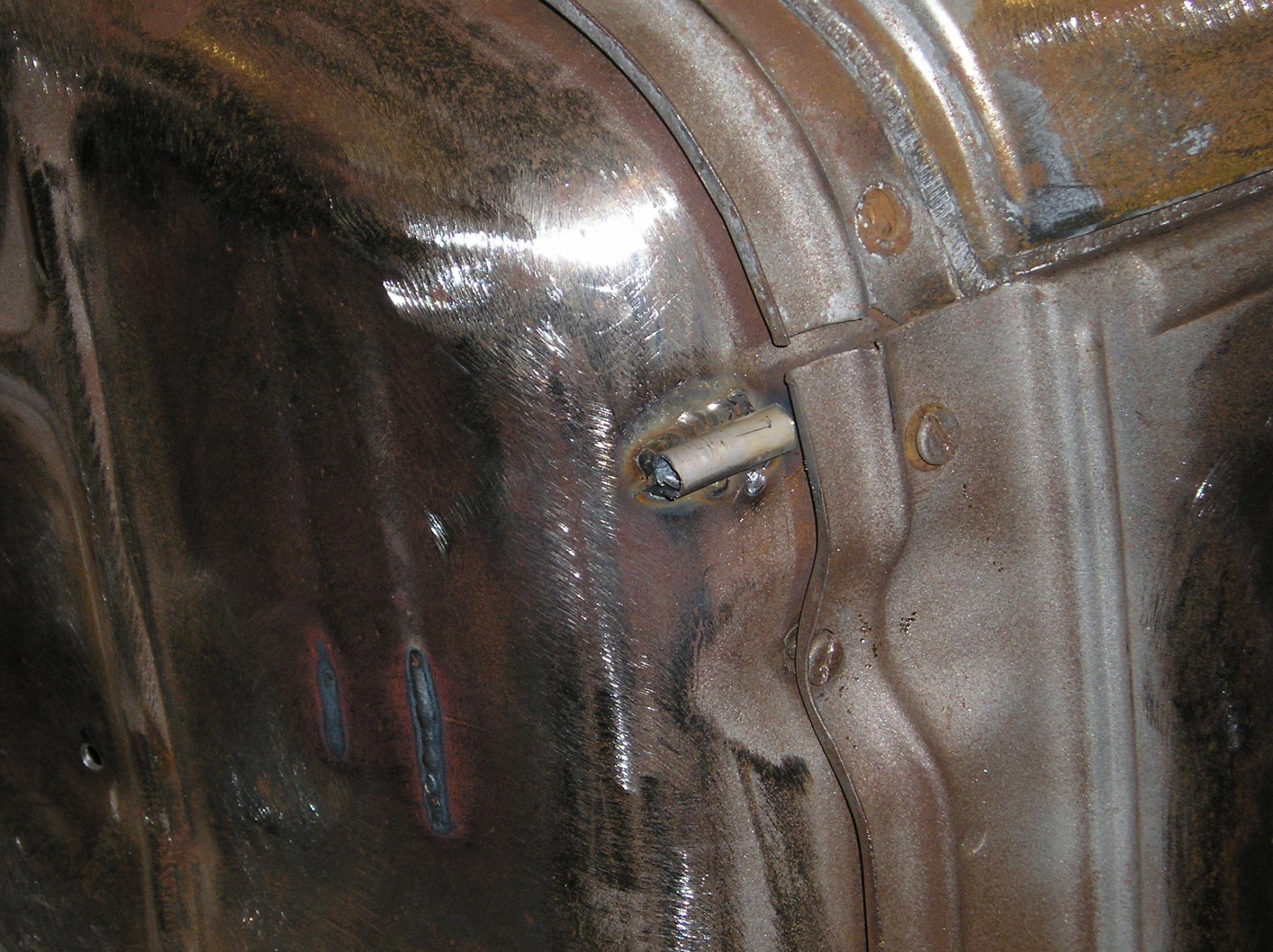

    Bikertrash, my hood latches are home made. I used some steel gas line and some stainless steel rod and a spring and a bit of really small wire to make each latch.
    I cut 2 pieces of gas line about 2 and a half inches long each, for the stainless rod to slide inside of.
    In the first picture you can see where I put 4 spot welds on each of the tubes along the inside edge of the hood sheet metal----invisible from below, which I like.
    In the second picture you can see how I sandwiched the spring, which I got at my local hardware store, between the 2 tubes, the front of the spring pushes against the small wire I pushed through hole I drilled the stainless rod for.Blow this picture up big and you can see pretty well everything I did.
    Obviously i heated and bent the stainless rod 90 degrees, making a handle.
    In the 3rd picture you can see how I welded 1 inch of tube to some sheet metal, fitted it, and bolted it to the grill shell to radiator mount bolt.
    Pic. 4 you can see how I welded the piece of tube to the firewall, I did not want to do that in case I ever run it hoodless but, I could think of no other way to mount it cleanly.
    Lots of measuring before welding and it worked well for me, good luck.

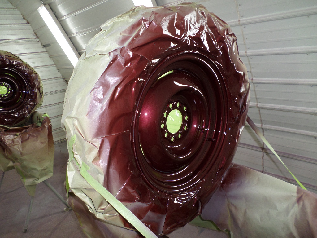

    Got a little more done, doors are a little bigger and turned out ok, no runs or sags. I now have just the body shell and 4 wheels left. I did the wheels in black some time ago but I like the maroon better, so, get out Mr sandblaster. The camera flash washed out the color in these pics.

    norms30a
    The wheels on the rod go round and round, and now they are maroon :D
    And a pic of a little oops.
    I also took off my frame for tipping the body on end, going to start on the body next.
