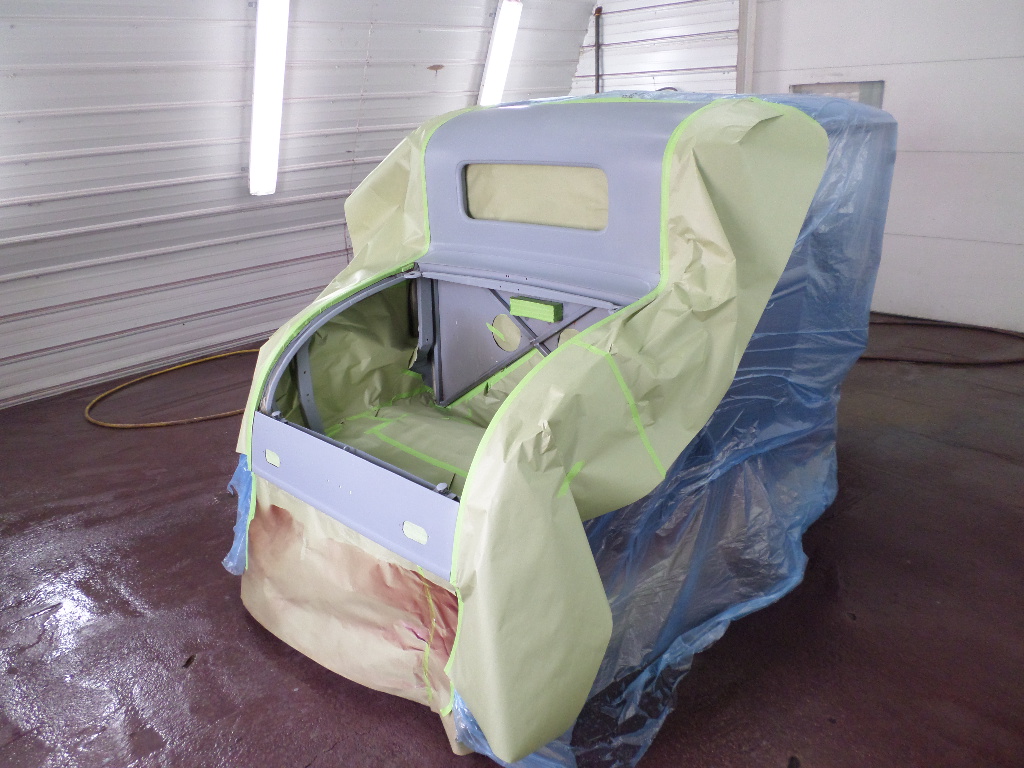

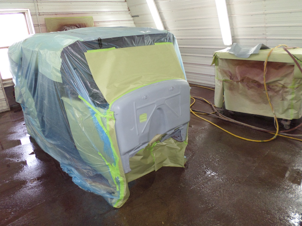

    Got some color on the body last night, decided to do the back area separate so to minimize chances of runs.

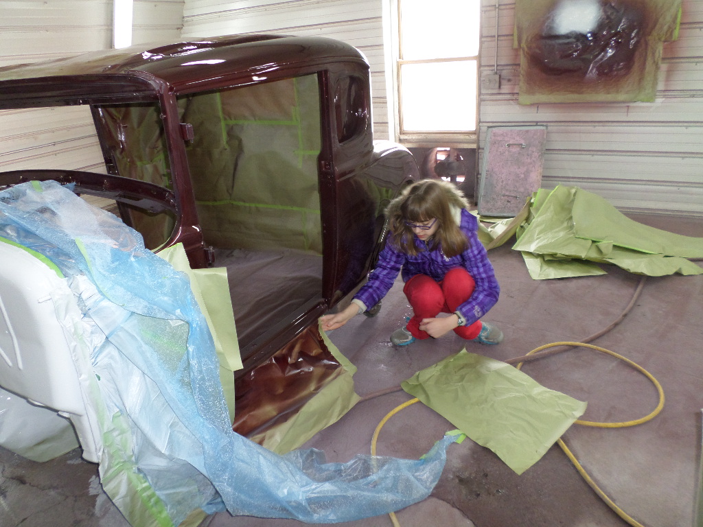

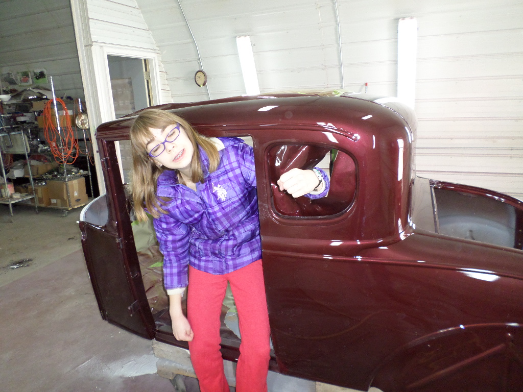

    Painted the last piece Saturday, then my helper took off the paper.

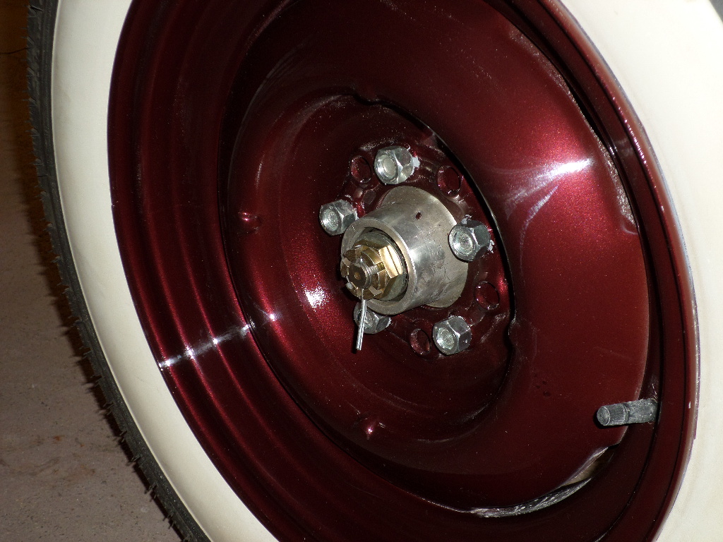

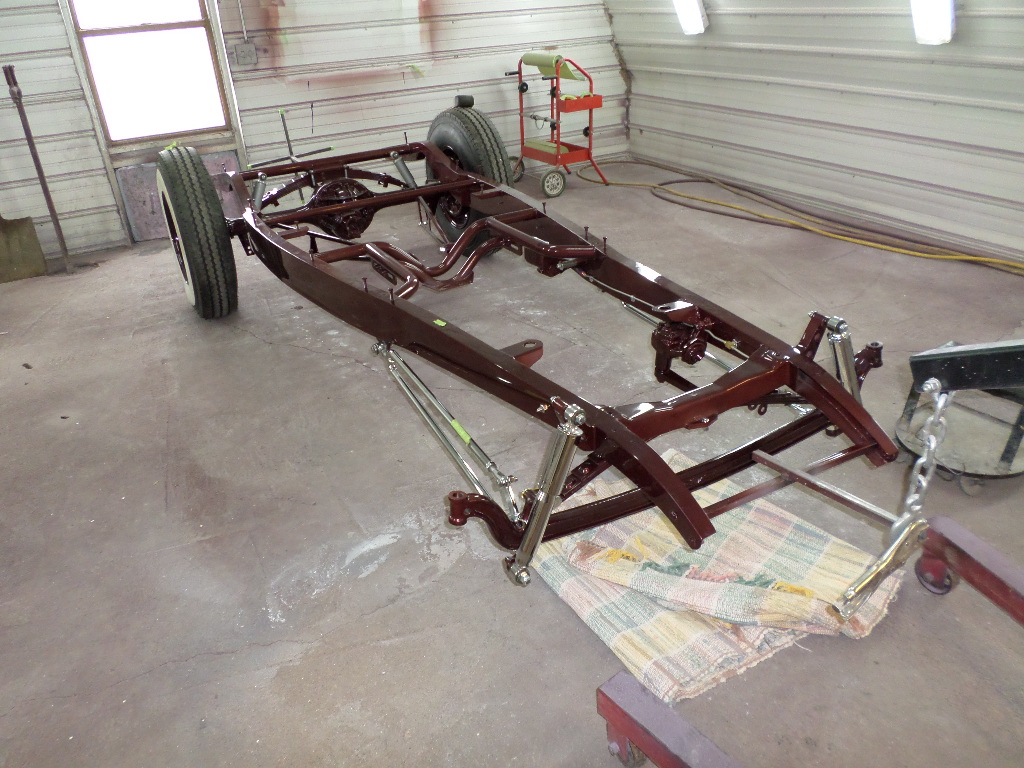

    More pics please, got that covered:D. I sanded and buffed the frame and stuff that bolts to it, so I am putting stuff together so that I have a rolling ch***is now. Still need to put on some brake lines and other small stuff while the body is off.
    Painting, sanding and buffing a frame ****s, way too many corners and edges to work around. This color doesn't help either looks like every angle is a different color.
    I wasn't happy with the short studs on the front wheel hubs so I replaced them with 1/2 inch longer ones

    Good call on those wheel studs. The car is looking great!

    Lookin good and good call on the studs can't wait to see it in one piece, digging the fire wall ,that's what the plan's are for mine too,hopefully I'll get something done before summer, i need more guys like you and your build to get my arzz moving keep them pictures coming======Jack

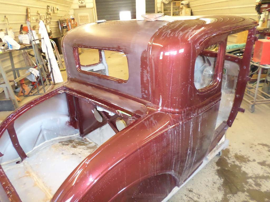

    Thanks guys. Got the body shell sanded and buffed.

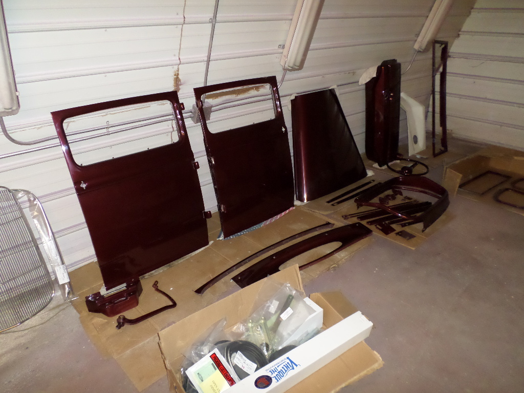

    Time to dust off this old thread after 7 months of not working on the A I have gotten back to work on it. First I finished buffing the doors, hood and all the small stuff. 121 028.JPG

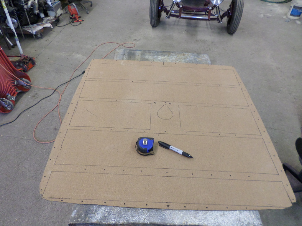

    Thanks for the good words guys, Wex65, that is going to be one really neat coupe, heck it's already really neat. I hope everyone takes a look at your build. I decided to put a top on my junk and not do chicken wire. So first thing I did is,I got some Masonite, made a paper pattern and cut, fitted, drilled and glued and screwed that on. 121 030.JPG
