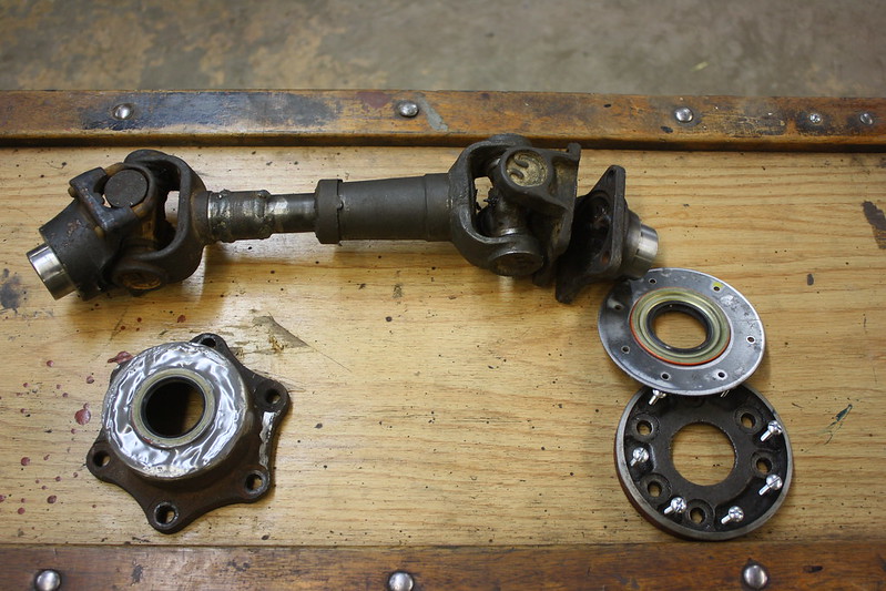

    Yes, some sort of suspension....This is what I did, it works well enough for the occasion ride.....and a driveshaft with a slip joint made from 47 Jeep parts...and a home made open drive oil seal conversion... 13134503124_59e0d5b9a1_c.jpg 12372302504_f4442e9dbe_c.jpg

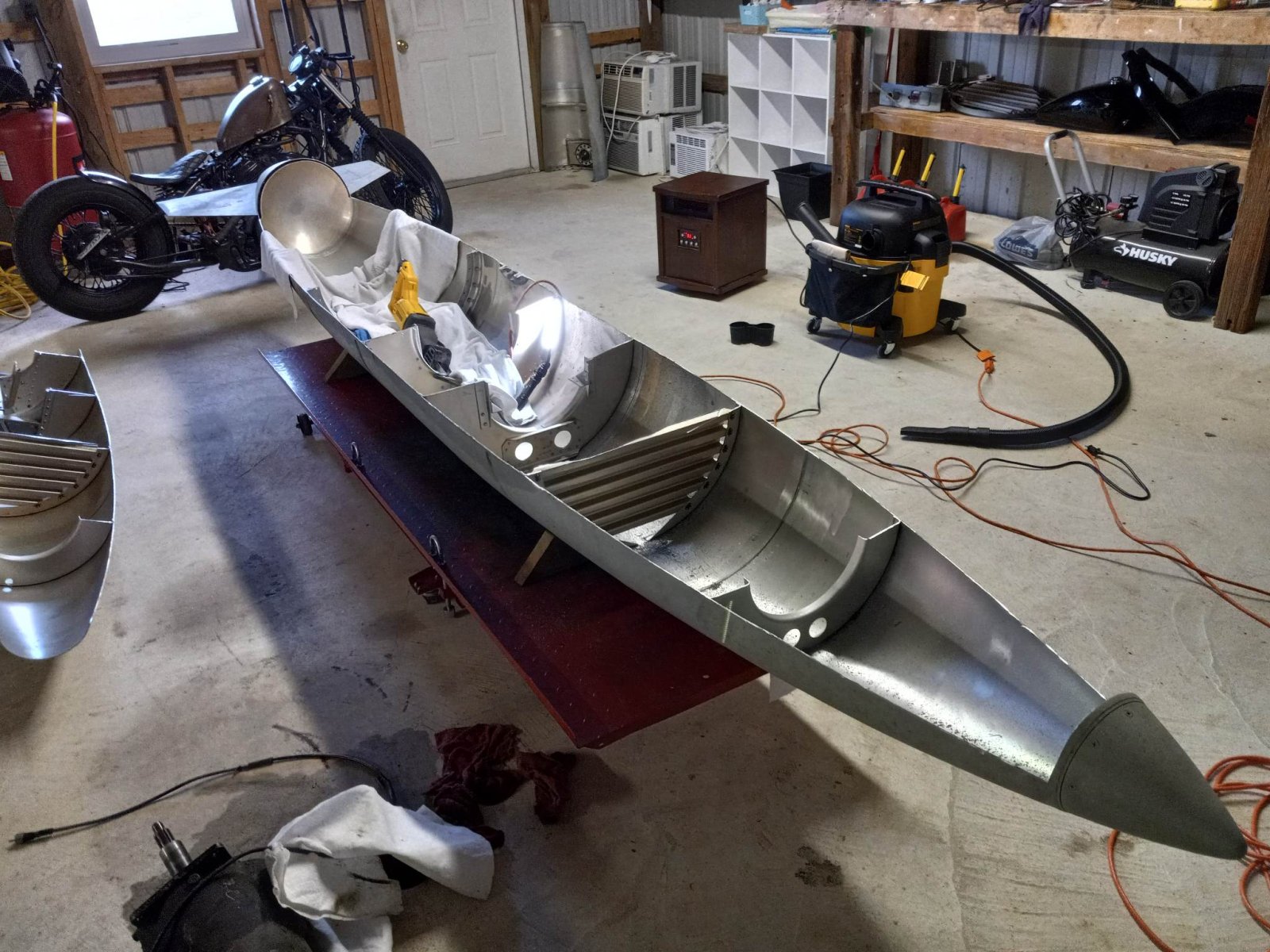

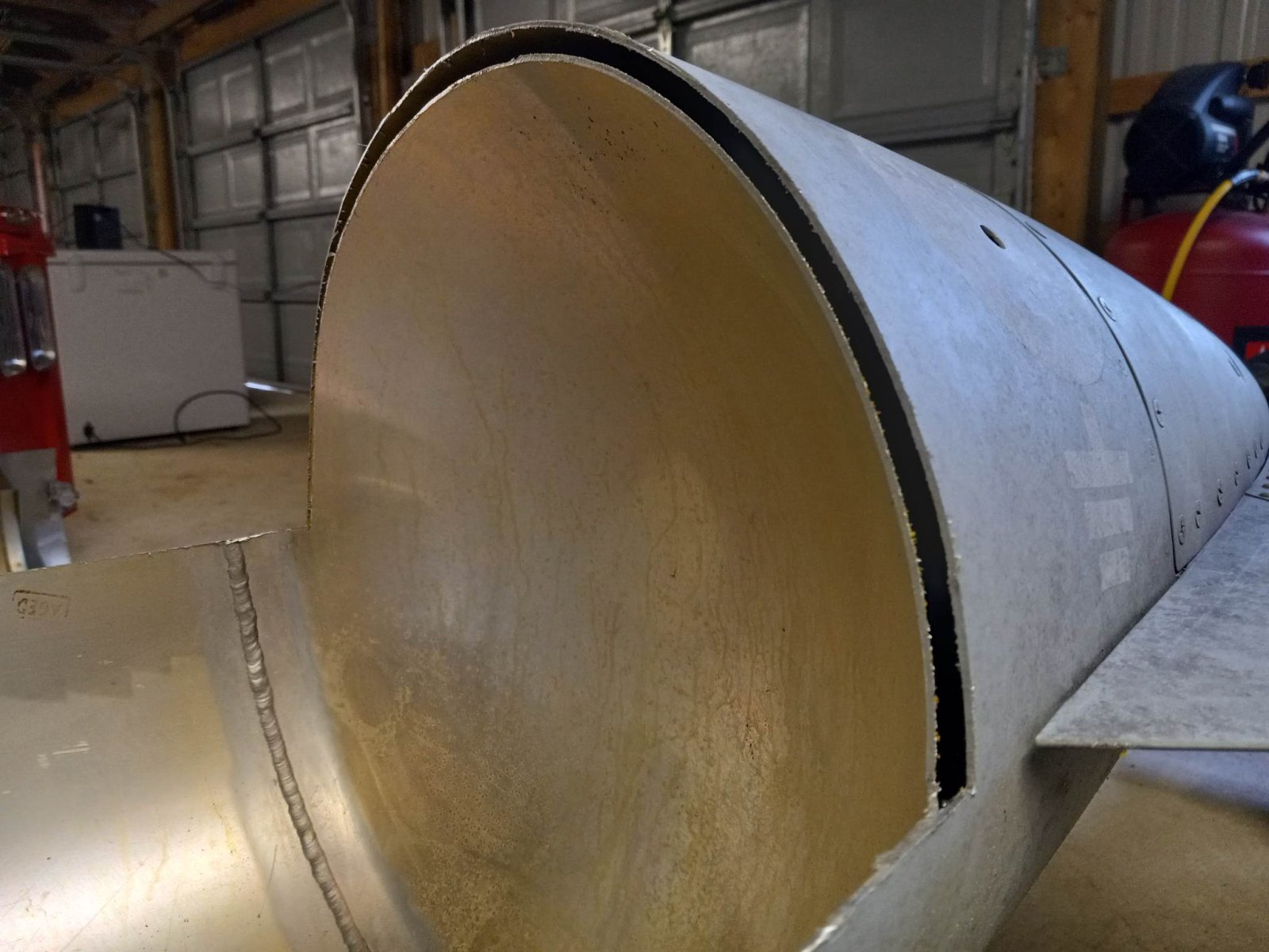

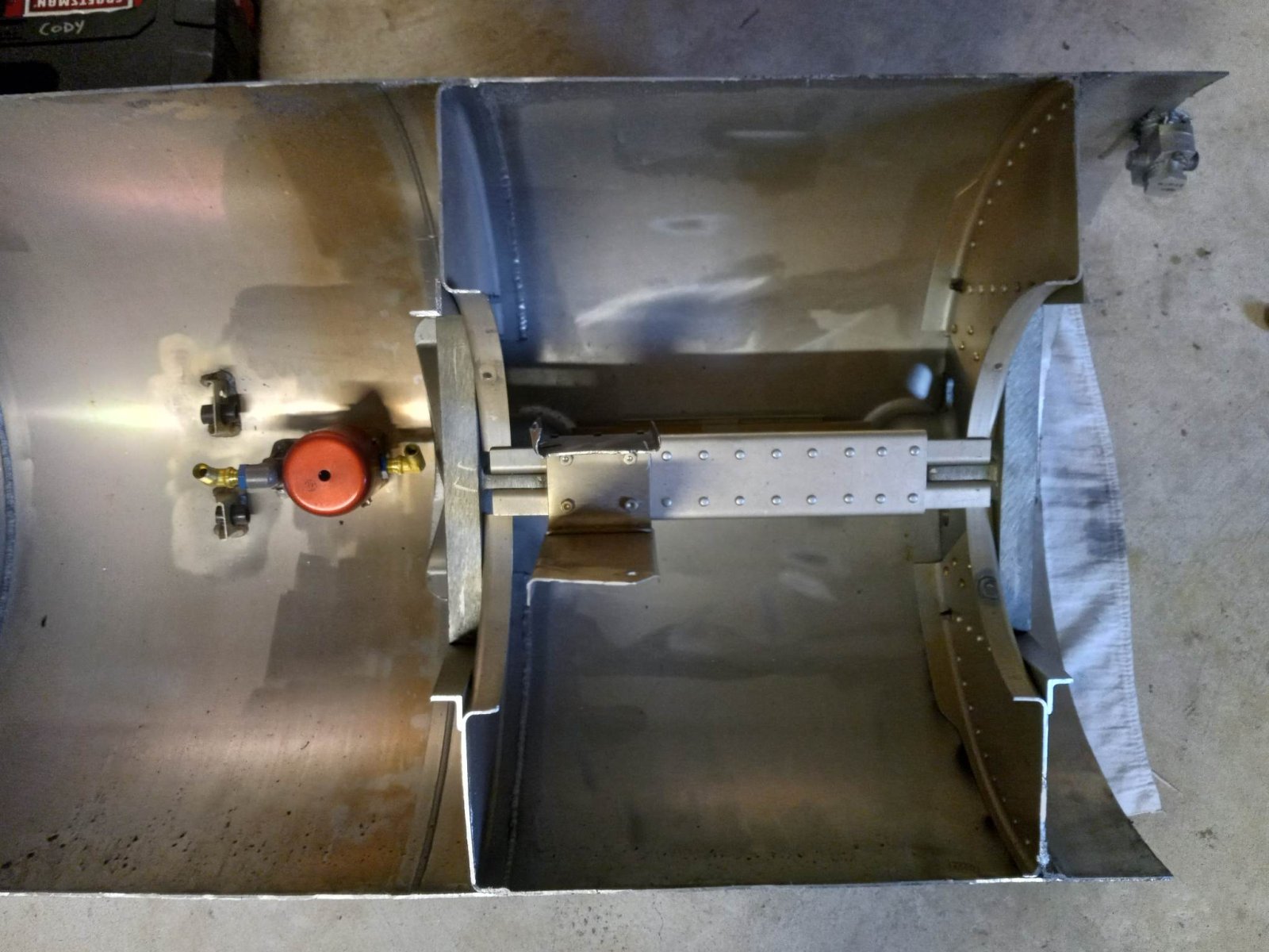

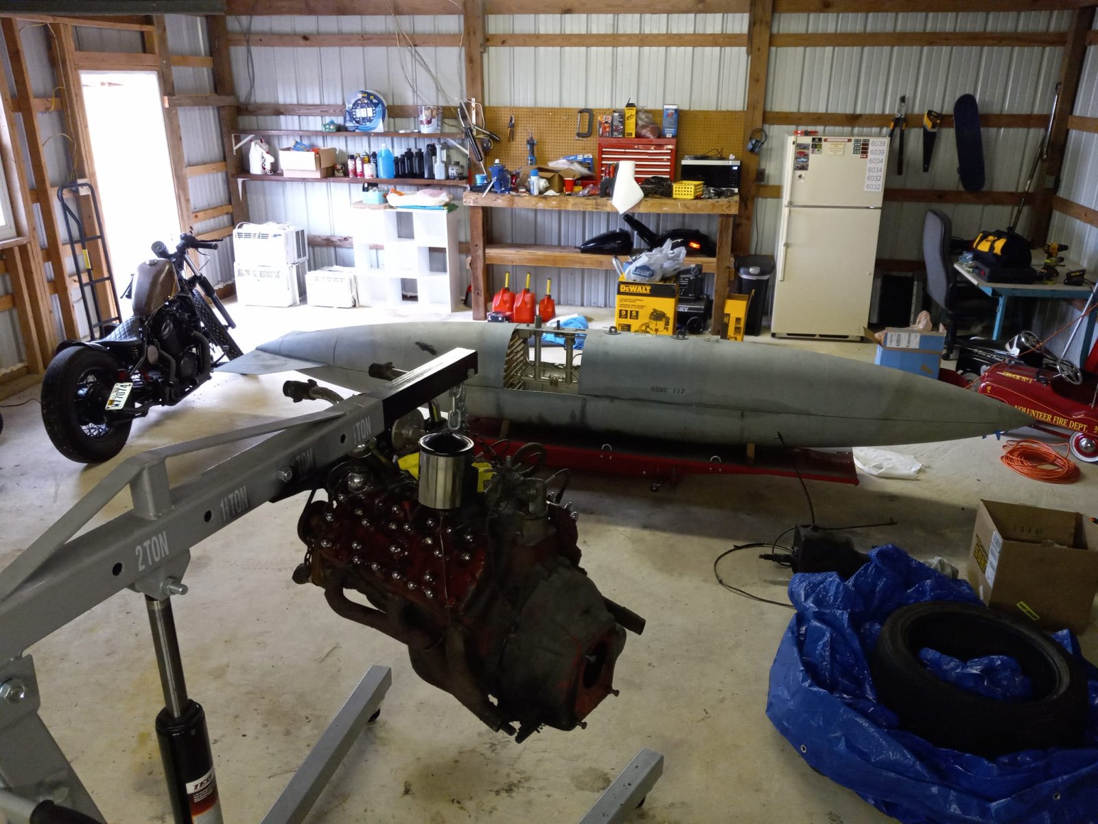

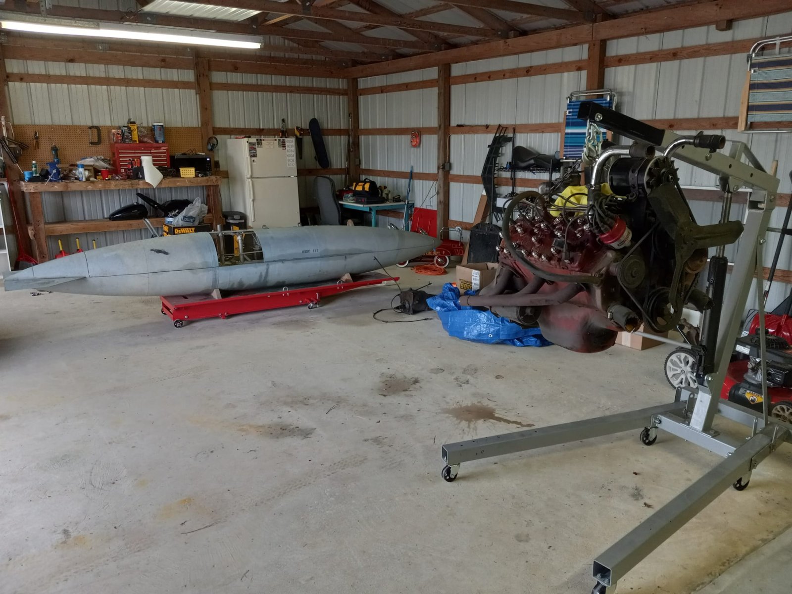

    Got home from work this morning and decided it was time to get this tank split in two. Tool of choice? Sawzall. I laid out a couple towels to protect myself from some sharp edges and hopped in the tank and laid down belly first. Was barely able to squeeze my arms in through the center under the main support structure where the tank would hang from the Warthog's bomb racks. I was able to (very uncomfortably I might add) stretch and reach far enough forward inside the tank to get the forward baffle sliced through horizontally. I first started the cuts from the outside before hopping in the tank to cut from the inside out. It was very loud in there lol. For all those pesky Torq-set screws, I've been taking the cutting wheel to them and giving them the flat-tip conversion. Now that the tank is finally split in two, I'll finish gutting out the tank next time I can make my way out into the garage. I have to say that I cut the tank in the perfect locations for separation with regards to the front nose cone and the rear end before the horizontal stabilizers. Almost time to get started on the frame. Good times ahead! I was able to take a proper measurement of the tank and the outside diameter is right at 22 inches. I didn't take a measurement of the wall thickness of the tank, but the inside diameter looked to sit right between 21 - 5/8" to 21 - 7/8". The 1950 Mercury Flathead should JUST fit inside with around an inch or so of room to spare but that will depend on how I can get the frame situated inside the tank.
    I'll be picture heavy in this build. One thing that bugs me in a lot of build blogs is lack of pictures to tell the whole story so I hope you all don't mind. I love do***entation when it comes to stuff like this so there will be pictures aplenty. It's almost frame time! 327649559_501852145427056_6471687846334451175_n.jpg 327827588_1160580447930123_7597018467270182574_n.jpg 327910794_1251988502061312_6689752508558995164_n.jpg 327916981_509984454573531_2356328219693443050_n.jpg 328138717_1849632755391597_4522169785980810132_n.jpg 328161629_568204702022251_8713973491182246314_n.jpg 328328580_1203420920546457_2896756035138060921_n.jpg 328405436_3512298799006472_4681061396369201199_n.jpg 328583192_754598672941815_8854393122862759911_n.jpg 328630657_6486259988055072_3997319522859708354_n.jpg 328634709_1343900756399354_6481985405074716933_n.jpg 328654946_710357544094940_5695341409595132887_n.jpg 328707360_701119251502020_6261742711424000054_n.jpg 328773685_2218472184991879_2763101265621779666_n.jpg 328844955_706332530960343_7567823066515573609_n.jpg 328883864_541327094726860_9133261086380137785_n.jpg 328924376_3403366729992956_2262587245683218264_n.jpg 329005432_848611149557814_6200865063437236161_n.jpg 329073431_877582486899519_7877215510357952519_n.jpg 329104358_885002992616393_7937089918608588052_n.jpg 329121180_553248583424238_6595669397349840908_n.jpg 329149622_1171270686910671_5186726341243474960_n.jpg 329161525_584781856839746_5112164298849123067_n.jpg 329173158_723420102708389_2278206731255407801_n.jpg 329187059_972582230769125_450528945897848753_n.jpg 329211118_3460470380890071_2181975298070123000_n.jpg 329214759_3432875750367669_8609439106519983057_n.jpg 329224011_1637436546679797_678126957106068648_n.jpg 329292149_560872372640659_5721329962661794459_n.jpg

    Was able to take a proper measurement this morning. The outside diameter of the tank comes in right at 22 inches at it's widest. I didn't take a measurement of the tanks wall thickness, but the inside diameter looked to be around 21 - 5/8" to 21 - 7/8' thick. The 1950 Mercury Flathead I picked up should JUST fit inside with maybe an inch to spare. We'll see how it lines up after I get the frame pieced together.

    What type of ch***is are you going to make? That may make or break it as you will run out of room fast. You will need to work out how much room you need first, mine is 36'' at the widest point...still tight. JW

    Planning on 2x3 1/8" steel channel stock at this point. With my welding skill level it will be easier to weld rectangles and square shapes as opposed to a round tube ch***is. I'm not a big fan of welding round objects. I'll also be able to use the garage floor and the flat shape of the 2x3 rectangles to help me keep a rectangular ch***is straight and level as I put it together... I also think the ch***is I create will be of higher quality and I can make sure it is as symmetrical as I can. Since I've only got 22 inches of space, less than that for the ch***is since it will be located lower, I'll be sure to take plenty of measurements. The tank is 14 feet long, so the wheel-base should come in somewhere around 11-12 feet in length.

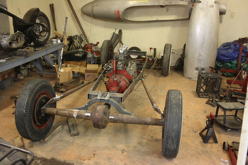

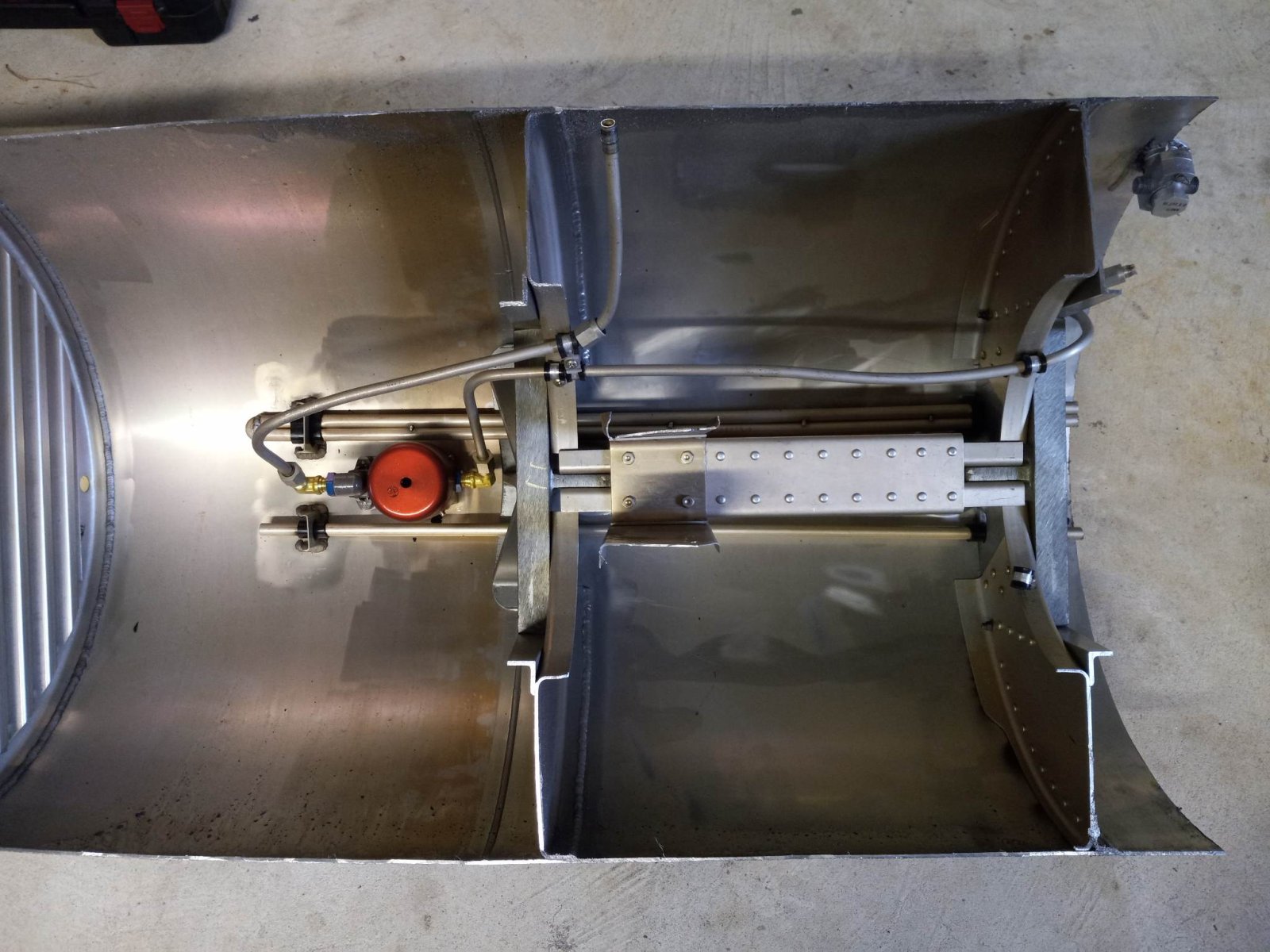

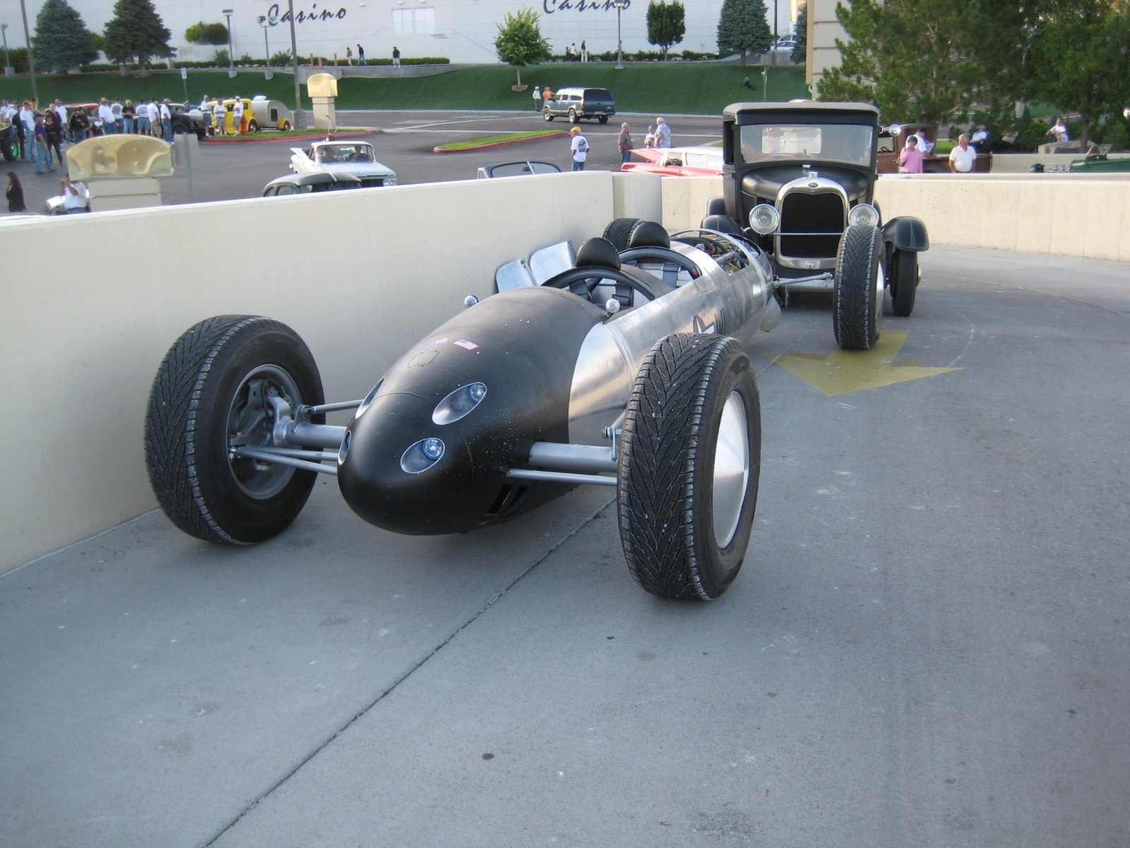

    I did this P-38 with similar power train as you are planning. It took 2 sets of T rails for the frame. Packaging of the necessities to make it complete, takes some juggling. Good luck with your project. IMG_7560.JPG IMG_0941.JPG IMG_0944.JPG
