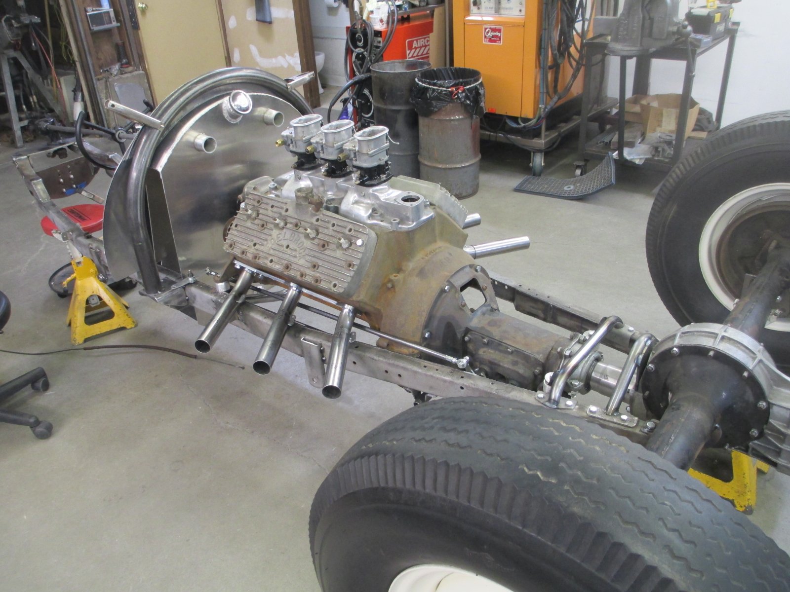

    Excellent work on your tank. Looks great! I was planning on doing single pipe headers very similar to that. Looks so cool exiting the tank. Does the water tank like that limit drivetime as opposed to a radiator?

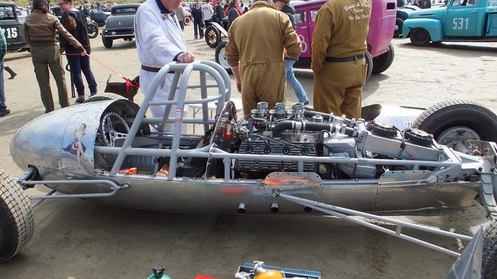

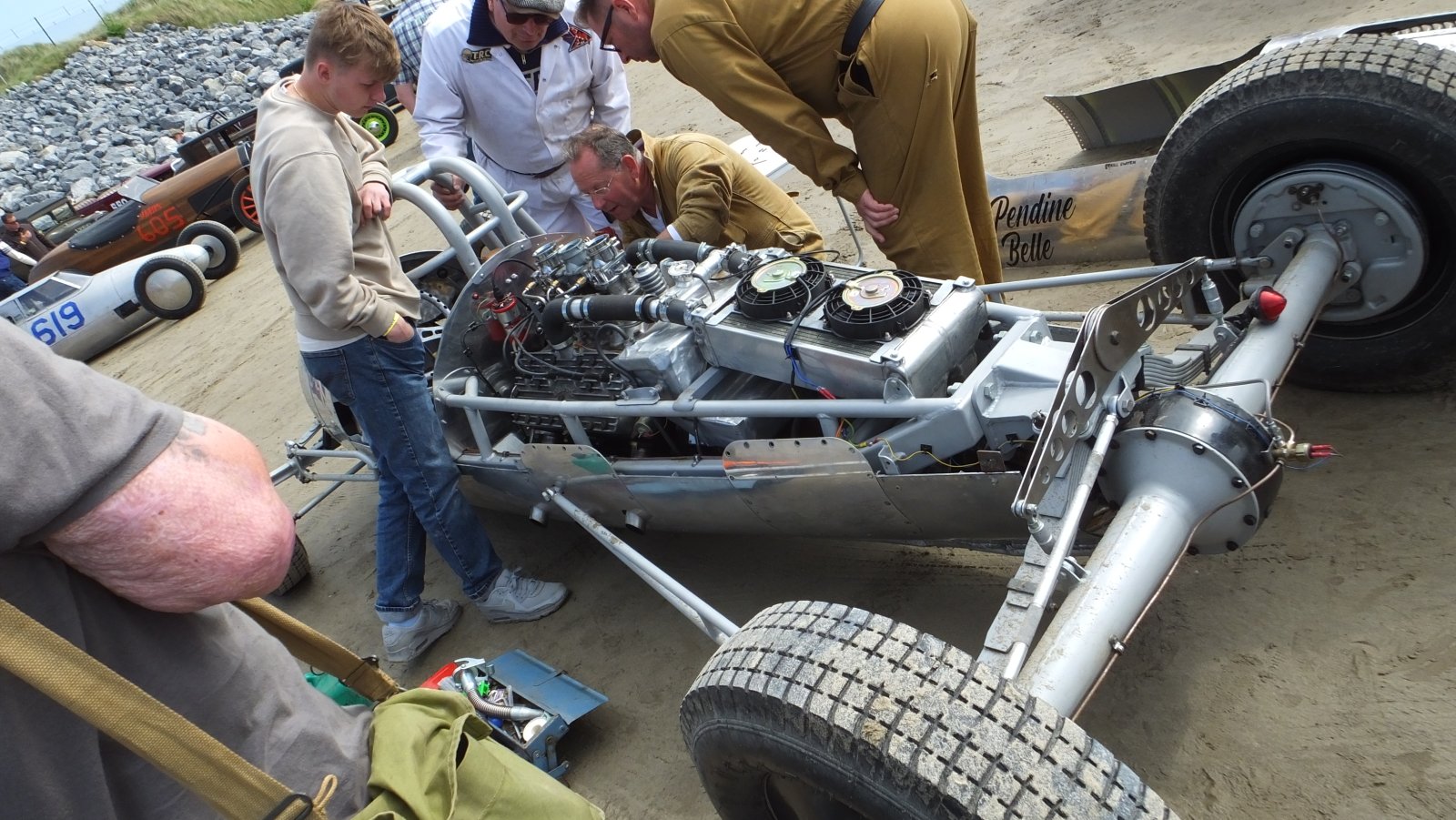

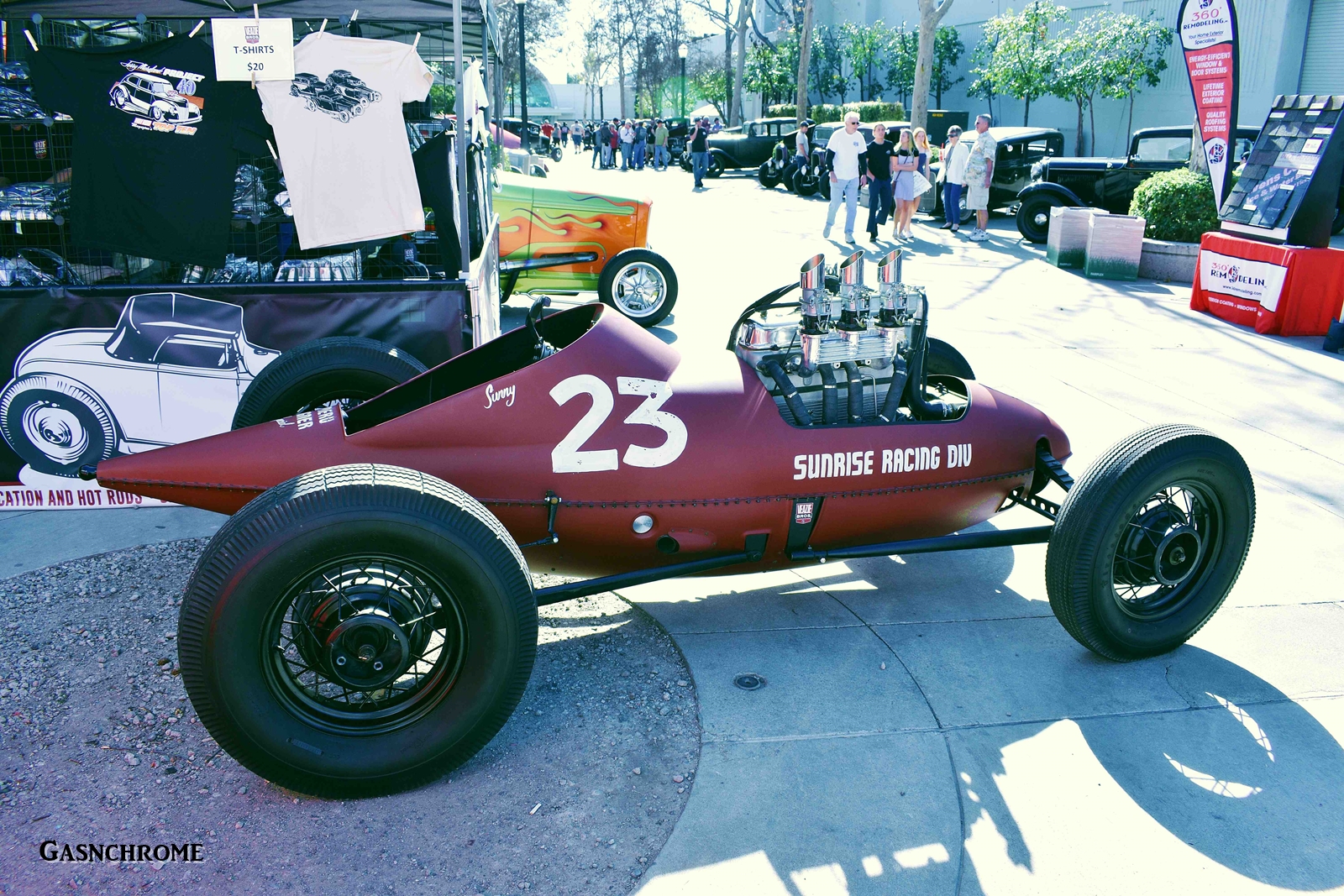

  6. 282doorUK
    Joined: Mar 6, 2015
    Posts: 524
    282doorUK

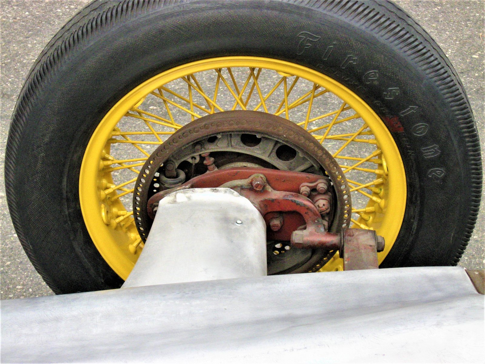

    I snapped this one at Pendine last year, maybe some ideas there for you.

  8. Superlite
    Joined: Feb 1, 2023
    Posts: 103
    Superlite
    I burned through six 4" cutting wheels to get through the tank. More than i thought. It hasn't been the easiest to bisect at all but the sawzall has made it easier lol. I won't be using a flange. I'll be riveting small profile aluminum sheeting on the inside of the bottom half and using either flush or winged camlocs to secure the top to the bottom. Winged camlocs if i decide i don't want to have to use a tool to separate the two halves. Flush camlocs if i would rather have a completely smooth profile. The inside aluminum sheet that i'll be riveting on will also help to further keep the tanks shape while using next to no space as well as a very quick way to separate the two halves. I'll be hinging the halves so they can flip up as well.
  9. Marty Strode
    Joined: Apr 28, 2011
    Posts: 9,710
    Marty Strode
    This one being a race car, the water tank is the way to go. In your case, a radiator would be best, but with a flathead, you need lots of water and air supply to it, and hot air exit.

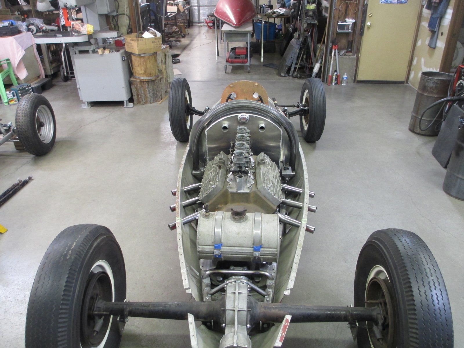

  10. Marty Strode
    Posts: 9,710
    Marty Strode

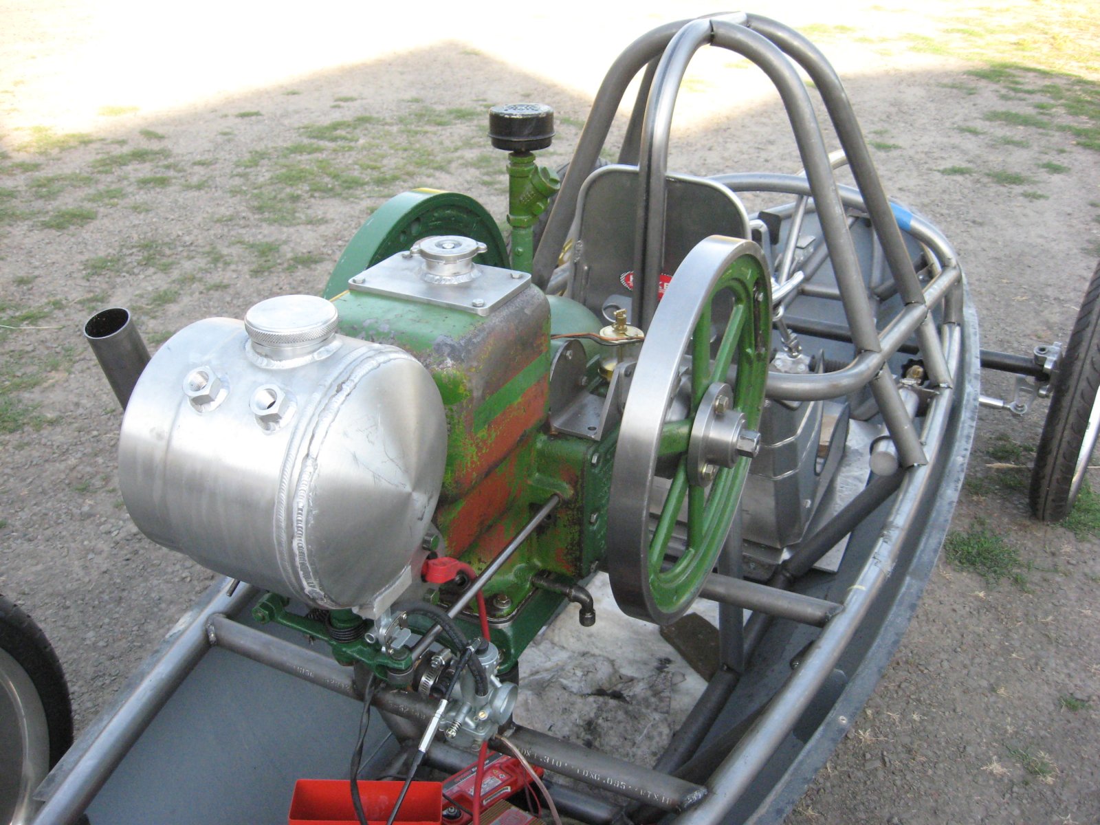

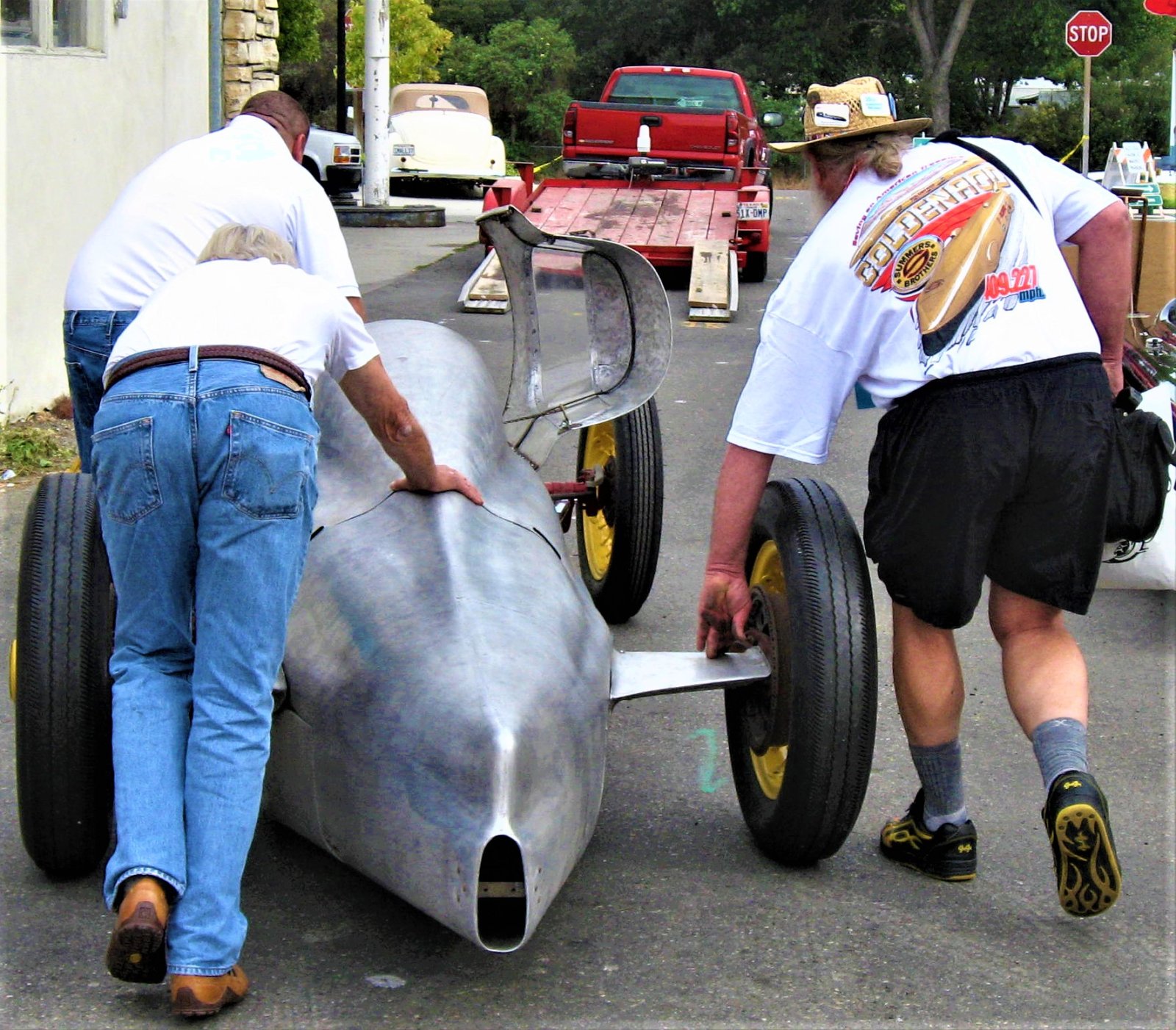

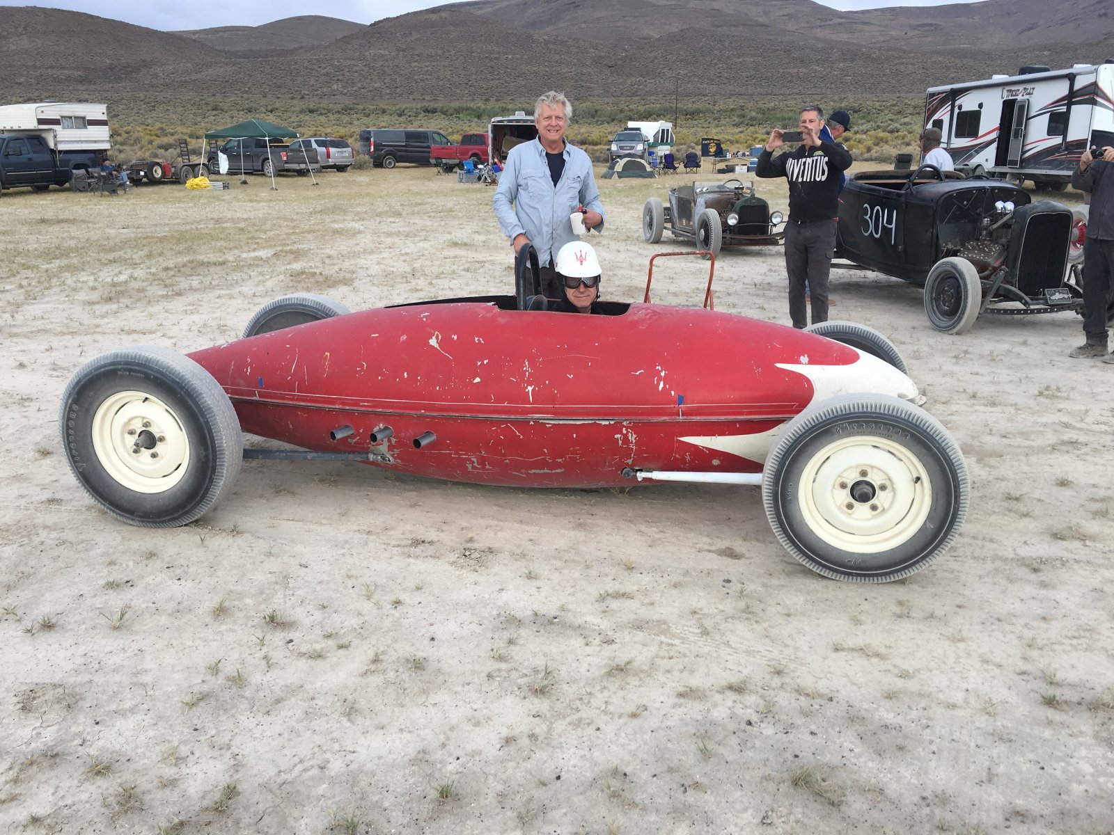

    Now if you want something unique, this is another one I worked on. IMG_5751.JPG IMG_5757.JPG

  11. Atwater Mike
    Joined: May 31, 2002
    Posts: 11,618
    Atwater Mike
    Marty. Just Marty!

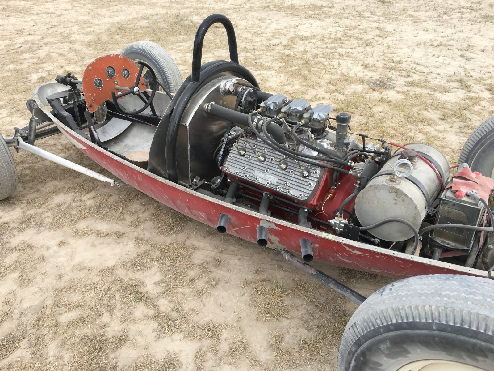

  12. Bearing Burner
    Joined: Mar 2, 2009
    Posts: 1,208
    Bearing Burner
    from W. MA
    All of the belly tanks I have seen including mine had full or partial tubing hoops to give stiffness to upper tank half with Dzus fittings securing the top in place. My flathead powered belly tank had a
    large watertank behind engine. m\Must have held 15 gal.

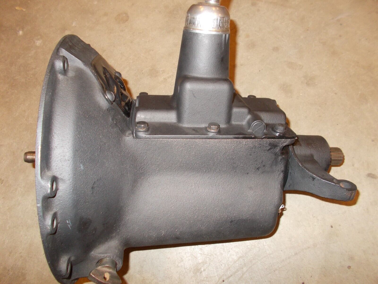

  15. alanp561
    Joined: Oct 1, 2017
    Posts: 5,591
    alanp561
    o_O Okay, I'll do it! First, let me say that I'm awe struck, @Marty Strode. Were you and your friends bored and this the result of a beer and ****tail napkin planning session? Some friends and I built a complete nuclear powerhouse one afternoon using that same method. Do you mind telling us what this creation achieved?
  16. Atwater Mike
    Posts: 11,618
    Atwater Mike
    F100 pickups had a side shift with a short bearing retainer, mainly just the gearbox. 3 speed, '53-'56 (at least, maybe more)
    chryslerfan55 and alanp561 like this.

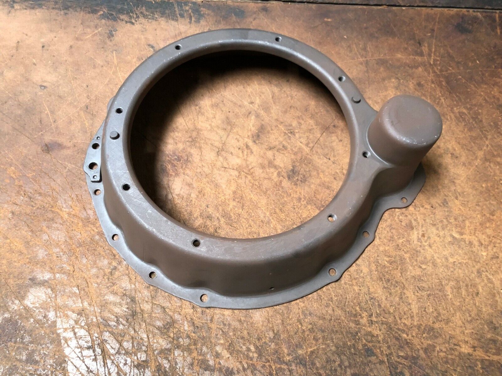

  17. alanp561
    Joined: Oct 1, 2017
    Posts: 5,591
    alanp561
    In regard to your transmission; why not change over to an F1 trans? You would need the Mercury bell housing conversion for 8BA to 59AB and the trans would be shorter with an open drive. Your driveshaft shop will have the Powerglide slip yoke. You'll have to shorten the slip yoke 1 and 5/8" to keep from running into the speedometer drive gear. I called Mac VanPelt to get the dimension.
    F1 top loader open drive 1952-61 3 speed
    [​IMG][​IMG]

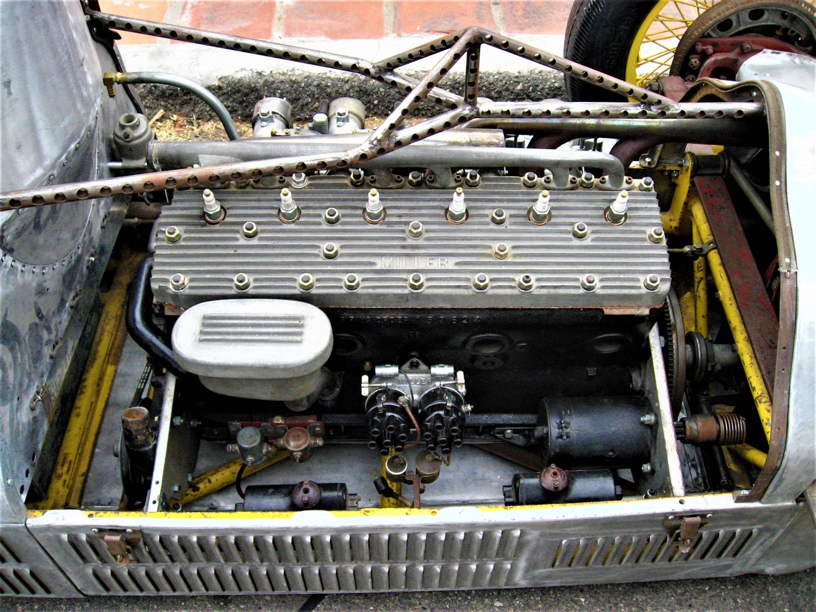

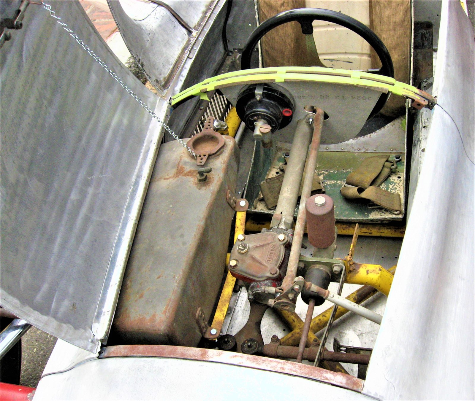

  18. 41 GMC K-18
    Joined: Jun 27, 2019
    Posts: 5,269
    41 GMC K-18

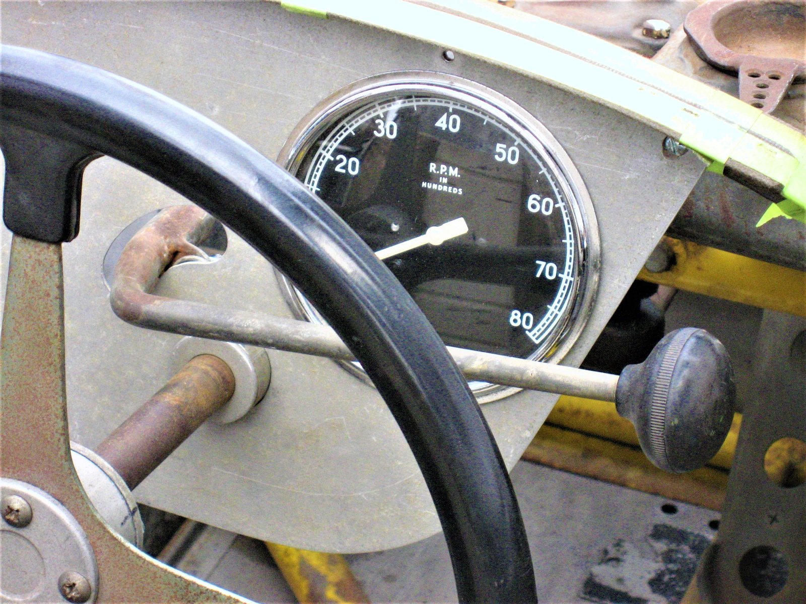

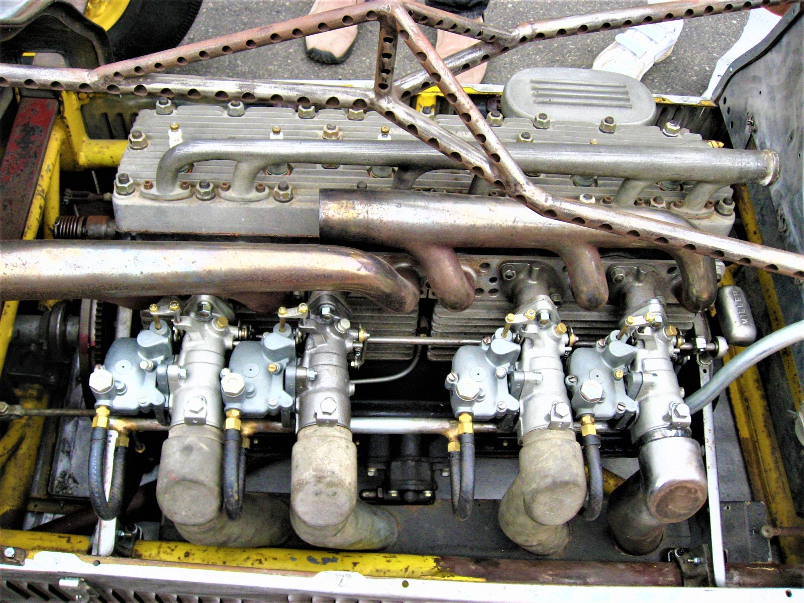

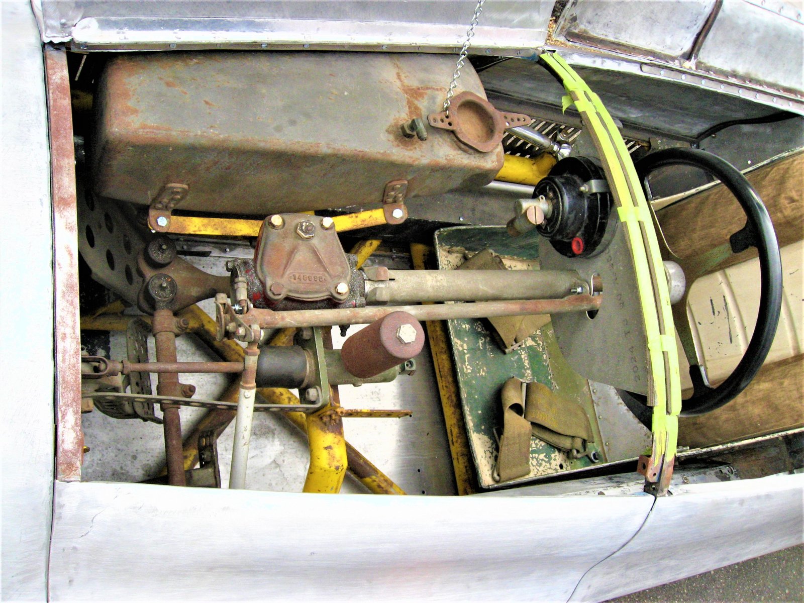

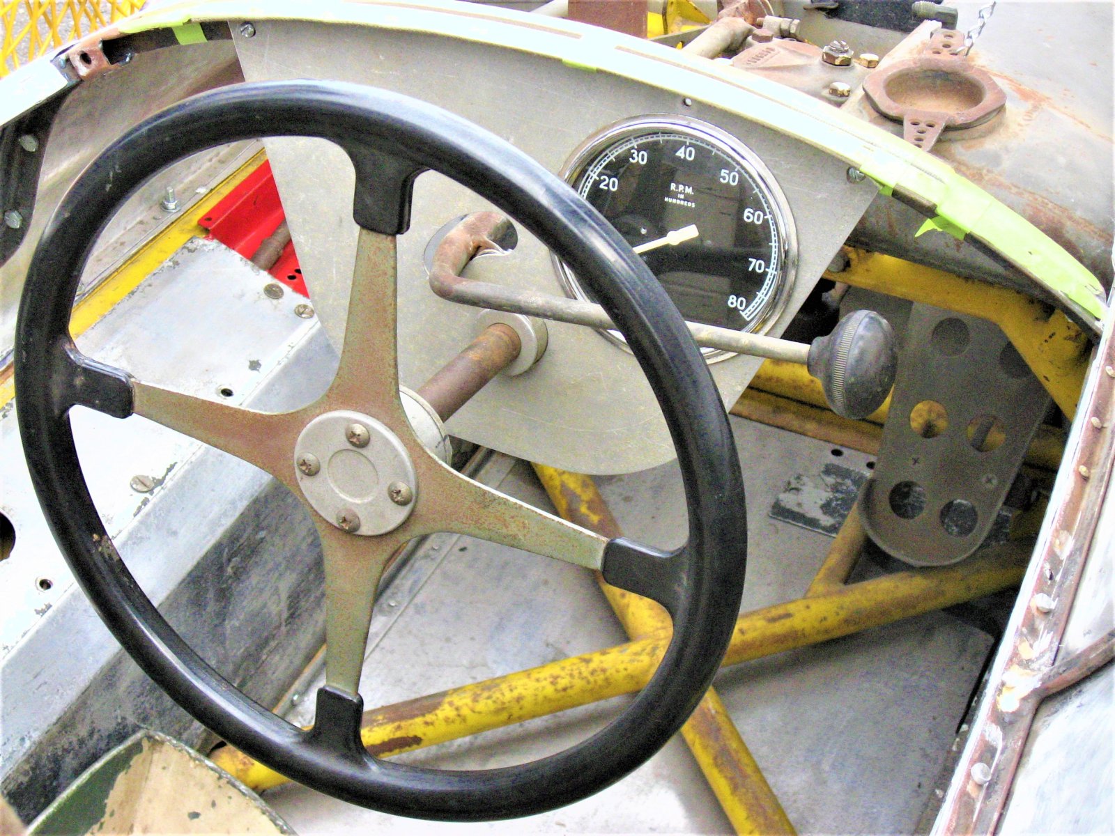

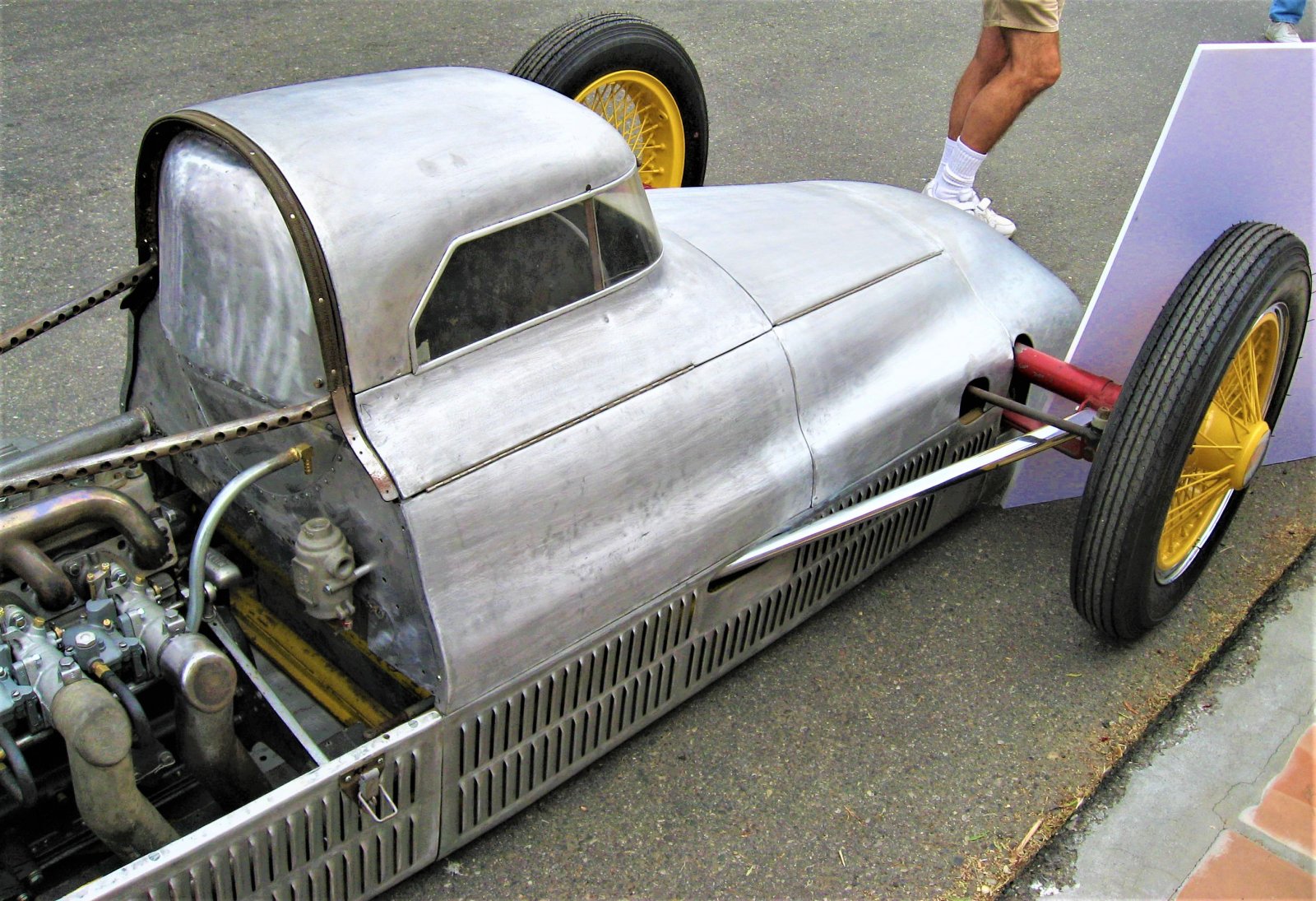

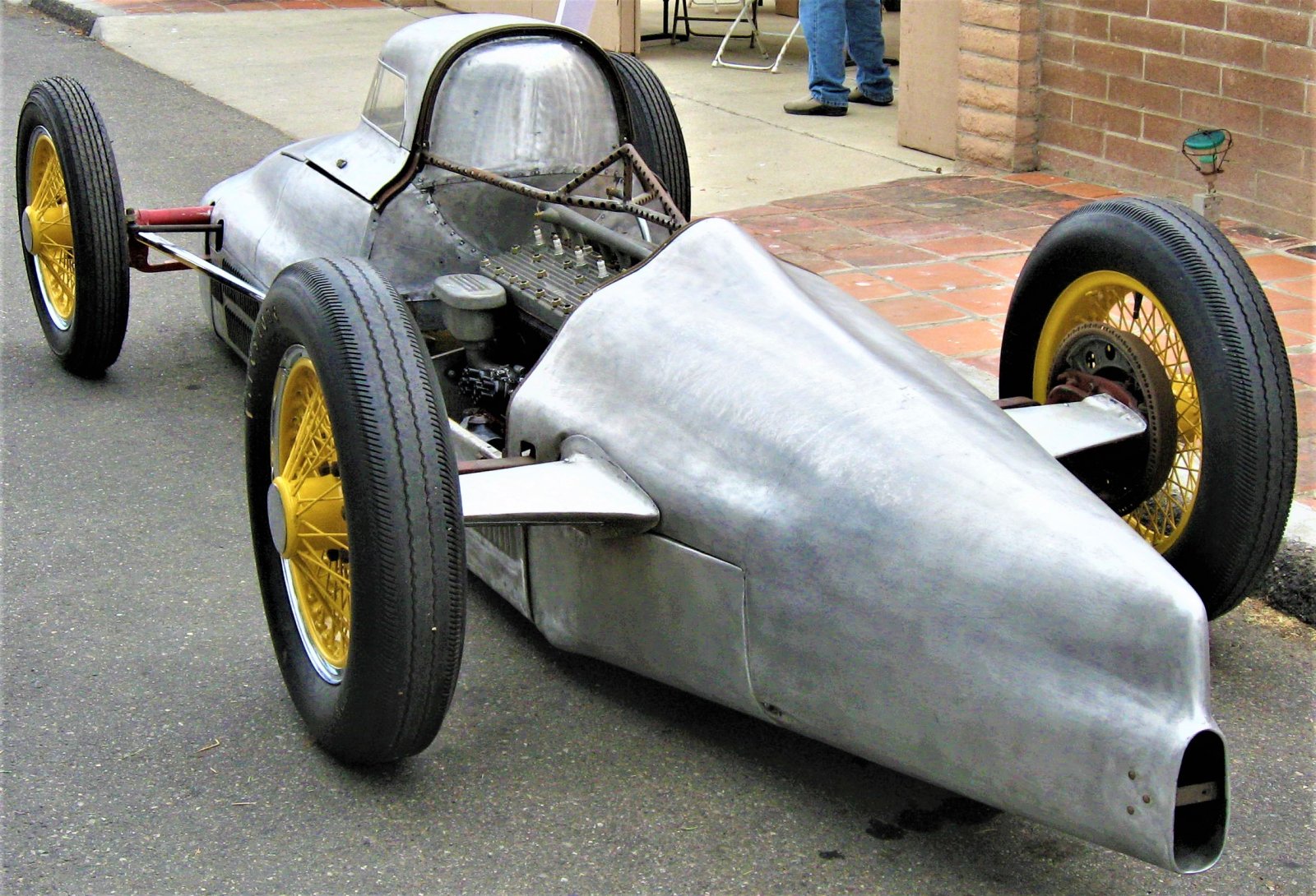

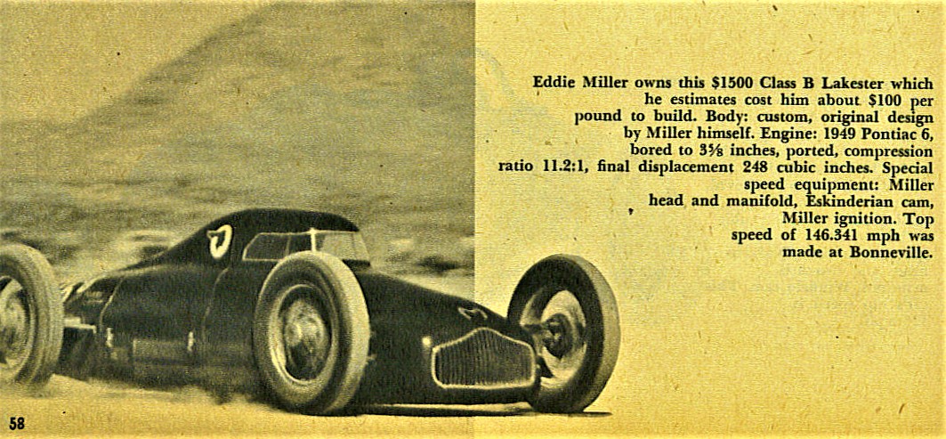

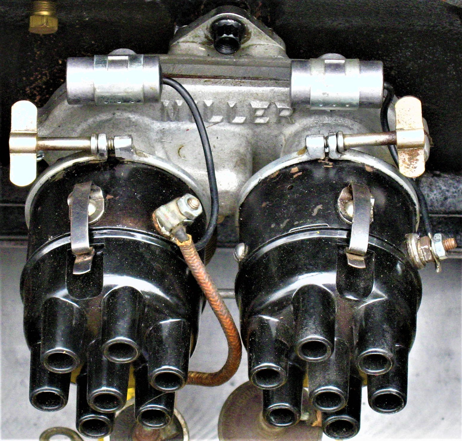

    I have posted these pictures before on another thread that deals with "lakesters".
    So this particular cool machine, isn't a true belly tanker, whether its a tank from a P-38 or the kick ***
    A-10 Warthog.
    But you have to admit, its styling and engineering is way beyond cool!
    But that being said, this is just some pure inspiration, for @Superlite as to how it was done back in the day.
    His results may vary!
    These shots were from the "GAS-UP" at Jack Mendenhall's family, private compound in Buellton California a number of years ago.
    Enjoy from Dennis.
    eddie miller Jr. reader board (2).JPG engine right side 2 (2).JPG IMG_0327 (2).JPG miller cockpit 2 (2).JPG miller drilled drums (2).JPG miller duel distributor (2).JPG miller left side (2).JPG miller reader board 2 (2).JPG miller right side cab (2).JPG miller shift and tach 2 (2).JPG miller shift and tach 1 (2).JPG pontiac flathead 6 banger (2).JPG IMG_0338 (2).JPG IMG_0334 (2).JPG miller on trailer (2).JPG eddie miller jr. Lakester (2).jpg
  19. Marty Strode
    Posts: 9,710
    Marty Strode
    It was from the mind of Lonnie Gilbertson,I just did the cage and interior tin work. Lonnie won the AMBR twice in the 70's.

  21. Superlite
    Joined: Feb 1, 2023
    Posts: 103
    Superlite

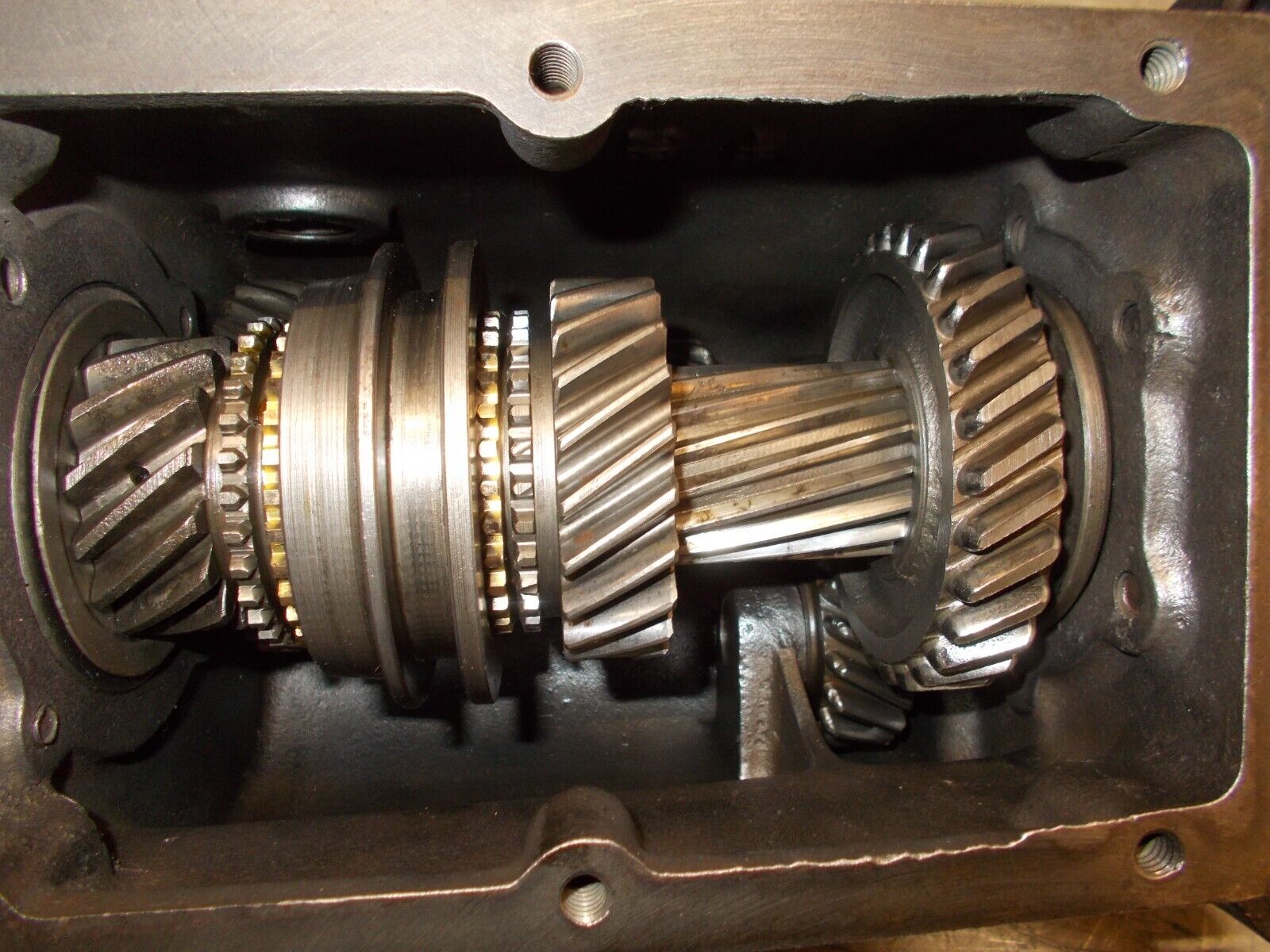

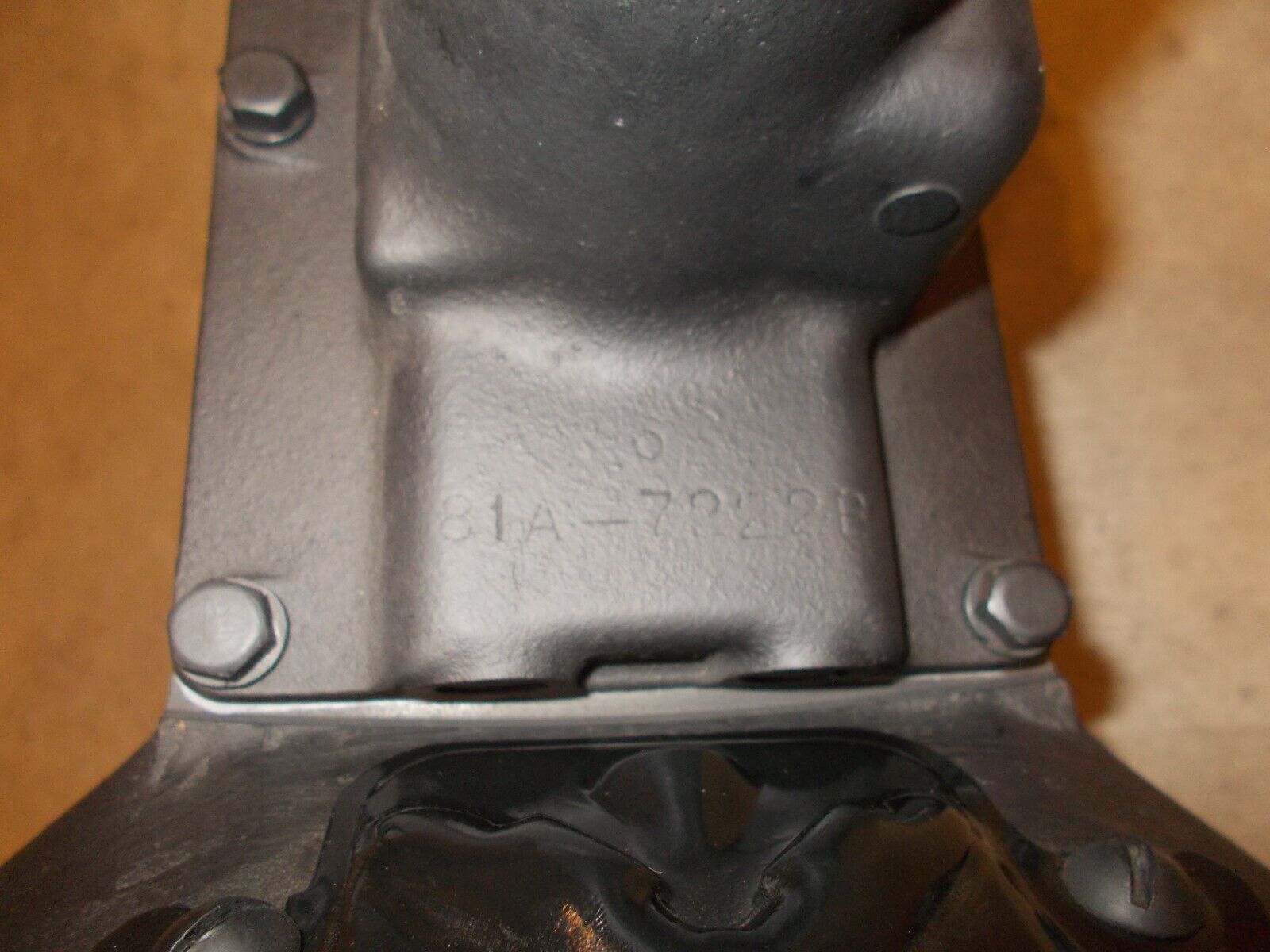

    Thanks for this suggestion and pointing me in this direction. I just picked up this completely overhauled beauty... 1942-1952 F1... Should arrive to the house in a week or so. Since this will be a driver, this completely re-done trans will give me a lot of peace of mind. I hate being stranded lol. Also, no oil leaks to deal with as there are with the current 3 speed trans sitting in the shop. I like how there isn't that long tail shaft in this one. Thanks for pointing me in the right direction Alan s-l1600 (1).jpg s-l1600 (2).jpg s-l1600 (3).jpg s-l1600 (4).jpg s-l1600 (5).jpg s-l1600 (6).jpg s-l1600 (7).jpg s-l1600 (8).jpg s-l1600.jpg

  24. Superlite
    Joined: Feb 1, 2023
    Posts: 103
    Superlite

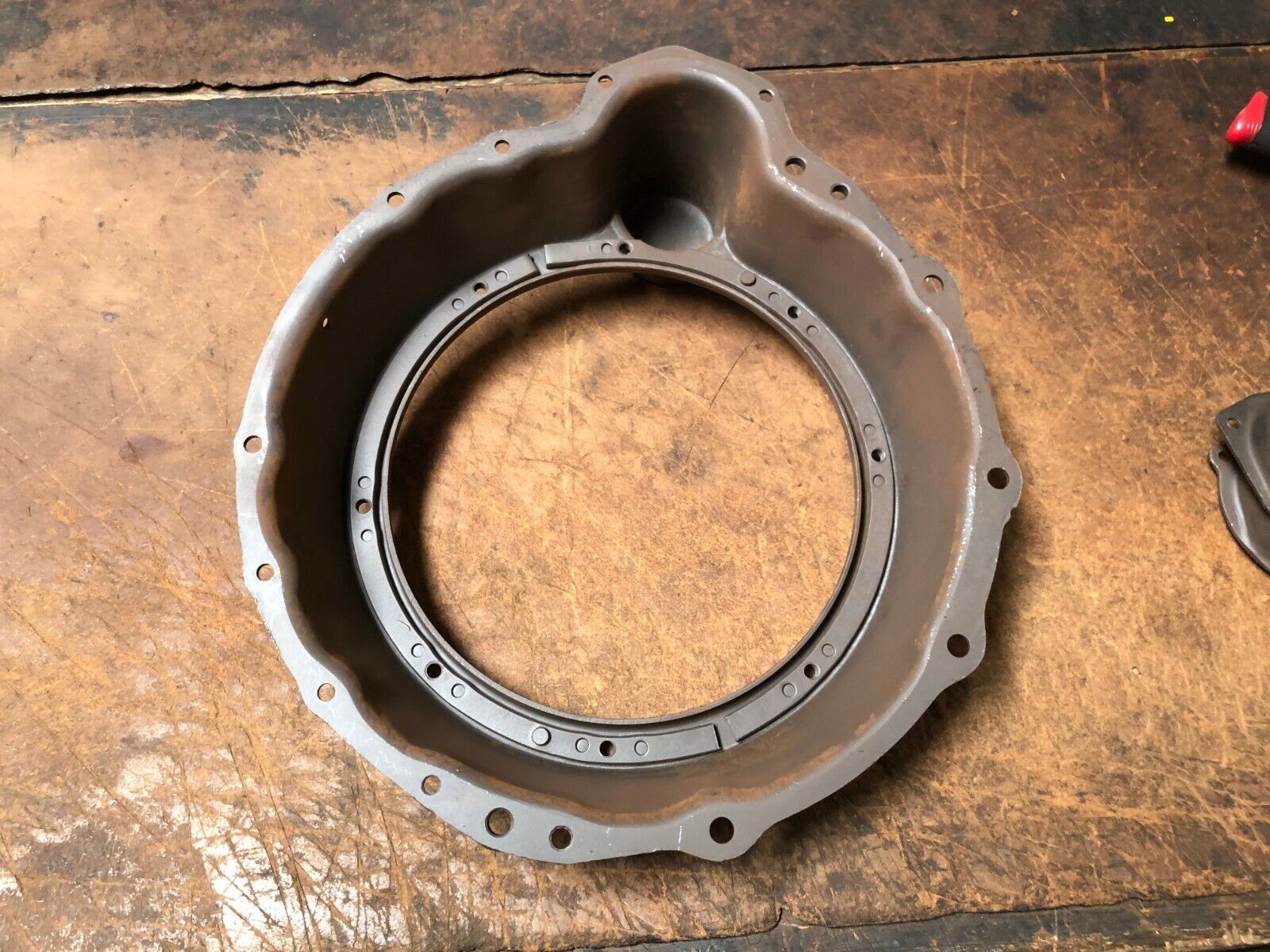

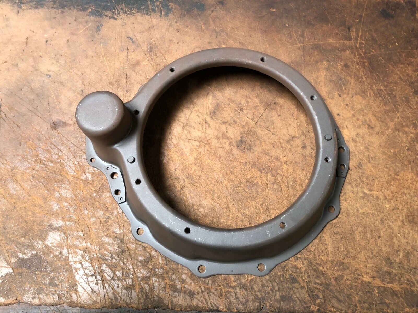

    Picked up this Bellhousing adapter for the 8BA Flathead which is what I have. Everything should mate right up(hopefully lol) s-l1600 (9).jpg s-l1600 (10).jpg s-l1600 (11).jpg
  25. alanp561
    Joined: Oct 1, 2017
    Posts: 5,591
    alanp561
    There are two different starter plates, one for standard trans and one for automatic. The one for the automatic tilts the starter slightly and you don't want that one. Mac VanPelt at VanPelt Sales is a gold mine of information and has an incredible inventory of flathead parts. If you don't have a Ford Green Book, buy one. Another source is

    Make sure you get the correct starter plate.
